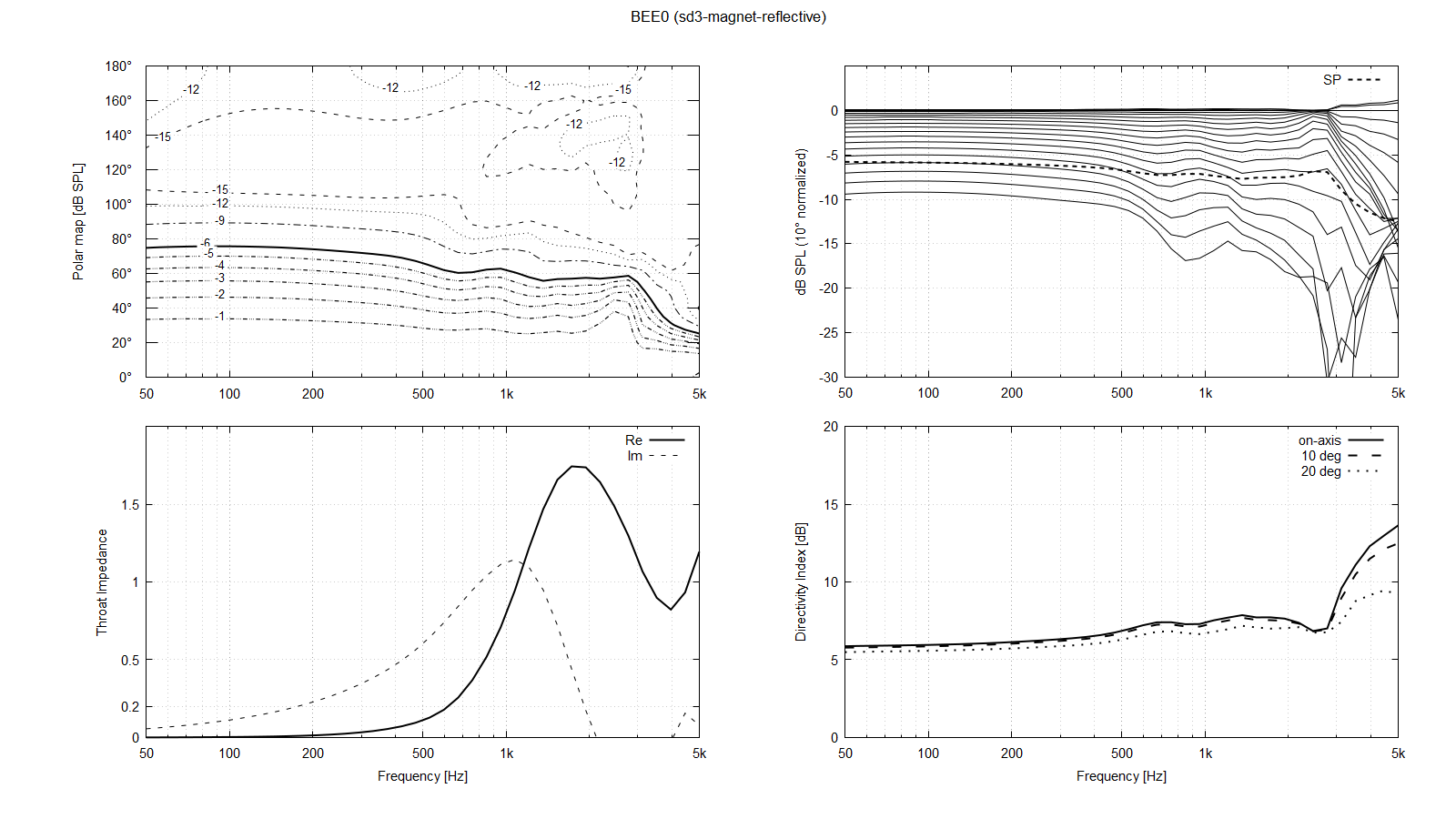

First suspect explanation for the ~650Hz axial boost is "dipole peak", which relates to path length between front and back source. Hump below which the ~-6db/oct slope of such gradient system is. Testing with VituixCAD diffraction tool, if it was just a flat open baffle then the "dipole peak" would be about where same sized closed box baffle edge main diffraction hump is. But, now with such 3D model the slot is quite far back the hump moves to lower frequency compared to closed box, so I think the axial boost is feature of such "U-Baffle" or what that is called I don't know 🙂 Path length increased toward back. You can probably move the hump higher or lower frequency by moving the slot front or back affecting path length, but if the response is now what you are looking for then there is no point to.
How is the damping modeled in the simulation? It looks like the slot is open and the walls inside are made of damping material? Would you build it like that or something else?
I suspect it needs some prototyping to get the response, for this reason could you simplify the box simulation, flat top for fast cheap prototype construction? If you get the pattern right with that you'll know it works with the rounded top as well, you can anticipate differences between rounded and flat top from differences in simulation results.
edit. By the way, is the damping constant over whole bandwidth on the simulation? Can you insert absorption coefficients for the material? If not then you'll need to use material and thickness that has ~constant absorption for the bandwidth you need the pattern, which might mean construction insulation in a thick layer, which might give too much attenuation. Usually materials have kind of S-curve on the absorption. Constant absorption happens at high frequencies and its high, like 20db high. On low frequencies there is very little absorption, especially in small thickness, and then some ramp up on the mid frequencies. This is kind of a shelving filter adding some group delay to the system and what not, might change the pattern from ideal unless you can model it?

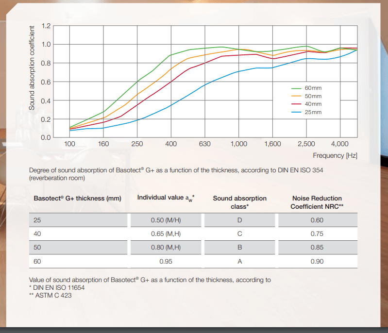

Basotect seems to work nicely on my cardioid mid prototypes so I suggest try that first if you want to model real damping material: https://insights.basf.com/files/pdf/Basotect_Brochure.pdf I'm using 2.5cm thick melamine sponge on the apertures.

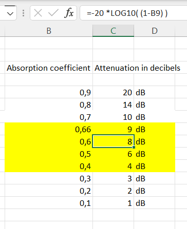

How to convert absorption coefficients to decibels for those who can't calculate dB in their head, I can't 😀

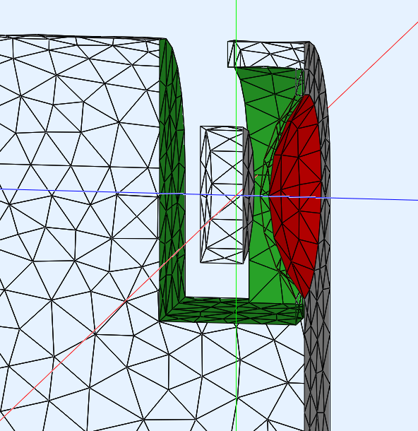

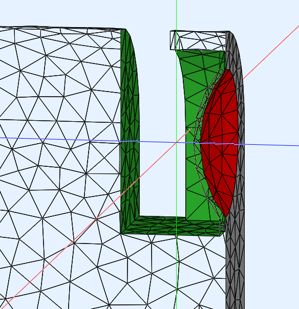

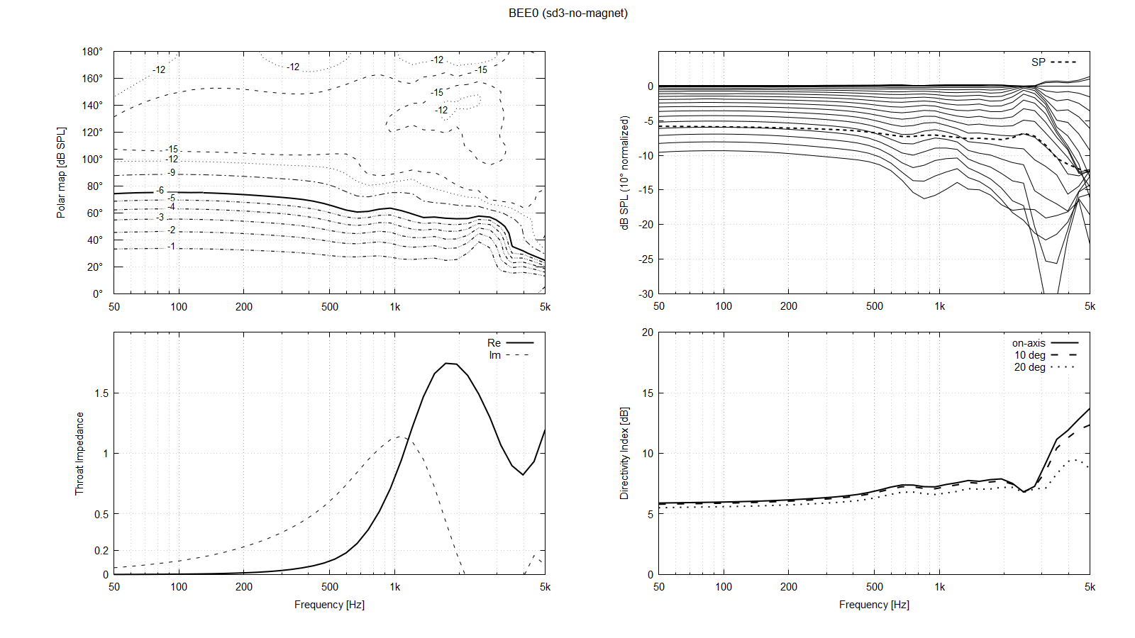

In the meantime I slightly refined the model, divided it into subdomains and tested adding a magnet.
(This is a bit different model than the previous one.)

View attachment 1134155 View attachment 1134156
View attachment 1134157 View attachment 1134158
You can see recent simulations (not final design) of this top module, it will need a bass module, crossed over around 200-300 hz. The design of the box, can be seen in the profile picture, of the poster. It's tiny!
It is possible to do passively, the group delay of a low pass filter matched with the corresponding side position for the cancellation woofer is enough to get a good range of cardioid radiation. It's easier and more tunable actively though.In a case this would be difficult or impossible to achieve passively (with a mere back side damping), I already like it so much that I'm willing to do it actively - instead of the current port opening I would place an array of small drivers. Maybe even that would be possible passively (i.e. driven with just one amplifier channel).
There's a range around 650 Hz where the two sum constructively.
I still don't understand the physics behind these graphs.
To clarify the situation, I played around a bit with simple formulas to clarify at which frequency SPL from two radiating sources (the front and the rear side) exceed SPL of monopole (front side only). I assume for simplicity that SPL of the rear and the front side is eqaul (pf=pb=po), so the total pressure is
pt = po*(exp[-i*fi1] + exp[-i*fi2])
and the module is
|pt| = po* sqrt[(2+ 2Cos[fi1-fi2])]
In order to pt exceed the monopole SPL po, the expression under the square root must be greater than 1,
sqrt[2*(1+ Cos[dfi]) ] >= 1, so the relative phase difference (fi1-fi2) should not exceed 120 deg.
The constructive interference appears when the square root reaches its maximum value which is 2, and relative phase difference (fi1-fi2) is 0 deg.
The destructive interference appears when the square root reaches it minimum value which is 0, so relative phase difference (fi1-fi2) is 180 deg.
Seems that these considerations agrees with your simulated SPL and phase graphs: the phase difference of the front and the rear side reaches 120 deg approx. at ~250Hz. and we can see that above this frequency the cardioid demonstrates SPL gain compared to the monopole SPL, while at the lowest frequencies the phase difference is close to 180deg, so the SPL is considerably decreased.
The second step would be to clarify what physical factors inluence relative phase dif. (fi1-fi2). We have not a lot instruments to influence f1, but f2 can be changed in two ways. The first way is to change acoustic path difference between the front and the rear sides. And a less obvious way is to change the volume of the rear chamber, which is a low-pass acoustic filter, so it also rotates the phase f2.
These will be the initial considerations, perhaps someone will add their thoughts.
