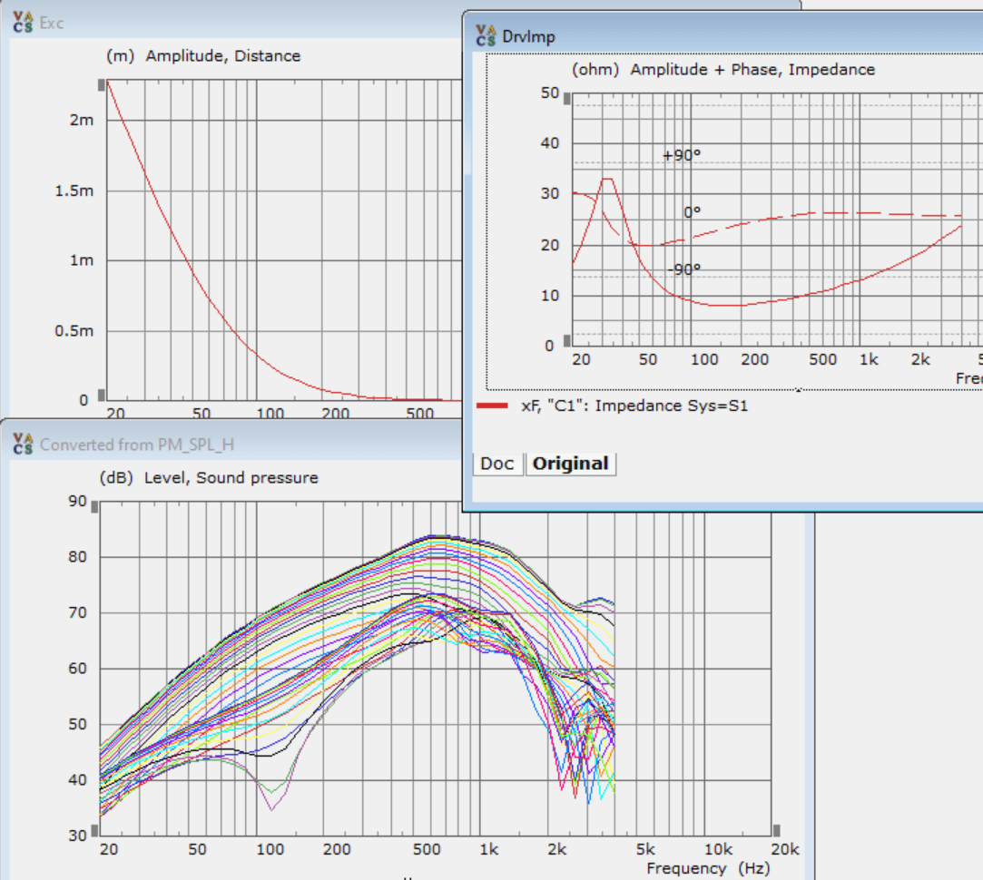

I tried to double the number of mesh elements, my results are virtually the same. The resolution is obviously high enough already.should my vacs plots from unmodified script match your posts ? except for higher mesh frequency
BTW, there should be no need to increase the mesh frequency. Instead, in a case it's too low, increase the model resolution set in an Ath script (*Resolution items).

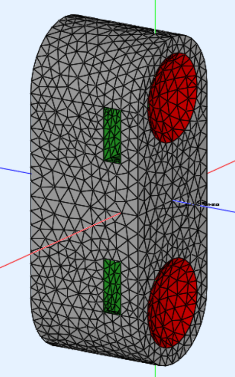

Is there a simple way to script it as an MTM in quarter symmetry?ath.exe update - added option of the closed top, as shown in the above examples (BEE/Port/OpenTop=0):

This is an ABEC project template to put the T-S parameters of an acutal driver in and simulate the real (absolute) SPL levels, excursion, etc. In ABEC, simply set a path to your MSH file from a different project (Mesh files - Replace file...). You can then re-generate your project without affecting this one.

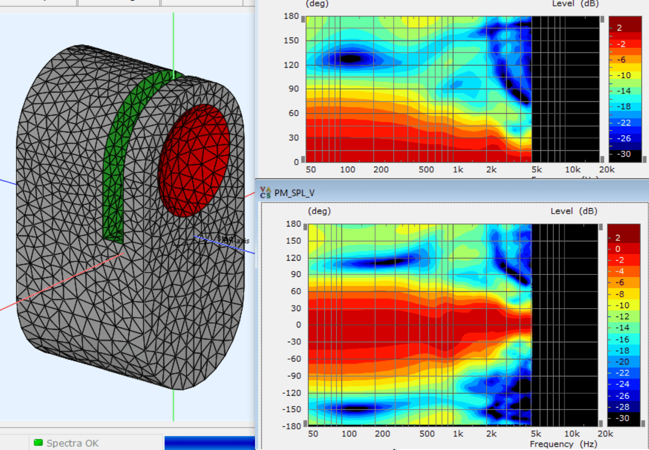

I'm still having (pilot?) errors in duplicating your results.I tried to double the number of mesh elements, my results are virtually the same. The resolution is obviously high enough already.
First try, my mouse skipped and I missed copying the SPL_V section at the bottom of the script and did only a 180 degree version. With that fixed, I get attached results from what should be identical script as you posted yesterday.
I notice that the Y offset in the abec drawing is different. My script has YOffset = -420.
with the attached MabatExampledFixed, my changes to z and w in the dipole opening section seem to be ignored.
Needed a little touch.Is there a simple way to script it as an MTM in quarter symmetry?

Code:
BEE = {
Height = 460 ; [mm]
Radius = 125 ; [mm]
Depth = 250 ; [mm]
Source = 90 ; diaphragm radius [mm]
YOffset = 105 ; [mm]
ZOffset = 40 ; [mm]
Resolution = 25,25,35,40 ; top-front, top-back, bottom-back, bottom-front [mm]
MTM = 1 ; 1/4 symmetry --> set YOffset = Height/2 + Radius
; dipole opening
Port = {
z = 25 ; [mm]
w = 40 ; [mm]
wt = 15 ; wall thickness [mm]
Resolution = 25 ; [mm]
Damping = 0.5 ; interior wall damping
OpenTop = 0
; don't mesh the waveguide
Mesh.WG = 0
; 1/4 symmetry
Mesh.Quadrants = 1

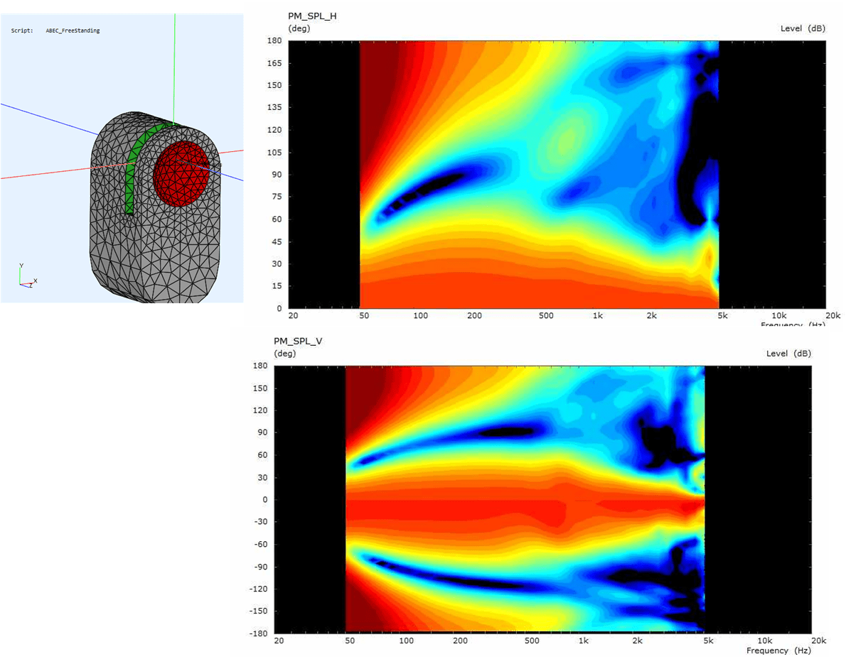

If you upload a complete ABEC project as you have it, I can check that.I'm still having (pilot?) errors in duplicating your results.
You said there's a way that "leads to the desired result more quickly". Maybe we just have different targets, as I'm mostly interested in the secondary effects I think, i.e. in frequencies 200 - 2000 - that's where it's supposed to operate.Generaly speaking, it depend on a shape of the the box. [...] However, this is a second order effect in gradient loudspeaker when it comes to directivity control at low frequencies.
Here it is.If you upload a complete ABEC project as you have it, I can check that.
Thanks.
I was able to reproduce it. Go to Options - Preferences - Processing and set NUC to None, restart ABEC and try again. If that doesn't help, I have no other idea.
