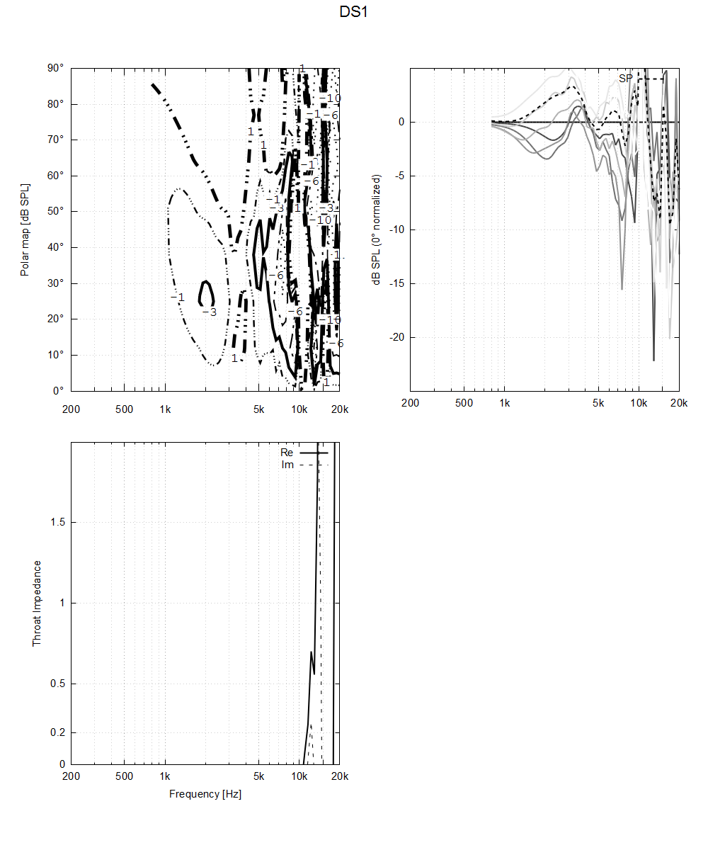

Yes!That's better 🙂
Response looks more similar to EAW's charts now.

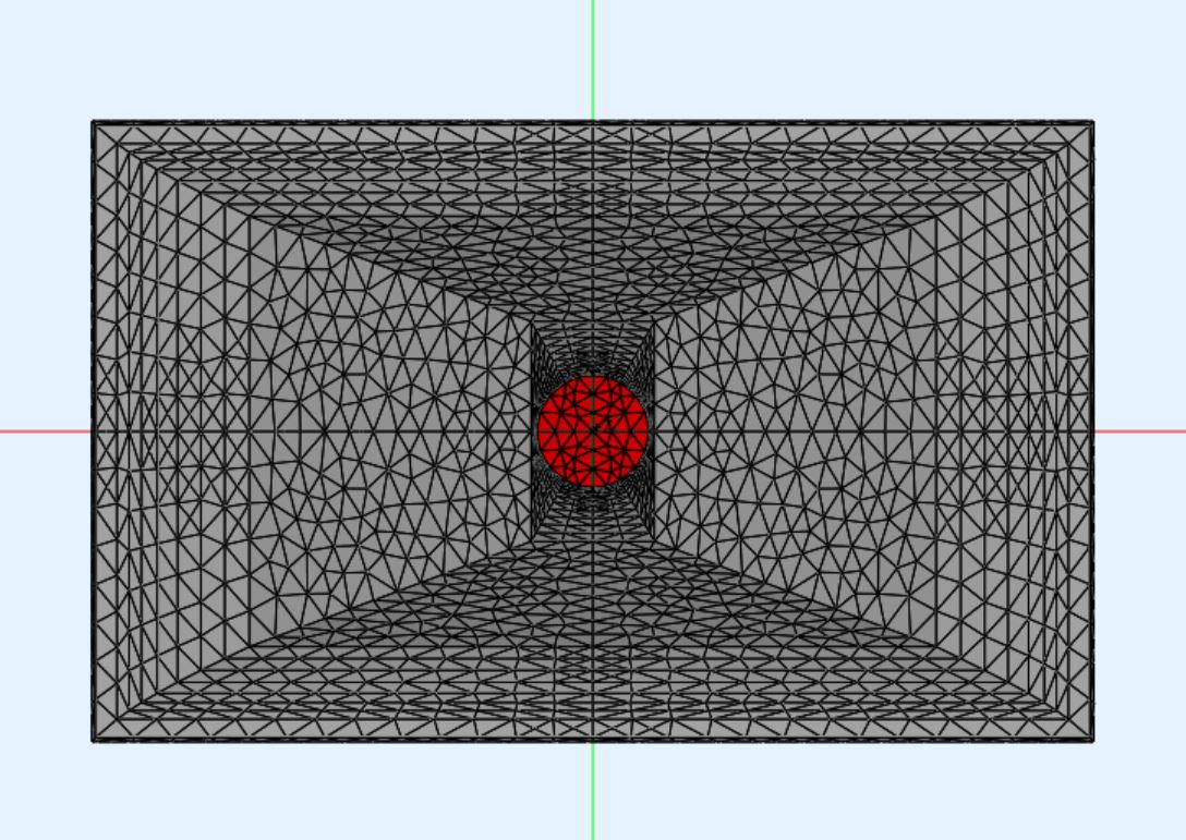

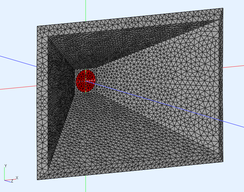

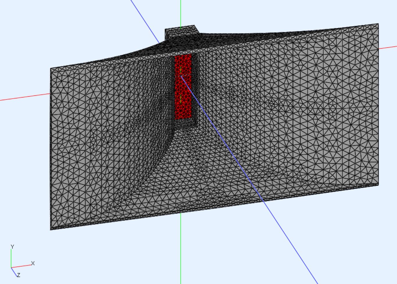

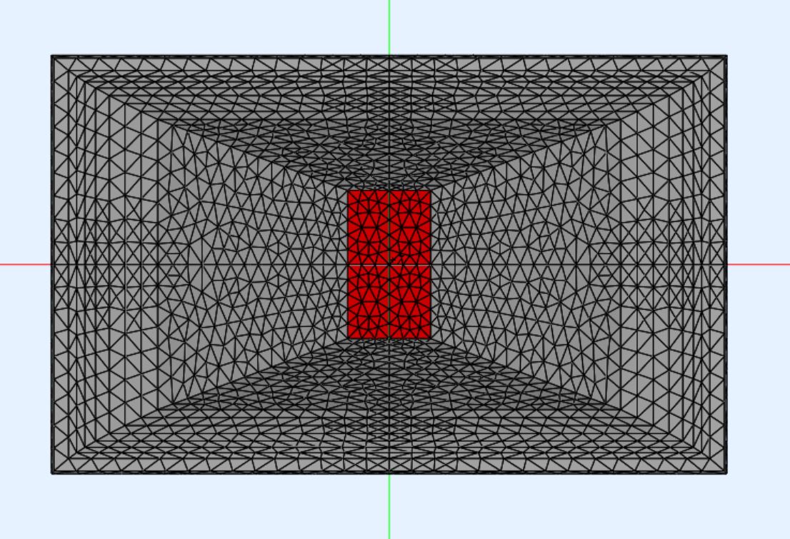

This is how to simulate flat walls with a simple flat driver entry, i.e. without any throat adapter. And of course you can add any number of subsequent horn segments (a better mouth termination) you like (or make the walls of the first part already bended (OSSE), of course).
Code:
Horn.Adapter = {
L = 0
Width = 40
Height = 40
Segments = 1
Horn.Part:1 = {
L = 150
H = {
k = 0
a = 42
V = {
k = 0
a = 30
Segments = 1

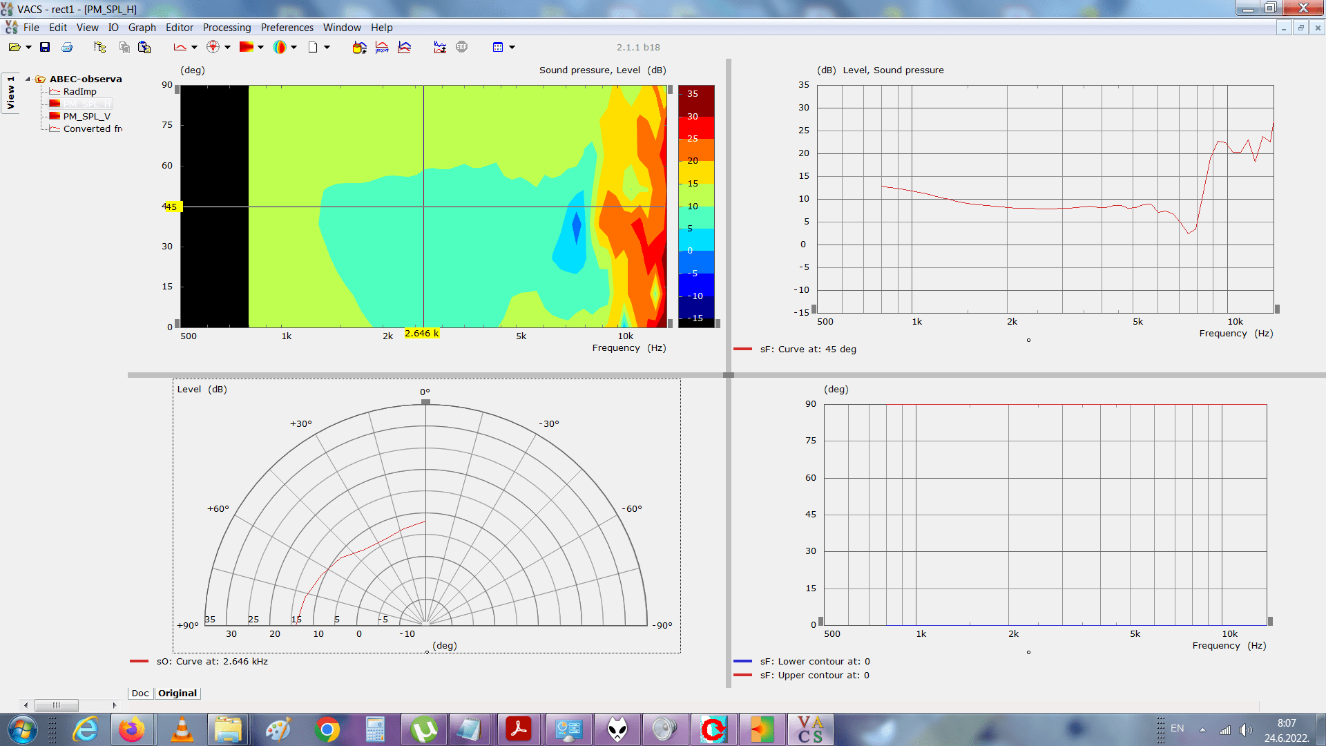

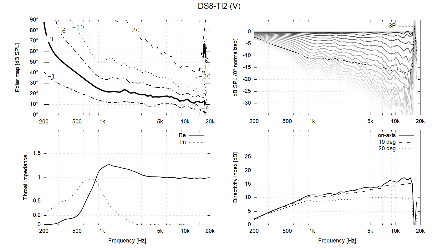

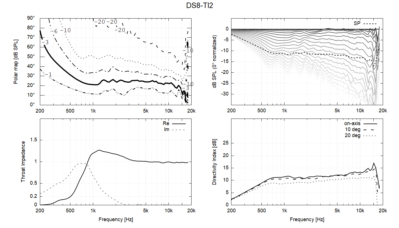

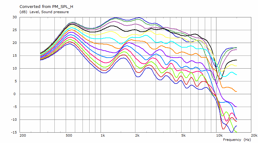

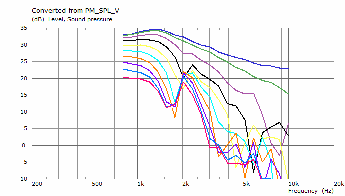

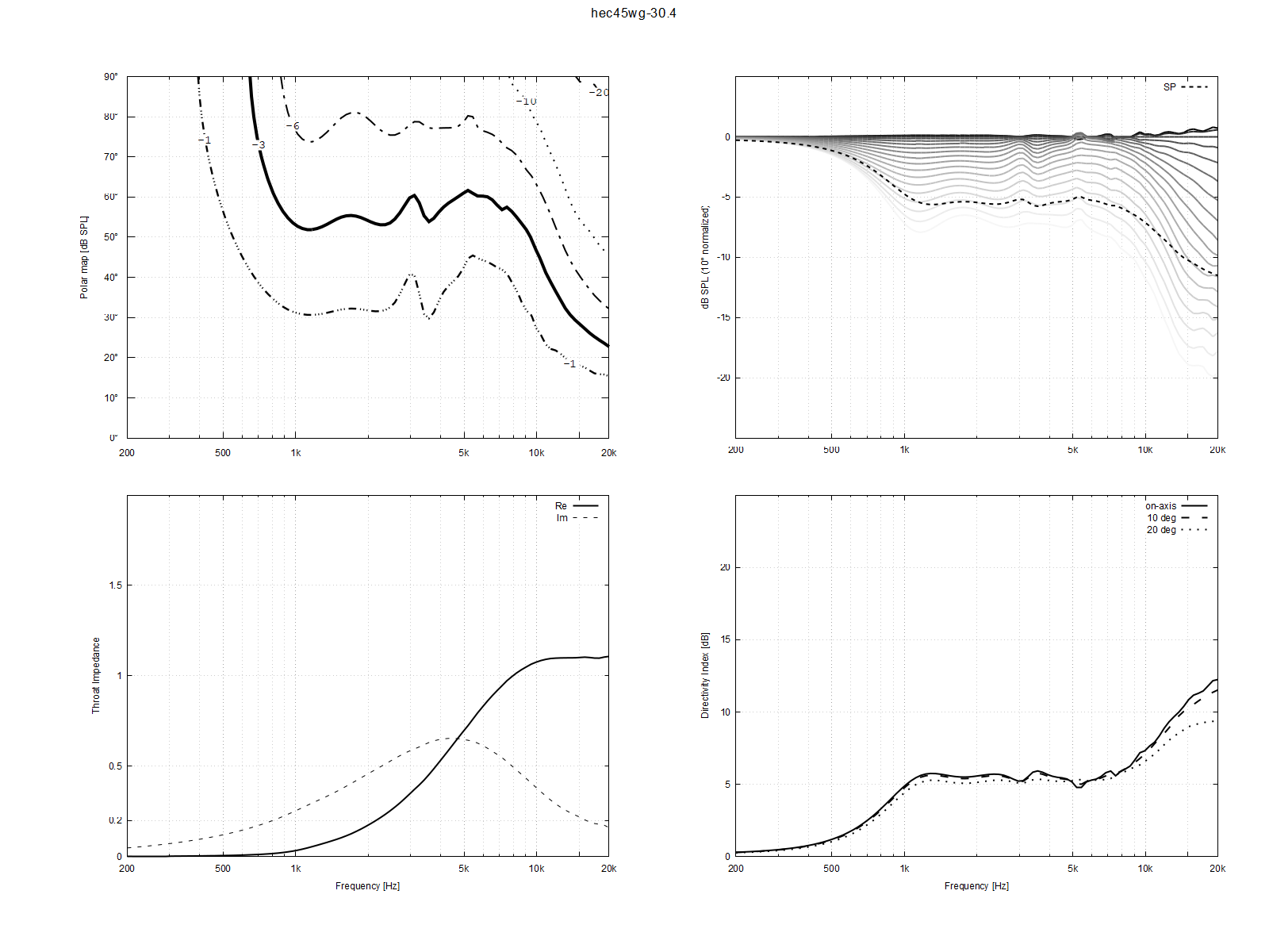

Just for completeness, these are the results -
(1.4" throat, HxWxD = 310x213x150mm, SPL for constant acceleration, polars 0 - 90 / 7.5)
I've tried designing such a device. You may want to adjust the parameters somewhat if you desire more gradually rising DI - I myself wanted to try constant 5-6 dB up to 16 kHz, but was not able to achieve this with a 25 mm dome and simple phase plug. Maybe there is something to be done about phase plug design, or maybe I have to bite the bullet and convert my direct radiating dome into a compression driver proper - with, say, 16 mm exit. Current PP basically does nothing aside from protecting the dome from pokey fingers and providing unusual throat impedance. Last 4-pack is the same WG with phase plug omitted.Can you also do WG/horn that are wide dispersion? If yes, did you ever present such a design here?

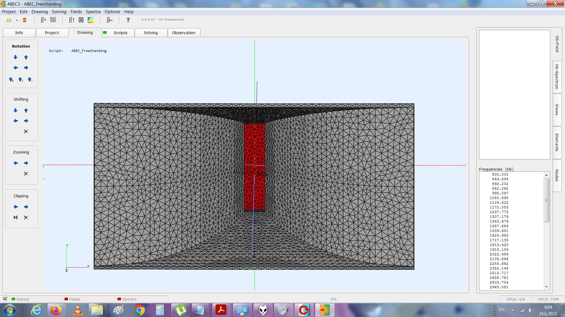

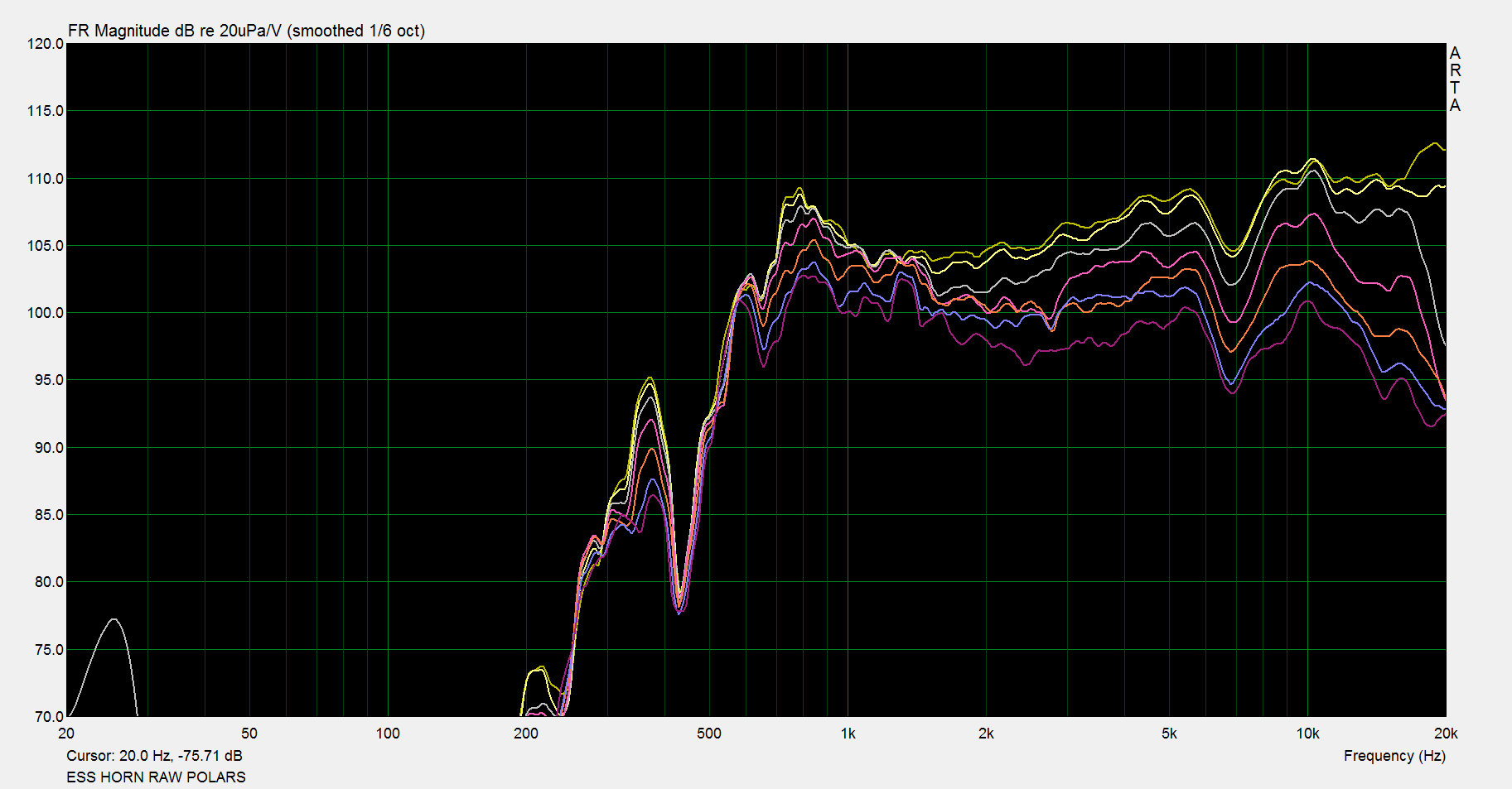

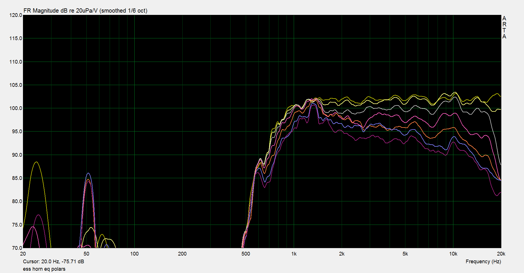

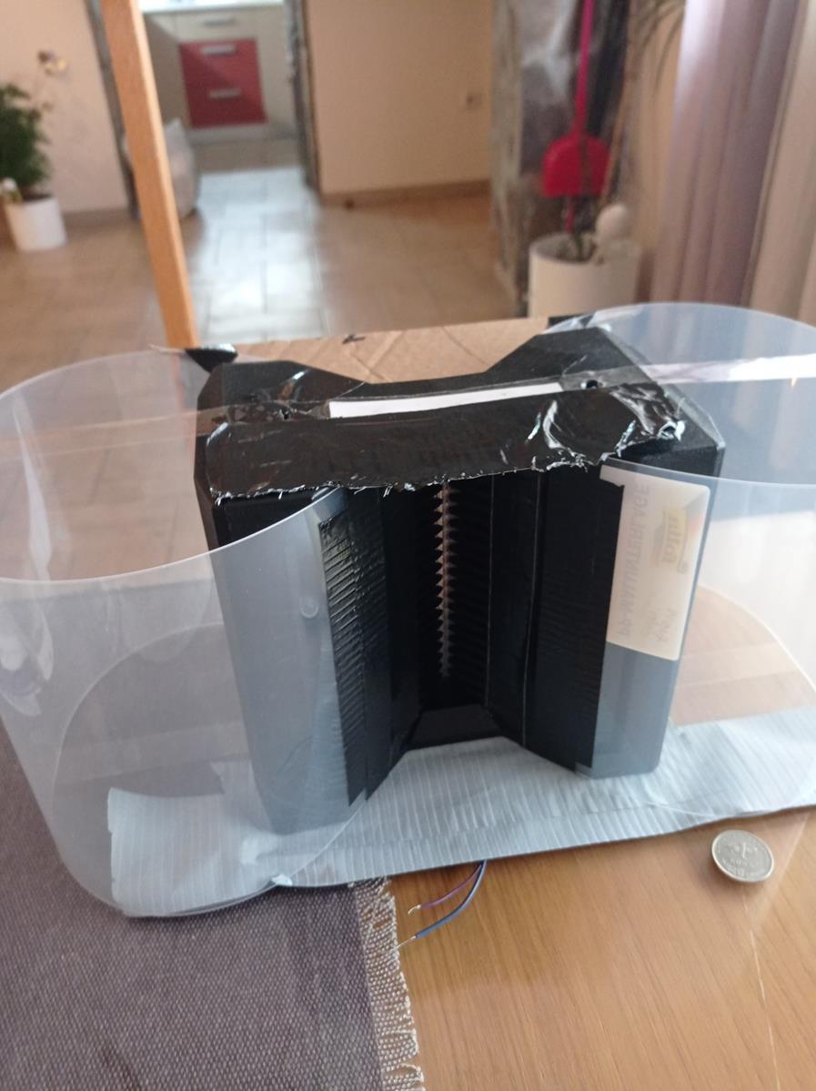

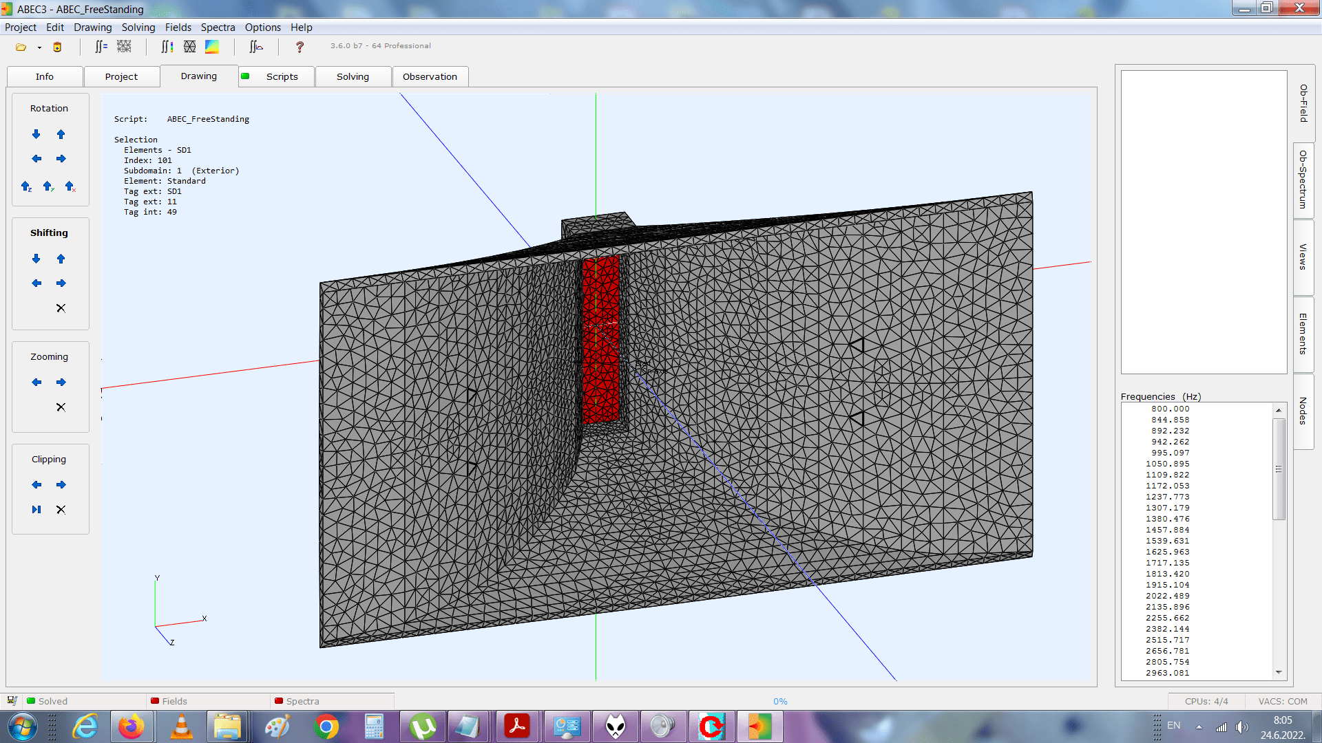

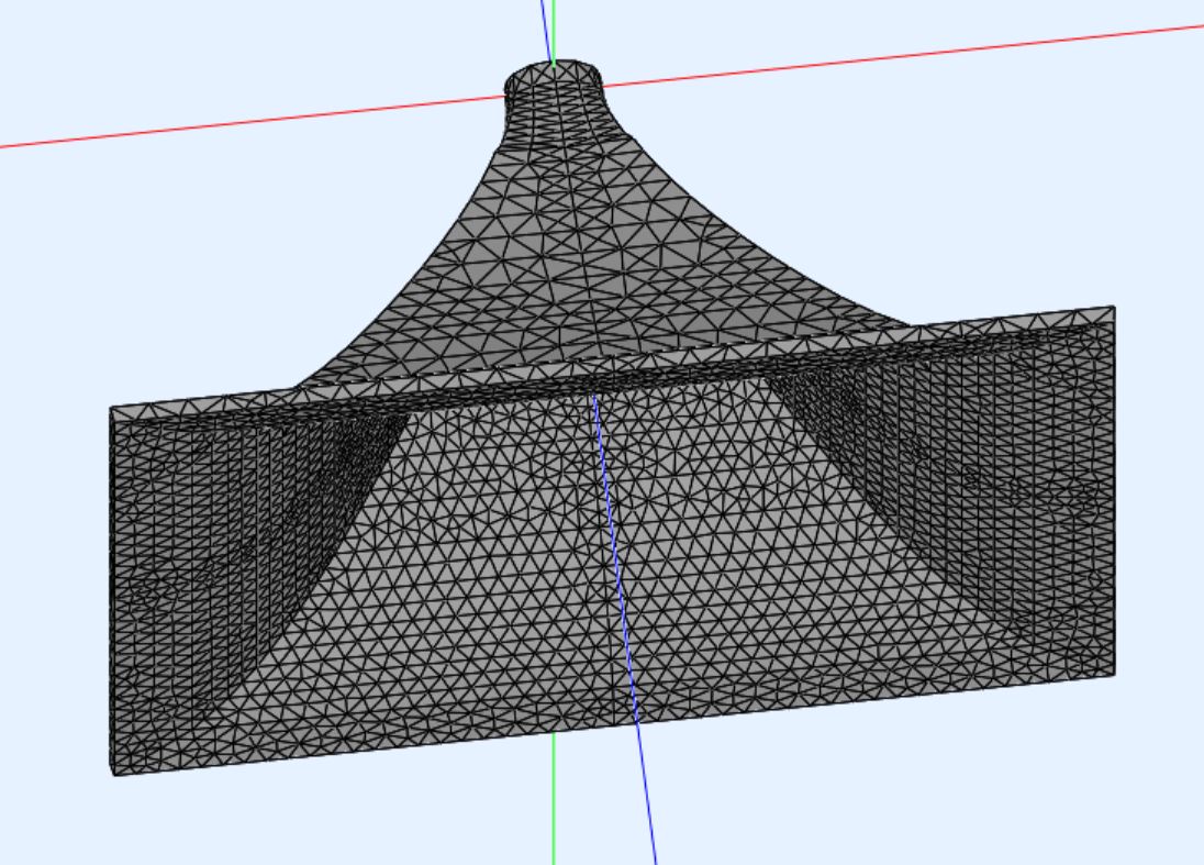

As Marcel gave us oportunity to design WG for rectangular source as AMT is I have tried to design WG for Heil AMT. Still not discover how to design Rollback (if it is possible) but what I get does not look so good.
Of course, I am not sure am I doing some mistake and could it be improved more. Below is attached script so if somebody have a will can check and advise.

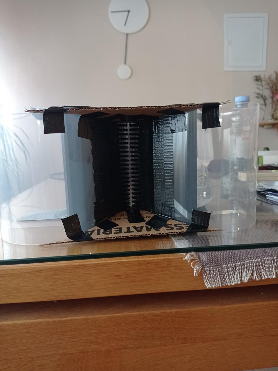

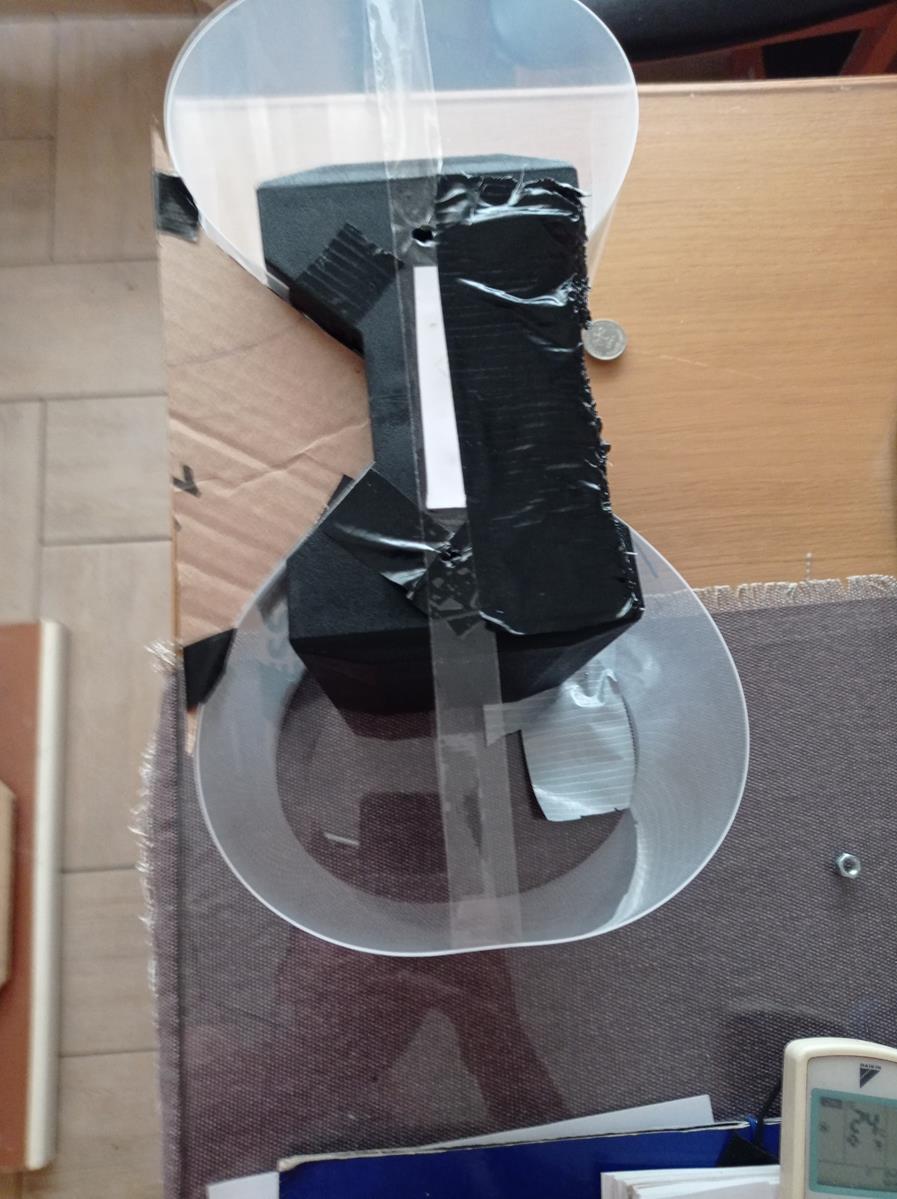

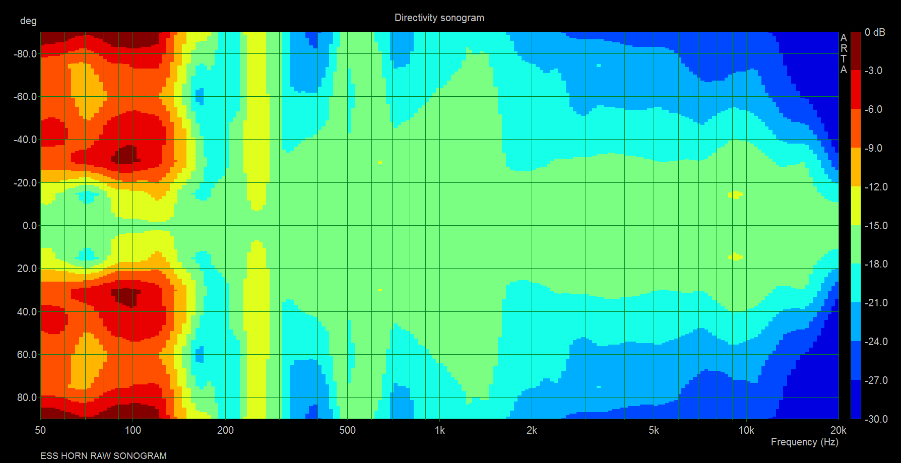

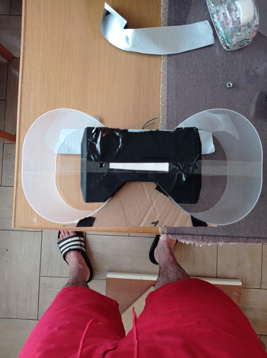

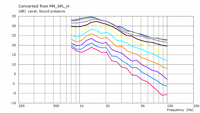

Any way, as I was not satisfied with results I wanted to confirm it in practice. I made some kind of WG arround Heil chasis from plastic folie, cardboard and duct tape. As You can see on photos finish is rough and with several flaws
but measurements are promising. Below measurements are ungated with 1/6 smoothing. First two are without any filters and second two with DSP and HP filter at 1 kHz
WG just follow V Heil chasis walls without any curve. I think with implementing OSSE things will get even better
Nice - cant beat reality 😉
And a more rigid "WG" would probably be a bit better as that will perhaps act as a membrane at certain frequencies...!?

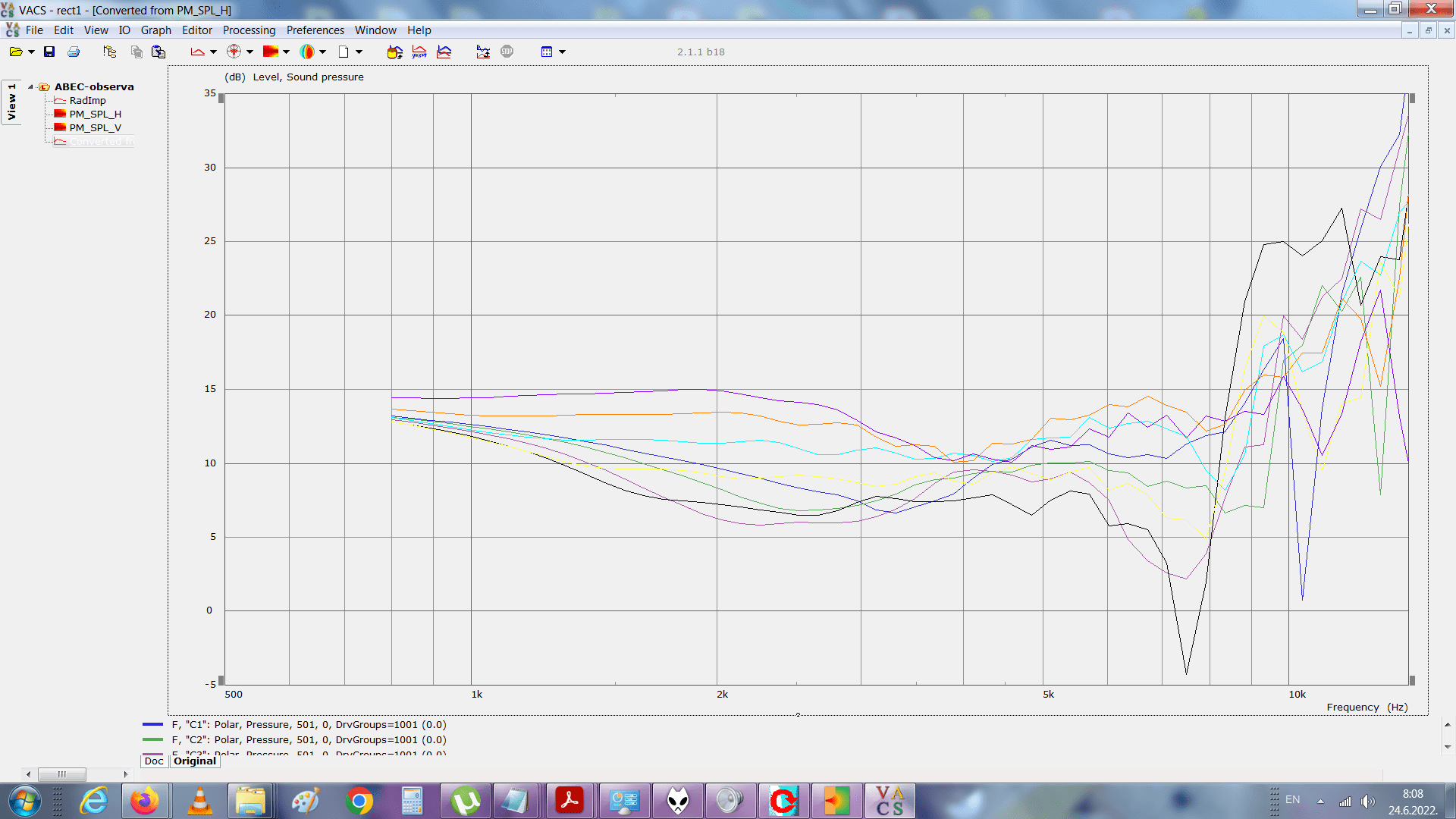

This is what I get with the script provided -
I only changed the 2nd horn part a bit (not sure it makes a difference) -

No, that's not possible at the moment.Still not discover how to design Rollback (if it is possible)
I don't know. Sometimes it behaves in mysterious ways...

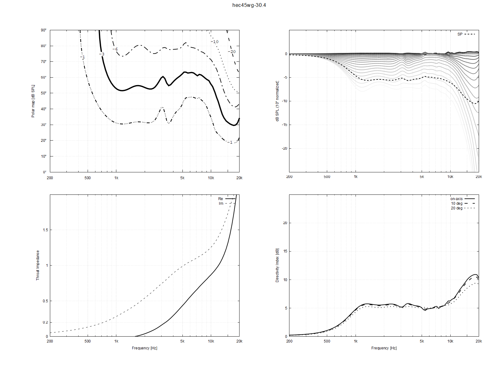

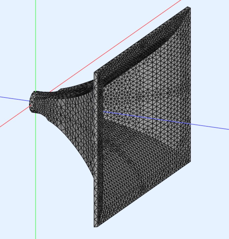

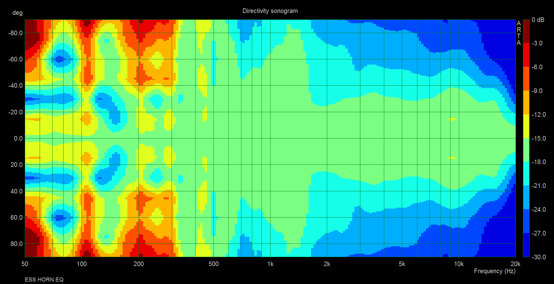

- I have to admit I'm attracted to the 2-profile geometry for a while now. I already have some bendable plywood which seems a great way to make these.

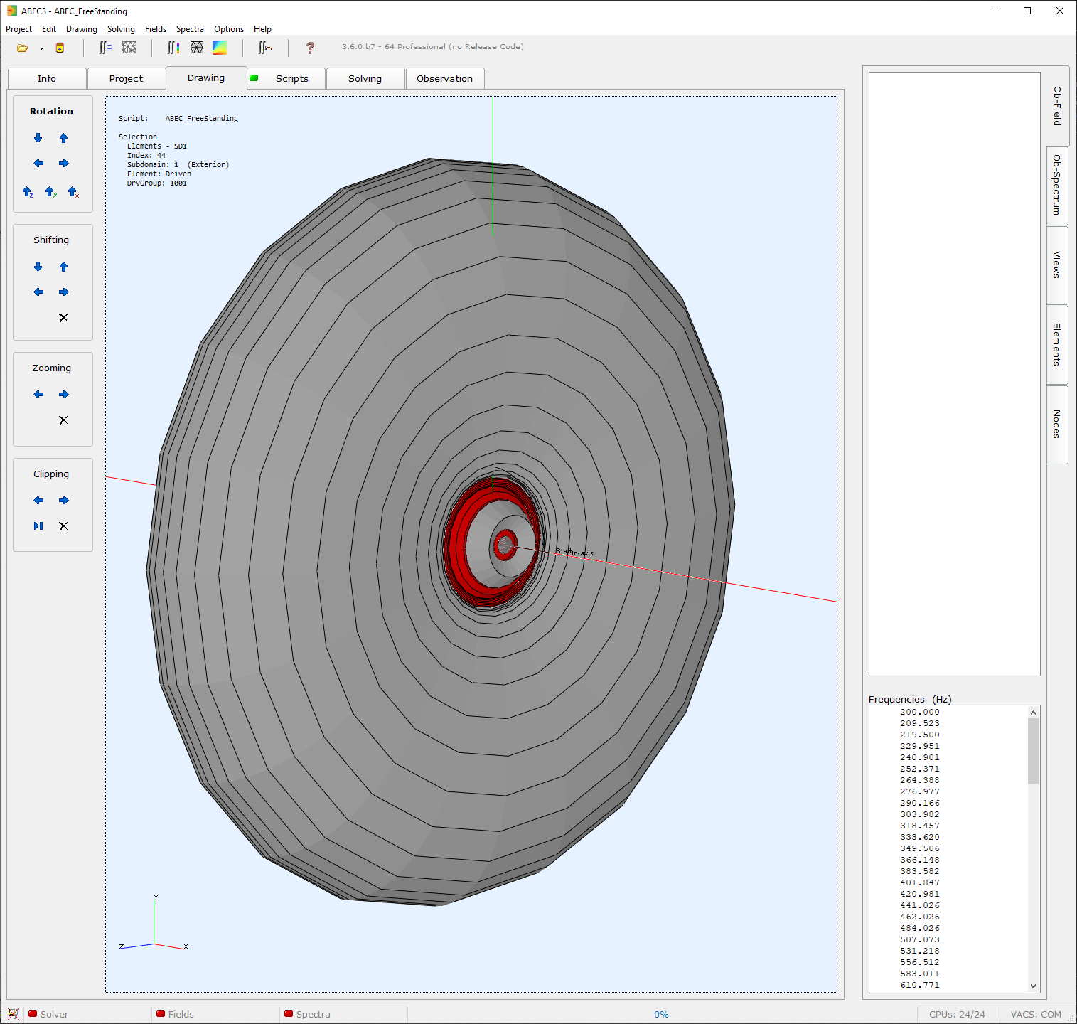

This one is 624 x 448 x 328 mm, 1.5" throat, simulated free standing (horizontal data only):
What happens to the directivity when stood off axis vertical and horrizontally at the same time (due to the square horn geometry)
Say 40 Deg X plain and 40 deg Z plain?
Can you simulate that?
And is that 624mm depth I take it?
I ask because I have a large format laser cutter and an application that fits this or somthing close.
