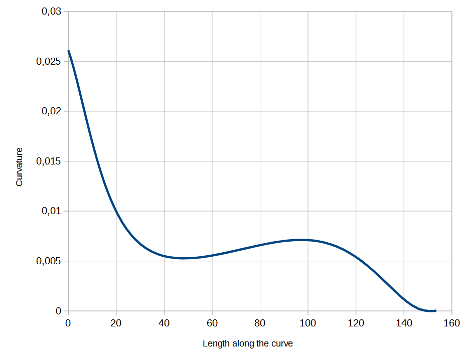

As to the baffle issue, this is the nice property of the OSSE formula - curvature along the curve goes smoothly to zero towards the "edge". It only takes some more space. (This was not the case in the previous example where the curve was cut at the apex, where the curvature is non-zero.)

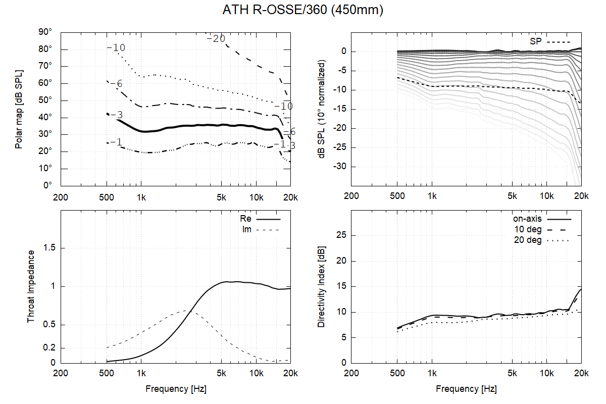

Almost flat DI, nice! I think this flat was not possible with the OS-SE script, all smooth results seemed to end up with steeper slope DI like your CE series. I wonder if the slight narrowing, around 1kHz on this one, can be avoided with flat DI? Although it is mostly outside listening window I think. Lets see after few more iterations
Anyway, nice, it looks like the rising DI part below 1kHz almost exactly matches that of ideal 15" driver.
The question is whether we want it this flat
I think this could be already too (unnecessarily) big for a 15" woofer.
I'm pretty sure it can but probably the overall size would need to increase even further.I wonder if the slight narrowing, around 1kHz on this one, can be avoided with flat DI?

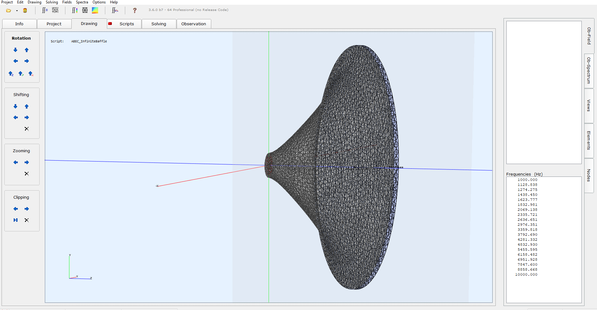

Just requesting the forum members that Im trying to simulate and I have fairly good 12 core 24 thread with 16GB ram and 6GB gpu but the meshing is not happening its at 0% all the time and cpu usage monitor shows 0% usage. What could be wrong? Can anyone please help me. I am loving the easy way of ath horn but im unable to use it. I have gone through the documentation but couldnt find this problem. Can anyone please help me. I need to build the horn for my tweeter.View attachment 1017946
Im able to get this now How to see the polar plot and the frequency responses can you please help me.

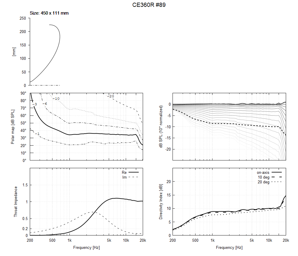

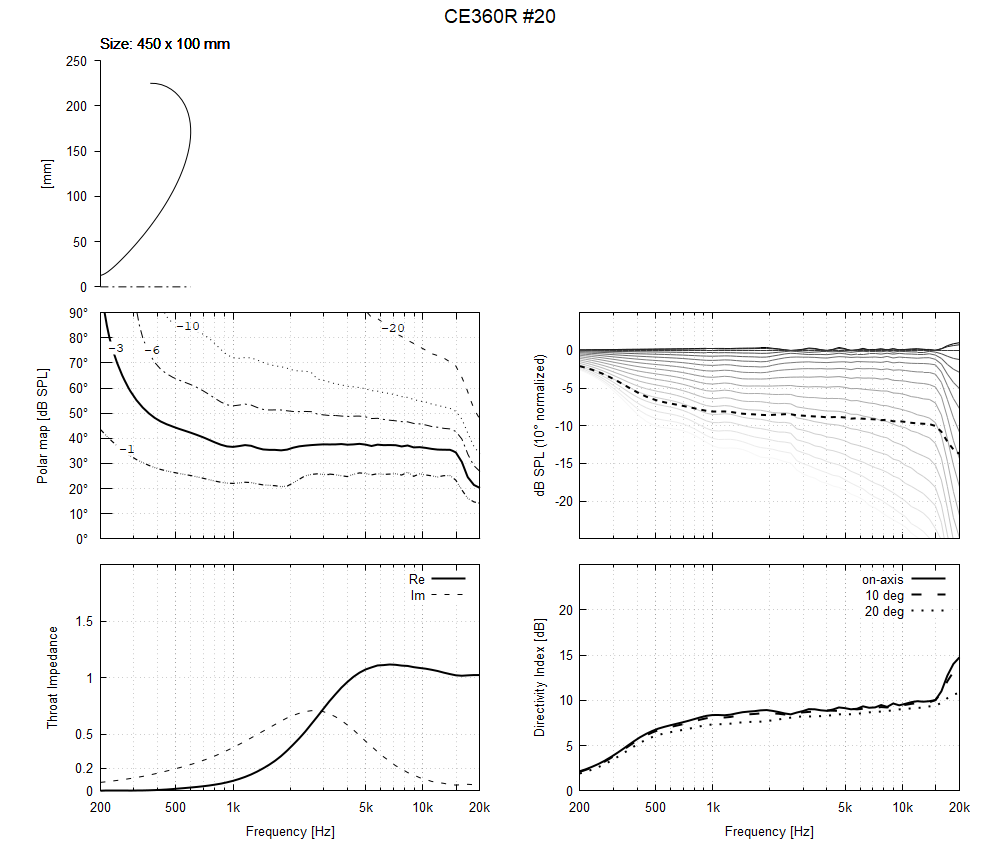

The first batch of 100 random mutants: http://at-horns.eu/gallery/opt6.php
Some of those are already pretty good.
The great thing about the parametric description is that one can set the overall radius as fixed. This was not possible before.
#89:
There's something magical about this shape.
#20:
This seems to be the limit of what can be achieved with a 450mm waveguide.
#89:
#20:
