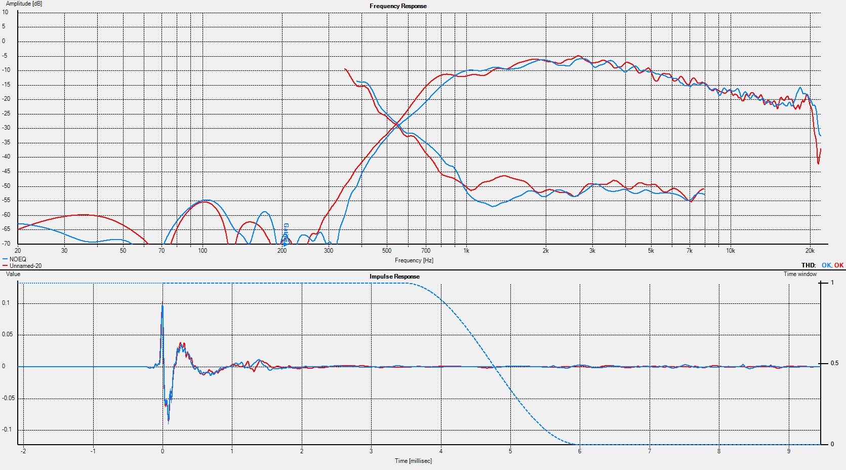

I printed a 1" scaled version of the 4 fane plug on my 0.2mm nozzle and tested it against a similar size horn.I still have to make a horn for testing. There's always something else one has to do...
Blue is a straight up axisymmetric OSSE, red is the throat plug cousin.
The secondary curves are THD plots
It's interesting to see how the plug gracefully deals with the breakup at 18.5kHz and improves loading and thd in the 700hz region
As a side note I have to meantion that there was a bit of stringing on the phase plug print (which might act like dr. Geddes' foam)

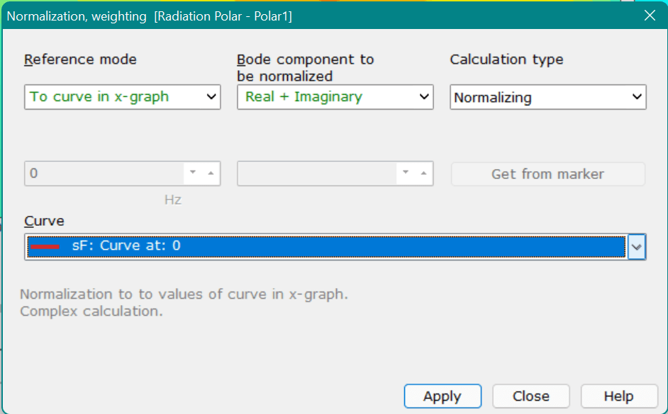

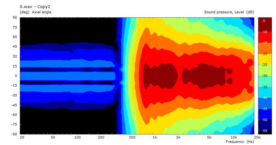

I'm trying to compare simulation vs measurement contour plots. I get weird results when I try to normalize my measurements in VACS, therefore I EQed in order to get a more or less flat response.

Those are interesting results. I suspect that the throat acoustic impedance has a large peak around 700 Hz and gets quite low above that (which would indicate quite a strong reflection at the plug/wg interface), otherwise I have no explanation for the behaviour shown. With four vanes I wouldn't expect such clean response at high frequencies, you obviously managed to print the walls thin enough. Great contribution!

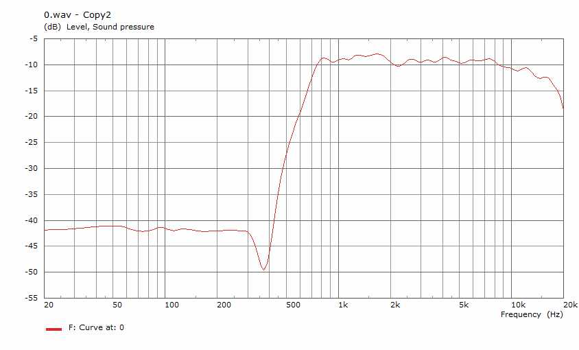

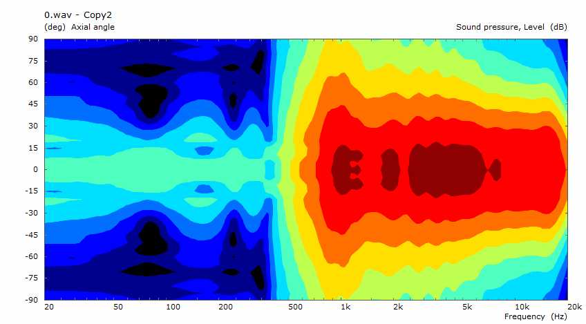

Here are the measurements,
However when I import them in VACS, and do the fourier, the graph seems a bit different...
And it's with more or less the same window
Make sure you select the 'curve in x-graph' as the reference mode, with the degree marker set to zero. Luckily, I already have this in my clipboard from posting in another thread 🙂On as side note:

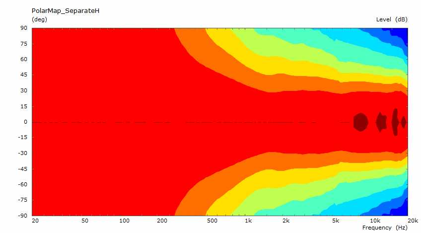

Thanks, that seems to work marvelously at HF. I would be especially interested in a comparison with a 1" throat without the plug.Here are the measurements

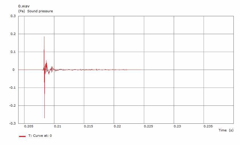

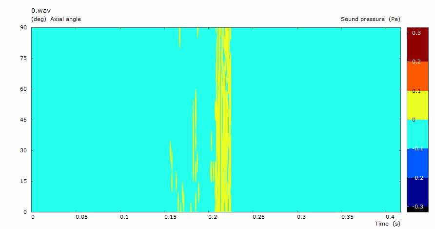

There's some reflection at 1.2 ms but probably it doesn't affect the results too much.
