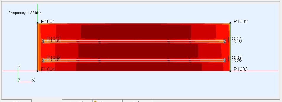

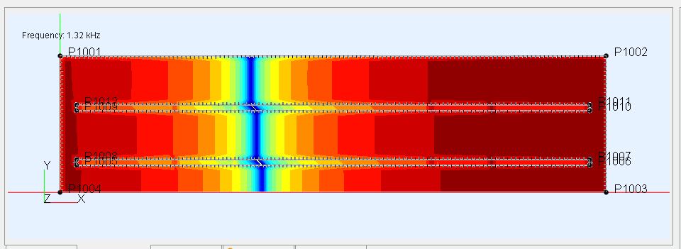

This is just a straight pipe that is divided.
One side is a plain source, the other side is an interface to an external doman that is 100% absorbent (as suggested earlier)
Example 2 is the same straight pipe with dividers, this time terminated by a reflective end located in the same domain.
You can notice that the edges don't match

There are no such obstructions in what I posted. In my case there are three completely separate interior subdomains....but here you guys are simulating interior obstructions that are very small.
So what's the conclusion about the tube case? (What aragorus shows is axisymmetric, i.e. we are looking only at the "upper" half. I'm not sure about your model.)
Cool, that makes more sense. However, those separate subdomains have edges that are quite close together.
I'll try and import the ABEC script, and run it in COMSOL too.
The tube comparisons seem to show that the AKABAK/ABEC version posted by aragorus has leakage into the dividers. Even if those are set to be a blocking element in the same subdomain, for the BEM calculation to be considered accurate at those scales we should see a value that is close to zero inside those areas.

What we see on the images posted by aragorus is a very high level inside the dividers, relative to the areas outside of it.
I think aragorus has defined a single element plane using all four corners of the main tube nodes. From my understanding of BEM, this causes the code to solve for all points on boundaries within those corners first, then it moves on to the other elements' boundary points.
It then probably tries to fix it by comparison with the larger element's data for inside the dividers, since they're coincident. That's done via the very intensive matrix multiplication which requires lots of RAM for complex models with lots of mesh elements.
There's a small chance that it's getting confused with the smaller elements being close together in miero's examples above 1 kHz.
Here's what happens in AKABAK if I recreate my 100 mm tube in 2D mode. NUC is off, mesh size is 1 mm for the domains, and 0.5 mm bifu with quad ratio = 4 for the observation field.
First up, defining a single element using all four tube corners "1001 1002 1003 1004", then adding the separate driven and anechoic termination (Damping = 1) elements:
To me, it looks like it's adding the values from the calculations from points on the damped element to the reflective element, as a matrix multiplication?
Correcting the elements to create two planes using nodes "1001 1002" and "1003 1004" for the tube outer walls gives this:
Rigid reflective termination, same order - single plane for tube walls first:
The latter set up in each case more closely matches the COMSOL model.
Also interesting is the calculation times. Each of those AKABAK models took over a minute to run for a single frequency, but the COMSOL equivalent in FEA took less than a second - even when I ramped the mesh detail up to 1 mm edge length maximum, using triangular elements.

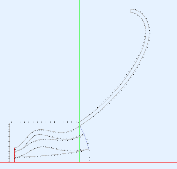

Are you able to share the 'tulip' style horn geometry as some form of CAD file please @mabat? It's a bit cumbersome redoing all the geometry by hand from the Nodes.txt.

DXF examples attached (exported from Fusion 360, contain splines so may not be readable everywhere).
