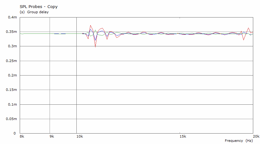

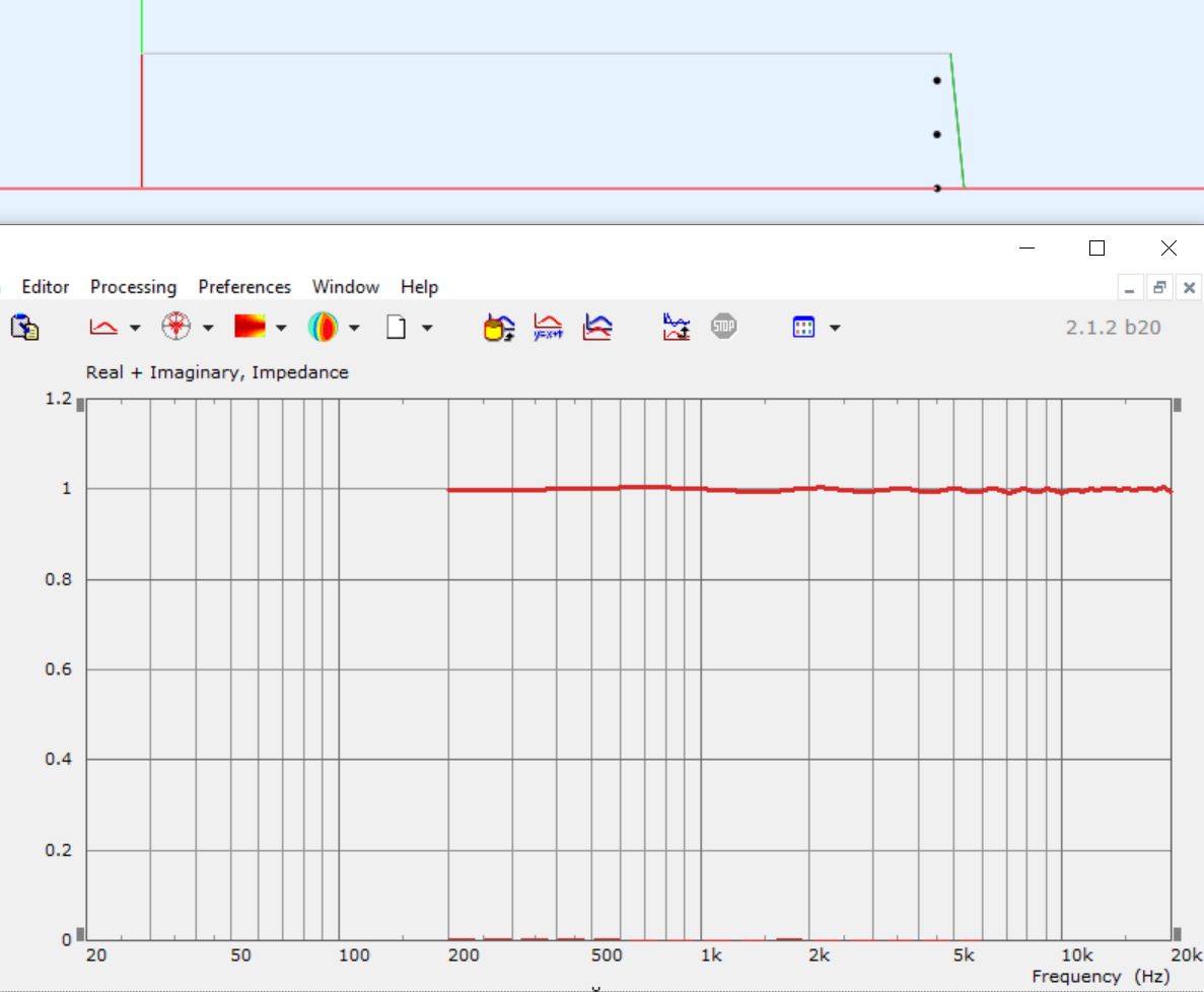

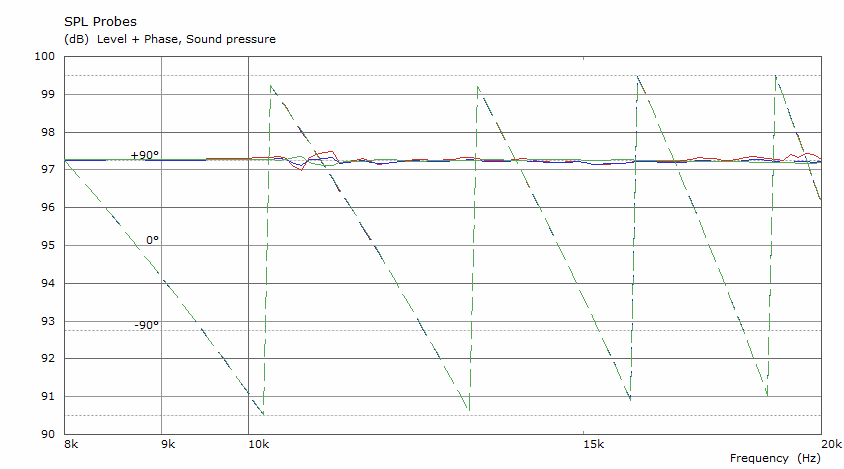

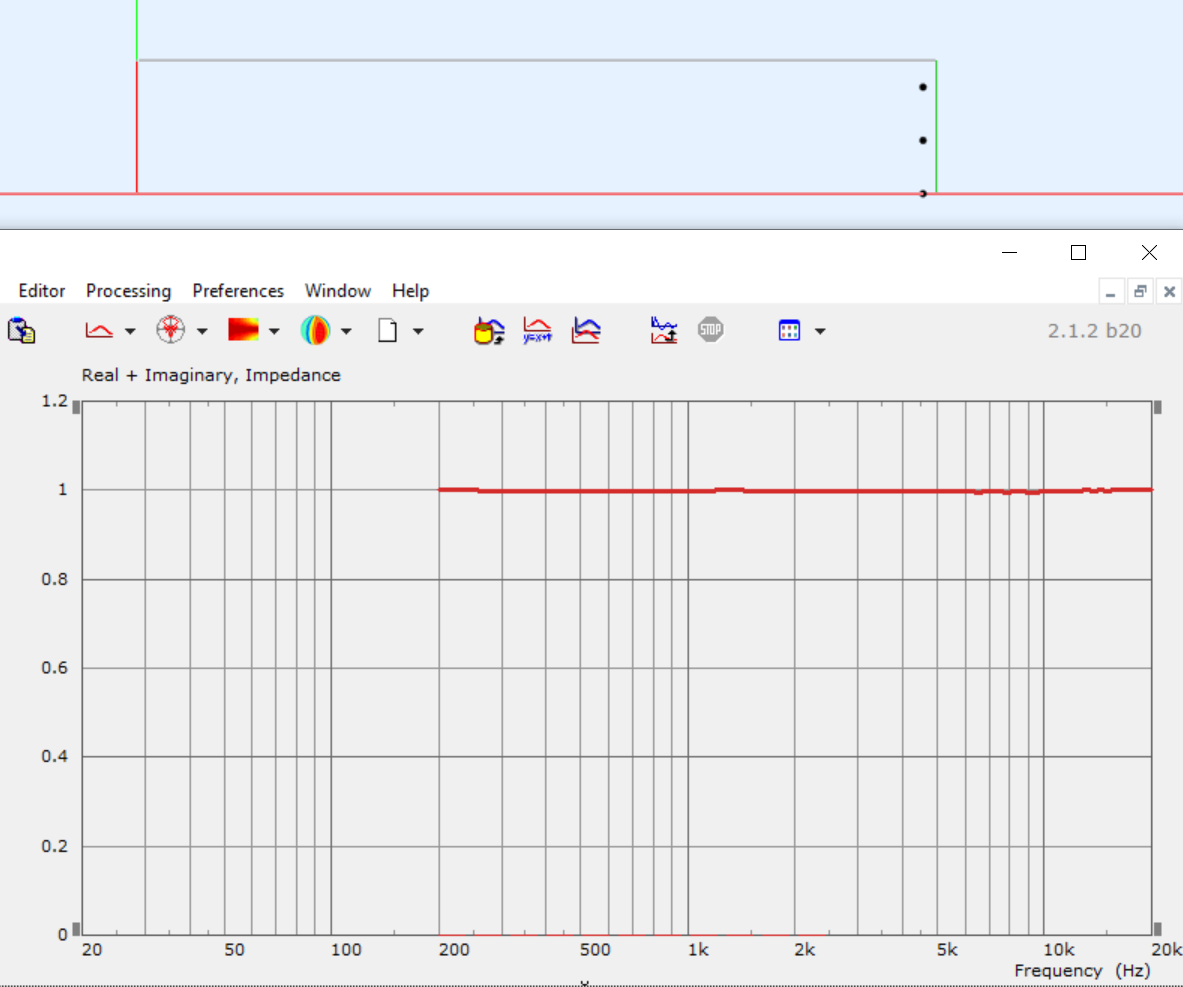

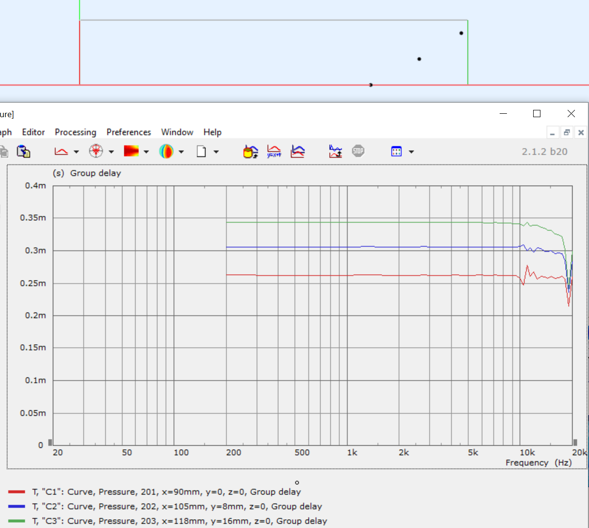

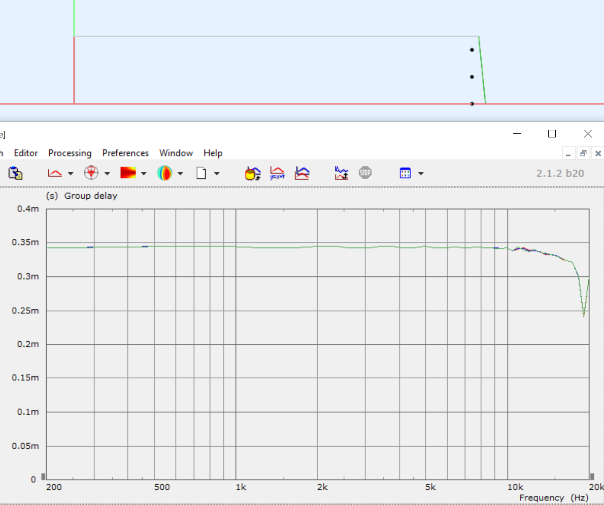

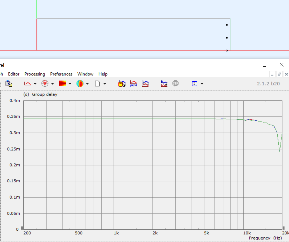

The travel delay at the end of each channel can be observed easily, see the pictures below. Simply terminate each channel with an absorptive element (100% damping). Even if the terminating element is not matching the velocity exactly, the error is still very small -
(The observation points are 118 mm from the source, i.e. approx 0.34 ms in time, which is shown in the group delay plot.)
I think that will be some side effect of the simulation setup. Nothing real. It's not perfect...
It's obviously related to the extraction from phase data - if I increase the number of points in that frequency band, it goes away (there are still some ripples, probably related to the dimensions of the tube, as they don't move at all) -

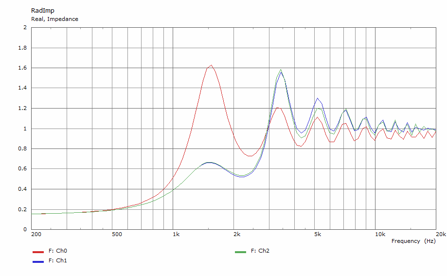

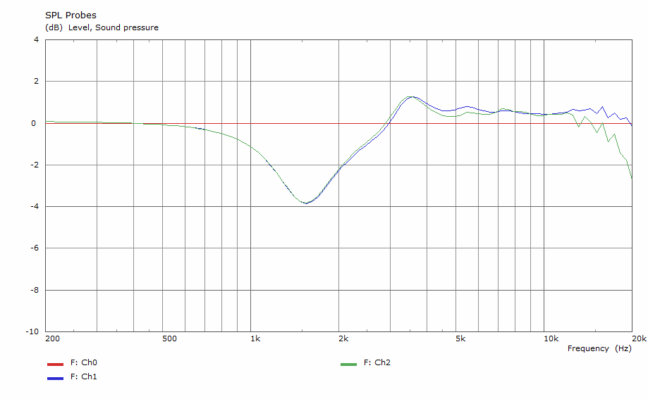

- Now I'm still trying to come up with some simulation framefork that would be useful for optimizing these things. I'm still not sure what to take away from the closed channels scenario, nevertheless here is a one more data set (channels terminated by a damping element) - I added pressure probes at the ends of the channels. Perhaps the bending has quite a big effect on acoustic impedance? (I believe that the wiggle is due to the wall impedance termination.)
Ch0 = center channel (SPL normalized)

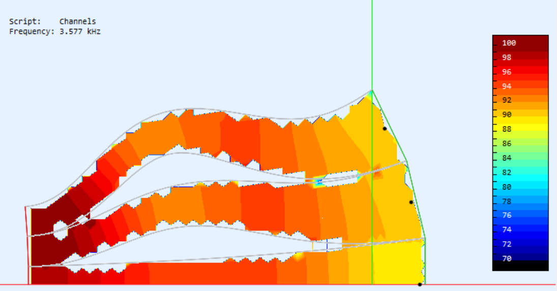

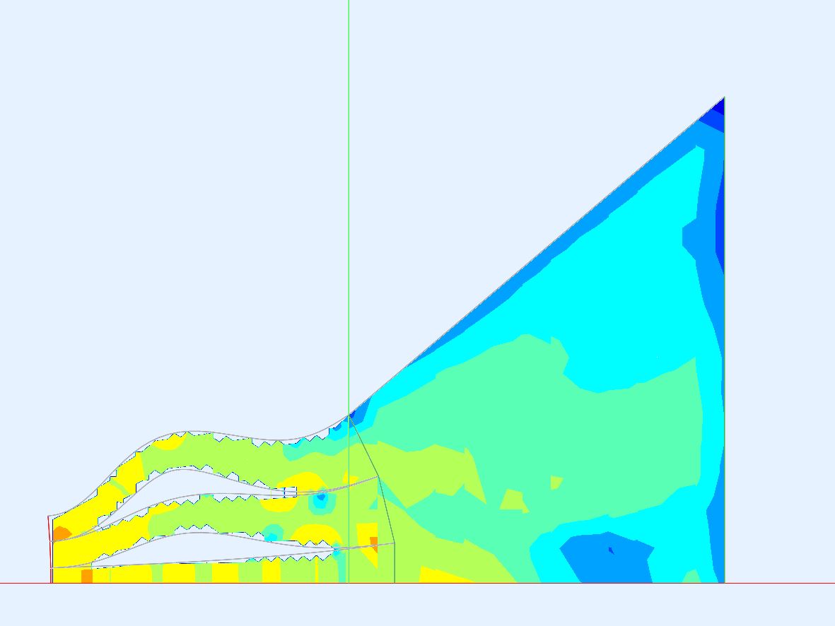

Sometimes it becomes utterly mad. Can we believe it?

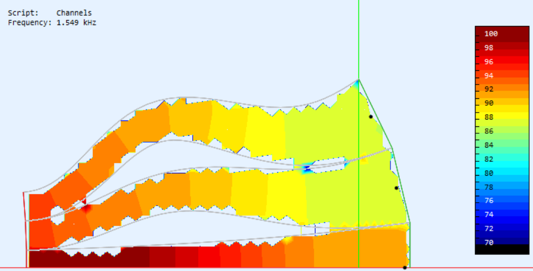

I'll have to work on it now, this was still only a quick&dirty try.
For absorption I'll need the terminating caps I guess.
I think this is the thin shape breakdown problem in BEM manifesting itself. If you look at the mapping of the fields, there is ‘leakage’ between the channels of the device.
Akabak has a dedicated non-uniform compensation option to try and resolve this, not sure if that’s in ABEC? It increases computation times and isn’t perfect, but might help.
The alternative is to simply use a scale model. It’s perfectly valid to do so, and will improve render times as well. If you blow the model up to a 10x scale, then you can modify the plots in VACS to see the behaviour at higher frequencies.
For what it's worth, tools like Siemens Virtual.Lab and it's hosts offer multiple types of BEM, as well as FEA and ray tracing to get around the different issues of standard BEM codes. Ansol Coustyx has seperate BEM codes for low, medium and high frequency, as well as fast multiple implementations that reduce sim times dramatically. It looks like that allows models with 100,000 elements to become feasible to render.
I'm curious what ABEC/Akabak uses at the backend, code wise. I know it's an indirect method only.
Anyway, look for the NUC option and try that. Otherwise magnifying glass time.
The other issue is the emulation of a perfectly absorptive or perfectly reflective rigid termination across the mouth of the device. For the former, an infinite baffle mounting and an interface to the external domain should be equivalent to a fully absorptive layer for the most part.
A rigid reflective termination will of course put a lot of reflected sound back down the channels, and their shapes will cause that to behave differently. It's a place where I wish you could plot isocontours of phase in 3D in this software.
