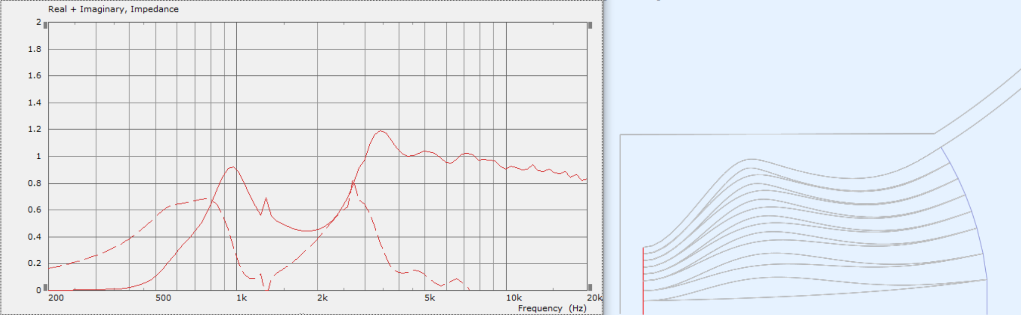

Yeah, that's very very similar - I could well get to something quite close I suppose. Why did you take the fins out?
- My basic understanding is that less energy is radiated into farfield and more is stored in the medium within/around the device. But how that works in this case, I have no idea. It has to do something with the bending 🙂
2-inch throat, 4 channels, the whole device is ⌀350 x 185 mm 🙂
- Time to print and test some of it, I guess.

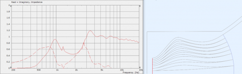

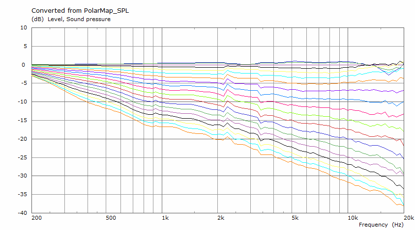

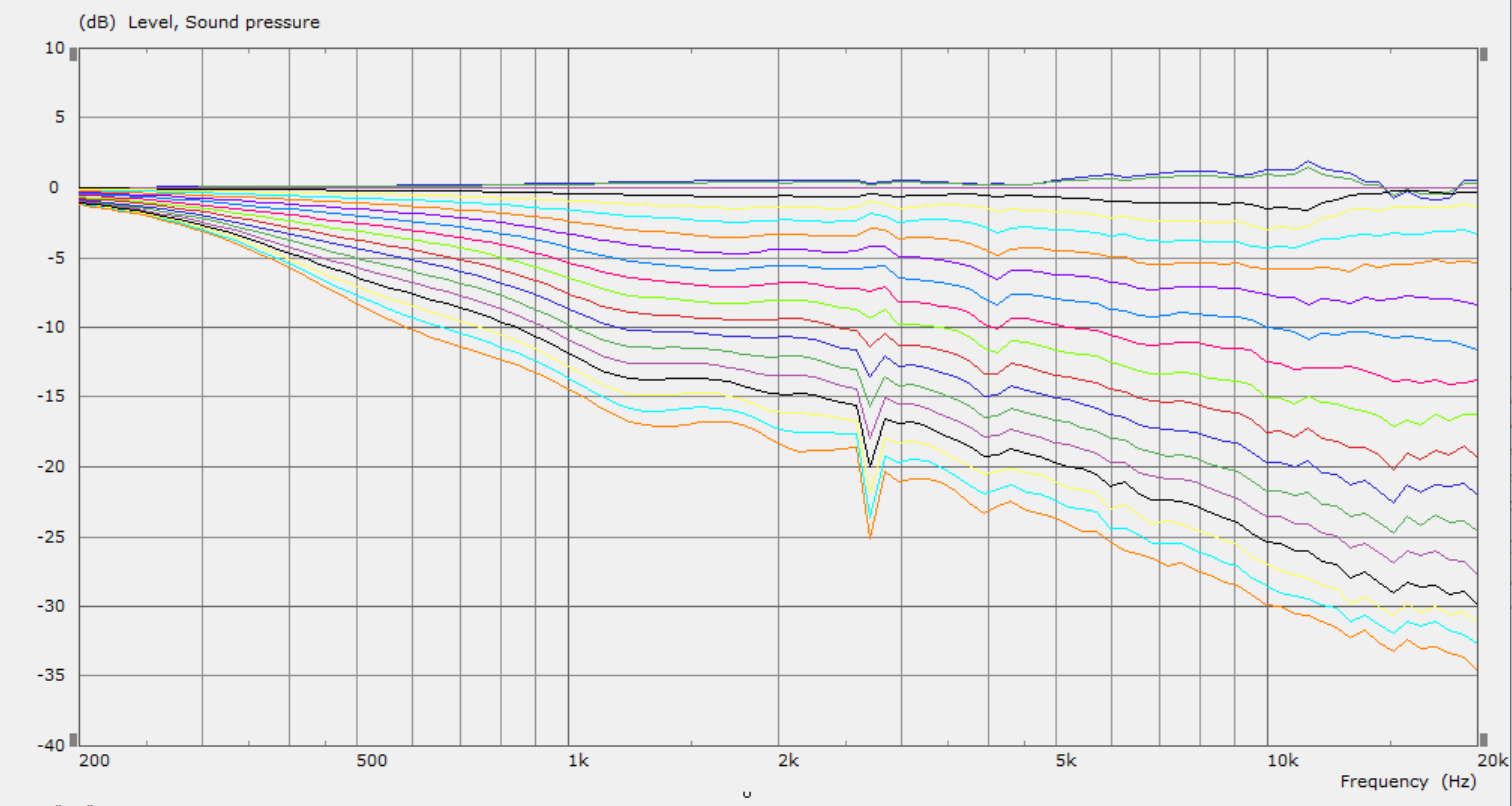

I was trying to simplify the model to avoid crossed surfaces as the first try seemed weird with them, most of the unexpected RadImp didn't change.Why did you take the fins out?

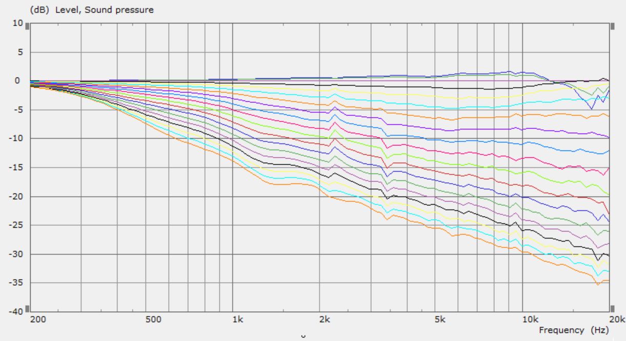

Don made a more conformal simpler mesh and smoothed the RadImp which gave this
nice! claiming the promise. Top octave looks like it was 1" throat! Surely time to print and measure before optimizing further. Really cool!
I don't have an explanation but I see something very similar in a simulation I have been running trying to model a Yuichi A-290, when I take the fins out. A peak at a lower frequency which trends back up.
TAD TH-4001 has similar problem with radiation impedance irregularities.

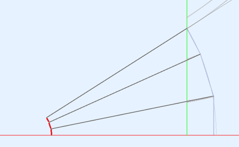

It's actually better than 1" throat. Well, at least in simulation. Typically a 1" throat loses it around 15 kHz, both in theory and practice (2" around 7.5 kHz). This is not the case with any of these, which is of course due to the spherical driving. Now the only question is how close can we get with a real driver. The cleaner the exit wavefront, the better.Top octave looks like it was 1" throat!

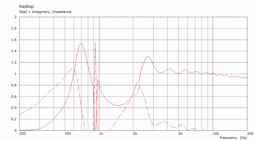

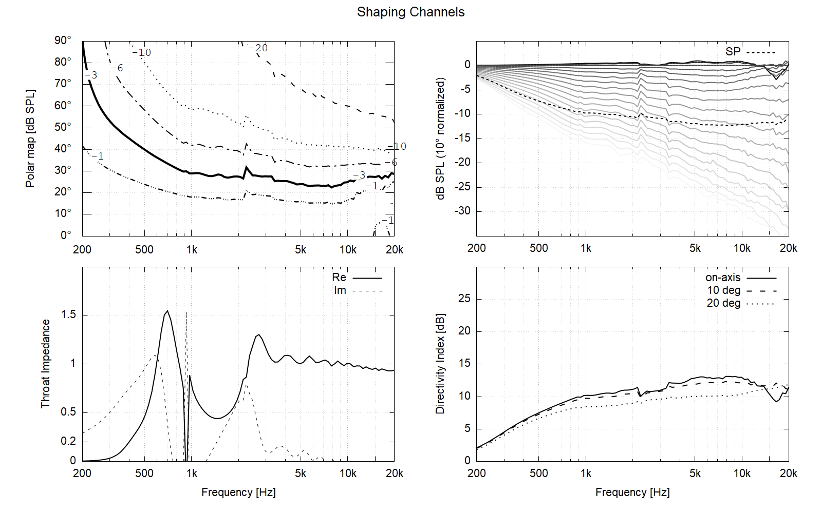

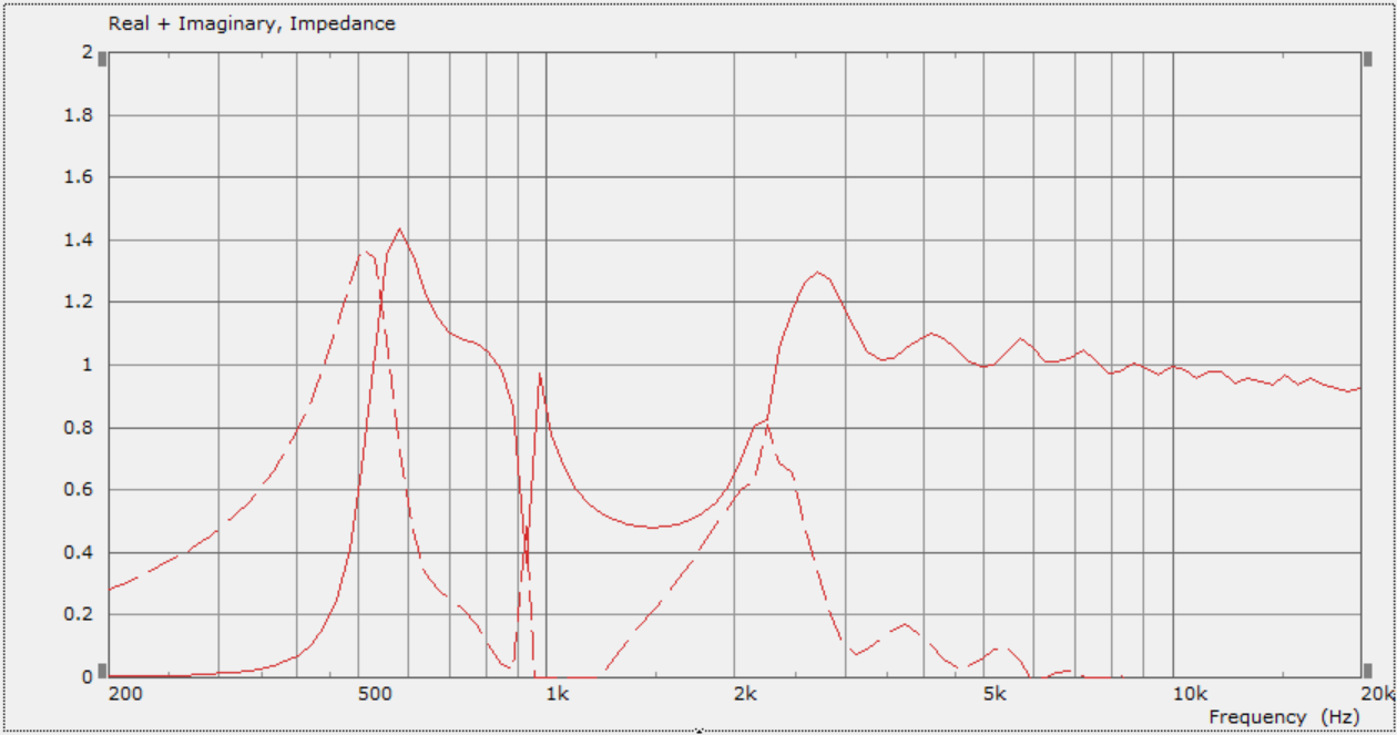

4 channels, 1.4" driver. Does anyone have an explanation why is the impedance as it is? It's obviously a propetry of the bended channels, it's a pattern that will probably stay there.
The local minimum on the impedance curve seems to correspond somehow to the length of the channels (wavelength of 1800 Hz ~ 2x channel length).

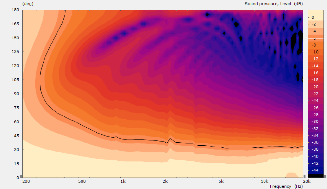

Which aspect are you referring to, the overall shape of the response or the change as you ‘flatten the curve’?
The latter appears to be the trade-off between the loading and coverage pattern or the wavefront sculpture. That’s not so dissimilar to the effects of constant directivity horns, trading axial response for more consistent coverage.

To me what you have are two devices that are not well matched to each other. One is tune low and the other much higher up. I'd suggest that the higher bumps correspond to the inner channels and the lower bump results from the outer portion. You have an impedance mismatch at the junction.
I have suspected all along that we can't go changing path shapes willy-nilly as the angular portion of the wavefront cannot be spread arbitrary. It is locked to the radial flaring of the waveguides. In math-speak, the equations are coupled and cannot be separated - what you do in angle affects the radial and visa-versa.
The sim is telling you exactly what the equations say.

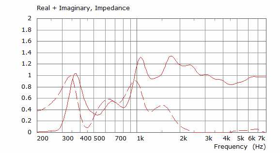

I think that the problem is improper geometry of the petals/channels in the mabats horn which, in essence, in current geometries are a simple curved tubes loaded (damped) with a horn radiation resistance. To test this I simply modeled one of the horn with petals uploaded here by mabat (script sc36) and then modeled radiation impedance of the petals itself.
Simulated impedance is as follow
In my opinion, everything is obvious here.
What's less obvious is optimal geometry of the channels. I believe that the channels themselves should be more like horns, or their length must be of a certain value (or both together)

It seems that petal itself introduces some pipe-like resonance. I tried to simulate 4001 with ant without petals and it is seen that petals certainly increases acoustic loading in certain frequency range (approximately one octave above cutoff). It seems to me that this is due to heavily damped pipe resonance.
On the other hand, the radiation resistance of TH-4001 with petals removed itself is highly disturbed, which indicates a problem with the horn walls non-optimal expansion. 4003 is much better in this respect.
Now this is getting really interesting, thank you all for you contribution of ideas about the acoustics involved. Much appreciated. I'd love to continue in this debate and perhaps gather a better understanding of the matter.
My initial notion was that there willl be no reflection back (i.e. no resonance) as long as the summed wavefront formed will match what's expected at the waveguide entrance. But maybe it's more complex than that.
Basically, what we have here as a beginning is this:
There should be no mismatch or resonance whatsoever as, as a whole, it's in fact still one conical device. The only differences to what I presented (besides the fact that the individual sources are flat, not spherical, but that's a very subtle difference, I assume) is that:
- the channels are re-arranged and bended so that the input wavefront forms a line, not an arc
- the individual expansion(s) of the channels can be changed from conical to something else.
So what exactly is it that makes the results so different?
