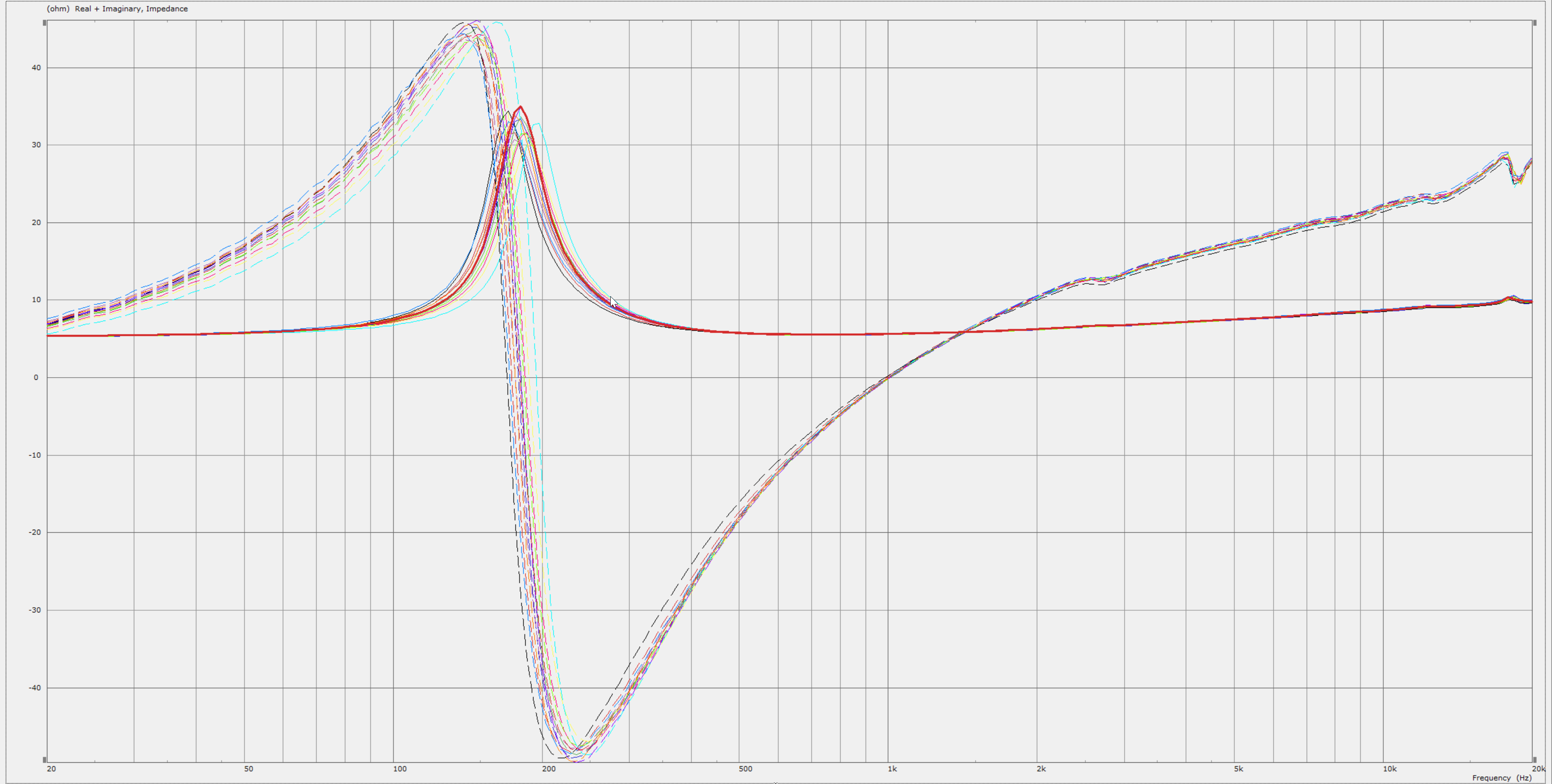

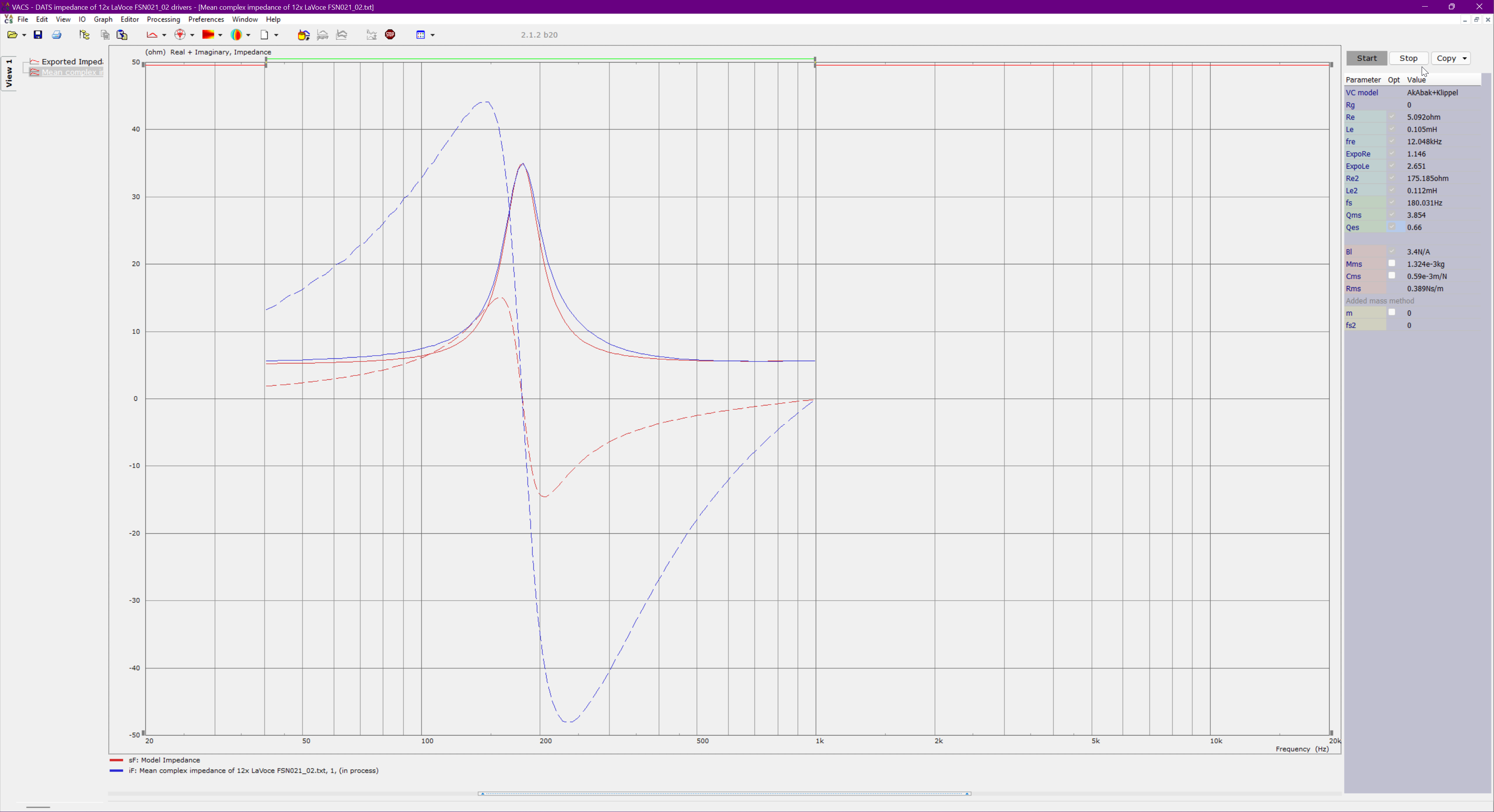

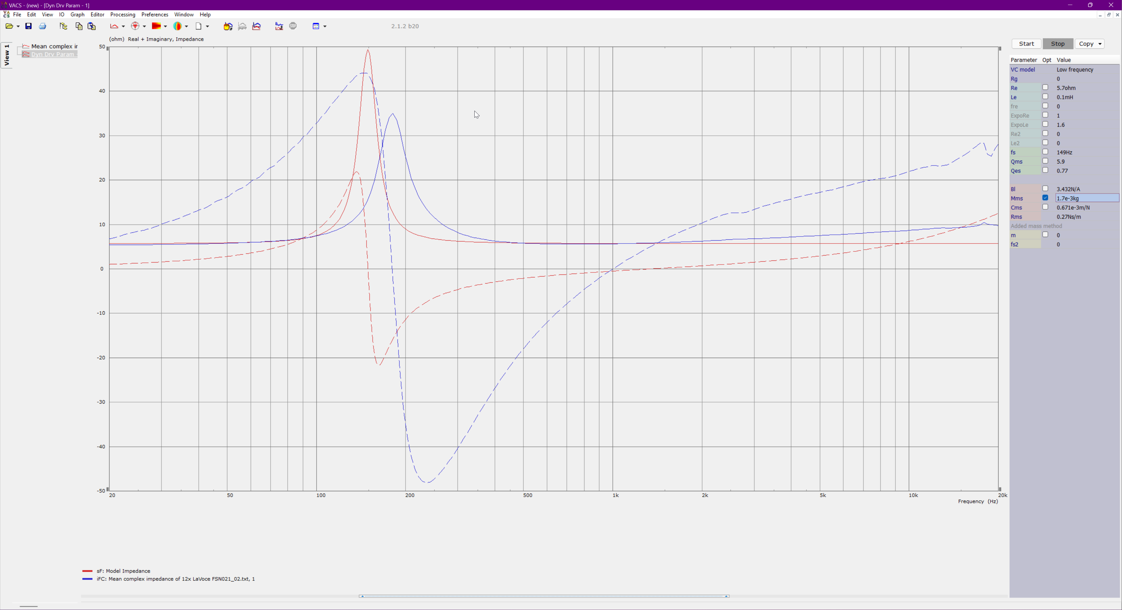

VACS has a built-in tool for this, if you supply it with an electrical impedance measurement of a driver. Of course, the better the input data, the closer the result so measurements that are generated from lots of averages in a reflection-free environment are a good first step.
I did this recently for a project, using 48 measurements across 12 different samples of a 2” LaVoce driver. I generated a mean curve from that data, put it into VACS, and the fitting algorithm created a set of parameters for use in Akabak. They differed quite a bit from the published T/S parameters, but the resulting impedance curve matched much more closely.
There’s also that method for generating a two-port model of a driver, using electrical impedance and current measurements done with a hard floor and a simple known horn geometry as terminations. That would represent it in some detail. I’m not sure how that could be used in ABEC/Akabak as it stands though. Perhaps a custom .dll and the ‘script’ element in the LEM section?
Sorry for the double post, but it might be useful to show the VACS method, as it's a little buried.
  • Take the electrical impedance measurements. DATS, REW and ARTA all work well
  • Import the electrical impedance traces into VACS
  • Generate the mean curve under Processing > Trend Analysis. You might also want to check the Std Error to spot or exclude outliers
  • Select the mean curve and copy it with Ctrl+C or Edit > Copy
  • Open a new Dyn Drv Parameters form under File > New Graphs, editors etc > Special forms
  • Paste the mean curve into the Dyn Drv Param form
  • Type in the T/S parameters from the driver spec sheet into the relevant Value fields on the right side of the screen
  • Check one of the red coloured options for Bl, Mms, Cms or Rms to enter that data, which then calculates the other values
  • Be careful to use the correct units! It helps to type the unit value after the number, especially for Le and Mms.
  • Choose a VC Model value; it's a drop down menu but doesn't look like one. The different options are explained in the ABEC or VACS help files.
  • Click the Start button to put in a starting point Model Impedance curve
  • Check the Opt boxes to choose which parameters to optimise to fit the measured mean curve more closely
  • Click Start again and give it a moment, when it doesn't appear to be making more improvements, click Stop.
  • Rinse and repeat until both the Real and Imaginary curves for the Model Impedance are close to the measurement
  • This can also generate the Klippel or VACS curve model data such as ExpoRe, ExpoLe, Re2 and Le2 for a more accurate simulation
  • Export the data from VACS
  • If you can't save the curve in the demo version, then there's the option to copy the values as pre-configured ABEC/Akabak formula values for use on a Dyn Driver element in the LEM section of the sim

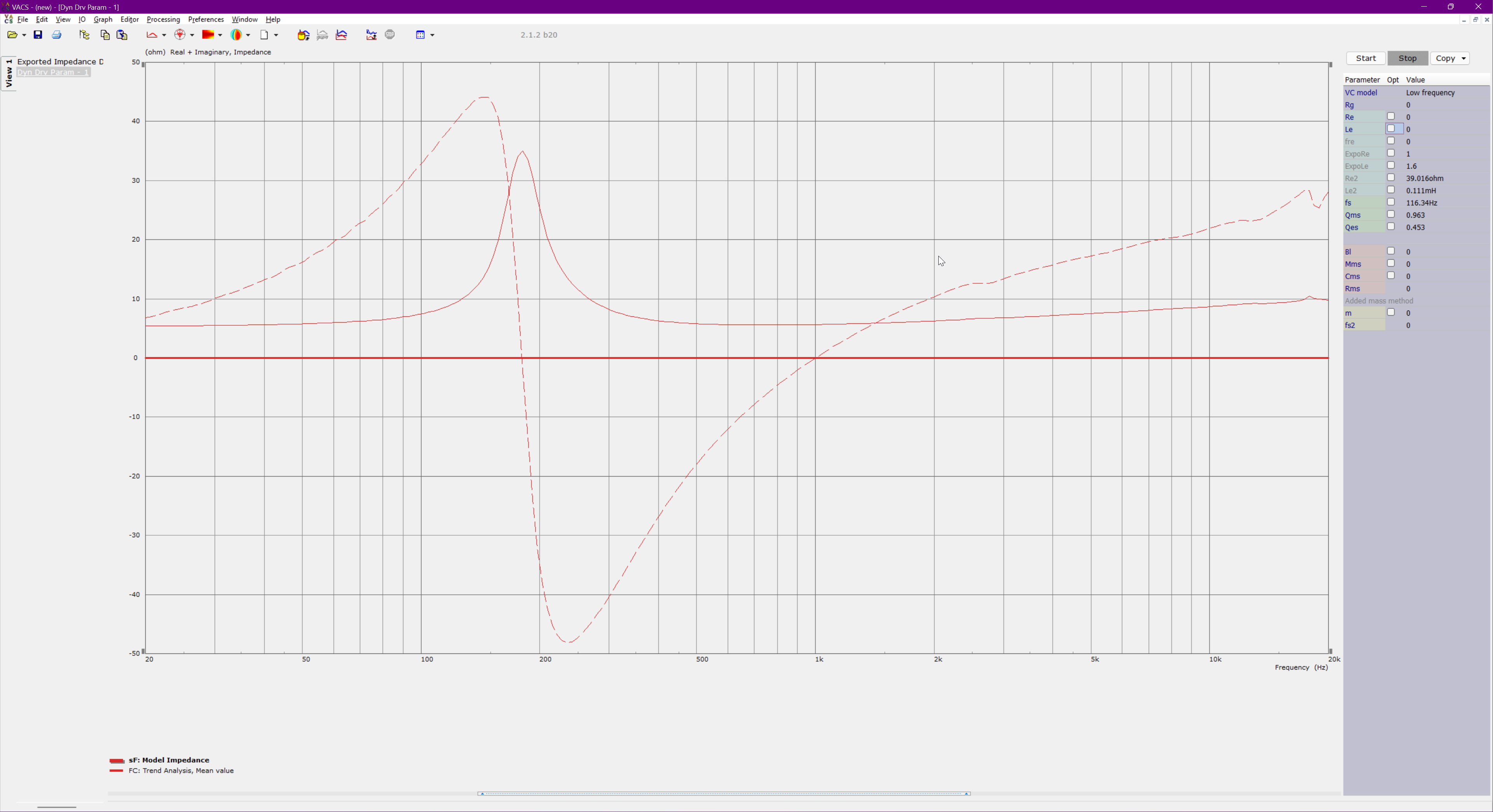

Some screenshots are attached. In order they are:
  1. Some example data, including a generated mean curve
  2. The initial view of the form with mean complex values pasted in
  3. The curve generated by inputting the T/S parameters from the spec sheet
  4. The result of model fitting after ~30 seconds of computation, using the Klippel+Akabak VC model option
Hope that helps 🙂

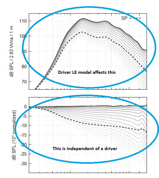

That corresponds with what I’ve been finding too, and a common issue with DIY synergies or multi-entry horns that don’t consider the ‘stuff behind the grille’ of the HF driver.
It’s a good reason to include a decent model of the driver in a BEM sim for something that is going to be built. The perfect planar source is handy to separate the horn contribution from that of the driver, but the response predicted is a little too good compared to what happens in reality.
It's important to stress that the normalized SPL data, as calculated for a 'constant something' source (i.e. without a driver model), will stay exactly the same, no matter what driver model is used. What changes is the absolute SPL level as a function of frequency - that's the only change a particular driver model can cause.
(Of course this is only true as long as we consider an idealized wavefront at the throat, but the LE model doesn't change this in any way either.)

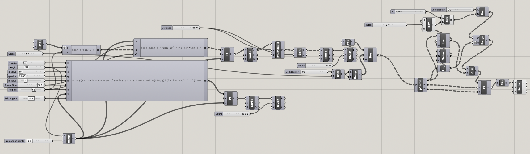

Btw Mabat,

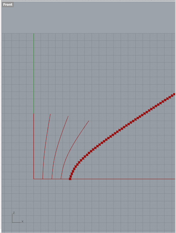

When you did the meandering script..
Did you offset the (x) coordinate on on every meander with a fraction derived from the average path length?
I was considering taking the area of every meander and using that to calculate the offset instead of using the average path length. (maybe it's the same)
I'm still trying to make a script that does it parametrically in GrassHopper, so I can adjust stuff in real time with some sliders.
It looks something like this:
attachment.php
attachment.php

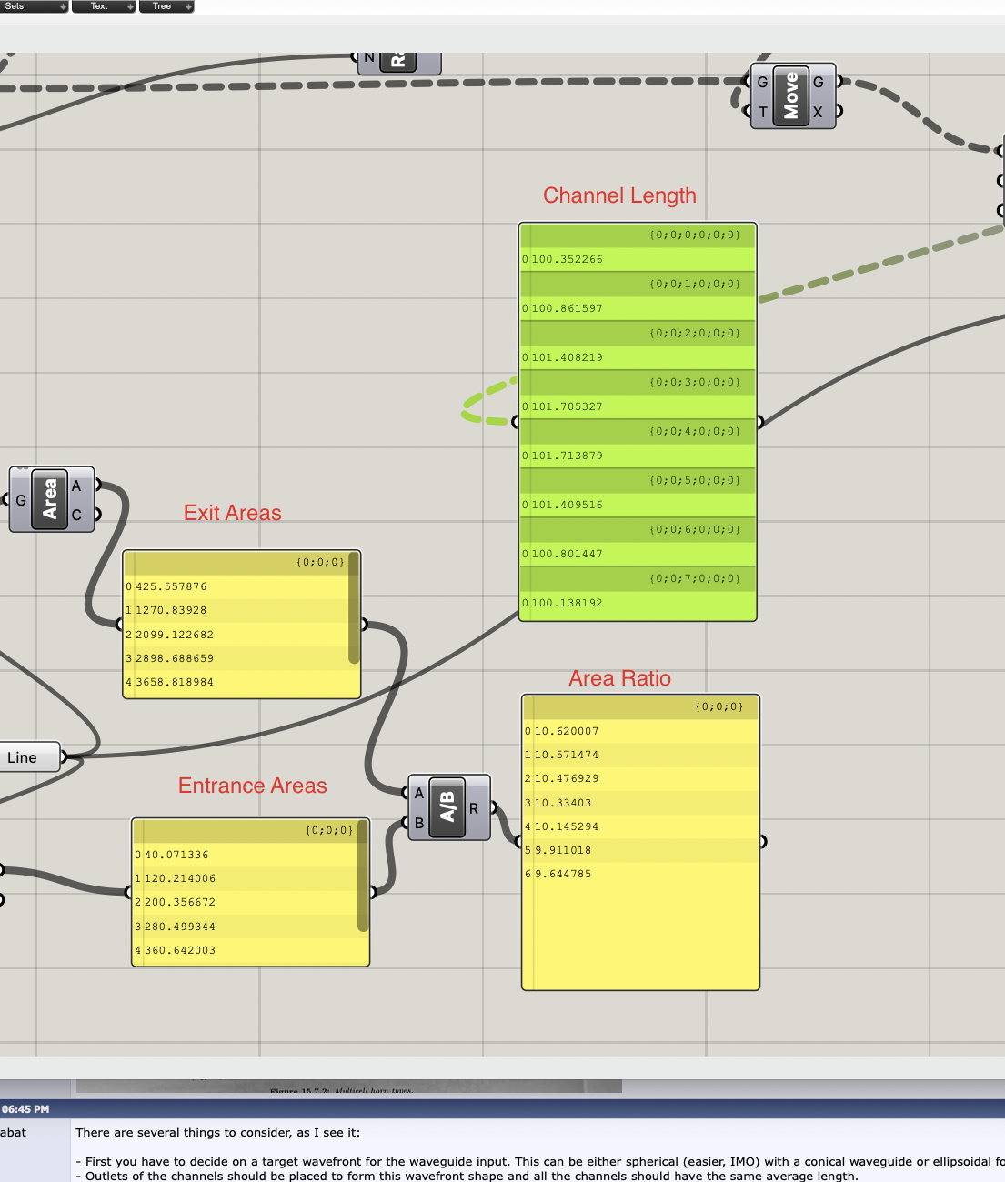

There are several things to consider, as I see it:
- First you have to decide on a target wavefront for the waveguide input. This can be either spherical (easier, IMO) with a conical waveguide or ellipsoidal for an OS waveguide.
- Outlets of the channels should be placed to form this wavefront shape and all the channels should have the same average length.
- The ratio of the input ring areas should match the ratio of the outlet areas (normal to velocity - on a spherical cap for the spherical wave), and the acoustic load presented on each channel should result in the same volume velocities at the outputs.
It's really not entirely straightforward but I still believe it can be done, maybe with a little help from some carefully prepared partial simulations.

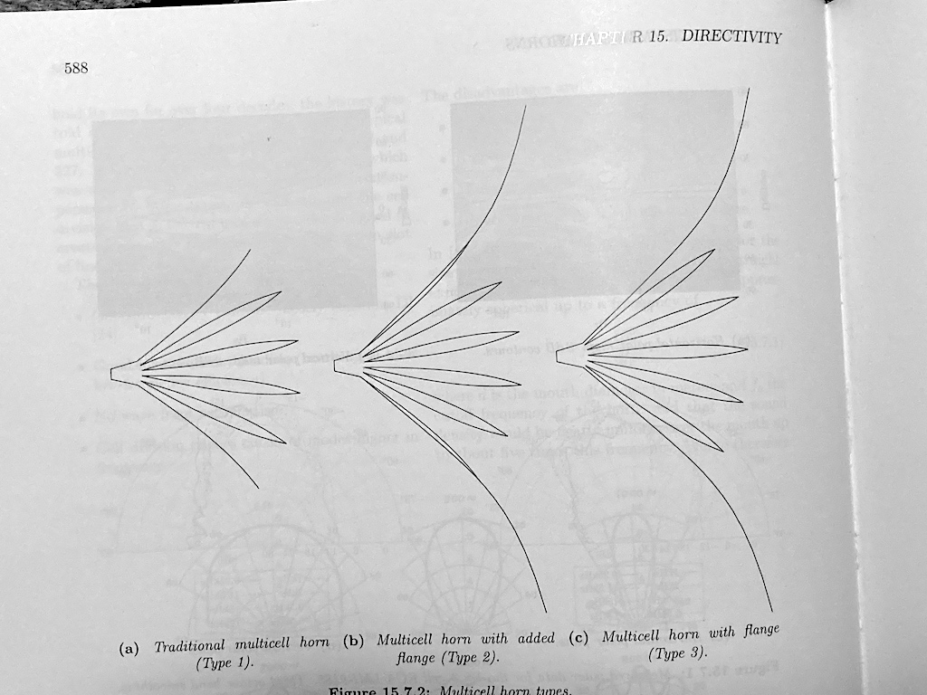

If the phase plug manages to produce a spherical wave, then it would be perfectly fine to use a properly terminated conical waveguide, wouldn't it?
I'm a bit inspired by the discussion in Kolbrek and Dunker's book about upgrading the traditional multcell design.
I think incorporating a phase plug is doing kind of this.
attachment.php
Not only "fine", it would be the perfect fit for the conical waveguide, i.e. with no further HOMs generated. Better than a flat wave with an OS waveguide - that's the point. But as always, it's far easier to make a sketch than to make it actually work.

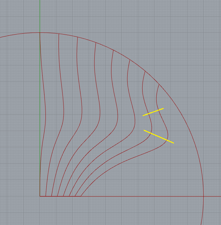

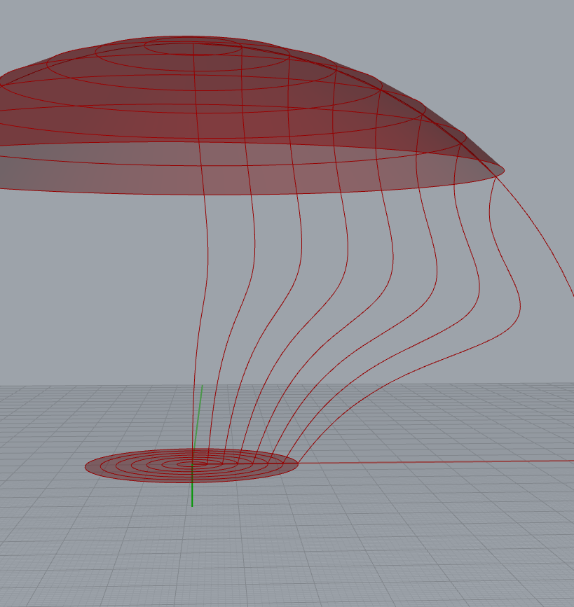

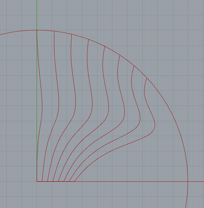

Hi Mabat,
I'm not sure if I'm way off, but this geometry almost satisfies the conditions:
Throat size 50mm, sphere diameter is 200mm
It starts off flat and ends up spherical (with center the center of the throat)
Not sure if the outlets will form the waveform shape, but that's what ripple tank / Akabak will show.
All Chanels have nearly the same length.
The spherical caps (rings) have also nearly the same ratio of input vs output.
Acoustic load at each entrance and velocity at each output is not simulated on.
Could you be kind enough to share the ripple tank format?
Screen Shot 2021-10-11 at 23.31.31.pngScreen Shot 2021-10-12 at 00.00.37.pngScreen Shot 2021-10-12 at 00.09.12.png
Here is a .dxf of the drawing
View attachment onion.dxf.zip
Without any closer examination of the rest, I think you should avoid such channel narrowing at all costs -
attachment.php
What you want is a channel that is continuously expanding. Also the velocity vectors at the outlets should be normal to the desired wavefront if possible, IMO. The question is how to determine the velocity vectors - I would assume that this is given by the direction of the channel "middle line" (if the channel is narrow enough). Also, I think there's no need for "meandering" of the center channel.
