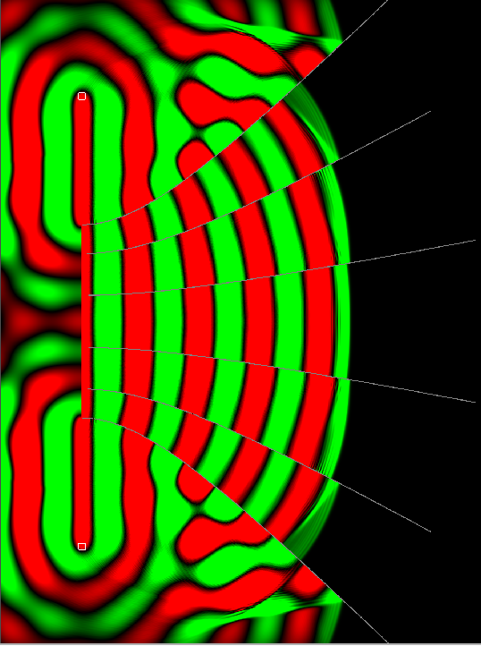

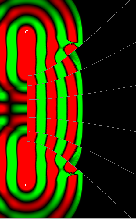

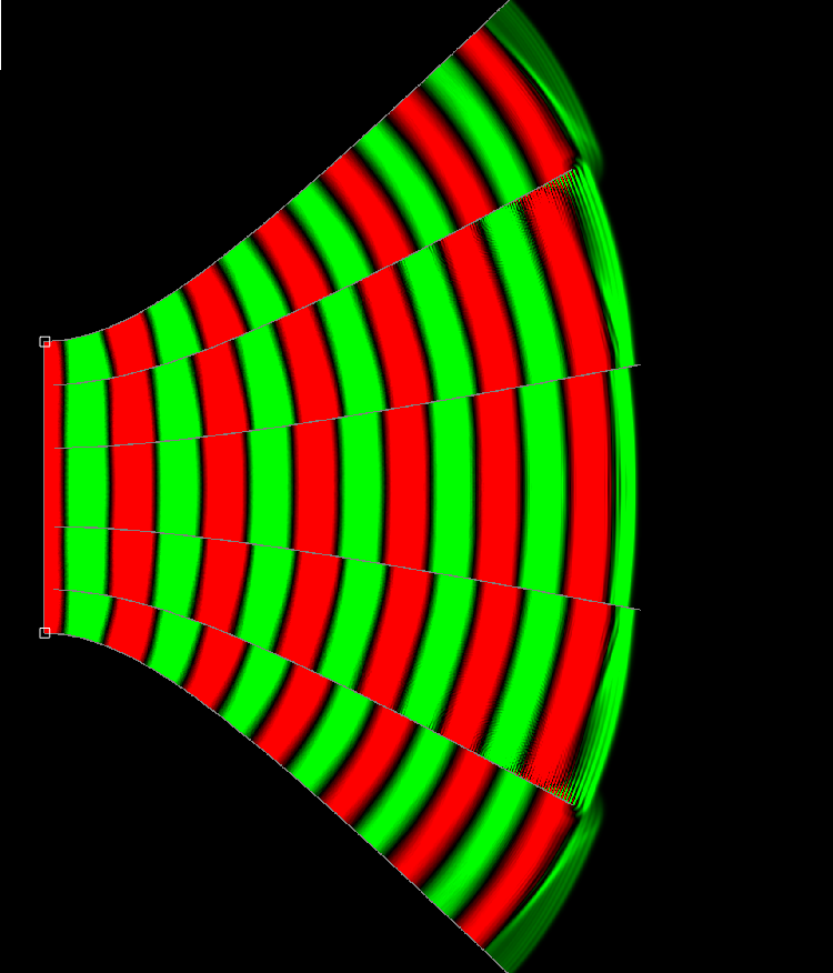

To follow the OS coordinates the wavefronts as a whole should form ellipses. I'm not sure that can happen with the vanes in place...
- Hmm, but the points on the ellipses of the OS coordinates are not equidistant from the origin, are they. Maybe that's the problem.
These are the OS coordinates, and after all, I think this is exactly what we see - by the time a wave in the blue vane reaches the ellipse at u=0.6, a wave in the yellow vane will be already slightly beyond that line.
(I could as well choose neighbouring vanes but the path length difference would be too small to be obvious.)
Seems to me that you are proving my point. For the zeroth mode the red lines are wavefronts - each channel is in-phase. Those channels are equal distance at .6. One does not "lead" the other as I see in the sims.
The average distance from the origin, which is a line, not a point, to each point on the ellipse is equidistant. That's how one draws an ellipse - the old pencil and string technique.
No. Imagine the vanes starting at 0 with separated sources. The average path lengths inside the channels are obviously different and that's what is effectively happening here, IMO.
I think we can leave the notion that the OS contours alone provide such feature but otherwise I still like the vanes principle. All (or "all") that seems to be required is to adjust the channels to be more aligned length-wise at the summing points. Shapes of the individual channels seem to matter much less as long as they stay narrow.
I was thinking about making the channels simply "meandering", separating them - I would keep the center channel as it is and add more and more of a smooth meander towards the outer one. Should not be hard to implement nor make.

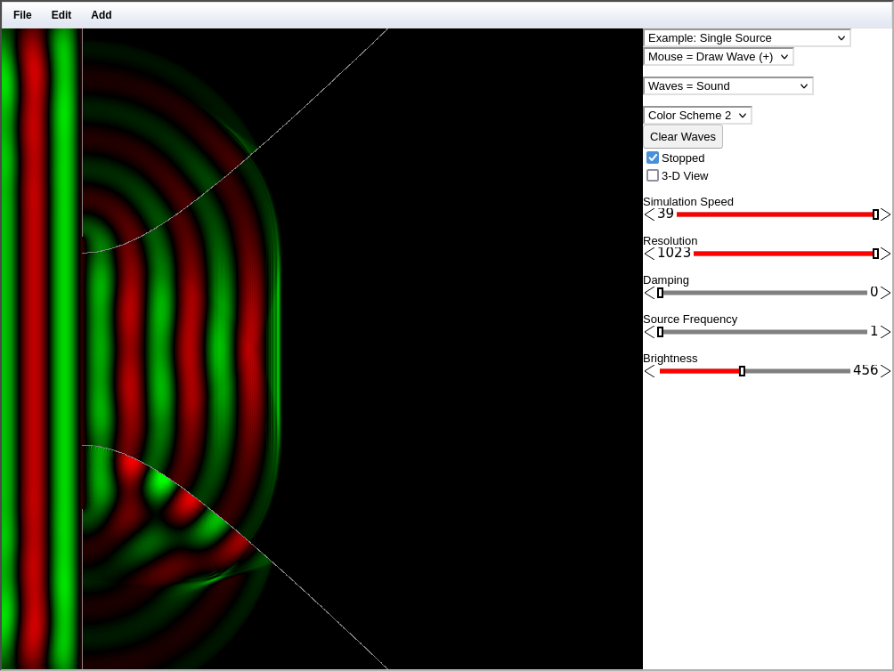

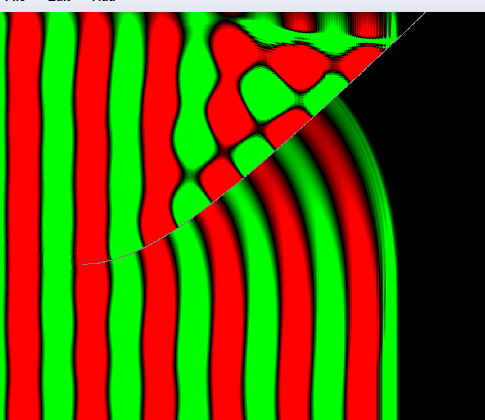

Strange behavior is simulated on the waveguide outside.
BTW, Paul has replied on the Github:
Source: sound wave propagation speed issue * Issue #4 * pfalstad/ripplegl * GitHubThe first one just seems like there are different standing waves in the various sections. The second one certainly seems incorrect. I don't think I'm simulating angled walls properly with acoustic waves, but I'm not sure how I would fix it.
That's because of reflections at the screen border, that's just the behviour of the applet - you should always stop the sim before the waves reach screen boundaries.
Well I think the simulations are actually correct in the big picture, however strange it may seem.
No, this applet does not reflect from the borders.

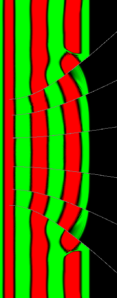

Here is a earlier screenshot of the same situation.
It nicely shows how a waveguide converts planar wave to the spherical one, because the wavefront in the center of the waveguide is aligned with the wave outside of waveguide. I have never realized that earlier 🙂
To me, it also looks that the simulation tool works. Maybe vanes could be adjusted to generate a nicer wavefront.
It definitely reflects off the screen boundaries - try placing a sole point source in the middle of a blank screen and keep it running... no waves should ever return back. See what you get.
OK, that's nice! It seems it has been fixed in the meantime, which would be great.
I certainly remember it behaved differently.
Could you post the code of the WG sim above?
I just extended source from your second example by 400 units to both sides:

Just a single wall, no reflections that would boost the fading wave.
Looking on the patterns on the other side, I'd guess that the width of a vane would be important too.

Sorry, I don't follow what you are trying to show. What's the point of all the waves outside the waveguide?
