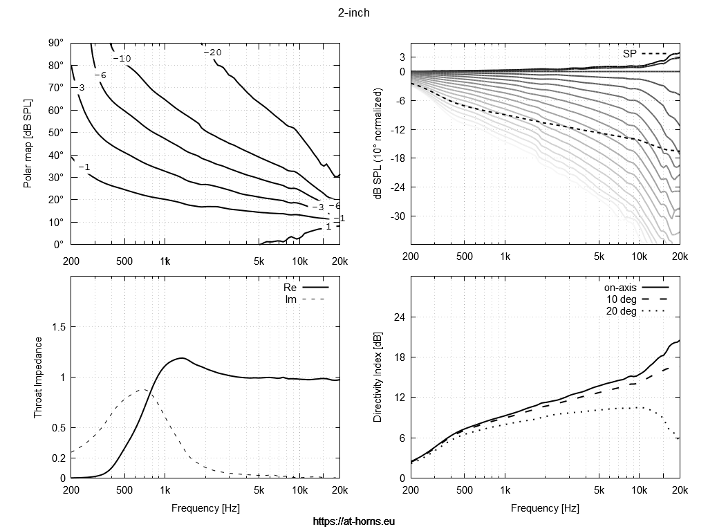

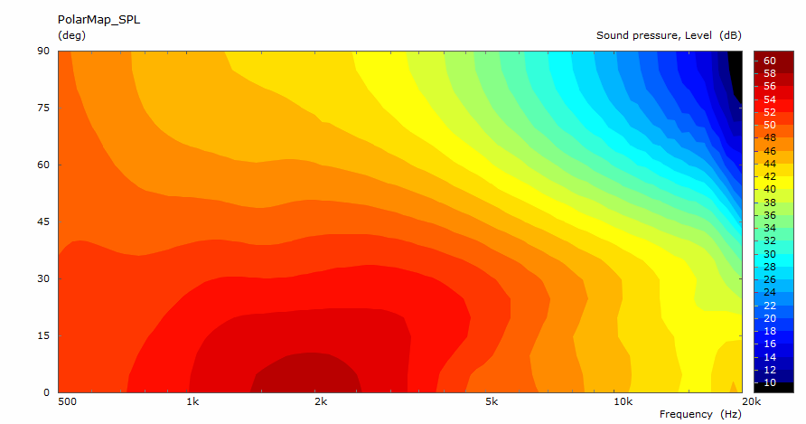

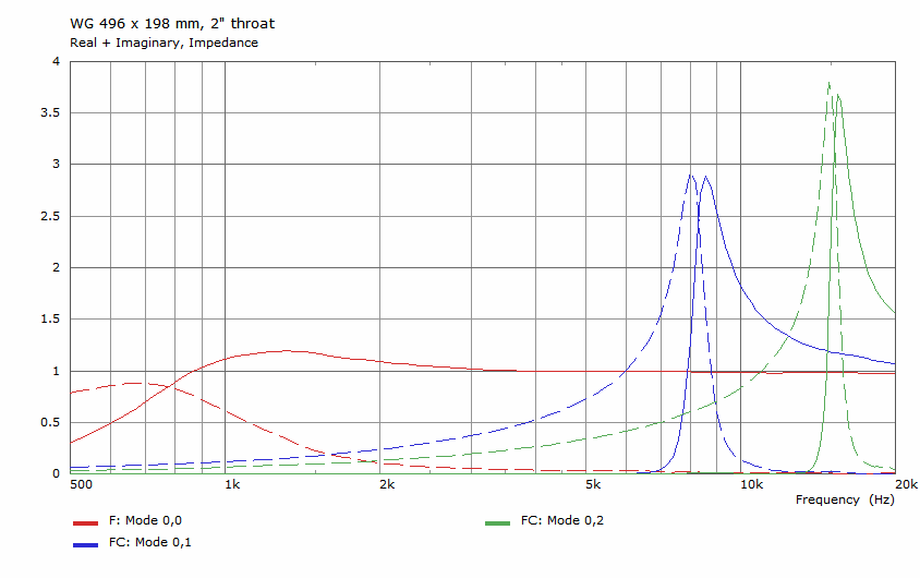

2" throat, ⌀496 x 198 mm. Modes 0,0 - 0,1 - 0,2. Nothing surprising.

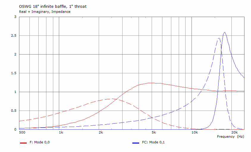

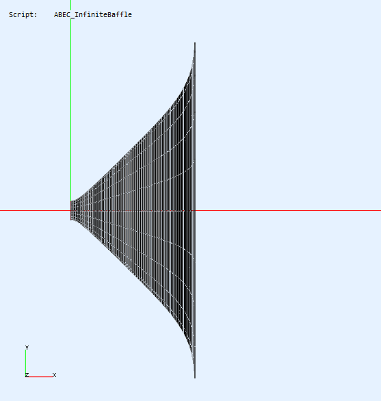

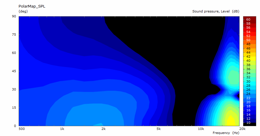

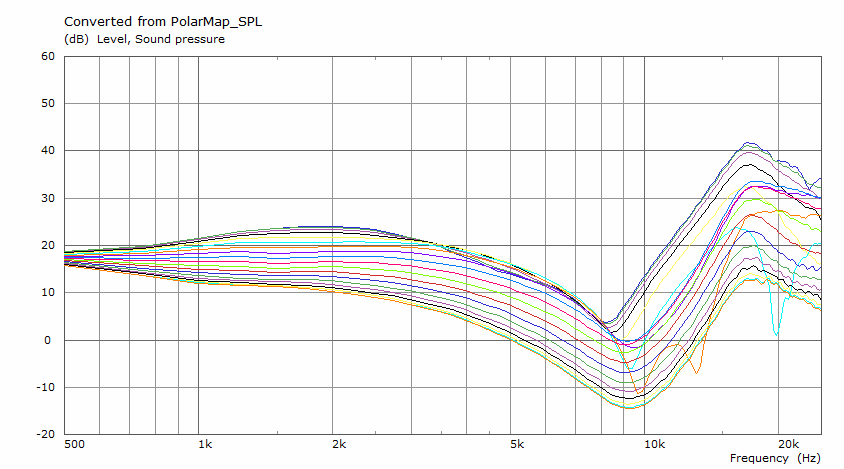

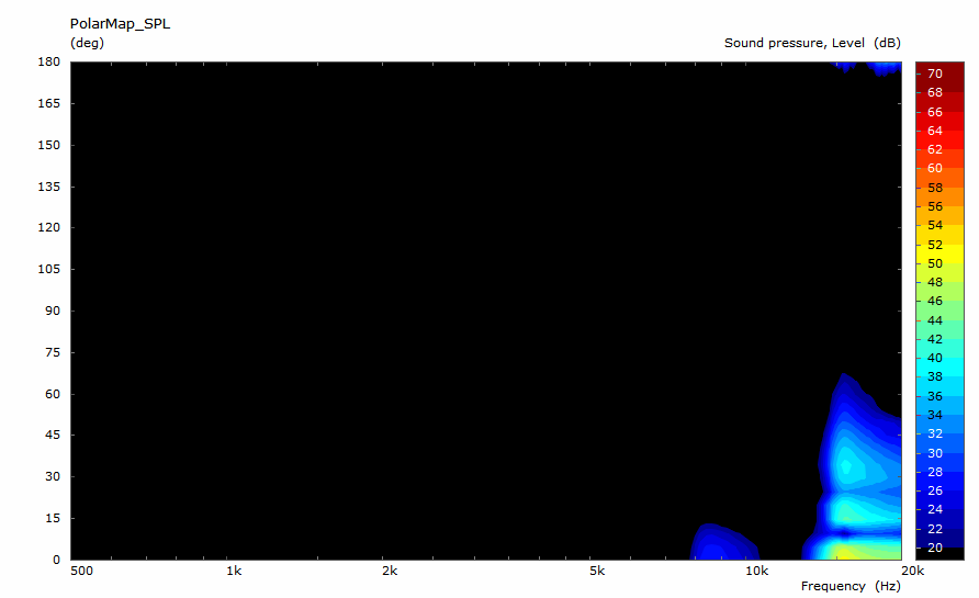

I have another one - 18" OSWG, 1" throat, infinite baffle, modes 0,0 and 0,1.
The question is - now what?
Well we have learned, but it was of course already anticipated, that wider throats yield lower cut-ins of the diaphragm modes. For a 1" throat all the modes are high enough that we could likely ignore them. For a 2" they will pose a significant limitation on the HF response, most likely causing the need for another driver to handle this frequency region. To me, the take-away is that for home HF one should limit themselves to a 1" driver.
As to the effect that these modes will have on the response, I should make clear that many things can happen - it all depends on the phase of the HOM relative to the normal mode. One phase adds and the directivity will narrow and the opposite phase will substract, creating a possible hole, and anything in-between is possible. Hence, the driver specifics will determine the response once the HOM kick in and will differ from driver to driver. Below that, the HOM will have little to no effect on the drivers allowing only the planar mode to propagate.
These are all useful new knowledge, although neither surprising nor unanticipated, but still Mabat has shown that they are real and can have a significant effect on the results.
One could take these results and highly accurate polar results (not trivial to do at these very high frequencies) to calculate back to the throat and find out what the throat motion was. For 1" drivers this is likely a waste of time, but for 2" ones it would be feasible to do and likely very instructive.

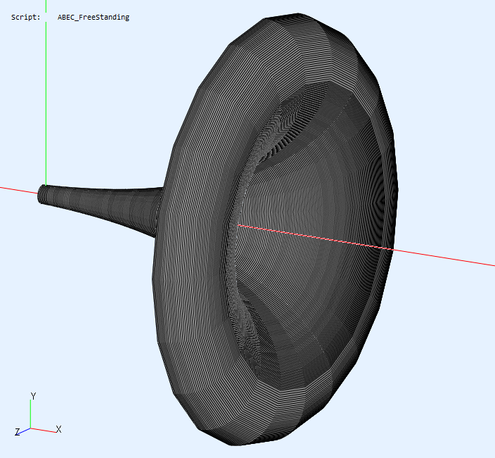

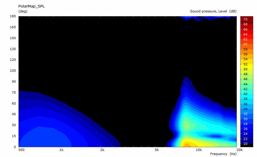

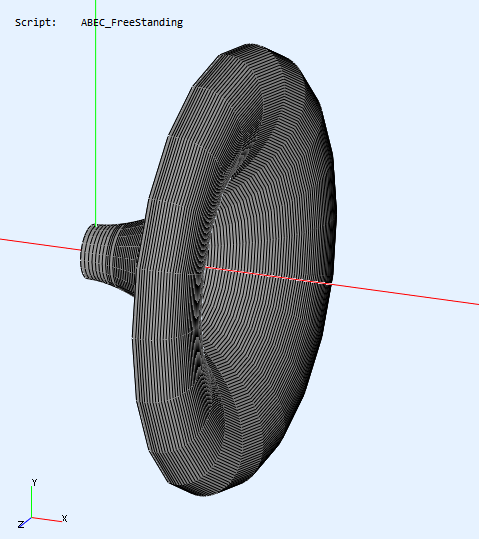

I assume that If the waveguide/horn is going to be in a standard speaker baffle, the correct modelling is "FREE AIR", correct?
The more suitable at the moment is the infinite baffle because in Ath there's still no option to put a waveguide into a box and simulate the whole in free air (not implemented yet).
The responses modelled in FREE AIR vs INFINITE BAFFLE is quite different and more jagged.
It doesn't have to be that way. Actually, I believe that a free standing waveguide can be made smoother (see almost all the previous examples) but to confirm this I'll have to implement the box option.

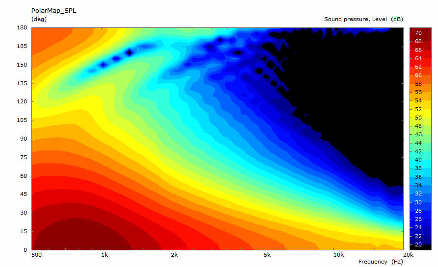

If the guide is axisymmetric and simulated with circsym they will be more similar but if a full 3D mesh is simulated other parameters such as where and how the interface is created can have a big impact on the simulated response, more so if a rollback is used.

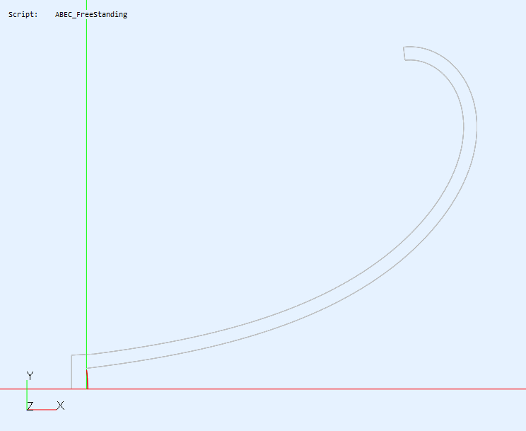

I don't have any LeCleach profile at hand, only something similar (high-z OSSE ⌀952 x 658 mm, 1" throat) -
Looks bit more wilder this one. Can you test some other waveguide profiles as well? The first results you posted might be smoothest already?
Straight sided conical? how about small step/angle mismatch at the horn throat? some random device from the simulation runs you posted few days ago? Does mouth rollback have any effect?
