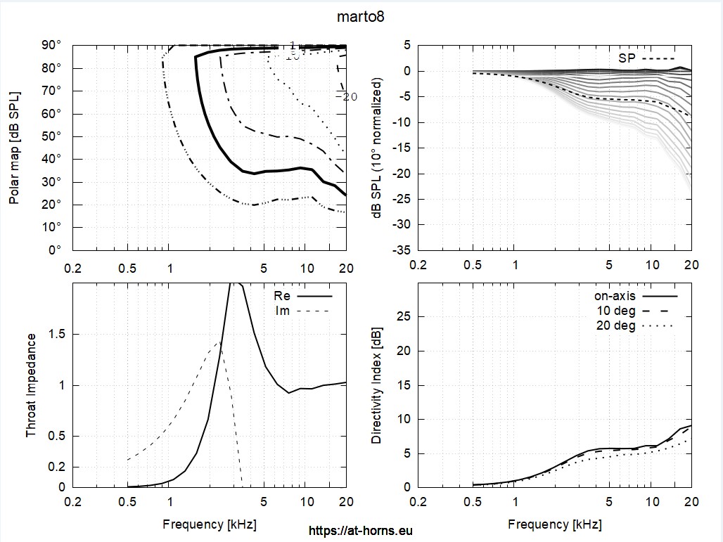

BTW, is this really what you want? The 'marto8' doesn't look like a proper waveguide at all, more like a mediocre direct-radiating dome tweeter. Number 2 is definitely closer to what I would choose.

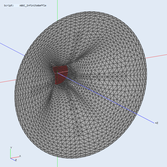

I uploaded the wrong picture (too many modelling!). This is the one that wont import to fusion 360.

Is it rectangular? I ask because if it was circular (axi-symmetric), the import to Fusion could be made differently and much more easily.
Then please see the post #5083
- Ah, now I see it's actually not axisymmetric, so the above won't work, sorry.
Well, you can always import the STL file... It won't make a smooth surface but for 3D printing this is irrelevant anyway. High enough mesh resolution should work just fine. (I only don't know how to make it solid.)
Just a few remarks on the script you posted, I quickly skimmed through -
1) I don't understand why you have the mesh resolution so coarse - this won't work. Use the commented lines instead (and maybe decrease the *Resolution items a bit to properly capture the details of the geometry).
Mesh.AngularSegments = 100
Mesh.LengthSegments = 48
Mesh.CornerSegments = 48
Mesh.ThroatResolution = 48
Mesh.MouthResolution = 48
;Mesh.AngularSegments = 100
;Mesh.LengthSegments = 36
;Mesh.CornerSegments = 4
;Mesh.ThroatResolution = 3
;Mesh.MouthResolution = 9
2) The value Offset = 33 in ABEC.Polars is too small, i.e. still behind the baffle (that's the reason why you don't see the far off-axis angles calculated properly). You should set it to something bigger than 50 mm, which is the depth of your waveguide.
Marcel,
My mistake, I sent the file with "coarse" mesh as I was testing if it make a difference on Fusion 360 regarding the error I am getting when importing. It did not make any difference.
About the offset, yes... I remember reading your recommendation in prior post (or was it in the PDF? IDK) but I am aware of it.
I will import the STL and fin a way to add a 1-3/8 18TPI thread for my compression driver and test it.

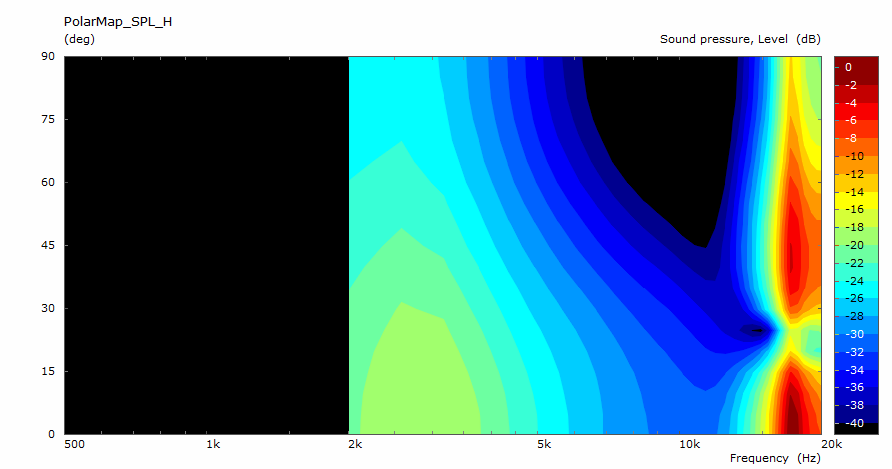

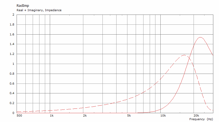

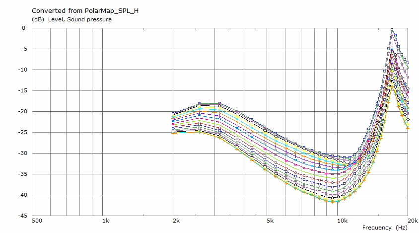

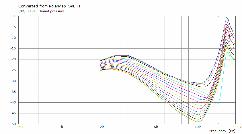

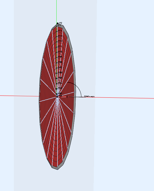

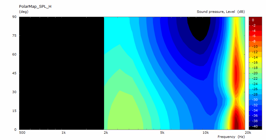

Driven by mode 0,1 (horizontal/vertical and diagonal polars).

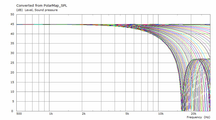

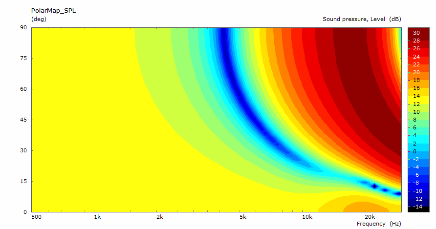

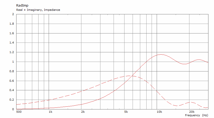

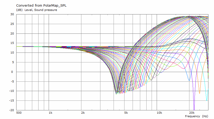

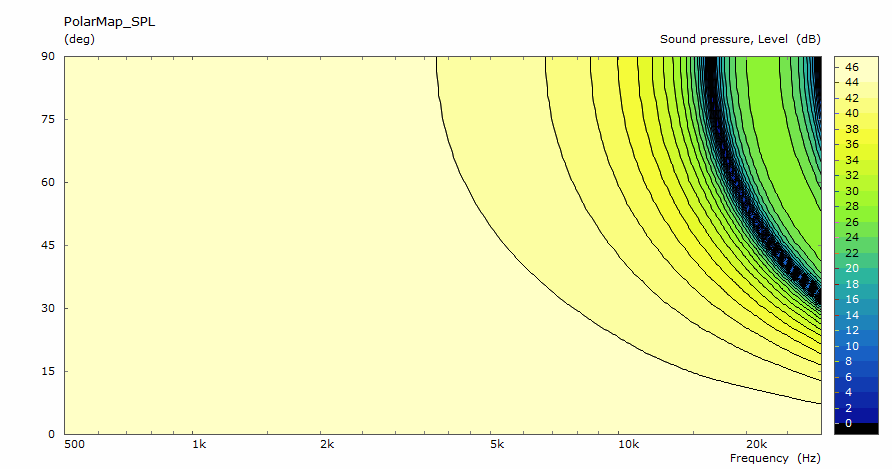

As a possible sanity check I made a simulation of a 1" flat disc in an infinite baffle, set to the mode 0,1 alone. Does it look sane?

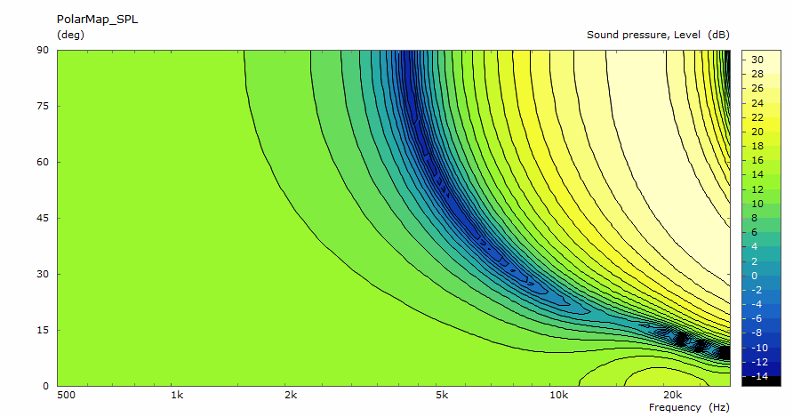

This is for a flat amplitude across the disc (i.e. mode 0,0 - all weights set to 1 in the above setup). This seems sane enough to me.

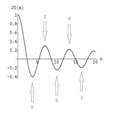

I don't follow. 0 means it's axisymmetric and the second index defines how large portion of the Bessel function (J_0 in this case) is mapped as the pressure (velocity) amplitude across the membrane. Value n means up to the n-th point where the Bessel function has zero slope (see the picture attached).
