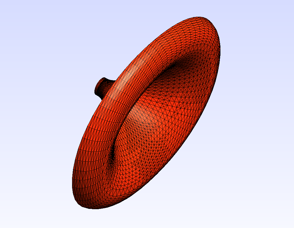

What does the program print as a "Project path"? There should be the name of the script (without an extension) in this path. It seems like it gets corrupted/lost in your case but I can't understand how this could happen.It has created the directory D:\Horns\ABEC_project with four files in it.
If there are only four, probably the *.msh file is missing (which is quite a pity).
It seems like the program argument (the script name as a command line parameter) is not passed correctly.
IMPORTANT:
Please (to all), use the line Out.DestDir = "D:\Horns" in the scripts, only set it to some directory that exists in your environment.
Your output files should then get created under this directory in subdirectories corresponding to script names. This is the standard way how to proceed. Otherwise you may get a mess.

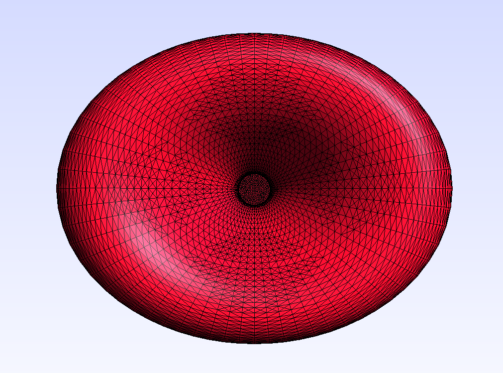

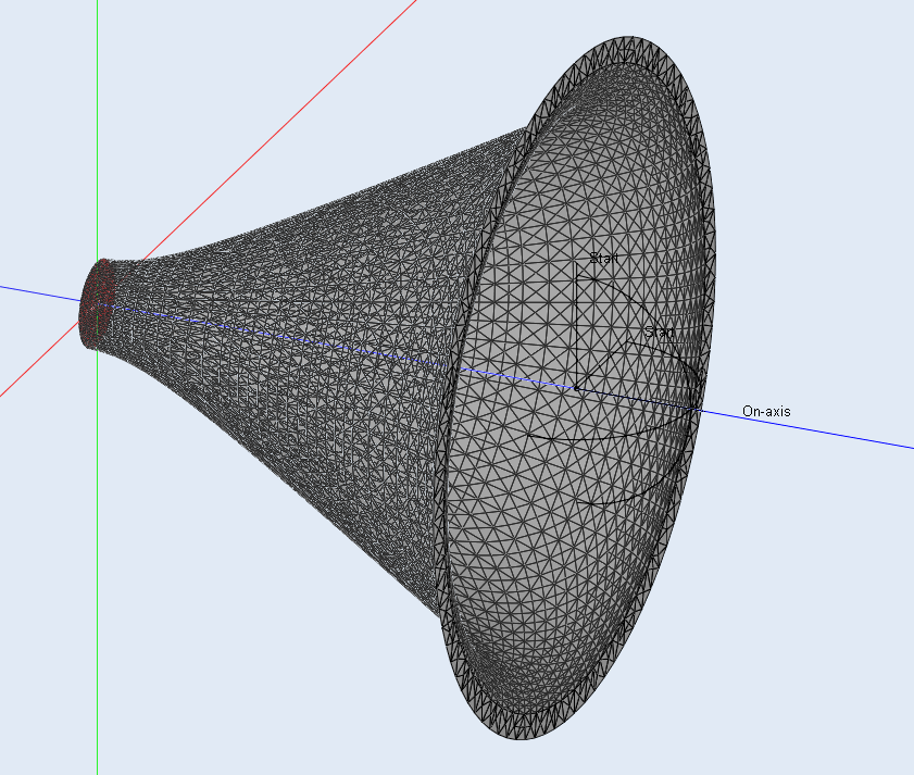

Fredrik, you can look for Gmsh configuration files on your computer and try to find something that may affect the mesh density (or just try to delete them). I just realized that during the initialization of the SDK (gmsh::initialize()), it reads these files by default:Tried it on my laptop now and the mesh is normal resolution there.
"If 'readConfigFiles' is set, read system Gmsh configuration files (gmshrc and gmsh-options)."
On my PC these files are in C:\Users\Me\AppData\Roaming.
That could be an explanation. I should probably disable this.
Thankyou. I'm getting closer, I'm now coming up with an error "Unknown output file format" when I try to open oswg.cfg. This error appears just after the width and height of the wg is displayed.

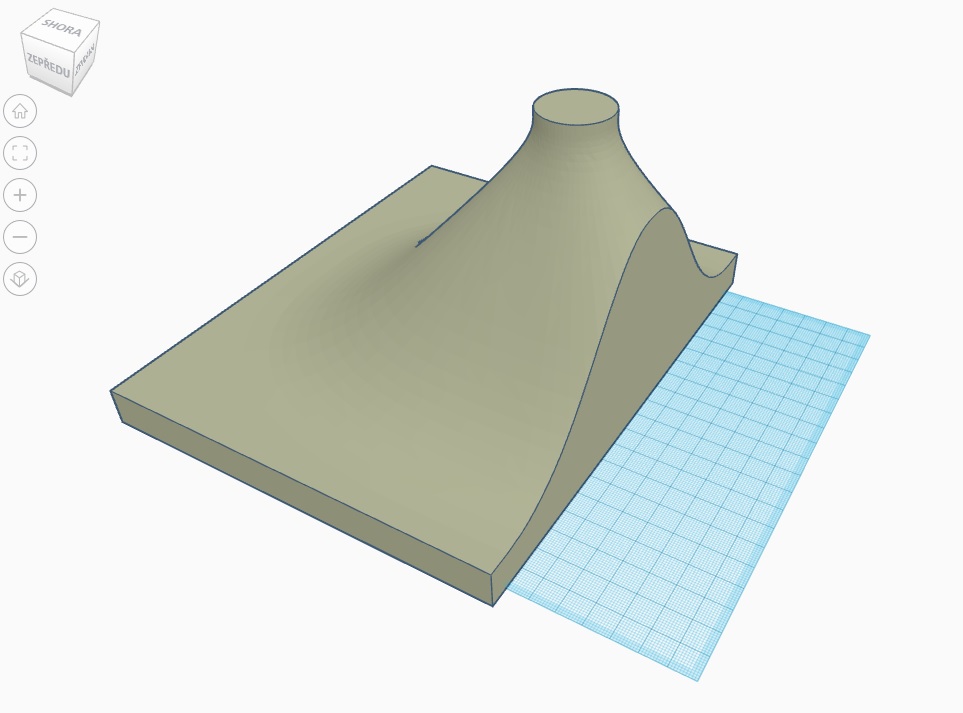

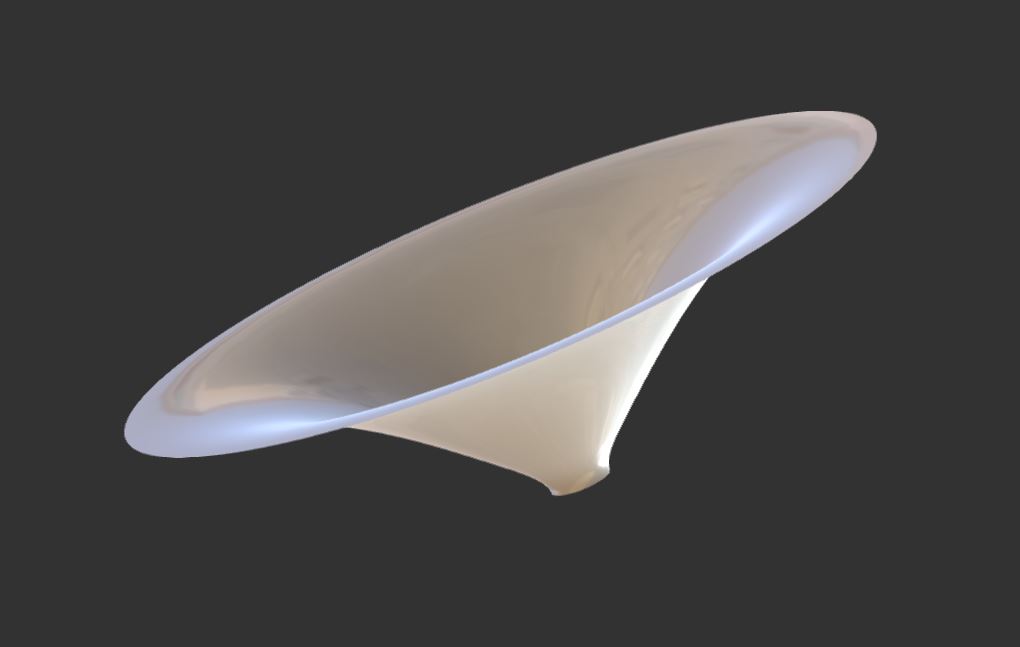

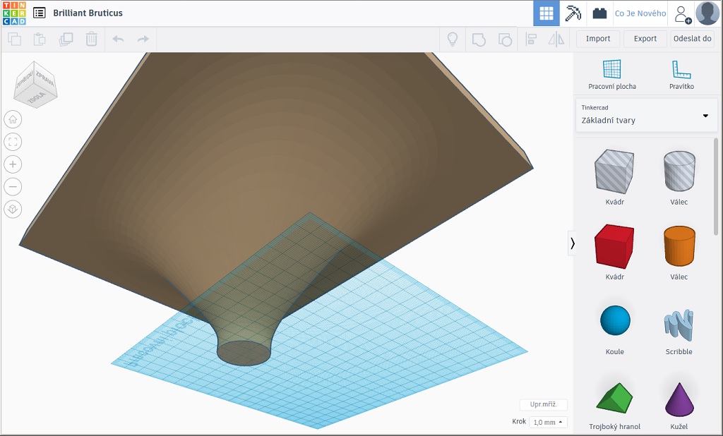

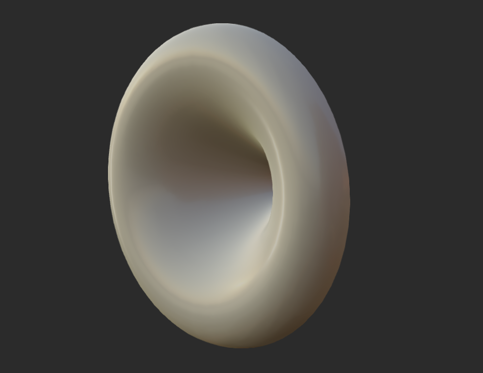

These are just some pictures from the coming functionality - a mold preparation. BTW, the STLs can be imported also to Tinkercad smoothly.
Now I would like to try to make horns myself from A1 acrylic resin: AcrylicOne
Does anybody here have any experience with this material? Maybe not so strong, but seems to be quite "user-friendly".

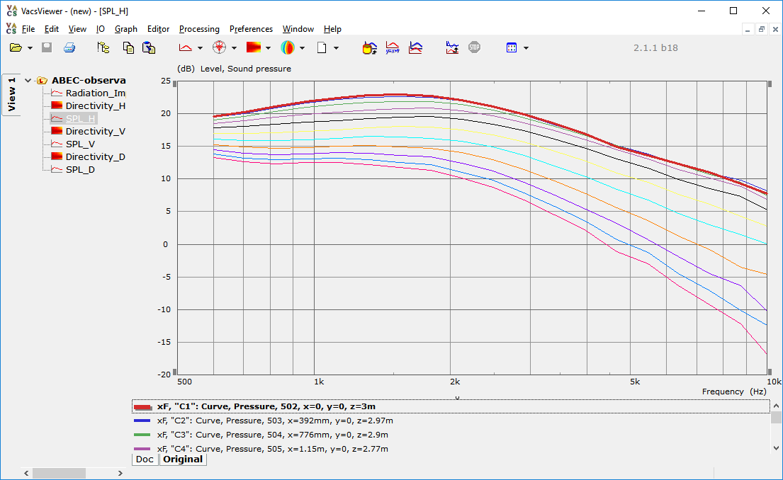

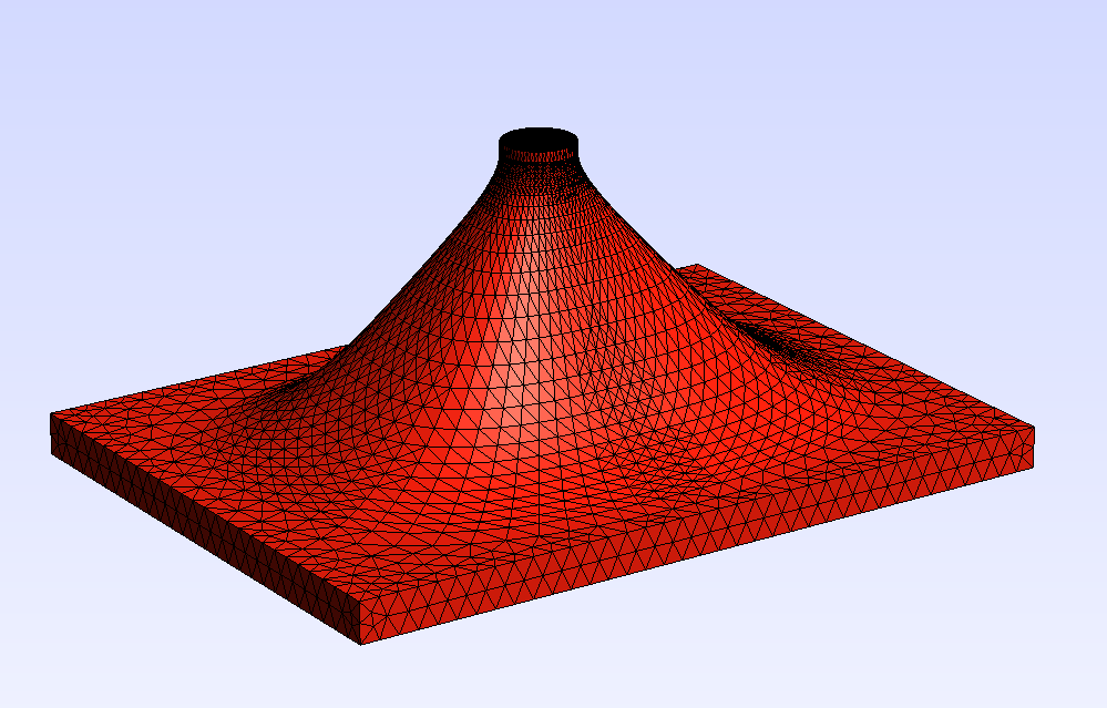

Ath4 script definition:
; Horn Geometry Definition
ThroatDiameter = 39.0 ; [mm]
ThroatAngle = 0 ; [deg]
Coverage_Horizontal = 90 ; [deg]
Coverage_Vertical = 80 ; [deg]
Depth = 200 ; [mm]
Depth.ConicSectionPart = 0.2
Shape = raw
SEExp = 8.0
Termination = baffle
Termination.Scale = 0.3
Depth = 200 ; [mm]
Shape = raw
SEExp = 8.0

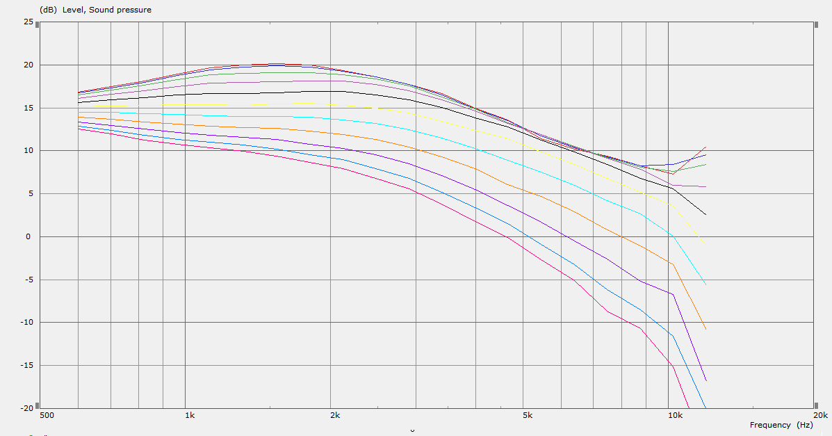

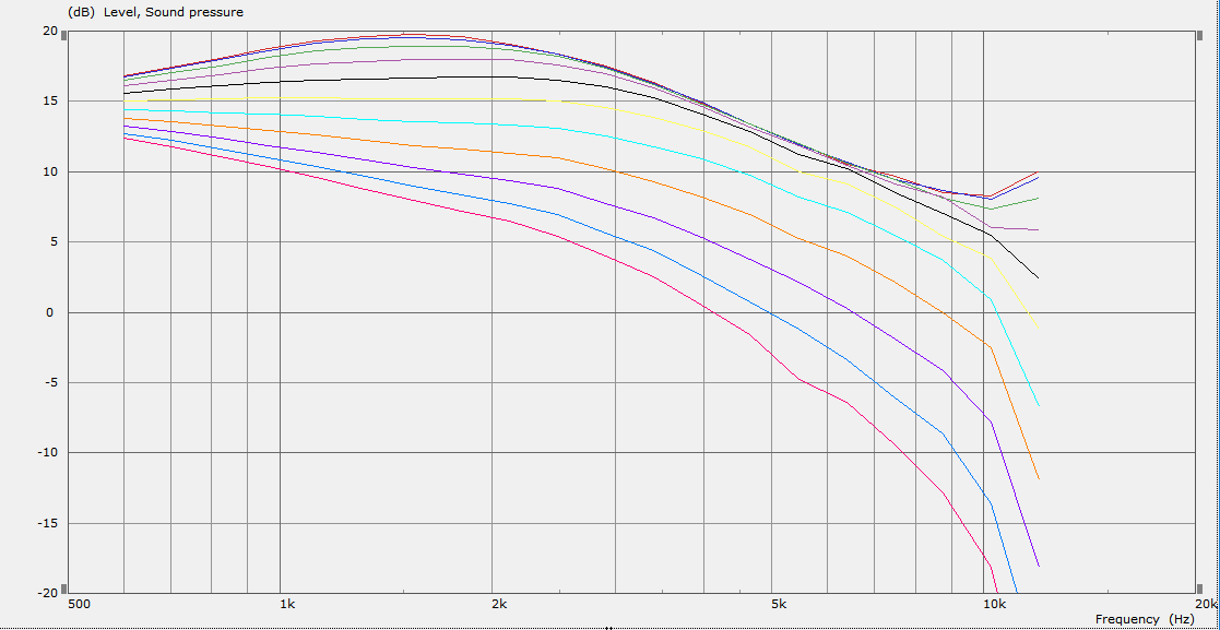

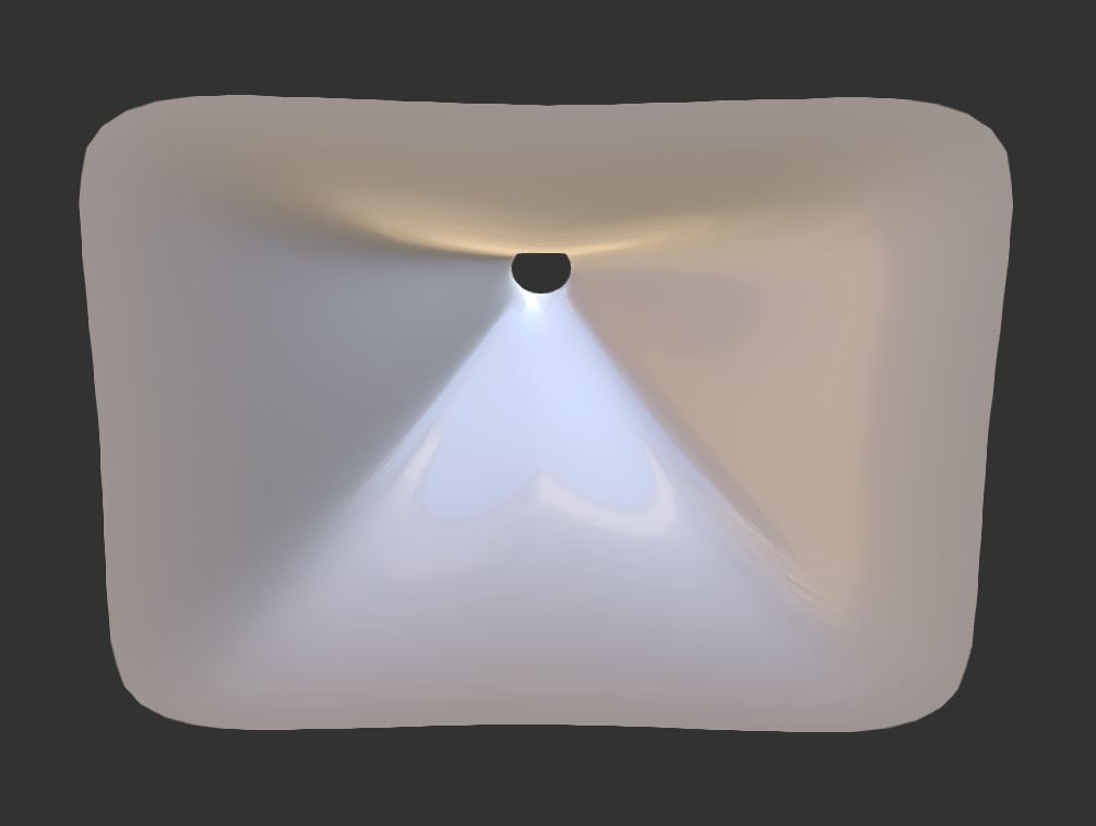

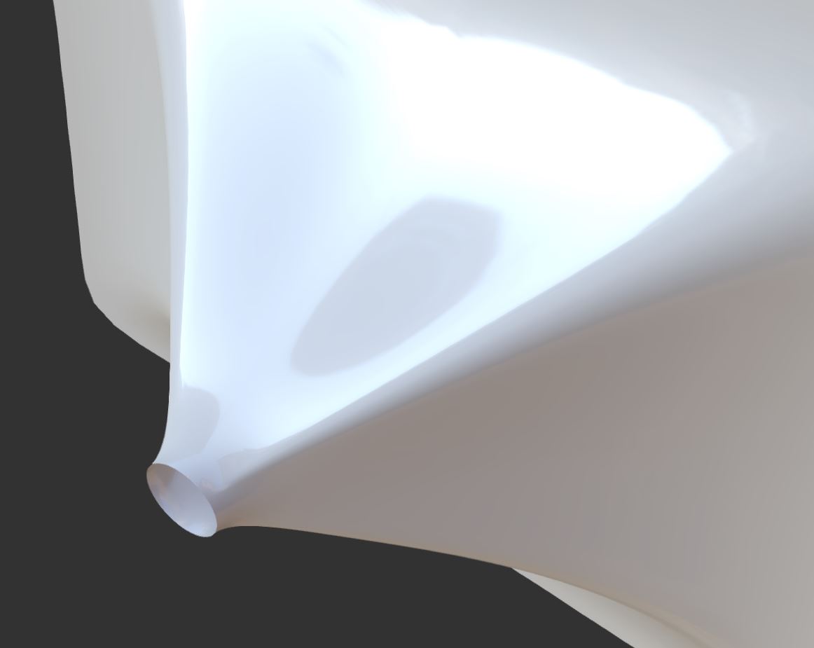

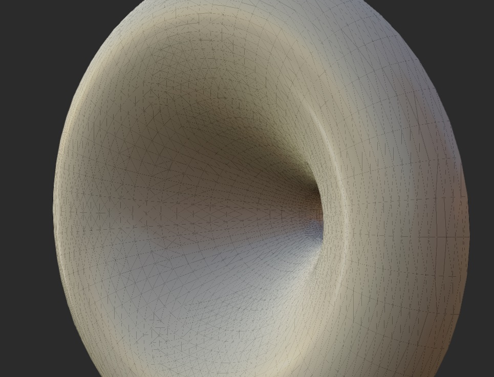

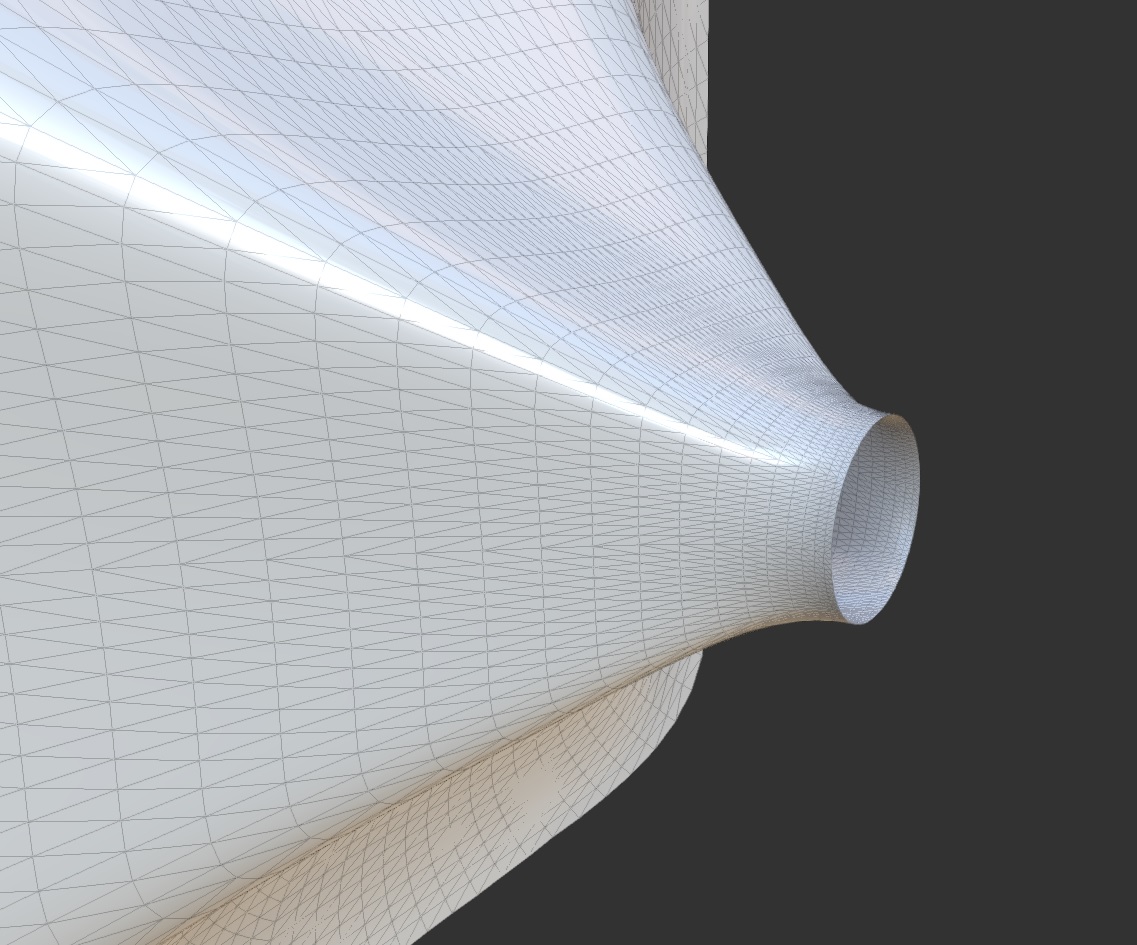

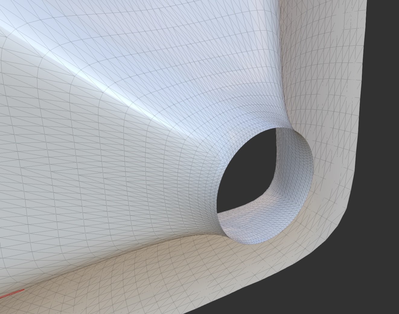

Throat detail -
(hyperbola+clothoid everywhere)

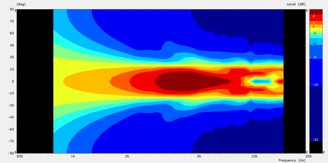

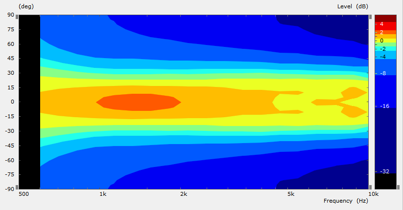

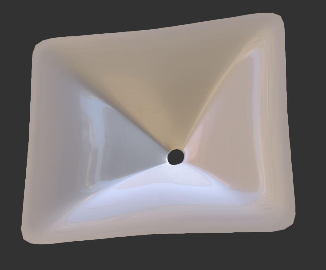

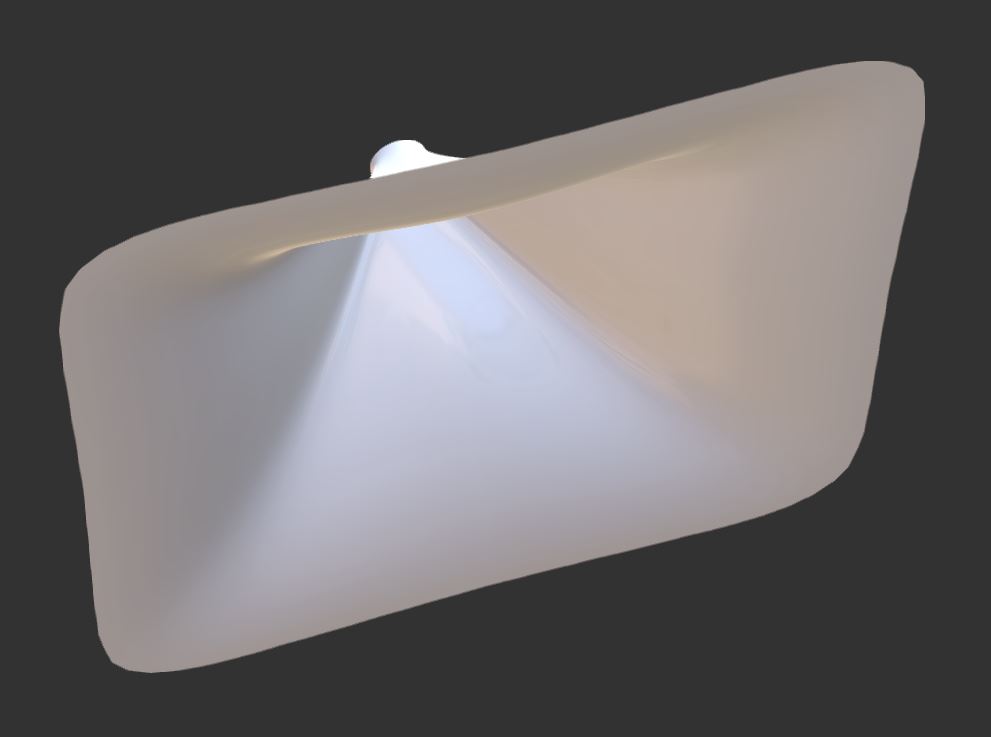

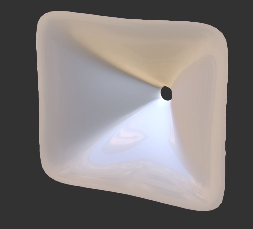

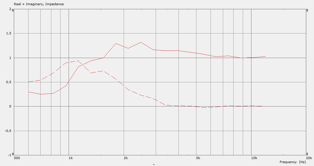

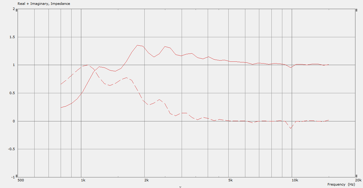

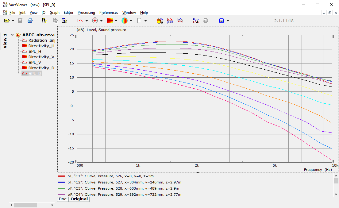

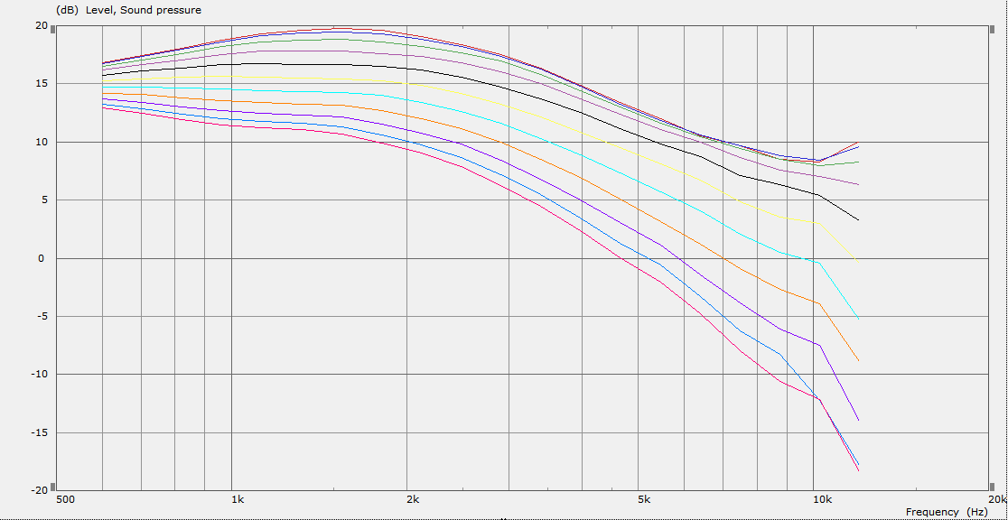

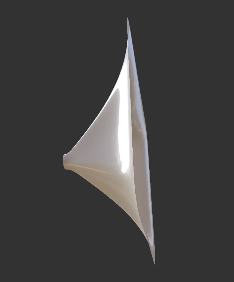

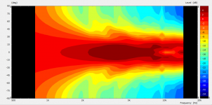

Making it shallower won't work as nice (this one is 506 x 416 x 140 mm; 110 x 100 deg nominal coverage).
Still usable, however.

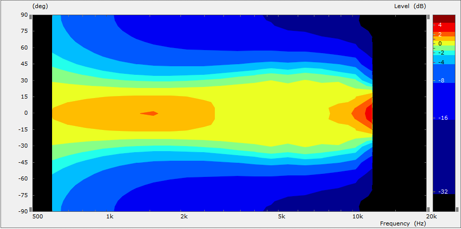

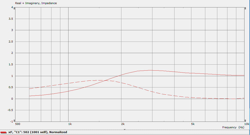

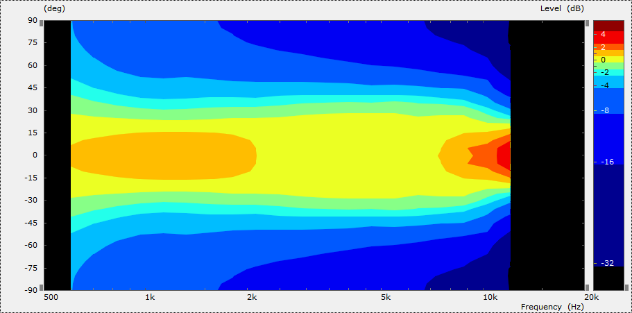

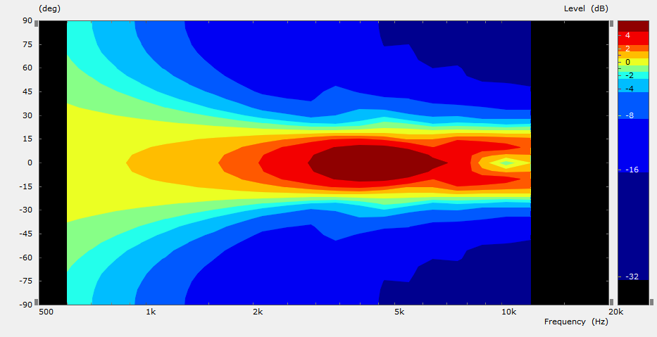

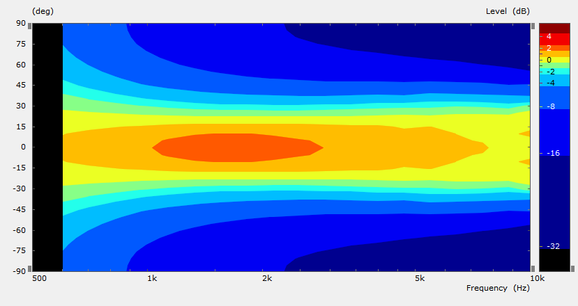

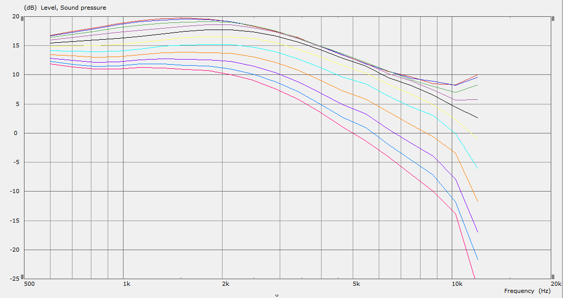

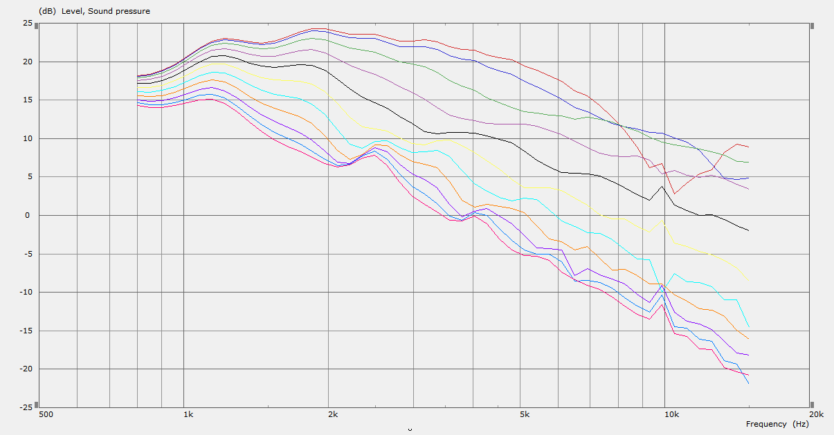

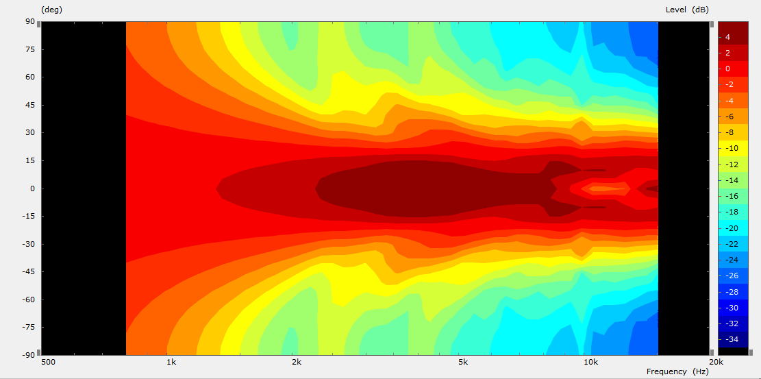

A bit more rounded mouth edge (still too small to have a noticable effect) and a bit more finer resolution.

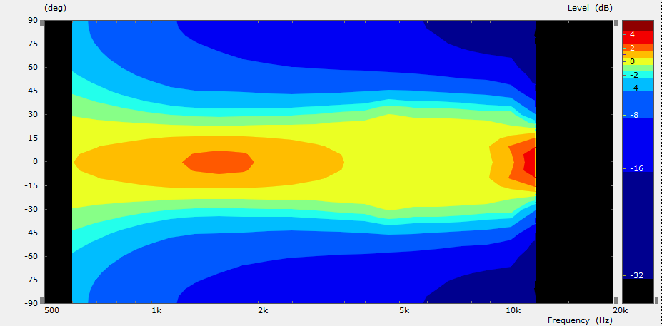

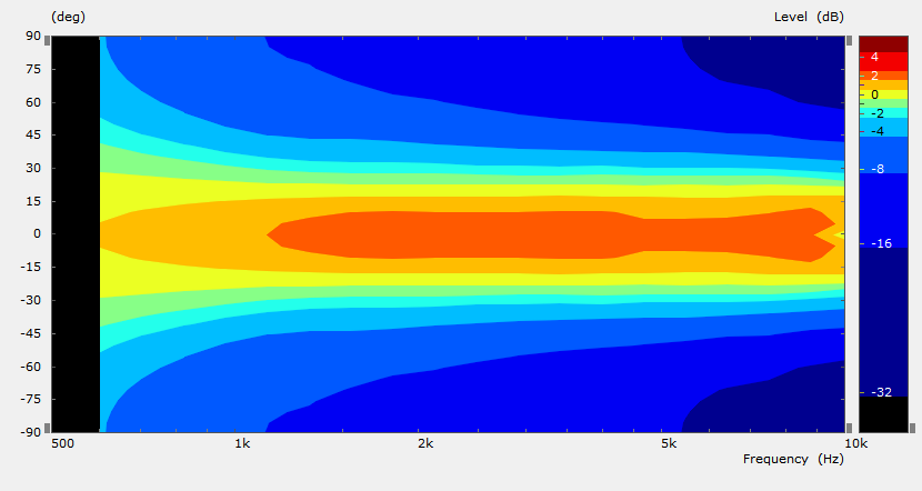

I almost like the log-shaded polar maps better.
