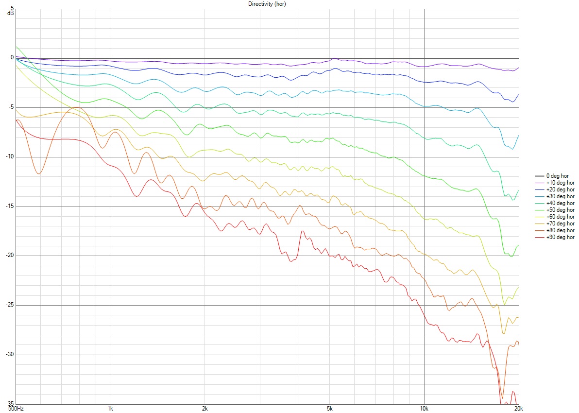

That was normalized, i.e. effectively an EQ used such that the response at selected angle (on-axis in this case) is exactly flat. It clearly describes the WG "alone", without the properties of a particular driver. In the Pet007's data this is the left lower chart. The upper left is the raw data.
That is correct - measurements posted were normalized.

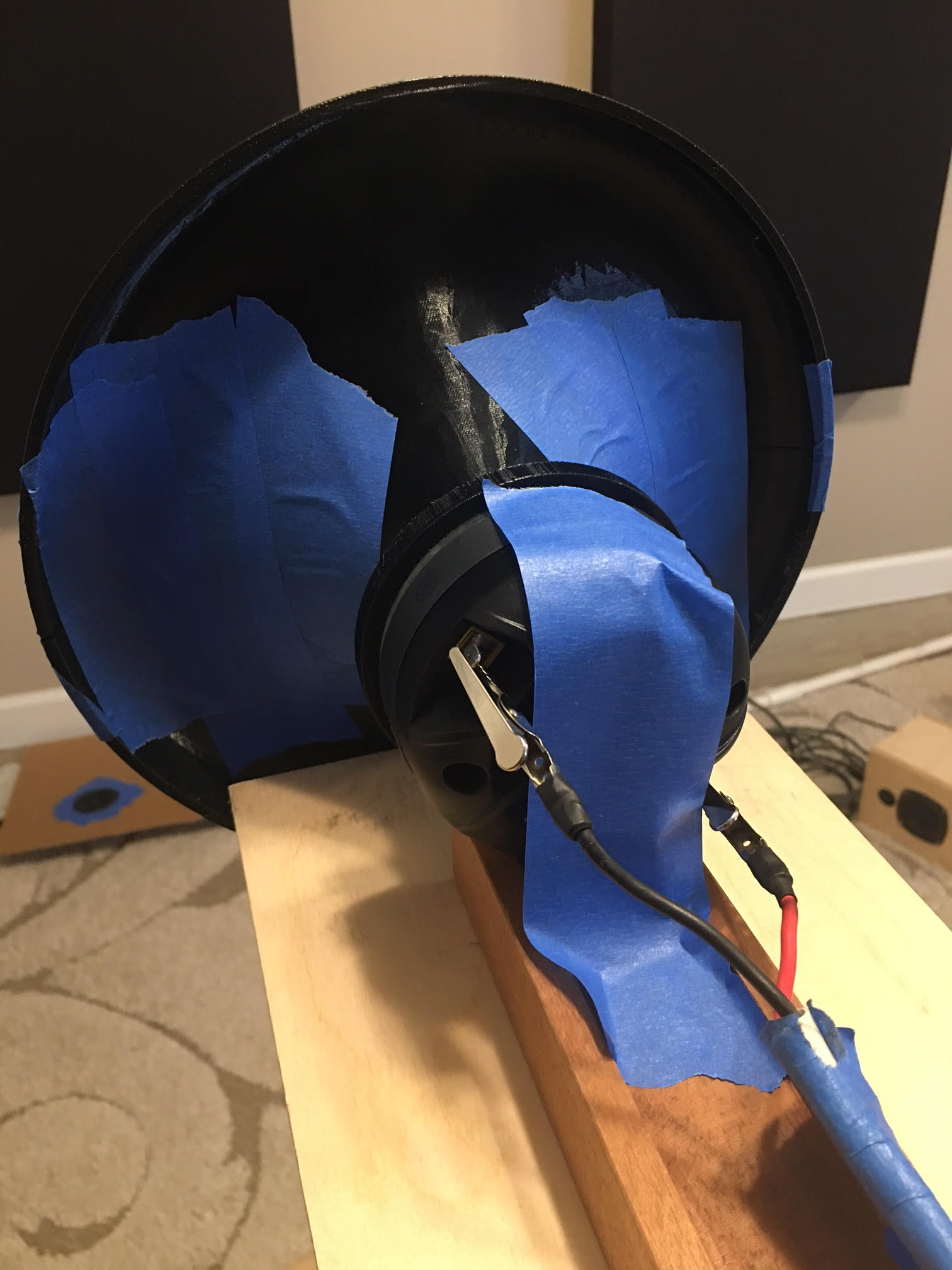

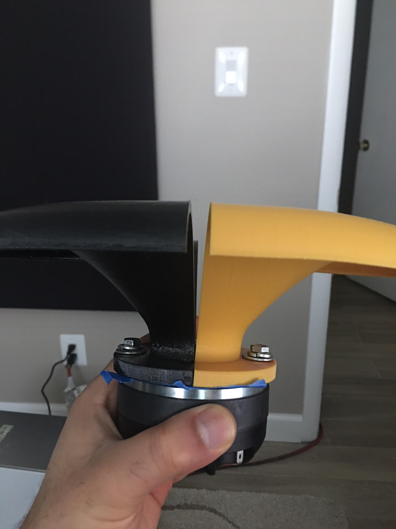

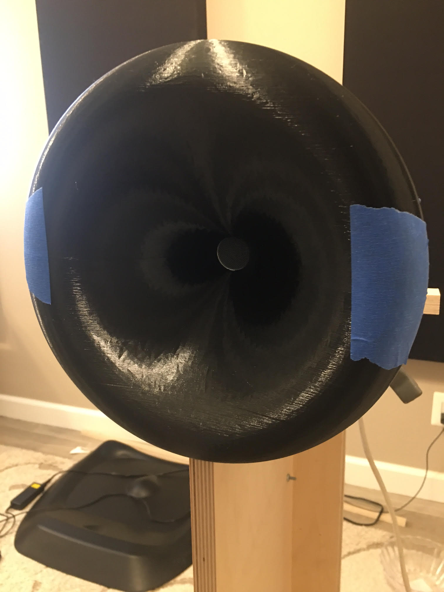

@Matab - could I make a suggestion? Is there any chance the mounting holes can be shifted by 90 degrees (or two additional 1/2 holes added) - so they print on the bed of the printer?
I know in my case I was just taping the sides together, but my concern is whether the two sides will still come apart (despite glue/epoxy) after the pressure of the bolts is applied. See included pic.
BTW - the Black is printed on Pursa by my neighbor - a successful print.
The Yellow was printed on my Ender 3 Pro - an unsuccessful print. I'm not very savvy with 3D printers or modeling and am completely new to it.

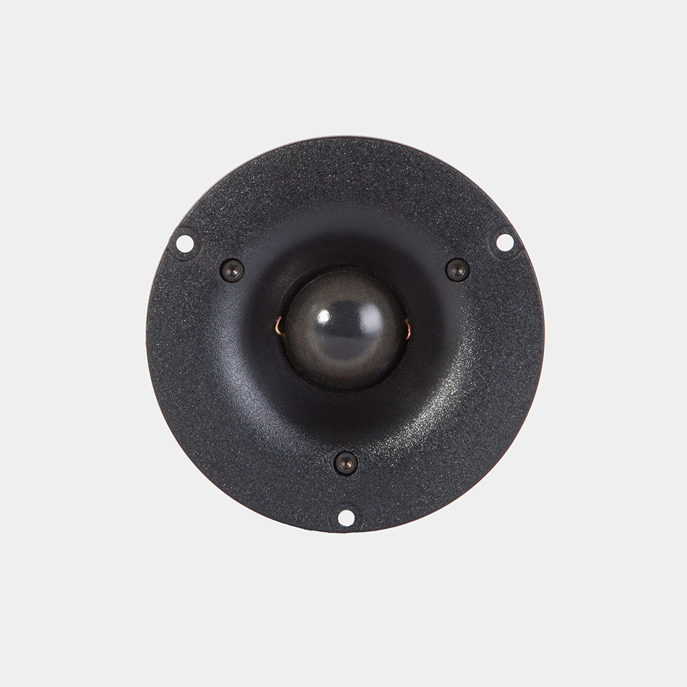

Some work better than others. The surround and - to a lesser extent - the shape / size of the dome play an important role in possible interference with the waveguide walls.
A traditional dome tweeter that pairs well with waveguides is the ScanSpeak D2604/833000.
I'm seriously considering this driver for a Living Voice IBX/OBX clone.
2 comparable tweeters with factory-fitted waveguides, but different surround-waveguide interface:
1. Morel CAT 378
2. Wavecor TW030WA11
Sure, that's no problem - www.at-horns.eu/release/ST260-19-half-rotated.zip

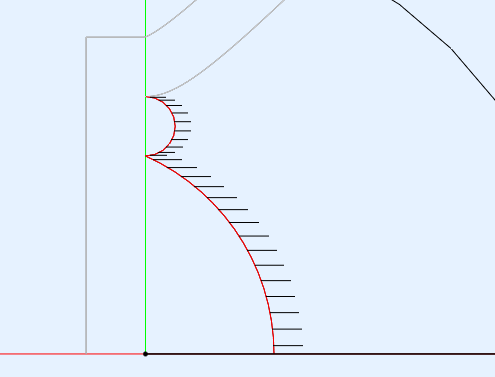

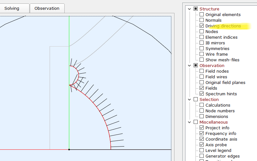

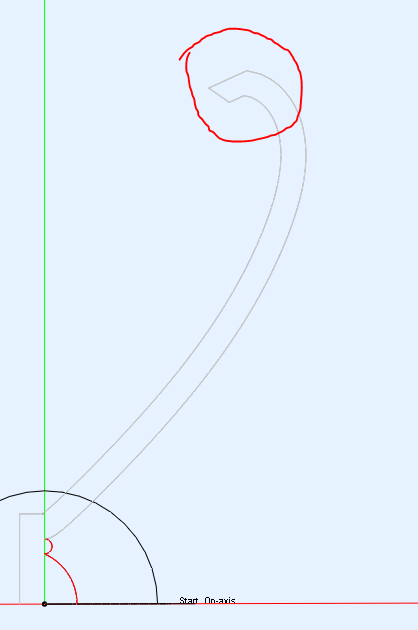

I'm trying to investigate the impact of the Rollback.Angle parameter in the freestanding CircSym mode, but no matter what value I use the end of the rollback looks discontinuous. Any ideas?
Code:
Rollback = 1
Rollback.StartAt = 0.6
Rollback.Angle = 235
Mesh.AngularSegments = 8
Mesh.LengthSegments = 100
Mesh.SubdomainSlices=
Mesh.RearShape = 1
Mesh.WallThickness = 5.0; [mm]

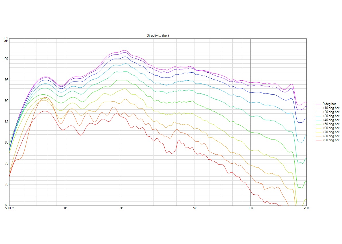

Additional Measurements

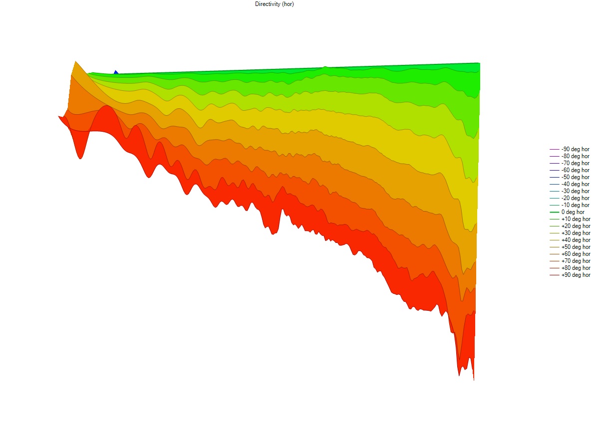

Here are additional normalized measurements (to isolate horn performance), with a slightly better-printed horn (same Peerless driver).
Thanks again. I think that better would be to normalize to 10°. If you look at the sim (#4969), just above 5 kHz there is a slight ripple on-axis. If normalized to 0° this ripple will show in all the other polars instead - that's not describing the overall behaviour very well. I know it's always difficult with normalization. Maybe you could simply show the raw data as well.
Normalized to 10 and raw
Sure, Matab.
See additional pics. Now normalized to 10 degrees, and raw.
Again - the two sides have not yet be glued - just taped together.
