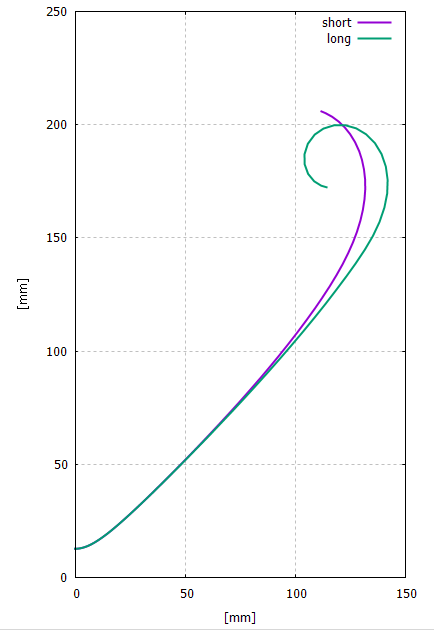

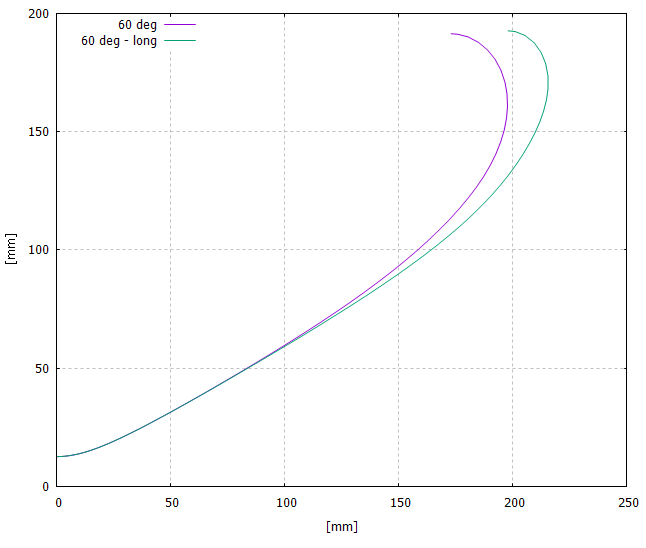

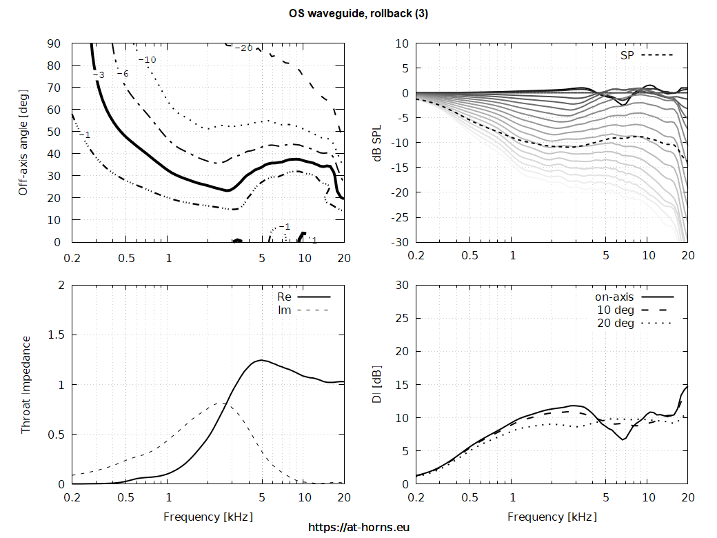

Yeah, I think it could be approximated pretty well with what I have. It may also be interesting to try optimize for an impedance target, i.e. what shape would be the result.Pas de problème 😉
No rollback -

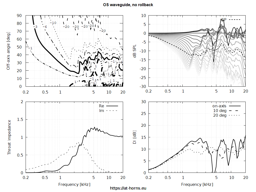

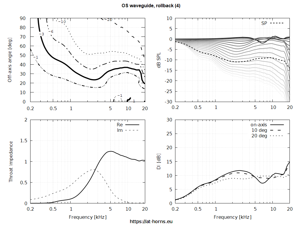

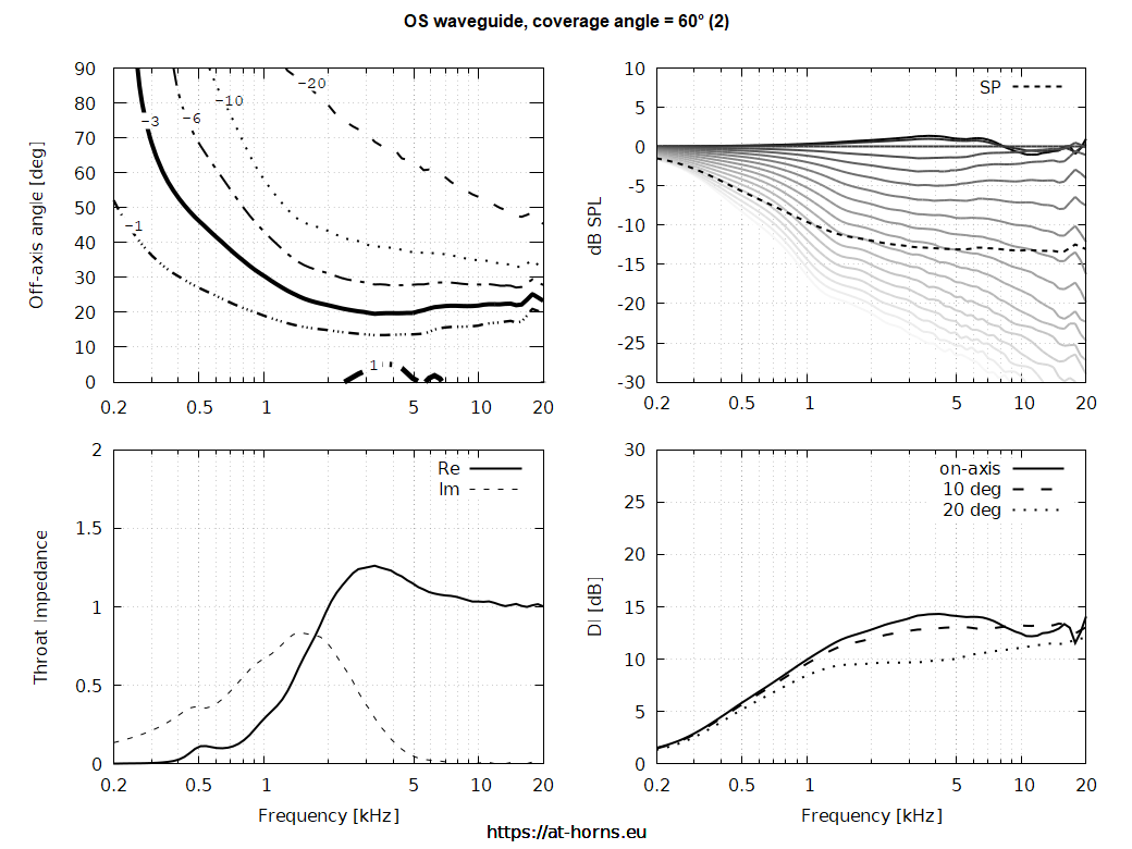

Not exactly state-of-the-art, that one... I wonder how these things measure:
But hey, if it costs xxxxxxxxxx dollars then it sounds good no matter what the measurement says!🙂

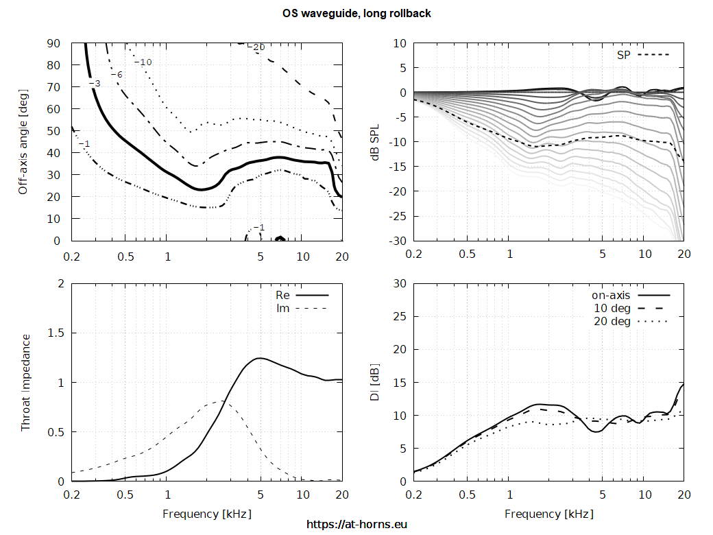

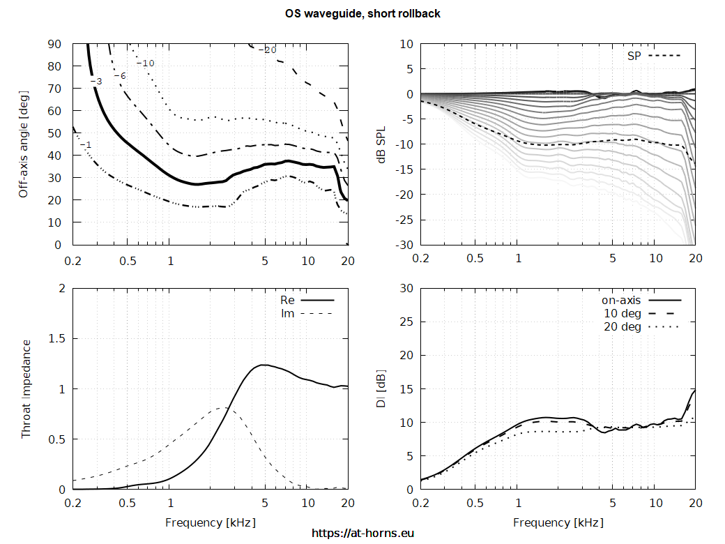

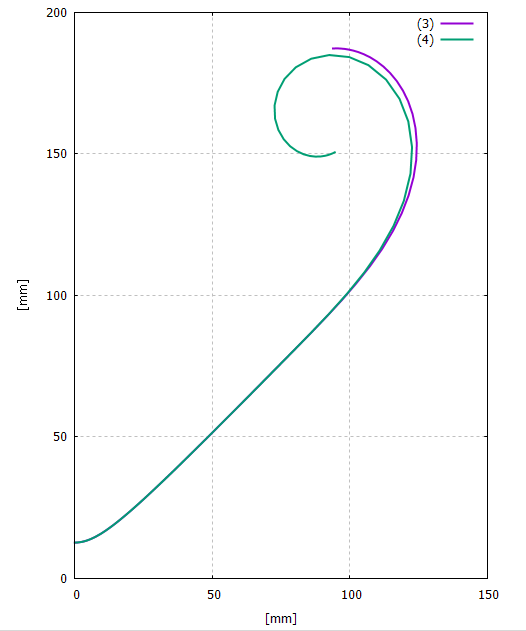

It is kind of amusing how small changes change the result so much. It looks like that any required parameters (throat size, next "way" woofer size, radiation pattern size) there is optimum shape that needs to be found out (or have you found some pattern?🙂). Great work!
I wonder how much of a difference there is to perceived sound, for example between the ones in post #4481? I think they are small.
ps. pattern control must affect quite a lot to a perceived sound quality in home, since the simple horn without mouth termination seems to sound just fine. For example most of the commercial PA speakers (waveguides) don't consider this kind of thing at all. Most home made waveguides (multiple entry horns seem to be the most popular) are made from sheet stock and people like their qualities.
