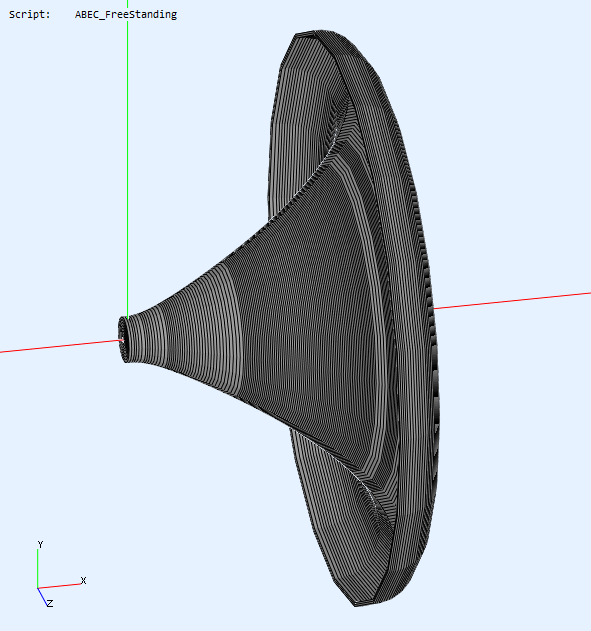

I'd like to simulate the behaviour when made from segments like on the picture but unfortunately that's not how the mesh is generated anymore... Otherwise it would be easy to make such a horn from e.g. balsa (wood) stripes.
(To explain - this is only a simplified visualization in the CircSym mode; it is actually solved for a perfectly axisymmetric shape, not segmented like this.)
Darn! When I saw those pictures last night I had similar thoughts re. making a "petal horn" with the technique you describe.

I could make an output of the templates for the unfolded petals if there was an interest. We have the profile templates already.Darn! When I saw those pictures last night I had similar thoughts re. making a "petal horn" with the technique you describe.
Bill

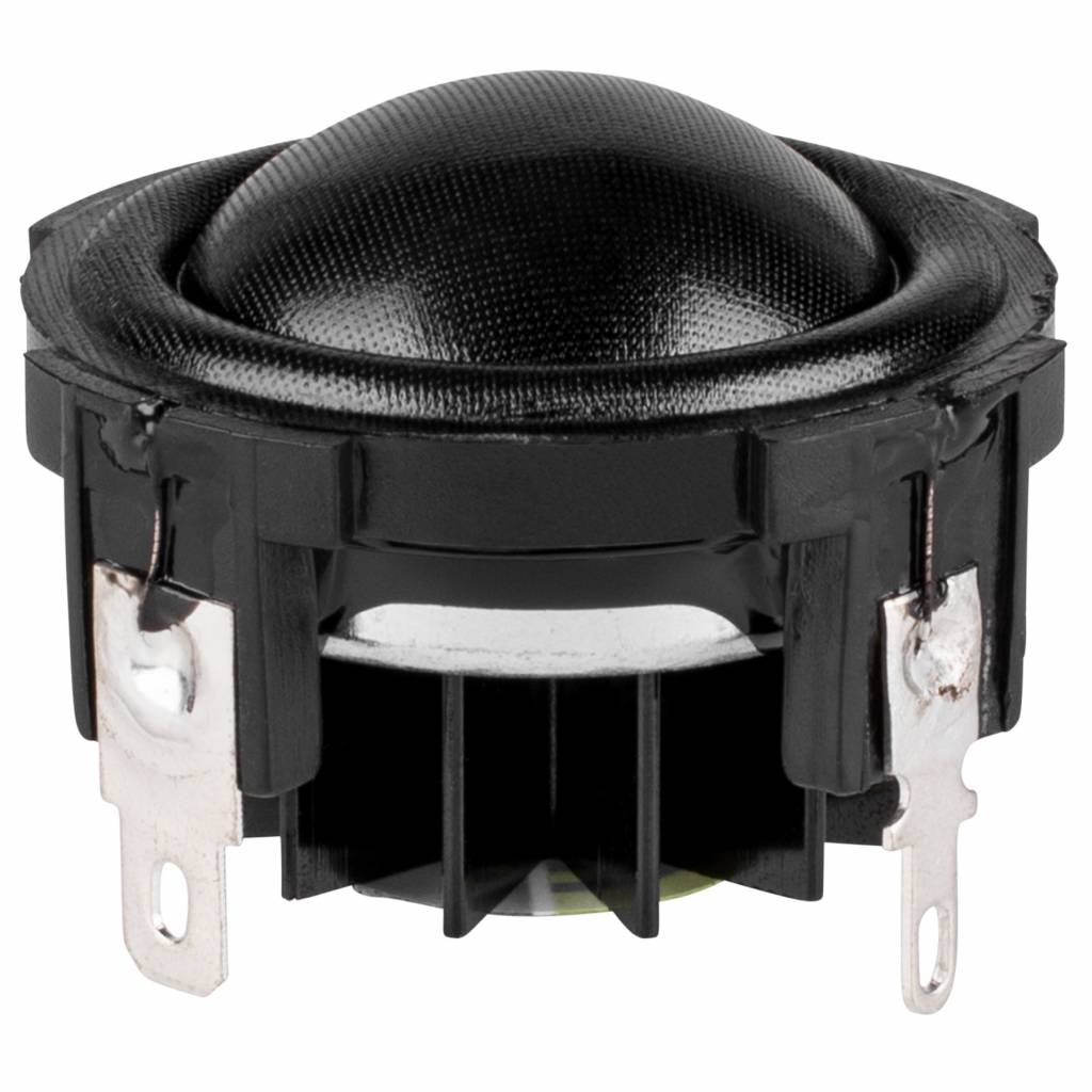

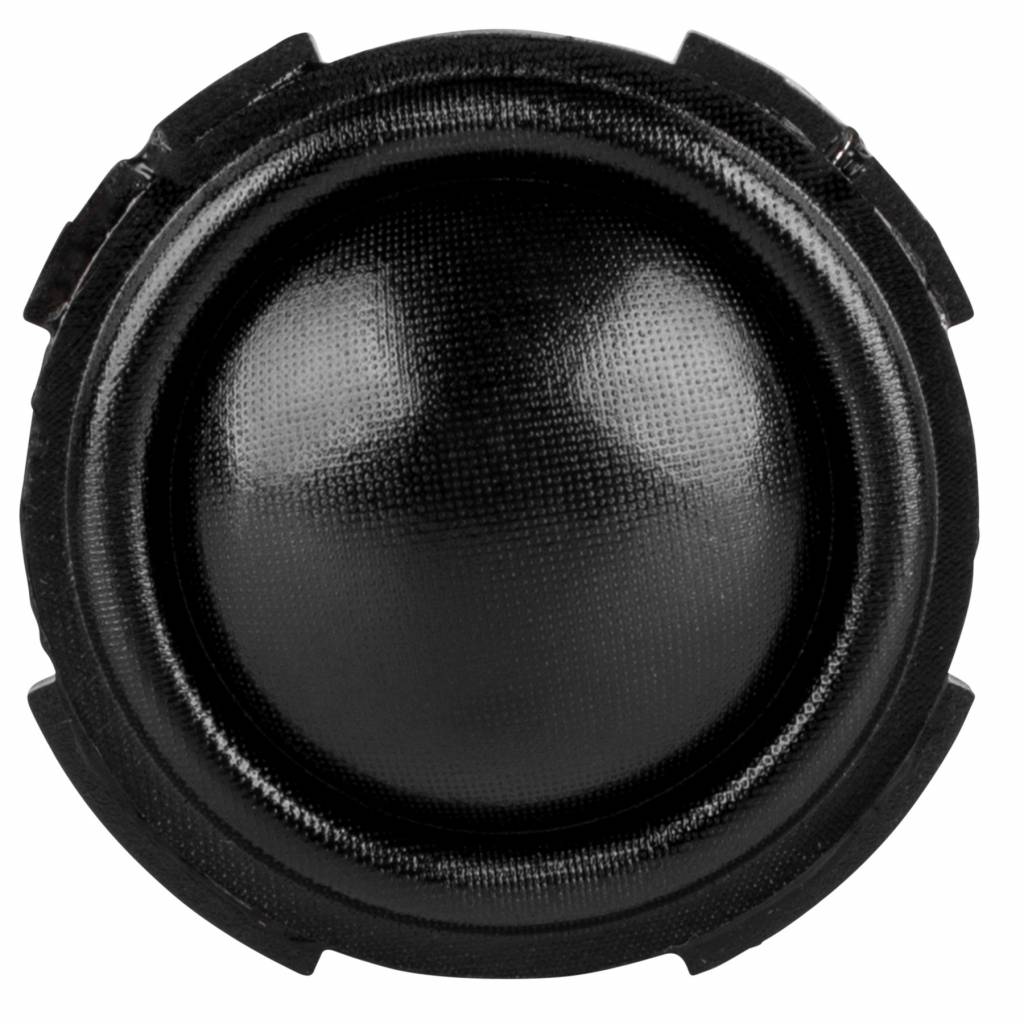

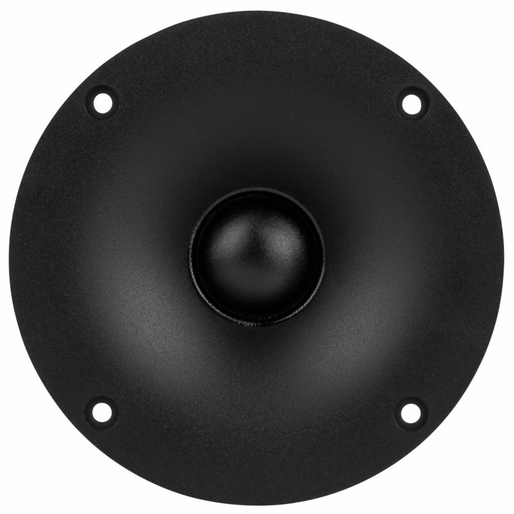

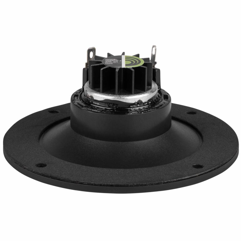

Dayton ND25FN(aked) versus ND25FW(aveguide).
dayton-audio-nd25fn-4-1-silk-dome-neodymium-tweete-2.jpg103.7 KB · Views: 316
dayton-audio-nd25fw-4-1-soft-dome-neodymium-tweete-2.jpg75.8 KB · Views: 322
dayton-audio-nd25fw-4-1-soft-dome-neodymium-tweete-1.jpg52.6 KB · Views: 131

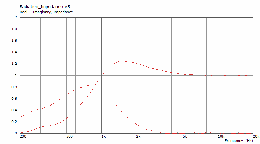

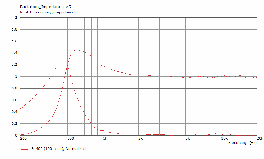

So the constant impedance isn't that important after all, is it.
The radiation impedance level is not so important because the efficiency of the system is so low. A change in rad imp of 20% will only equate to something like 1 dB of output.
Now when this impedance drops to near zero, then we call that "cutoff" and it makes a big difference.
What has major effects is an electrical impedance that swings due to internal resonances. This is a big problem with a passive crossover.

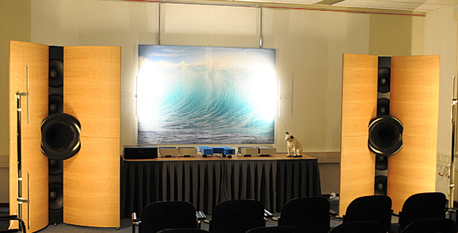

If you don't mind beaming and are willing to host a giant horn, it's perfectly possible.

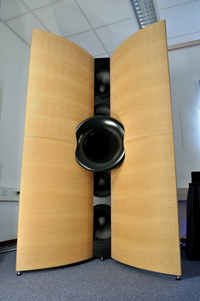

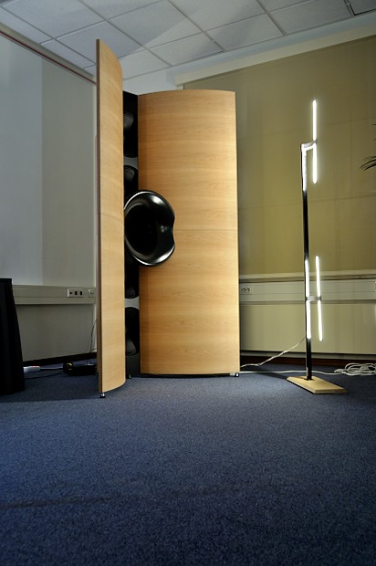

This fully horn-loaded prototype loudspeakersystem - developed in just 2 months, was voted 'best-of-show' by most visitors almost 10 years ago.
It's capable of 15Hz>20kHz, but was tuned slightly higher (20Hz). Crossover to the mid/high horn was 270Hz.
I remember seeing that one at the time!
Bill
Take my word for it, that system didn't suffer from any 'noticeable' crossover artefacts.
There are only 2 horns involved, however, for the mid/high horn a modified BMS Coaxial is used.
The OB horn is quite special, it's designed to cancel room modes.
The guys could almost literally shake the hotel where the show took place, though without annoying adjacent rooms - contrary to the top-of-the-line PMC large format studio monitors, that were also demoed.
The designer has expressed interest in OS horns, after a client of his built Summas and praised the wide coverage of the system.

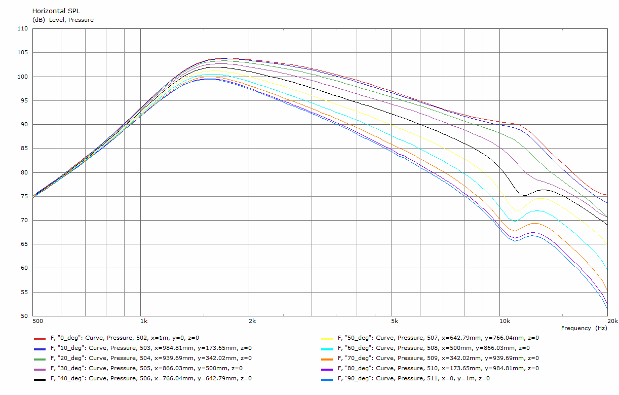

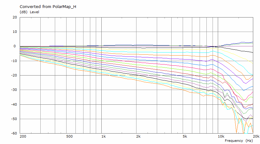

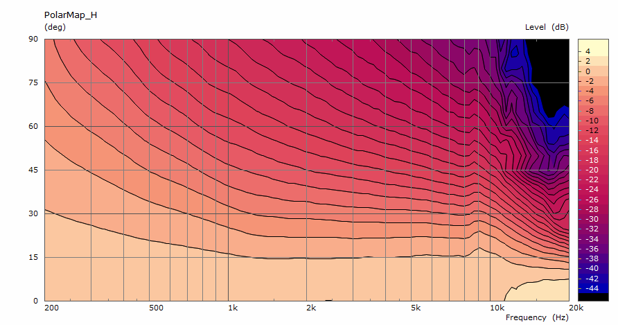

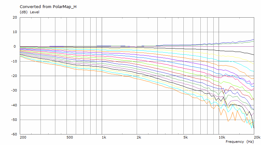

Well this is about the kind of beaming you would have to accept if you used a 2" driver like the big Celestion, at least without employing any diffraction techniques. This is about the best I can get out of it - maybe someone else could do better. Honestly, I don't know if this is exactly what to go for. Maybe.
(⌀800 x 376 mm).
(⌀800 x 376 mm).
The real part is pure efficiency - right? But how about the reactive part - isn't that a bit more problematic as it changes the phase?
