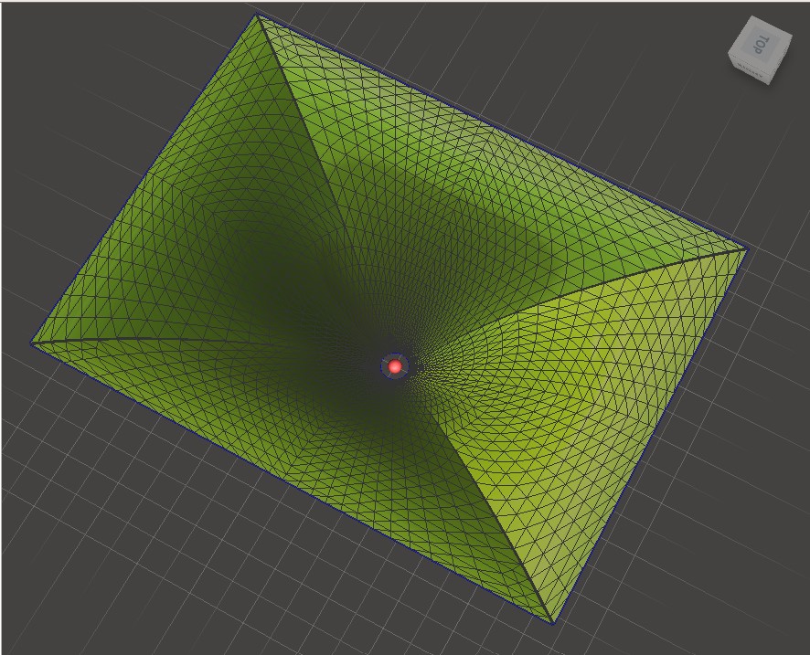

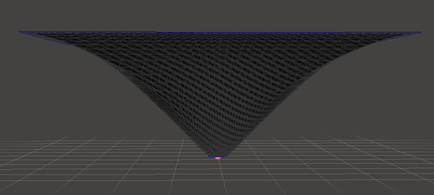

Does anyone know a trick or plugin or something how to get cut sheet for bent panels? In other words, If I model such a horn that could be made with 4 bent plywood pieces, how to cut the correct size pieces?

Solidworks can only flatten surface not plate (have not tried metal sheet module). Blender maybe?
Hornresp can generate rectangular horn panels, but only for the profiles you can model in it.

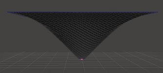

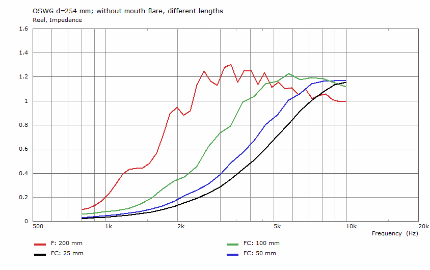

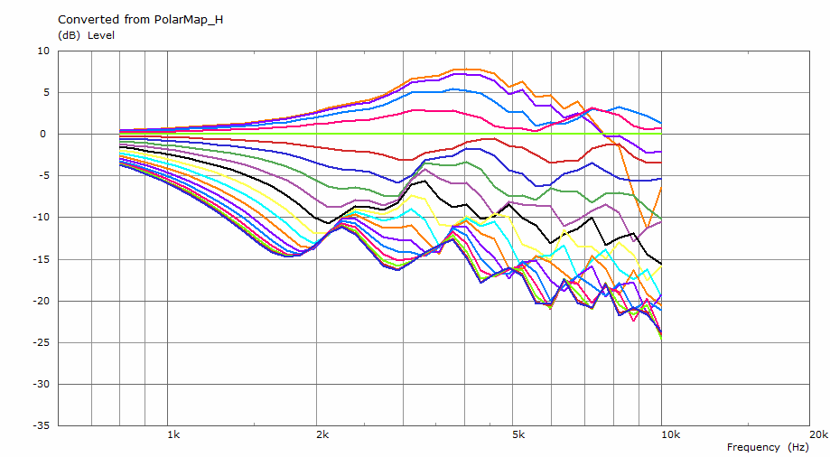

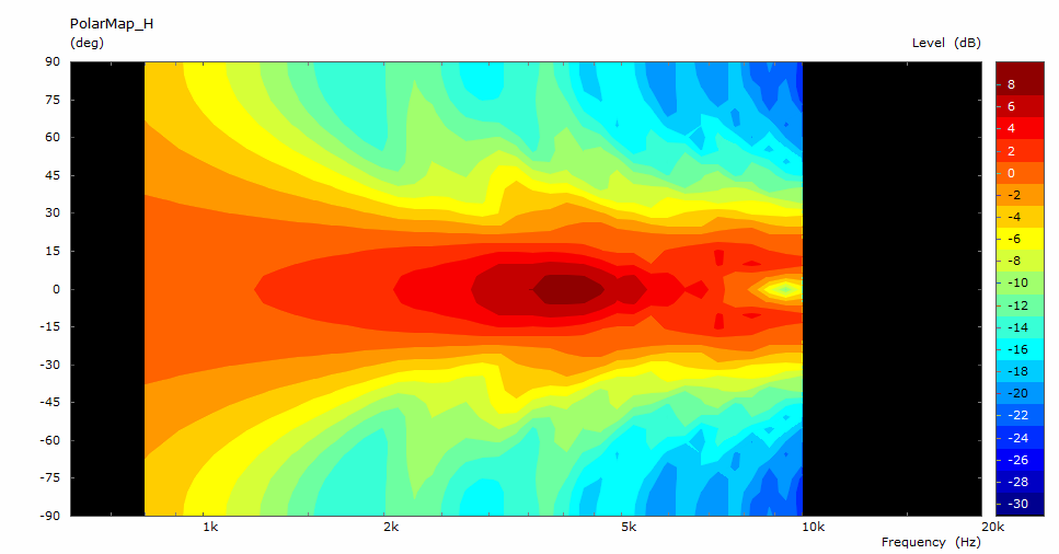

Here is the project file in case anyone would want to try various mouth terminations to see the effect:
Geometry.Definition = 2
Throat.Profile = 1
Throat.Diameter = 25.4 ; [mm]
Throat.Angle = 0 ; [deg]
GCurve.Type = 1
GCurve.Width = 254
GCurve.SE.n = 2
Length = 200 ; [mm]
Term.s = 0.0
Term.n = 4.0
Term.q = 0.996
; Mesh Setting
; ABEC
Mesh.AngularSegments = 100
Mesh.LengthSegments = 20
Mesh.ThroatResolution = 4.0 ; [mm]
Mesh.InterfaceResolution = 7.0 ; [mm]
Mesh.InterfaceOffset = 5.0 ; [mm]
Mesh.ZMapPoints=0.5,0.2,0.7,0.7
; ABEC Project Setting
ABEC.SimType = 1
ABEC.f1 = 800 ; [Hz]
ABEC.f2 = 10000 ; [Hz]
ABEC.NumFrequencies = 40
ABEC.MeshFrequency = 1000 ; [Hz]
ABEC.Polars.Dist = 2.5 ; [m]
ABEC.Polars.Step = 7.5 ; [deg]
ABEC.Polars.Points = 8
ABEC.Polars.Horizontal = 1
ABEC.Polars.Vertical = 0
ABEC.Polars.Diagonal = 0
ABEC.Polars.DiagonalInclination = 0.0
ABEC.Polars.PMapNorm = 20
; Output
;Output.DestDir =
Output.STL = 1
Output.MSH = 0
Output.ABECProject = 1
Output.Coords = 0
Throat.Profile = 1
GCurve.Type = 1
GCurve.Width = 254
GCurve.SE.n = 2
Length = 200 ; [mm]
Term.s = 0.0
Term.n = 4.0
Term.q = 0.996
; Mesh Setting
; ABEC
ABEC.SimType = 1
; Output
;Output.DestDir =
Output.STL = 1
Output.MSH = 0
Output.Coords = 0

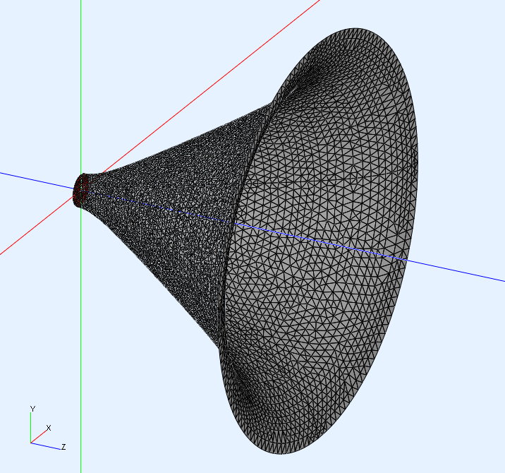

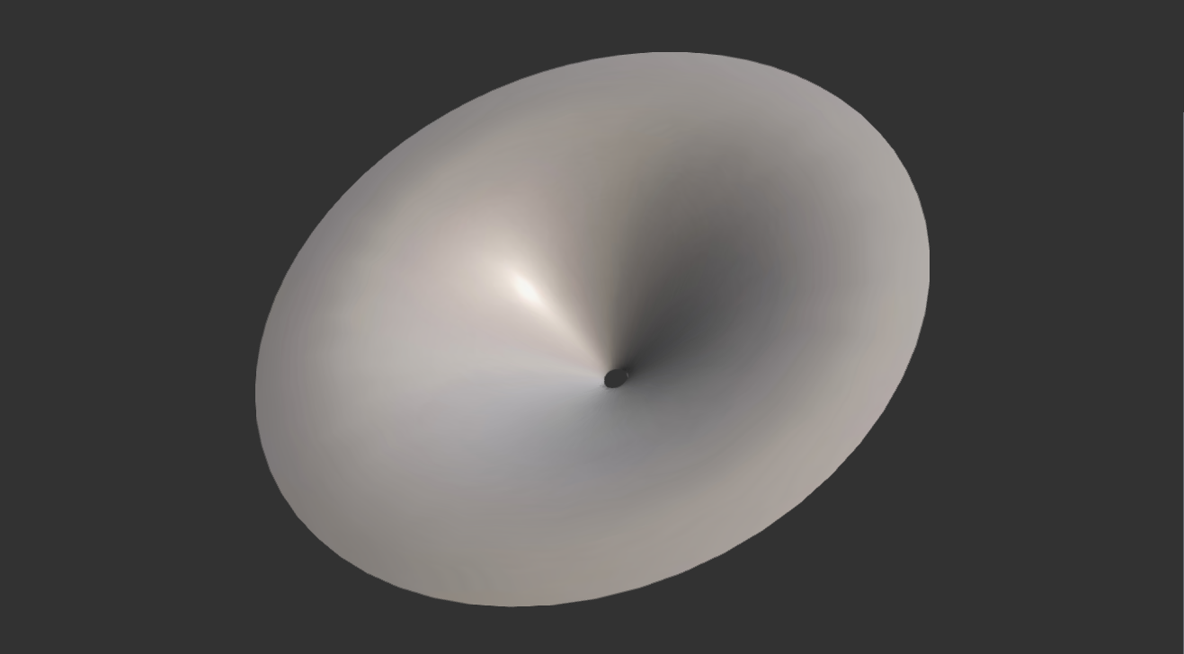

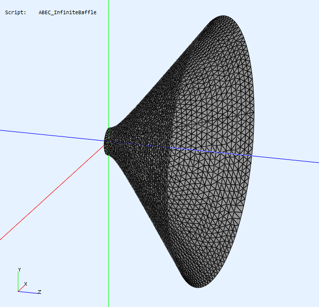

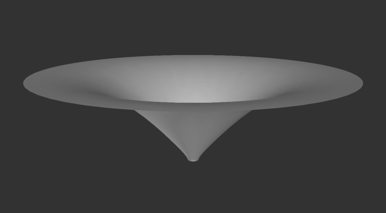

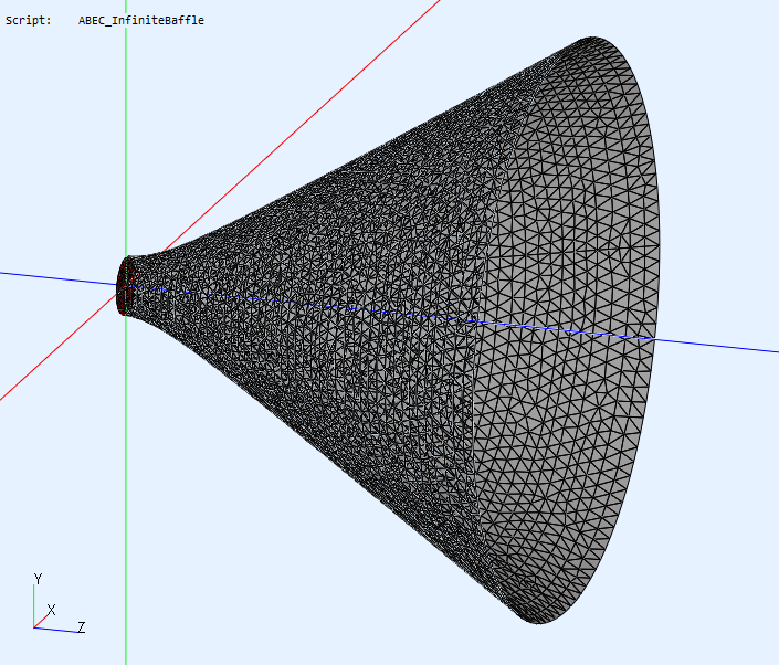

If someone wants to sim a big waveguide, this one's 63.3 cm Ø.
Changing the coverage (half) angle to 40 results in 569.7 mm (22.429") Ø.
Geometry.Definition = 1
Throat.Profile = 1
Throat.Angle = 15.5 ; [deg]
Coverage.Angle = 45
Length = 200 ; [mm]
Term.s = 0.8
Term.n = 4.0
Term.q = 0.998
Morph.TargetShape = 0
Rollback = 1.8
Rollback.StartAt = 0.8
Rollback.Rate = 0.08
; Mesh Setting
Mesh.AngularSegments = 64
Mesh.InterfaceResolution = 8.0 ; [mm]
Mesh.RearShape = 1
Mesh.RearResolution = 10.0; [mm]
Mesh.WallThickness = 5.0; [mm]
Mesh.ExteriorSegments = 0
Mesh.InterfaceOffset = 12.0 ; [mm]
ABEC.SimType = 2
ABEC.f1 = 1000 ; [Hz]
ABEC.NumFrequencies = 20
; Output
Output.DestDir = "C:\Horns\Demos" ; current directory by default
Output.STL = 1
Output.MSH = 0
Output.Coords = 0

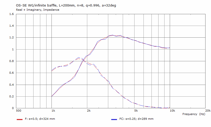

... and now with a smooth termination added, two cases for s=0.25 and s=0.5 (length 200 mm and coverage angle 64.5 deg fixed):Not that it is any interesting but this is the polar map for the longest one, i.e. ⌀254 x 200 mm. Of course this is not how to do it 🙂
