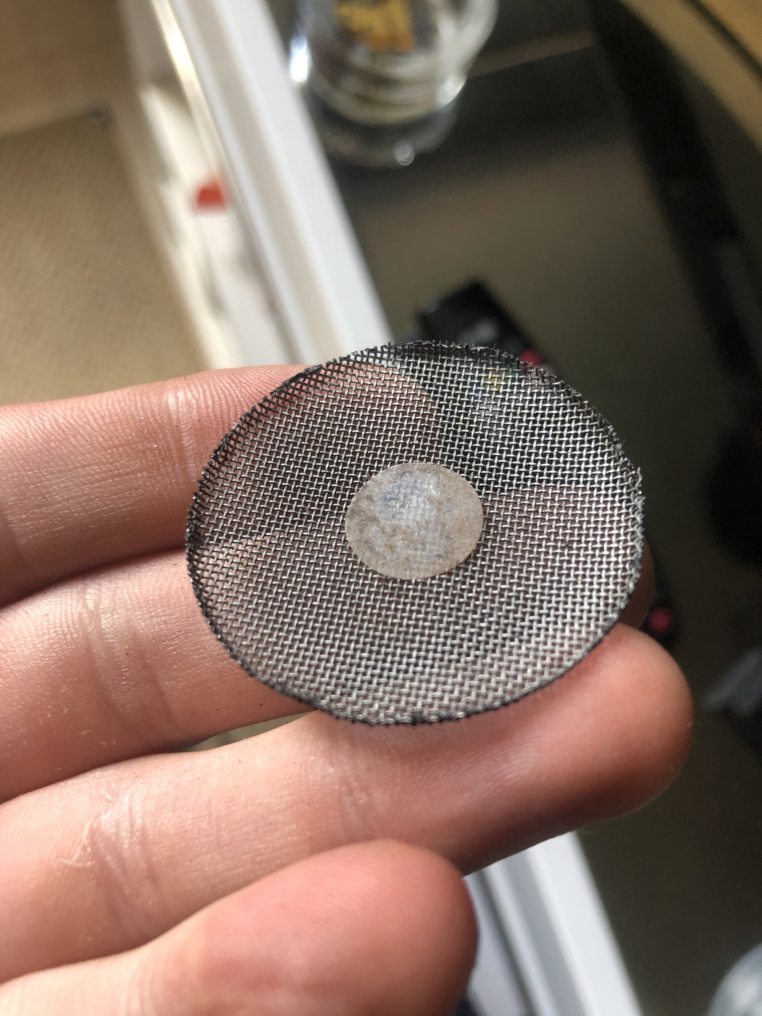

In case of the H1212 waveguide, there's obviously something happening above 10 kHz that is not covered in the model. I wonder what that could be and whether we are able to include it. That would be interesting to find out. So is it something about the hard vs. soft dome?
The (unmodified) SEAS 27TBFC (H1212) comes with a clear plastic disc below the grid, which helps to improve dispersion characteristics.
Or, to quote the designer:
"The plastic lense or diffusor is there to lift the frequency response between 15 and 20kHz."

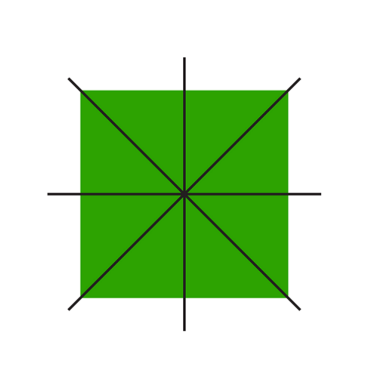

Beneficial how? I was under the impression that a fully symmetrical waveguide would produce the best total response in the listening window. I'd love to learn more!
You mean axisymmetrical (i.e. 'round') waveguide?
A symmetrical waveguide would be square, for instance 60 x 60°.

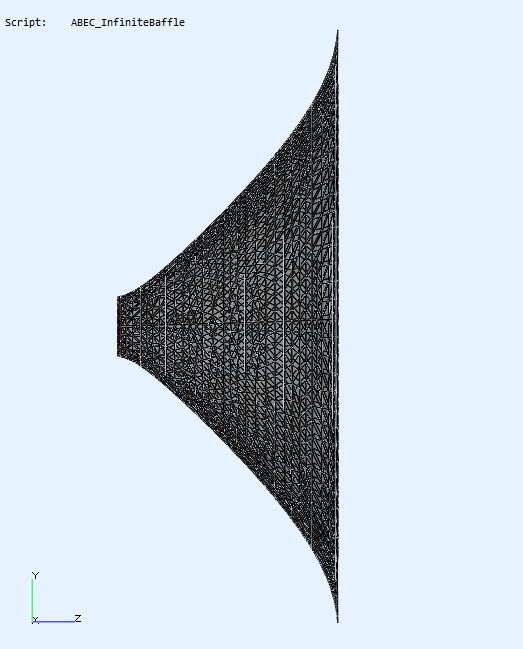

Actually, I've been playing around with CircSym for a while (again) and it's really the way to go for axisymmetric devices. It can be made precise enough by increasing the mesh resolution greatly - as I realized later, there's absolutely no problem going to 50 kHz or more, it still solves even big waveguides in minutes without a glitch up to 20 kHz (something unthinkable with a full 3D sim in ABEC). As I also intend to make a really good big free standing axisymmetric waveguide, CircSym is almost a must - currently I'm implementing the option.
For an experiment you suggest, it would be the perfect method.

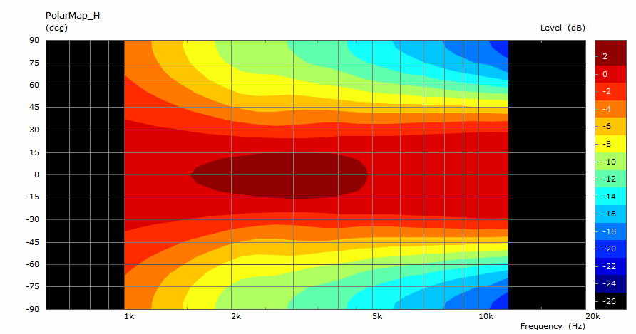

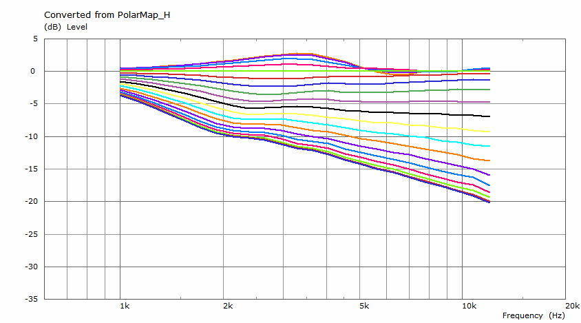

BTW, these are the BEM results for the "demo1" example included in the Ath package (OS waveguide ⌀254 x 94 mm in an IB) - for a demo I wanted something that solves in a short time, this one takes 5 minutes on an ordinary PC.
Maybe it could be still improved as axisymmetric of the same size, I don't know, I've only put together some numbers.
