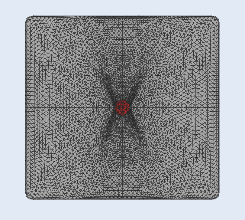

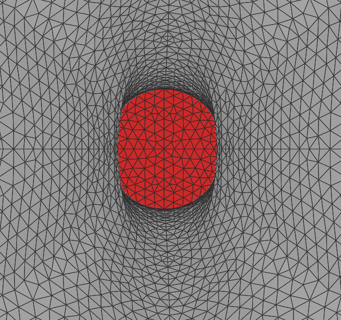

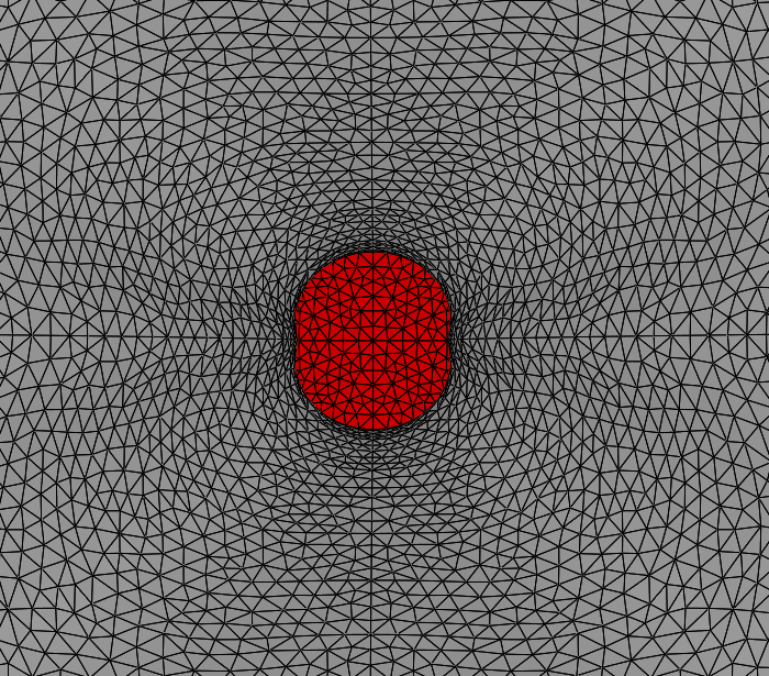

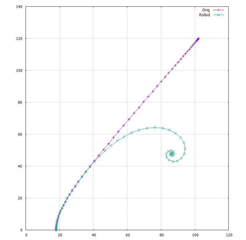

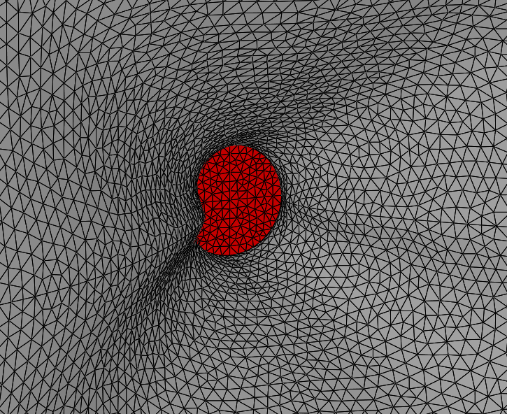

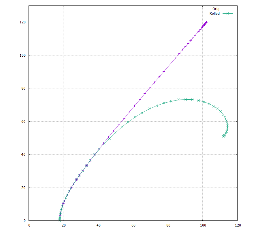

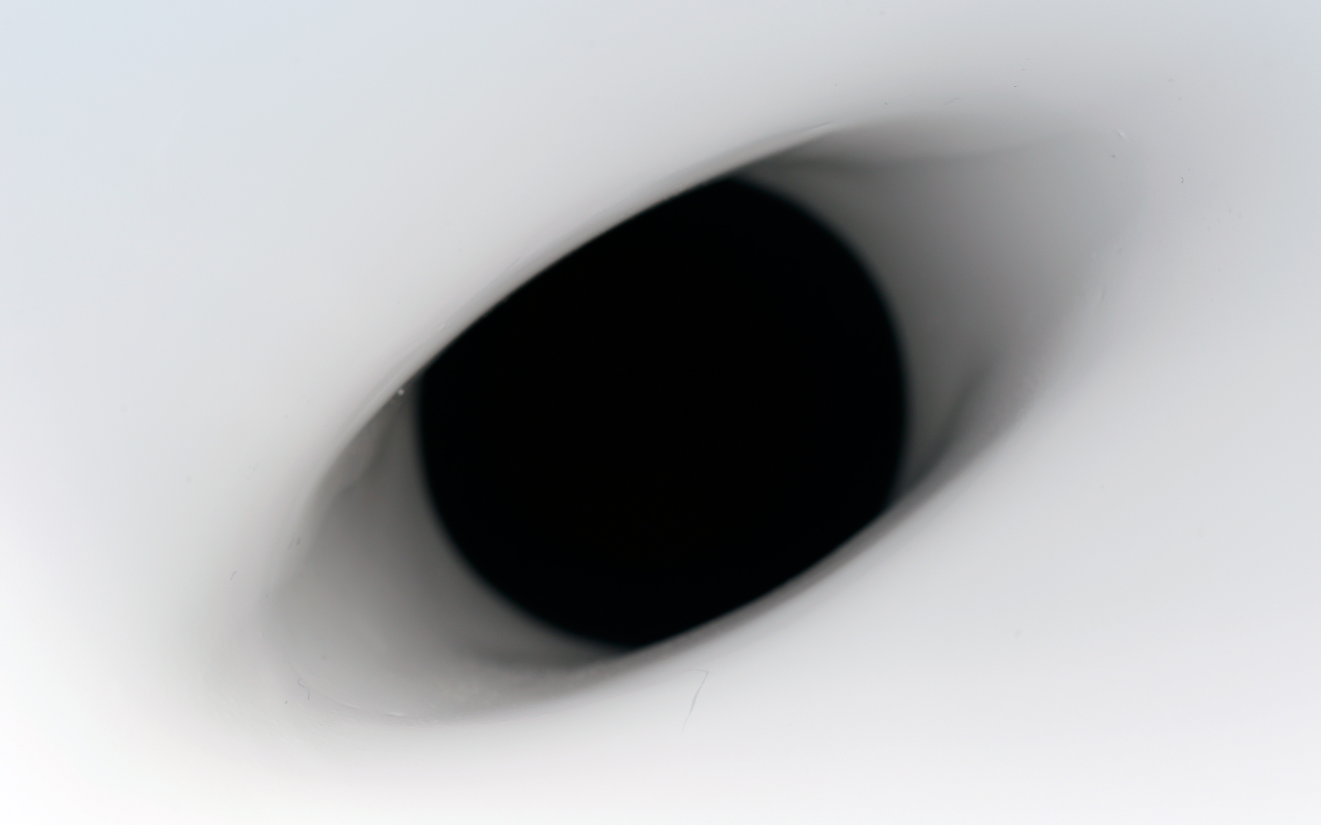

Suggestion: try to morph the throat into an ellipse which opens into an rectangular mouth.

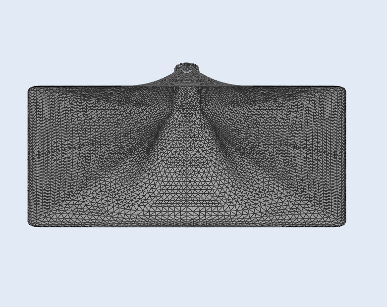

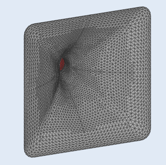

I've already simulated some. So far nothing worth talking about, really.

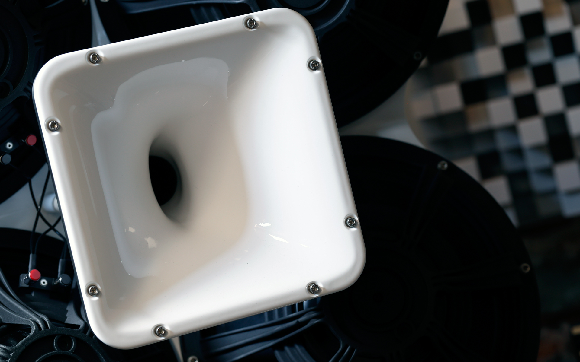

It seems you've pretty much cloned the throat of the 18Sound XR-series.
I don't know, I haven't found it doing anything really useful. The above was 1,4". I have seen better without narrowing the throat.
I even tried to incorporate it in some of my better designs - it was always worse.

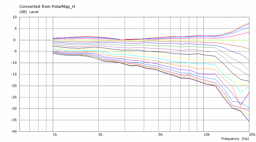

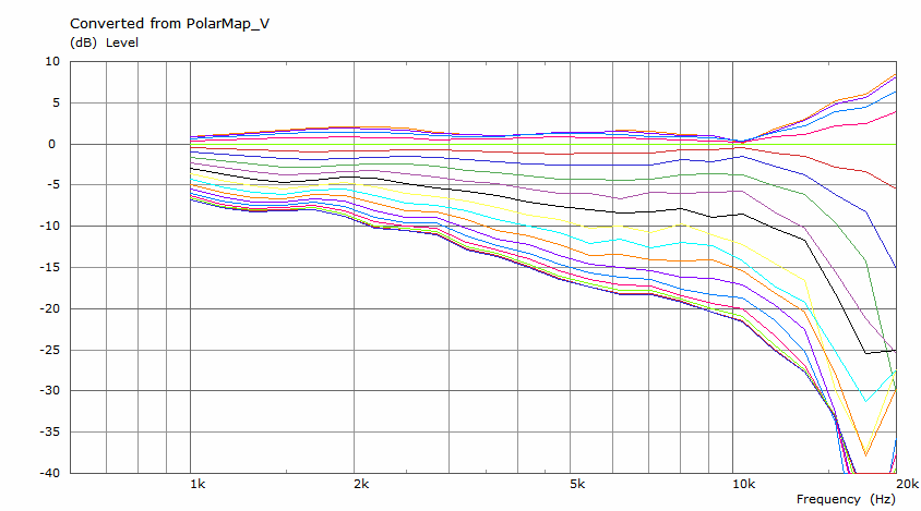

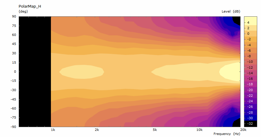

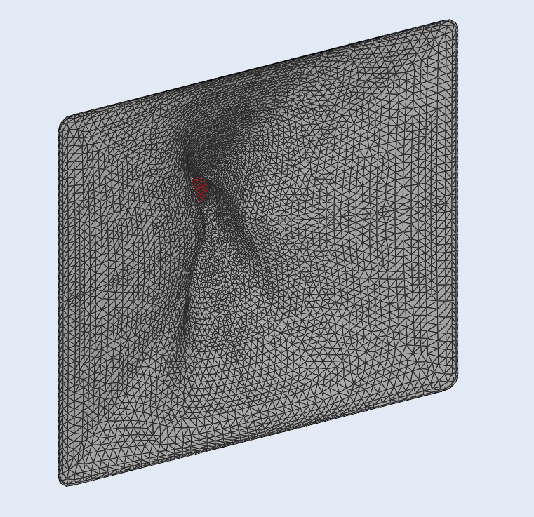

I expected some improvement wrt pattern control in the vertical plane. Your waveguide appears to be 60x60°, so it's hard to tell if this is the case.
Anyway, it's probably not worth further exploration.
Vertical? I'd expect horizontal, and maybe it is, up to a point, but it doesn't come without drawbacks. What I showed is about 90x80°.

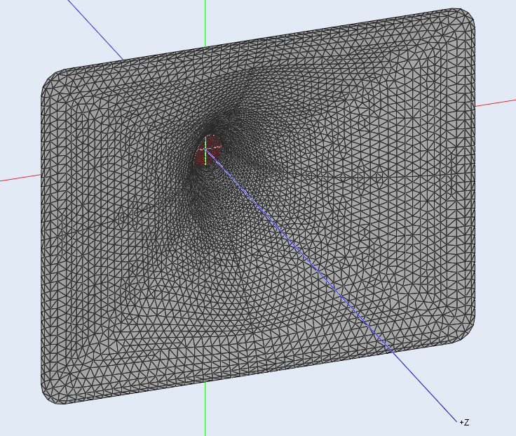

My focus now will be the phase plug.
90x80° is almost symmetrical, but at least there seems to be no pattern flip.
You polars are somewhat better than those of 18Sound.

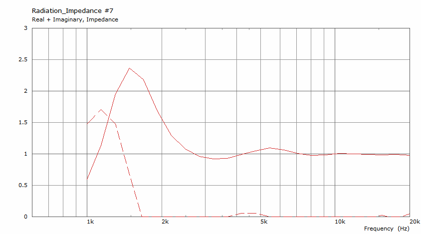

If 1200 hz is possible w/o horn, how low do you expect it to go horned ?
