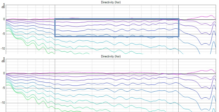

alright so what is the coverage angle of this horn and it's bandwidth?
As seen from the measured data, it has a remarkably stable 100° beamwidth between 1 - 10 kHz, which smoothly widens below that and narrows above that, as for any such horn. It's almost without any diffraction noticeable on the frequency response. That's simply a good waveguide in my book. There won't be many like this one.

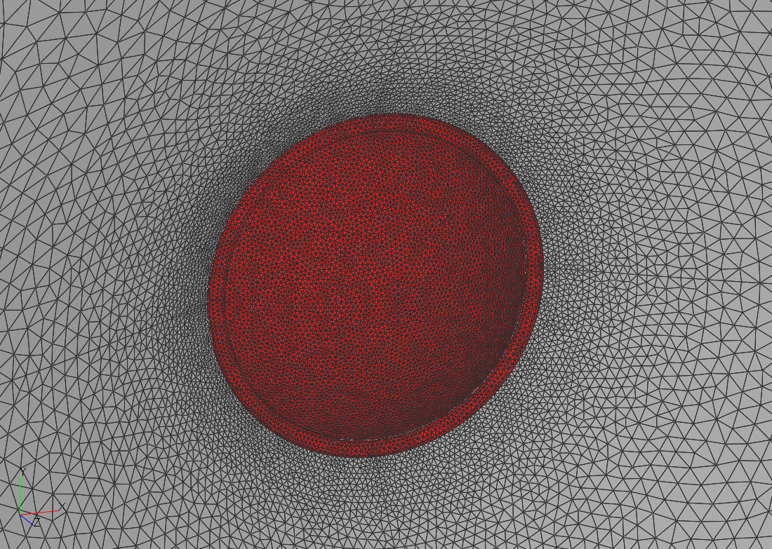

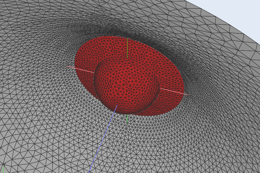

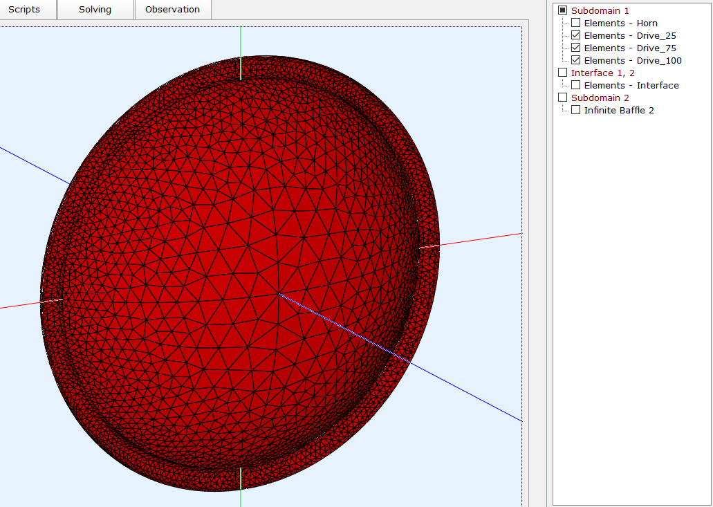

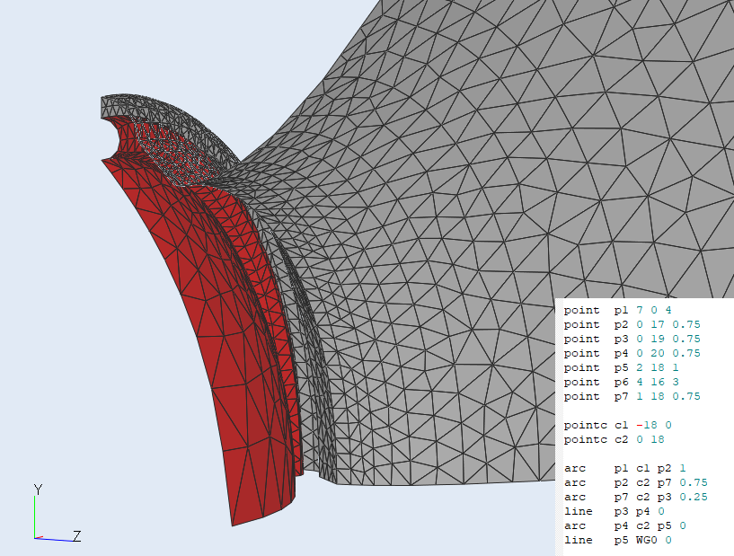

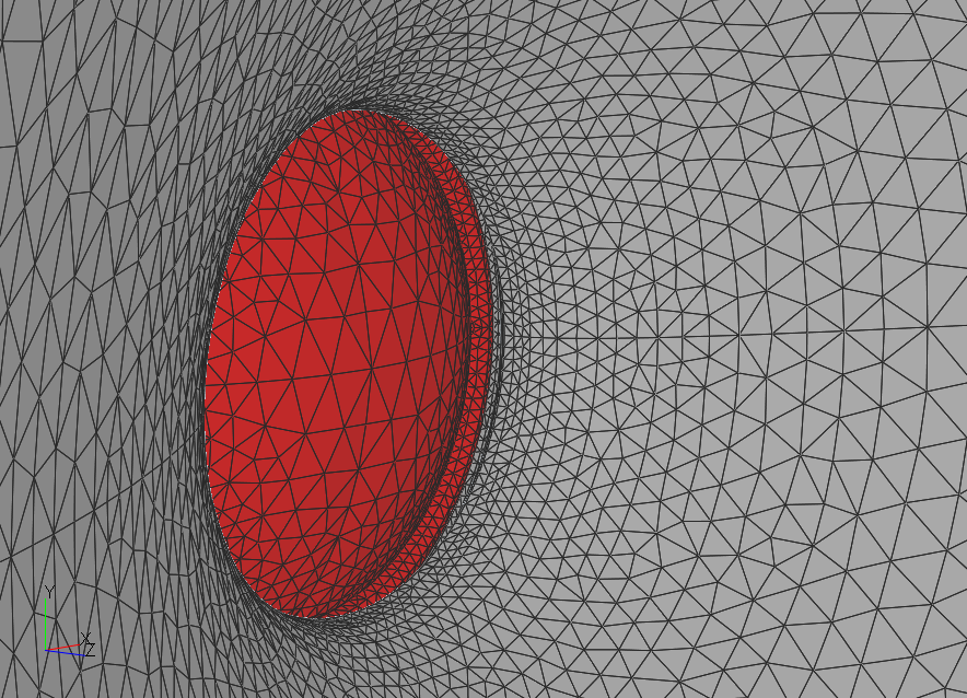

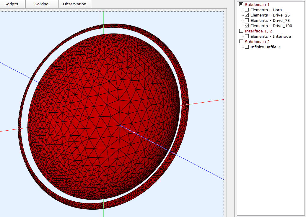

As for simulating dome tweeters, ABEC allows to define different weights to different driving elements. This is what I did - I set a lower weight for the surround. In this case the surround is divided into two rings of weights 0.75 and 0.25 respectively. Maybe one ring at 0.5 would be sufficient, I don't know, could be checked. The weights are set in the script file, along with the whole dome geometry, or whatever it is.

I assume this weighting is there to account for the fact that the outer edge of the surround is not moving, and you can gradually include the surround geometry until you reach the point where the driving force of the voice coil defines the dome movement?

I guess the match with reality mainly depends on how closely the diaphragm maintains a pistonic motion.

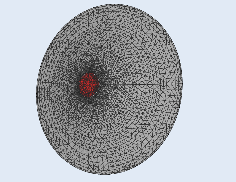

Anyway, now the tool is much more suitable for simulating dome tweeters - even something like this is now easily possible to test:
