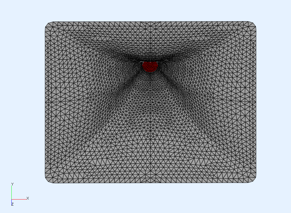

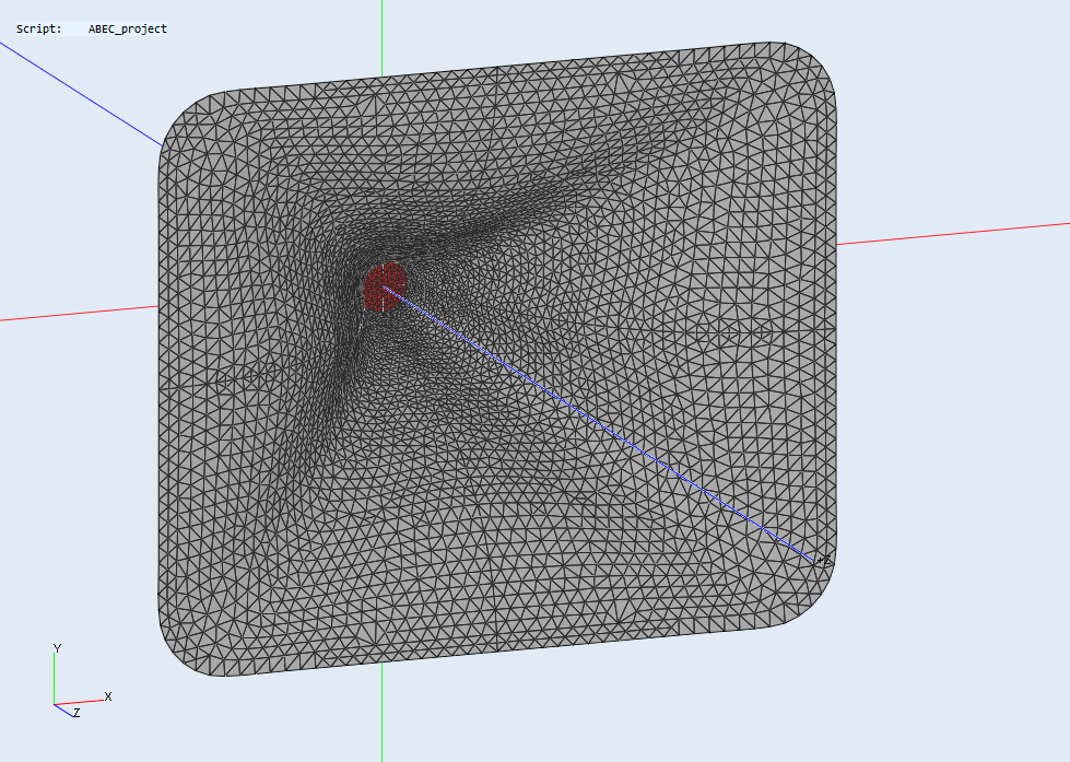

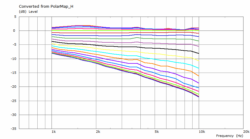

That is a fairly complex set of parameters from the looks of it. Very gradiual mouth curve horizontally, and quick transition from round to rectanggular. And the dimensions? - I thought you where all about flat(ish) DI waveguides (same vertical/horizontal directivity)?
Actually, I think the DI will be pretty flat, at least for the first one shown (the widest beamwidth). This is still something I need to implement and show in VACS - the DI curve. From the polars I'd say it shouldn't be much different horizontally and vertically either. There's a difference but not a huge one.

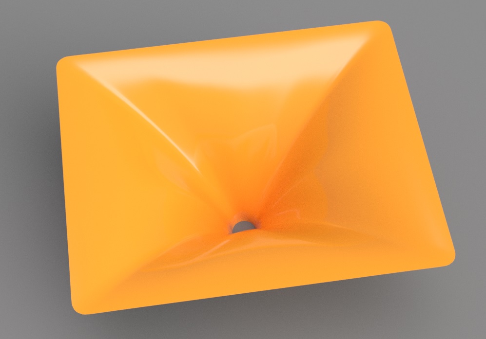

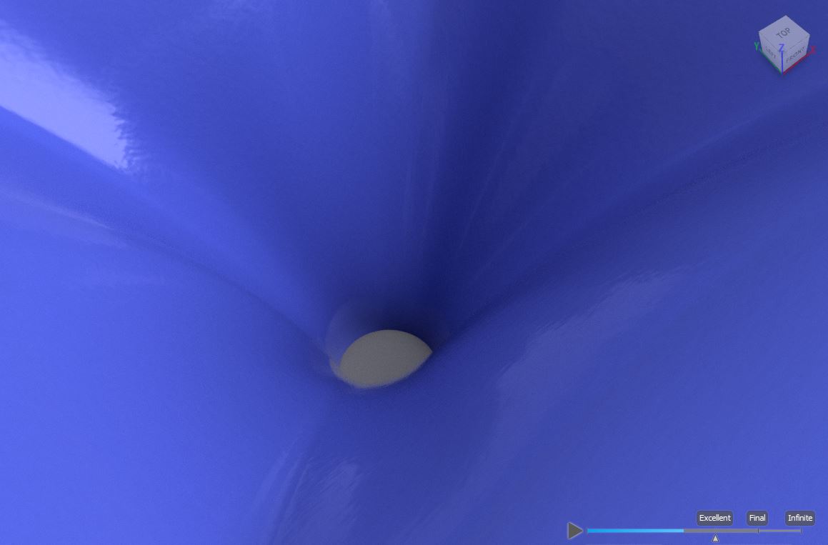

Renders of the deepest one -

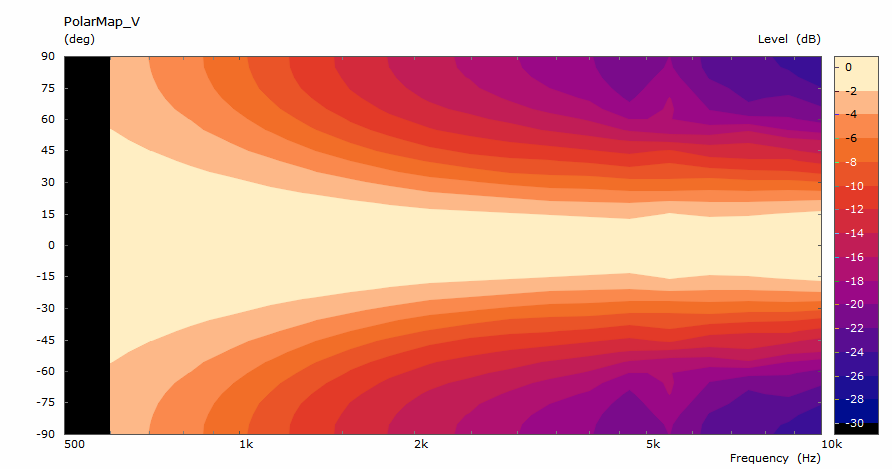

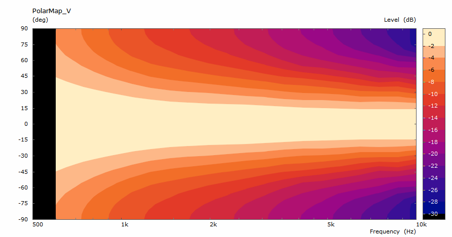

Thanks for posting the sims.

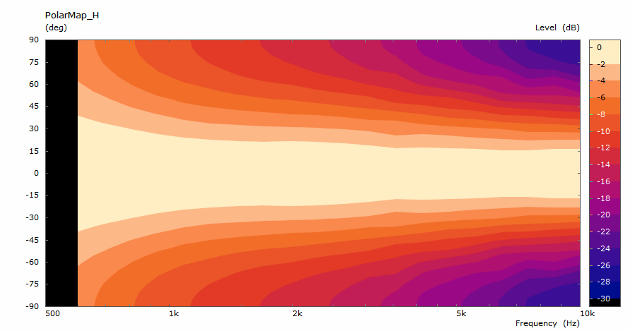

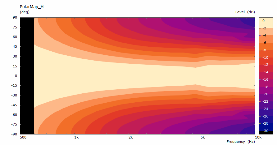

Your shallow wg looks exceptionally smooth, even far off-axis.
I suppose the irregularities in the latest sims may be artefacts that not really matter?

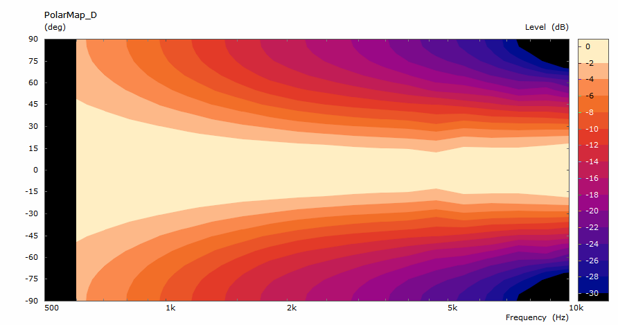

The latest p-map looks exceptional too.

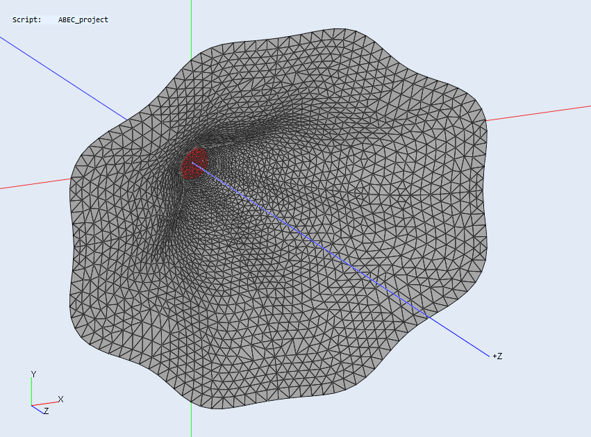

Yeah, that is still due to the coarse mesh, I didn't want to wait too long. Sometimes it's cleaner, sometimes there are defects like these on various frequencies. I'm already used to "look through" them...I suppose the irregularities in the latest sims may be artefacts that not really matter?

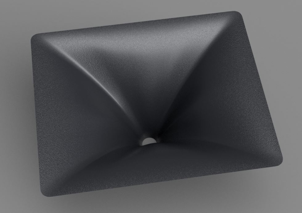

Two more... still experimenting with Fusion. 🙂

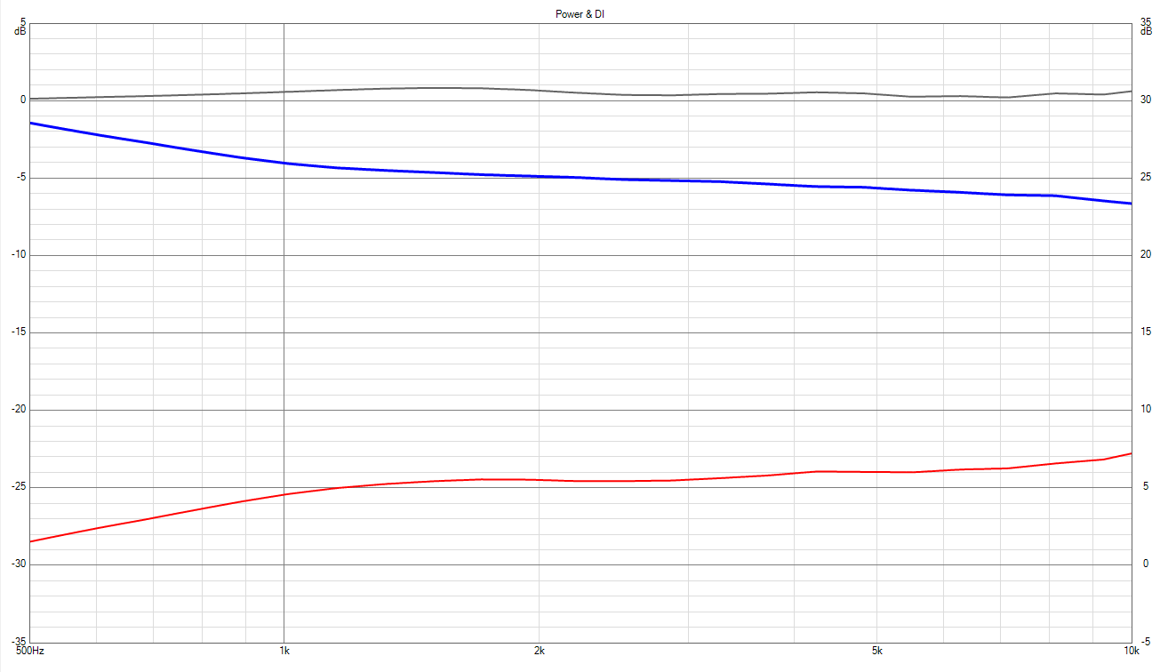

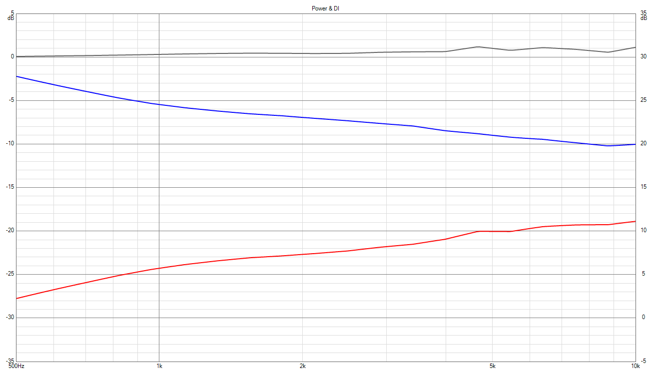

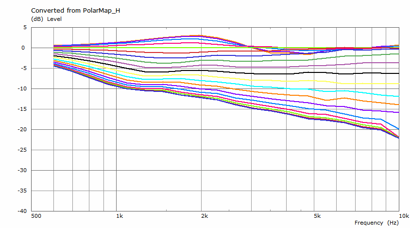

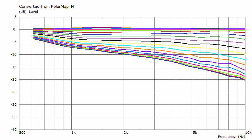

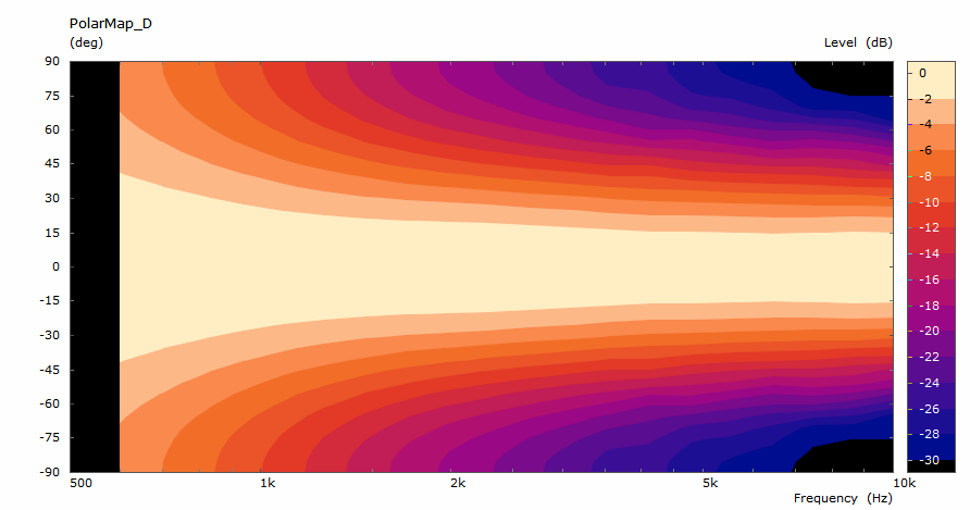

I loaded the horizontal polars into VituixCAD (great piece of work, BTW) for the wide and narrow waveguides shown above. There are DI calculated (correctly, I assume - the red curves). So these would be the DI curves if the waveguides were axisymmetric with these polars. If all the data was taken into accout it would be slightly worse I guess, maybe not that much. By far worst are the diagonals but they should not have a big effect on power response in this case.
The shallow one (the first shown on the previous page) will be the one I will use now, together with a 12" midrange. As you can see, the DI of the waveguide itself is very gradual even under 1 kHz and that brings some freedom in crossover point and design.

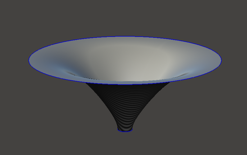

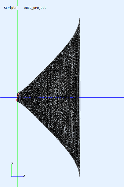

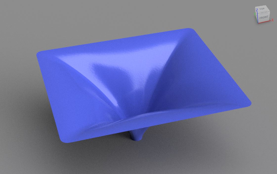

BTW, this is the basic shape before morphing to rectangle (200 mm deep in this case) -
For the deepest one (220 mm) I tried to increase the corner radius to 50 mm. Not bad but not too visually appealing either 🙂

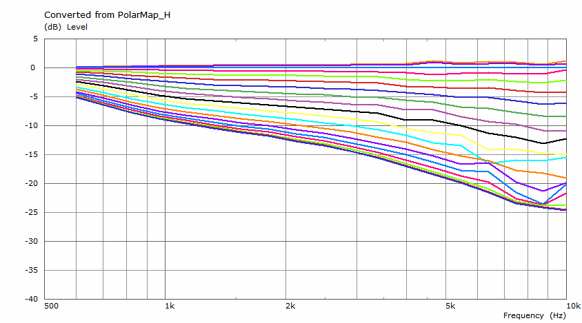

Maps normalized to 0 deg - no problem here.
For deeper waveguides it's probably hard to beat a "more OSWG like" variants - if it's big and smooth:
"More OSWG like" as in: Axisymmetric?
