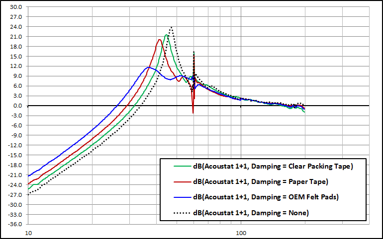

Attachment #1: Measured Low Frequency responses (ignore 60hz power line noise) 😱
- Without any damping attached to the rear stator there is a +24dB response peak.
- Felt pads do a nice job of damping the resonance as well as lowering the frequency of resonance by adding mass loading from the air trapped between the felt pad and diaphragm.
- Neither of the tapes provide much damping at all to the peak. Note also the reduced output at 30Hz because of less mass loading from trapped air.
This explains comments by Mendel24 after experimenting with tape “…I have found that the bass only outer panels really need some felt backing on them or the bass does not sound quite right…” Post#9

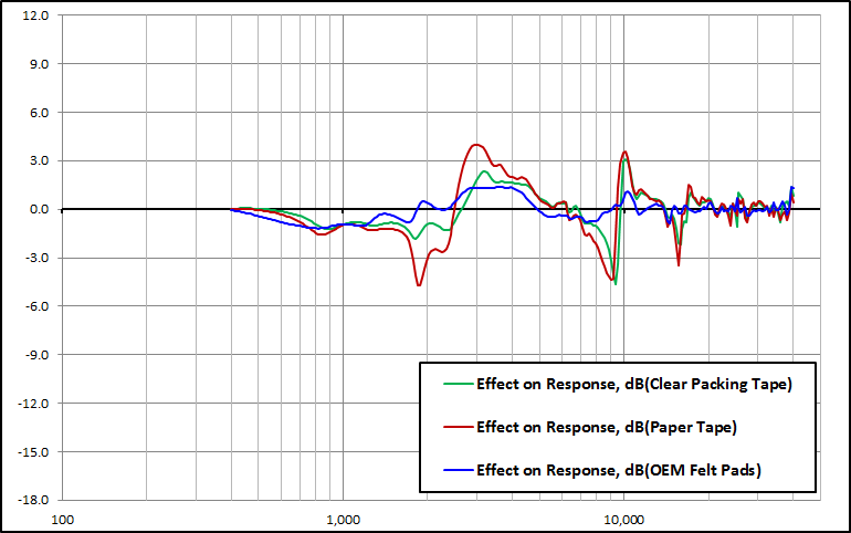

Attachment #2: Measured effect on high frequency response
- Plotted responses are normalized by panel response with nothing attached to rear stator.
- Felt pads have minimal effect on the response.
- Reflections from the tapes put pronounced peaks and dips in the response. Since our hearing is more sensitive to response peaks than dips, the overall sound tends to be “brighter”.
Measurement of similar reflections from using additional thin diaphragms as dust covers like Quad does in the ESL-63 and variants can be found here: Post#16
