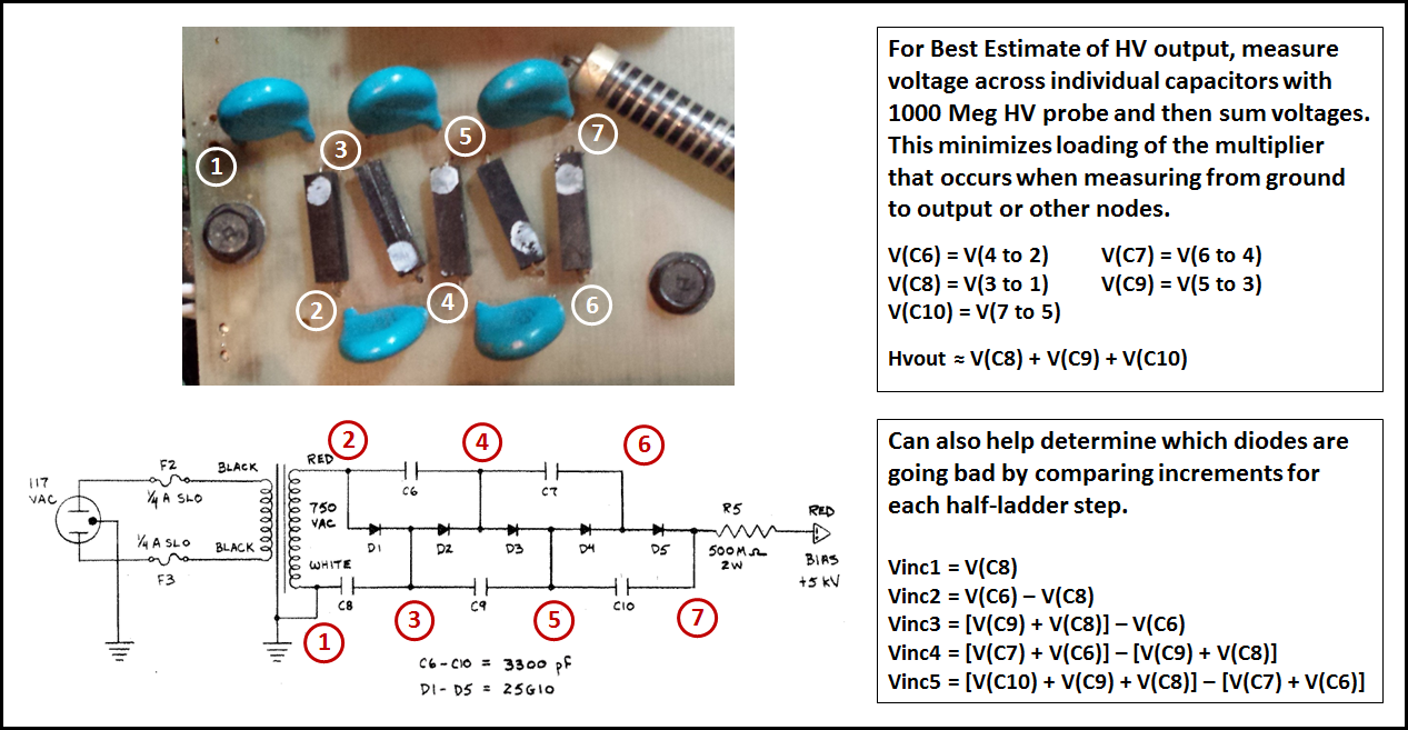

I have a slight (?) mismatch in bias voltage between two interfaces. Apologies to all if this has already been answered, but I wasn't able to find an answer with Google or by searching this thread.
I'm working on a pair of MK121-C interfaces and have just replaced the high voltage ladder capacitors. Using a Fluke 1000:1 high voltage probe, the voltage readings are 4.95 volts at the 5k site and 3.32 volts after the resistor (at the red connection) in one interface, but in the other interface, they're slightly lower - 4.80 V and 3.15 V. The line voltage transformers seem fine - putting out just under 800 VAC for both interfaces at the base of the ladders. My question is - "Are these bias voltages close enough"? What is the "acceptable" range of voltage mismatch between two interfaces? If a 150 volt difference is not acceptable, then should I replace the diodes with the Vishay GP02-40s?
Thanks in advance for your guidance!
Where your measurements taken with or without the panels hooked up to the interfaces?
If they were hooked up, this might indicated one of your panels has some leakage.
Try measuring without panels hooked up.
If measurements were taken without panels hooked up, personally I would replace the diodes.
If interested, you could measure across each capacitor and compare between the two interfaces to determine which diodes are giving the loss.
You should get about 1kV across the first capacitor in the ladder, and 2kV across each of the others.

Thanks for responding.
The measurements were taken without the panels hooked up.
If I walk the probe up the ladders for each interface, I get the following voltages:
Interface A B 1.11 1.10 2.20 2.17 3.24 3.16 4.17 4.05 4.96 4.80
I don't see an obvious glitch in these readings.
I pre-measured the caps and tried to assign them evenly between the two interfaces if that matters.
Still wondering whether these differences are "normal" or not...

Sorry, that didn't post at all like it was intended to be formatted.
Try this:
Interface A: 1.11, 2.20, 3.24, 4.17, 4.96
Interface B: 1.10, 2.17, 3.16, 4.05, 4.80

There will be some inevitable variation between speakers due to tolerances of transformer windings, diode conductance and capacitor value. The voltages you measured are within the expected range of "acceptable" values. Replacing the diodes may help, due to the age of the original diodes, but that's not a guarantee.
It is only in the Spectra series of Acoustat speakers, with the ultrasonic bias supply, where the bias voltage can be adjusted for an exact match between speakers.

To minimize loading on the multiplier, it is best to measure the voltages across each individual capacitor rather than walk up the ladder measuring relative to ground. Summing up voltages measured across the individual capacitors will give you a much better estimate of the true output voltage of the multiplier.The measurements were taken without the panels hooked up.
If I walk the probe up the ladders for each interface…
As AcoustatAM mentioned, there will be the inevitable variations in component values resulting in mismatches in HV output. However in your case, you confirmed that the AC voltage magnitude feeding the multiplier was the same for each supply. Also, you evenly distributed capacitor values when replacing. So, any difference in output would be caused by the diodes. Your HV output difference is 3% which would cause a sensitivity mismatch of about 0.3dB. Not likely to be noticeable as a shift in acoustic image towards the louder channel.I pre-measured the caps and tried to assign them evenly between the two interfaces if that matters. Still wondering whether these differences are "normal" or not.
For reference:
1) HV output difference is directly proportional to AC voltage input. So if input voltage is mismatched by 2%, you would expect output voltage to be mismatched by 2%.
2) If you had one supply with all caps 10% above nominal value and the other supply with all caps 10% below nominal value, the difference in HV output would be about 50Vdc.
