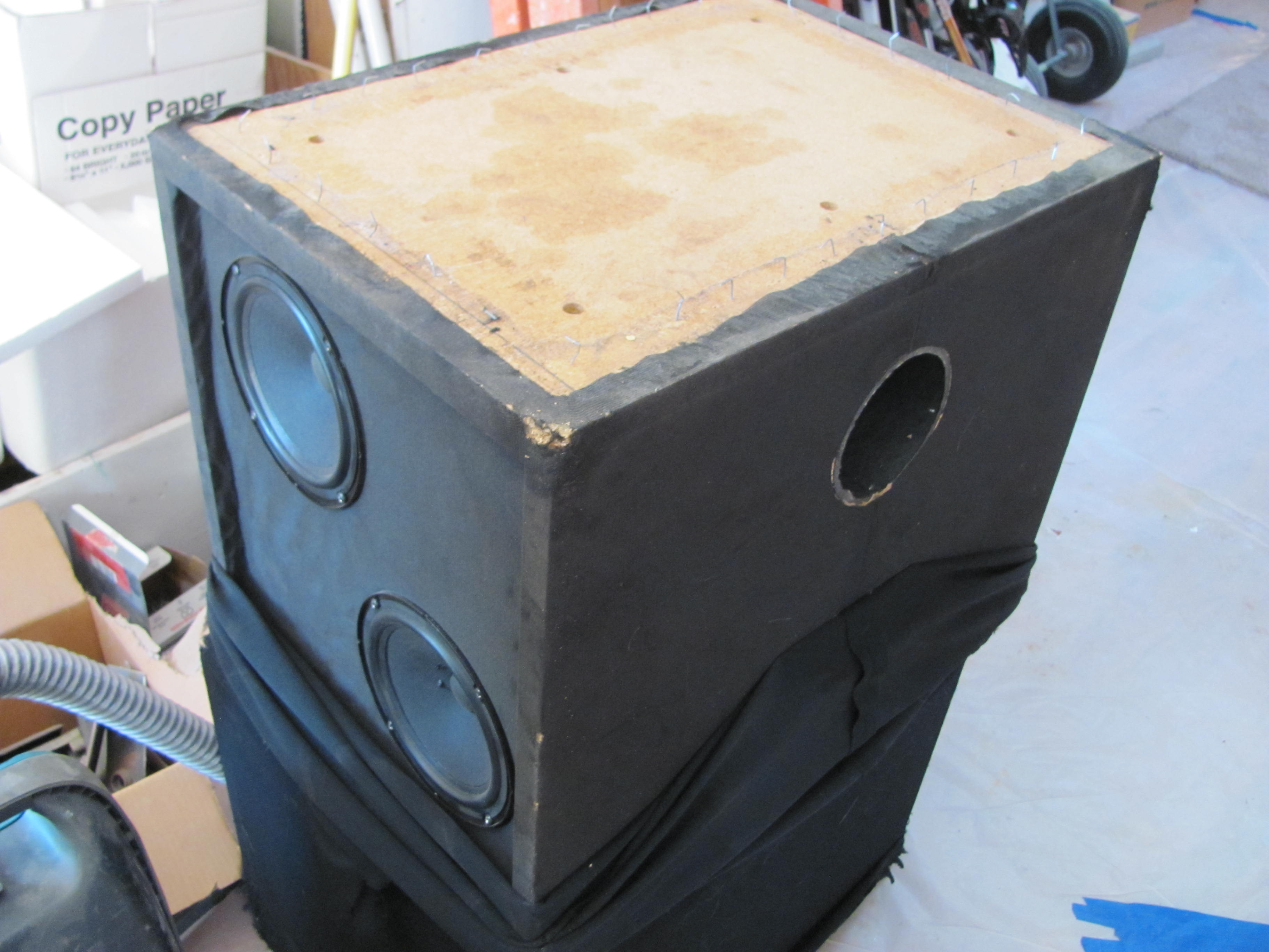

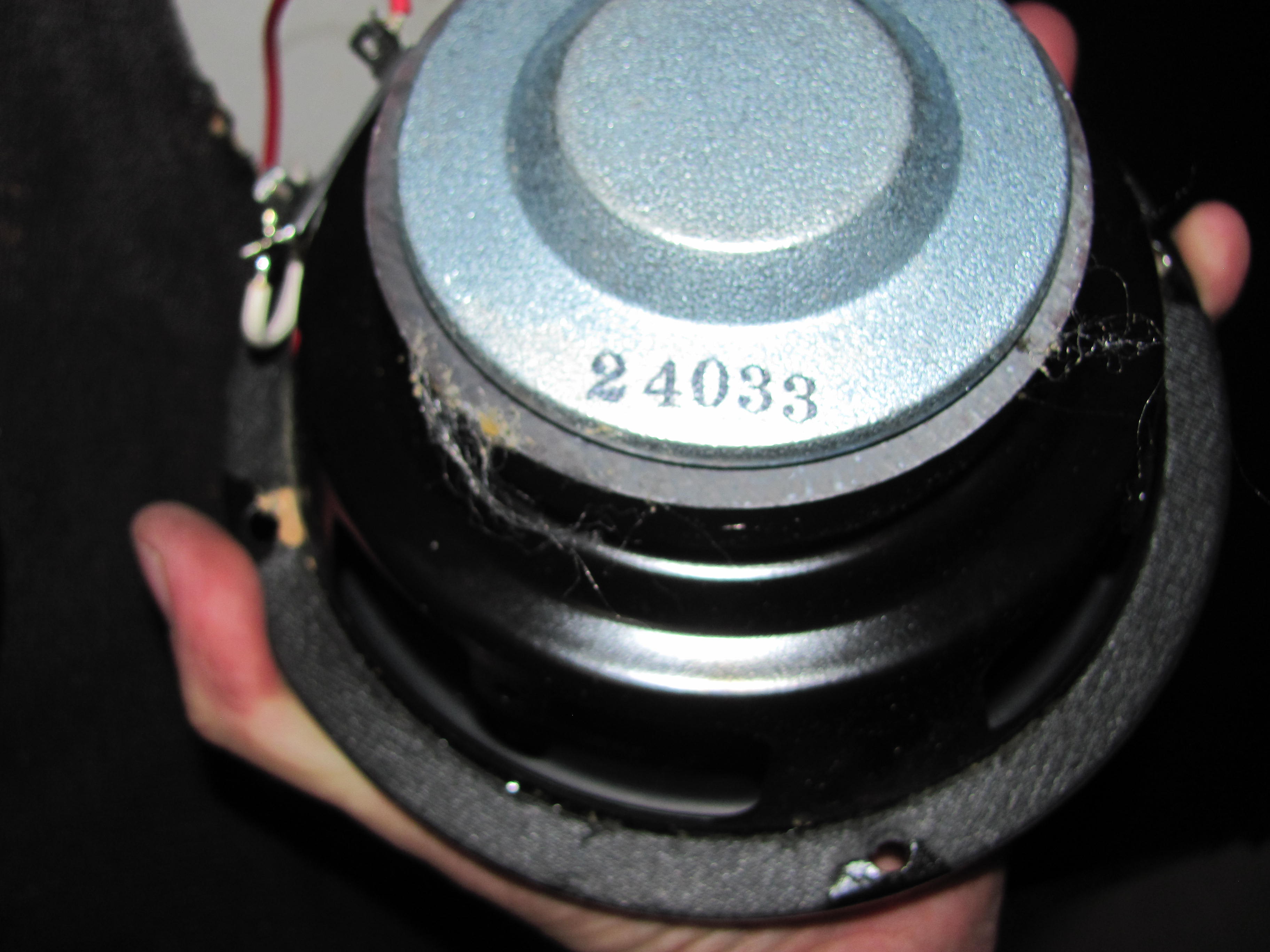

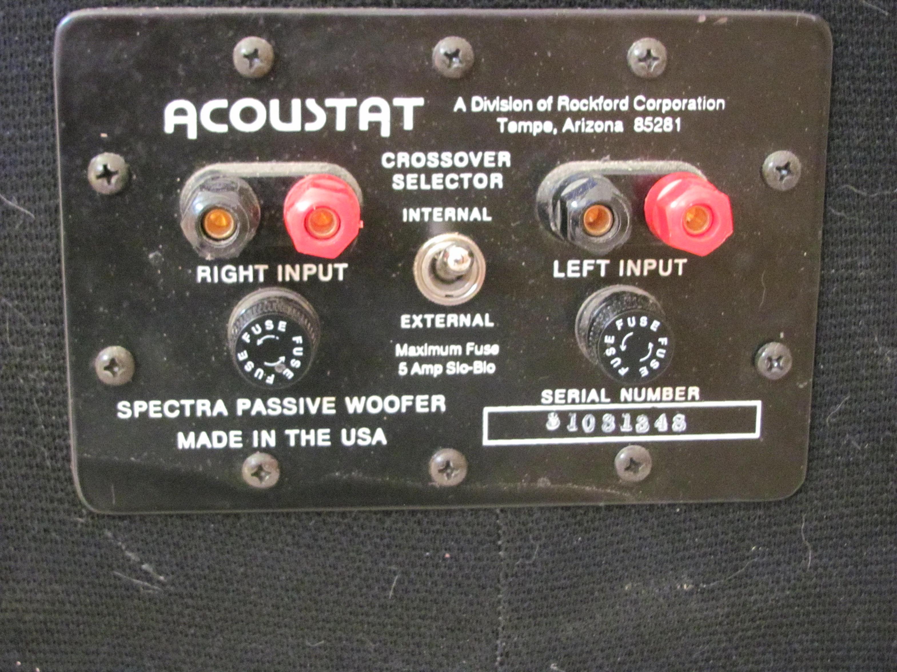

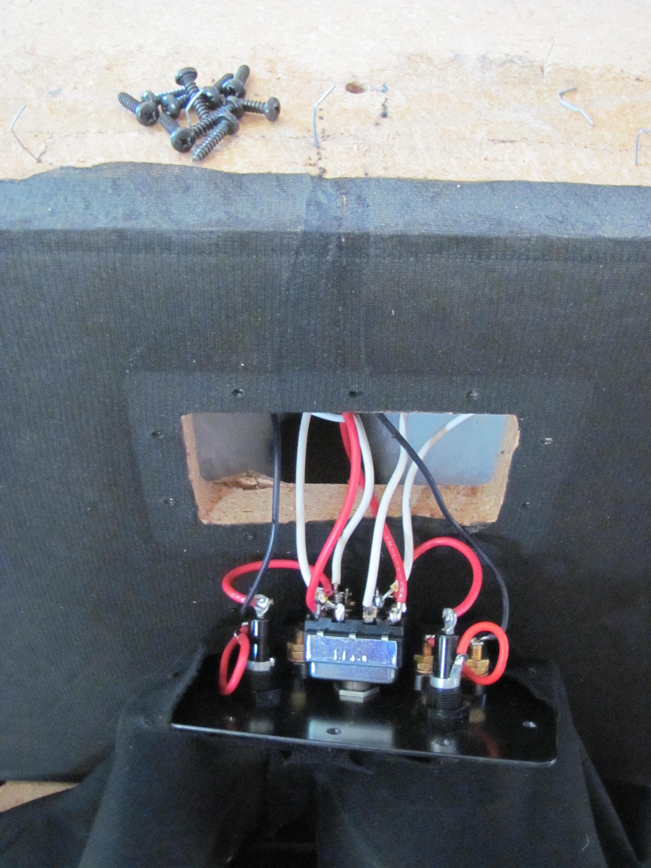

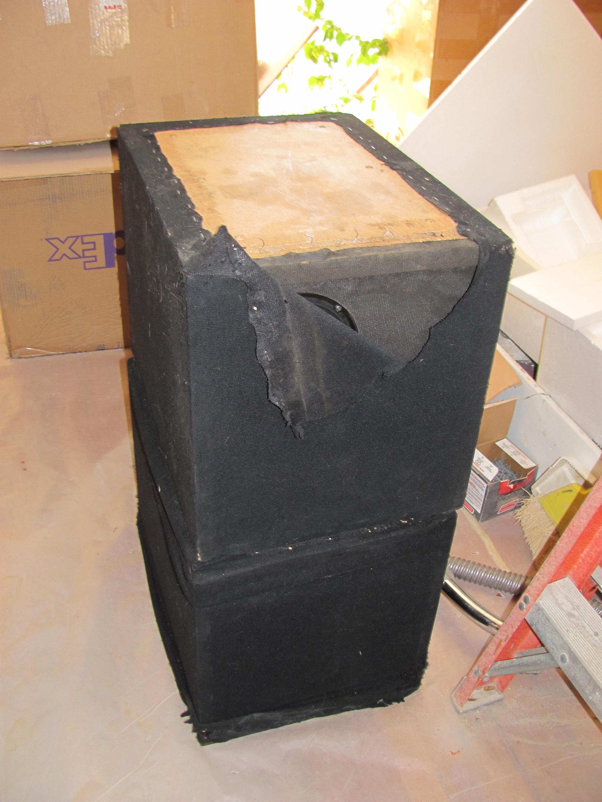

Hi Andy, I just bought a pair of SPW-1's that need some help. What speaker was used in these (I have heard peerless)? And where is the crossover located?
The crossover is located in the woofer box...somewhere. The SPW was assembled at Rockford's Carbonneau speaker-manufacturing facility so I never actually looked inside one.
The woofers were custom designed and manufactured at Carbonneau for the SPW, and no, I don't have any spec's on it. Since you have two SPW's, and they're really designed for stereo-use, perhaps you could use one for parts to get one in good working order.
