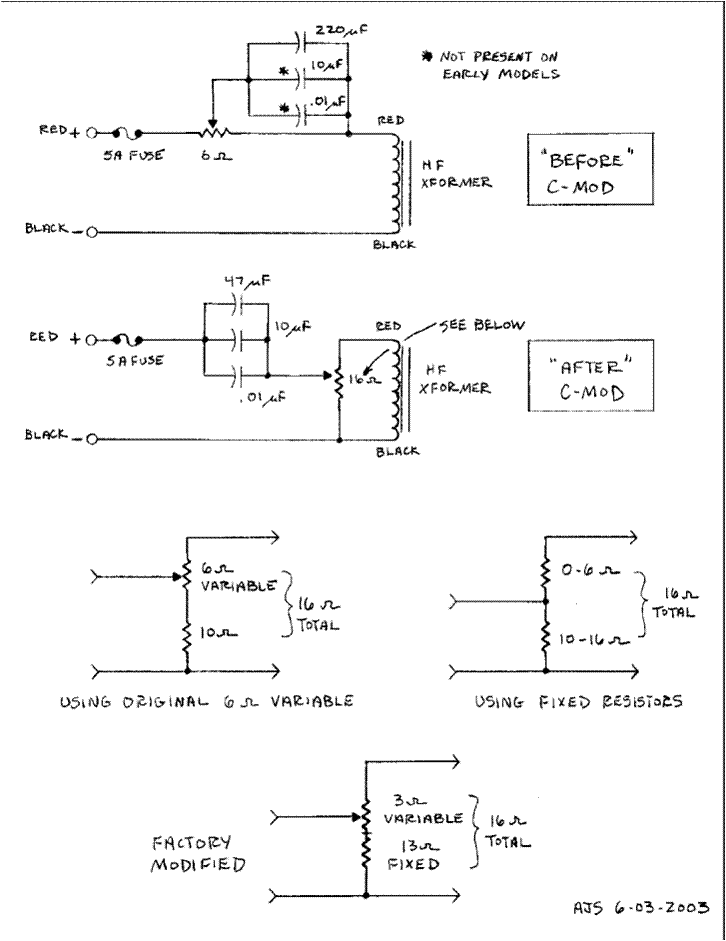

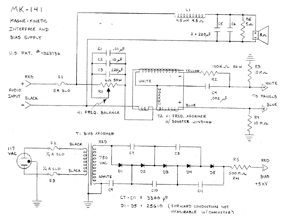

Here a pic of your 131 interfaces..pic1..........an Schematics for the 141..pic2.cant find one for the 131......C-mod well work in the 141....so it should work in the 131 pic3.....................you can search??? info all here...
I took it that you had 1+1s with the fullrang interfaces....my bad
but see the bias in the 141 Schematics it just like yours.....theres caps an diodes.............replace all...are have someone ck it......good luck

As TYU says, a refurb of the interfaces and the c mod you will have completely different speakers. I had my 121's for my M3's done by Roy Esposito of Sounds Like New, as I don't know a soldering iron from a lit cigarette. I think I might have even lit a cigarette with one sometime.
That refurb along with an amp suited to driving low impedance speakers turned my $300 investment into lifetime speakers.
