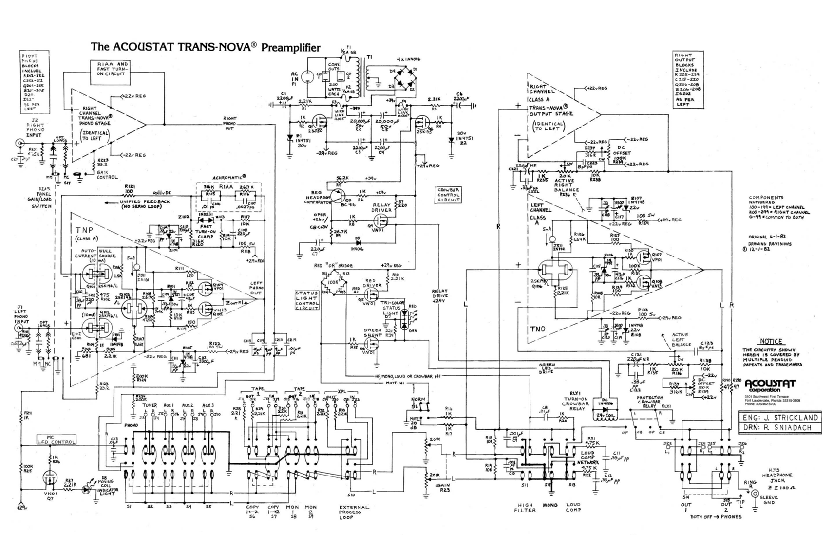

Here is a pic of the TNP Schematic I used when repairing a friends some years ago.

Bolserst - thanks for posting the TNP schematic - it's been a long time since I've seen one. I don't think I have one in my archives.

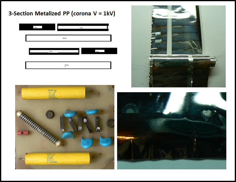

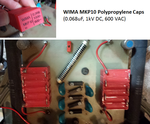

…the two high voltage capacitors on the printed circuit board are also potential candidates for replacement, although these are probably the most reliable of the capacitors in the unit. They can also be difficult to find with the required 5-kV rating.
This reminded me that I had been meaning to post some findings on degradation in these capacitors and one possible replacement path. I was troubleshooting a pair of 1+1s with a noticeable L-to-R imbalance in the midrange. Initial measurements indicated a possible problem with the HF transformer. Further investigation pointed the finger at the mixer capacitors. Swapping with capacitors from another interface confirmed the diagnosis.
I cut the ends off the capacitor and unrolled the metalized film. Well over 100 damage points were noted where internal corona discharge vaporized the metalized film. As best I could tell, these capacitors used a 3 section configuration which would be good for ~1000VAC based on corona discharge, although they have a 6kVDC rating. For more details see attached PDF on the subject.
I decided to try “building” a replacement capacitor from a series stack of 6 WIMA MKP10 capacitors. The net voltage rating would be 6kVDC and 3.6kVAC which is adequate for the voltages they will experience in the mixer circuit.
Measured response with the WIMA replacements in the interface matched OEM so I was happy. The owner felt the sound of the interfaces with the WIMA caps were noticeably improved in the midrange…enough so that he had me replace mixer caps in his other Acoustats as well.
