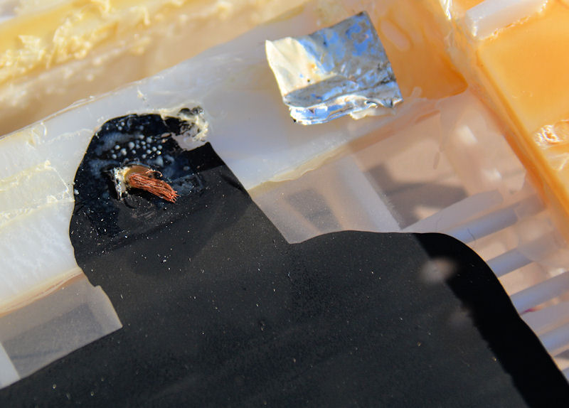

I've attached a photo of the bias wire being installed. The black area is the conductive coating, and as you can see, the stripped end of the bias wire is secured with a piece of foil tape to hold it in place while the two halves of the panel get glued together.
And therein lies the problem. Acoustat panels are glued together, and are not meant to be disassembled. It is possible to pry the two halves apart, but you stand a very good chance (probably about 98%) of damaging the Mylar diaphragm in the process. Ordinarily, this panel would be considered trash.
Since you have nothing to lose, I suppose you could try disassembling the panel. Perhaps some else has some experience with this. Being a factory guy, my only experience was to throw away the panel and replace it with a new one. We never bothered trying to repair panels.
The original wire was custom made, with PVC insulation tested for 10kV. Any wire with a suitable voltage rating would be okay, but unfortunately the type of wire is the least of your troubles. Sorry I can't be of more assistance 🙁.

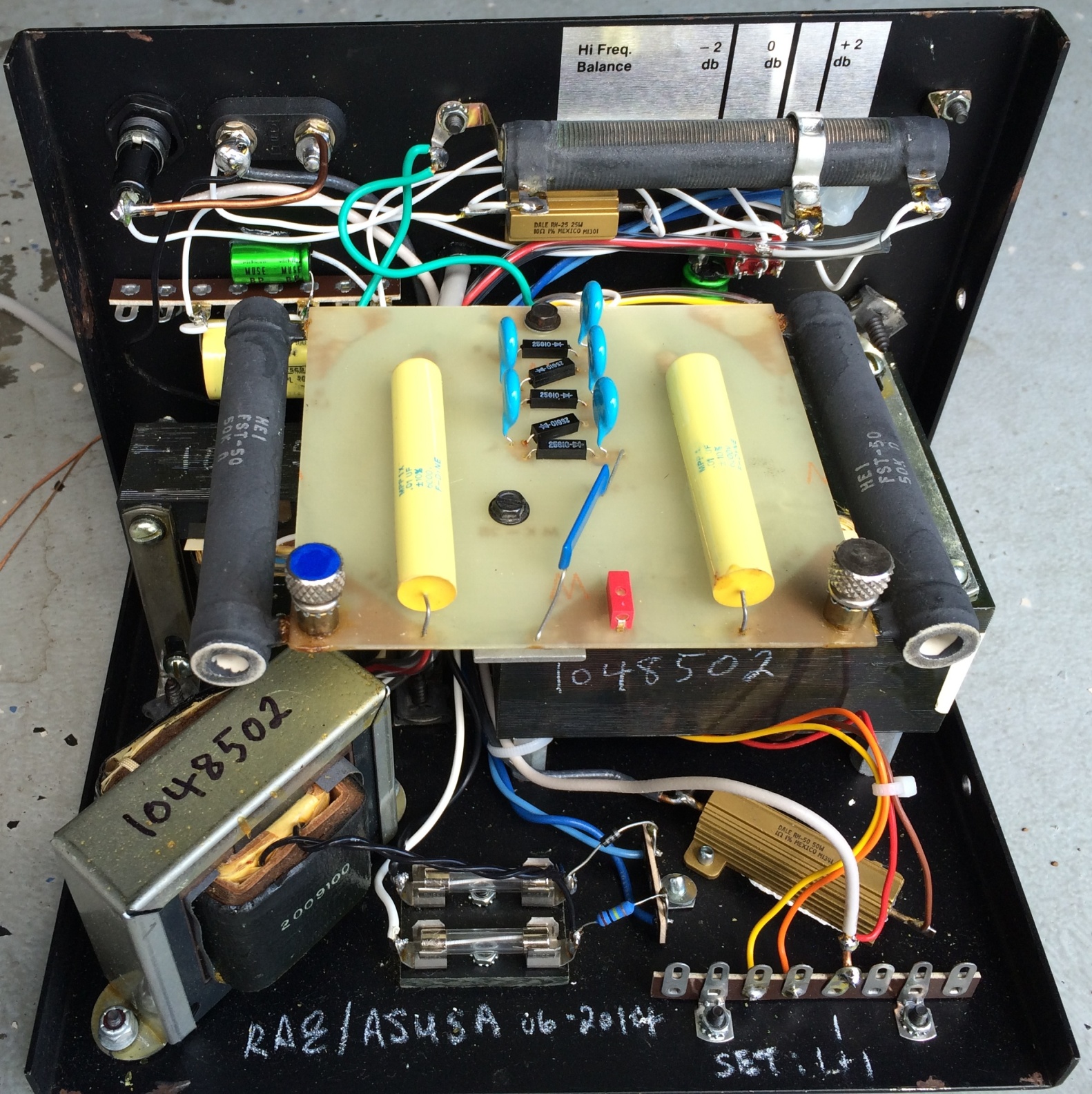

I have a pr of 1+1s that I suspect need bias ps rebuilt. The last time I listened to them they sounded weak and one much weaker.
I can source the caps in the multiplier but the diodes I haven't a clue. What is a suitable replacement? Or, is it possible to stack 1N40XX diodes?
Also, does anyone have plans for a HV probe we can use to accurately measure the bias?

Although it is possible, I wouldn't recommend stacking 1N400X diodes. You can't guarantee that the voltage will divide equally among the series-connected diodes. Try contacting HV Components Associates, www.hvca.com. They made the original diodes, but that p/n has been discontinued. Their current line has a p/n G10FS that should be a suitable replacement. I don't know what their policy is regarding minimum order etc.
Of course, any diode with a suitable voltage and current rating is fine, but most of the ones available have a higher current rating and are physically too large to neatly fit on the board.
Although a high voltage probe is the preferred and safer method of measuring the bias voltage, you can also use an ordinary digital voltmeter with a 10-megohm input impedance, provided that you measure the voltage ONLY after the 500-Mohm resistor (that is, at the red socket where the speaker connects). Attempts to measure anywhere else in the circuit will likely ruin your meter.
In this situation, the 500-Mohm resistor and the input impedance of the meter creates a voltage divider, and you will measure only a fraction of the actual voltage. Firmly connect the negative lead of the meter to chassis ground, and the positive lead to the red socket after the supply has had a few moments to charge up. You will measure in the range of 70-80 volts for a properly working bias supply. Naturally, if your meter has a different input impedance, the voltage division will change and you will get a different reading. And, I will make the disclaimer that this method is suitable only for factory-stock bias supplies. Any modifications to the circuit may effect the reading and/or ruin your meter.

There has been some discussion recently about how to repair a missing bias feed wire. My stock answer is that the panels are not meant to be taken apart (which is true enough) and that any attempts to do so would likely ruin the diaphragm. It might be of value to the Acoustat Community if you could write about your experience and methods with panel dis-assembly and re-assembly. This is something we would have never bothered with at the factory, so I have no experience to share. Thanks.
I have had good experience with the GP02-40 4kV diodes made by Vishay, stocked by Mouser.I can source the caps in the multiplier but the diodes I haven't a clue. What is a suitable replacement? Or, is it possible to stack 1N40XX diodes?
The 4kV rating is double the recommended rating by Vishay in their application note for a multiplier circuit like the Acoustat.

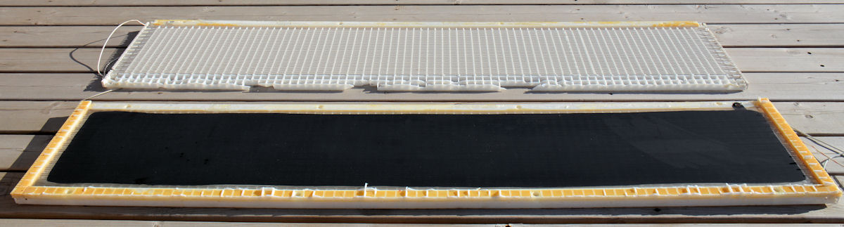

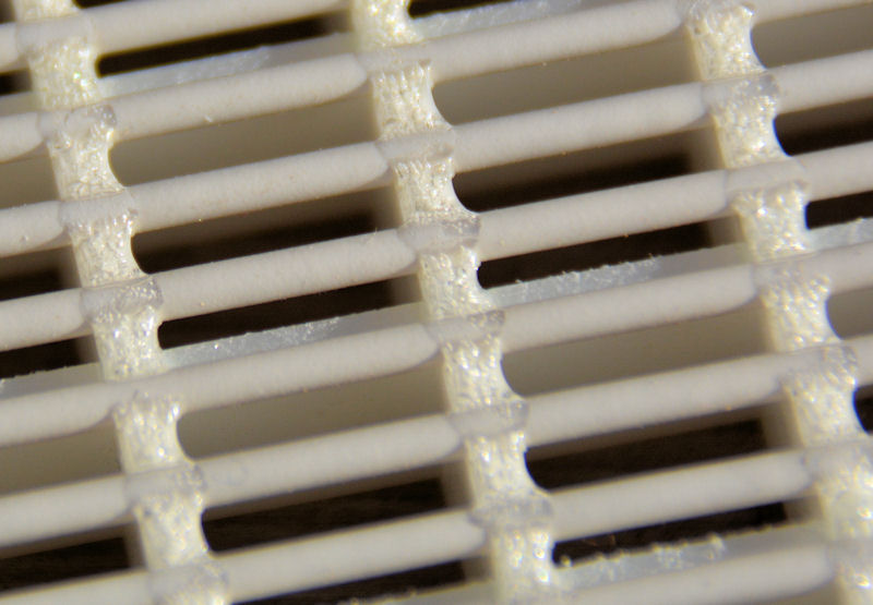

Well I can tell you how to take apart a panel, but reassembling one and having it function again is something that I haven't tried.
When I tried to repair the "buzzing" panel that I mentioned before, the first thing that I did was very carefully examine it from top to bottom, looking for loose wires, debris, or any damage to the area of the panel that I could see through the wires. I removed the felt dampers from the back side and checked there as well. Finding nothing, I cleaned out the panel with compressed air and retensioned the membrane with heat, without success.
While examining the membrane while it was backlit, I noticed that I could see many pinholes throughout, so I checked the panels in both my model 2s and 1+1s and found them to be the same.
Still hoping to fix the panel, I again thoroughly examined, cleaned, and retensioned, but the buzzing remained. Finally, when I was yet again trying to retension the membrane, I got it a tiny bit too hot and a few small holes formed, the largest being about 2 mm. At this point I decided I had little to lose by disassembling the panel.
I very carefully pried the panel apart, but as careful as I was some of the plastic frame was broken and in a couple of tiny places the mylar tore away from the frame, leaving two 1mm X 6mm gaps right at the edge of the diaphragm.
I then had a close look at the inside of the panel trying to find the cause of the original buzzing issue and found a small drip of glue sticking out from the stator wires towards the membrane. This drip had apparently formed when the wires were first attached and had been there ever since.
The panel may have been salvageable if there was just the membrane holes, but I doubt that the plastic frame could be properly glued together again with all of the damage. If a person was extremely careful and very lucky they might be able to take a panel apart without damaging it too much for it to be reassembled, but it certainly would be a challenge. Gluing it all back together again would also be a tricky thing to do, but would probably be a bit easier than taking it apart. I think that if I was trying to fix a missing bias feed wire I would do it without actually disassembling the panel. Instead I would try just removing enough of the plastic frame around the connection point to reattach it, and then repair what I removed with some new plastic and glue.
I've attached a picture of the two halves of the disassembled panel, as well as a close-up of the area where the wire is attached to the membrane. The silver metal foil was originally glued on top of the wire attachment point. The third picture shows the pinholes on the membrane, which I can confirm are just damage to the conductive coating and are not actual holes in the mylar. You can also see marks on the membrane from the stator wires, possibly from dust or perhaps from actually "slapping" against the stators. The last picture shows the stator wires glued to the plastic frames. The drip that caused all of the problems was composed of that same clear bubbly glue that holds the wires in place.

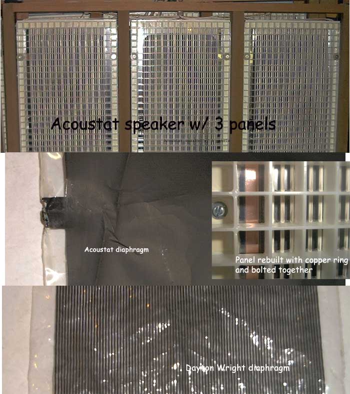

Is it not possible to build 'Acoustat' panels? Back years ago a good friend of mine was a rep for the company that purchased Acoustat. He knew I owned a pair and when he told me the panels were made from common light louvers I was kinda shocked. I dropped a sock and was surprised how simple it appeared.
So, I guess the question is "what is not available to DIY panels"?
The mylar, the coating, stator wires??? I believe I've seen the plastic louvers at the hardware store.
The louvers are easy. The combs for the wires would have to be fabricated. Also the frame for the film, but that's much easier. Film, coating, and that's pretty much it. I rebuilt some Acoustat panels (changed diaphragm material) and one day, I'll get around to re-rebuilding since the ones I made were modified by the fingers of a curious 5 year old. At the moment, I don't have a suitable room, so it's a VERY backburnered project.
