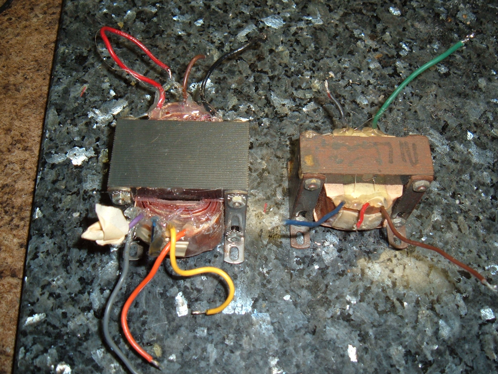

I do this frist thing when I pull the box.........if you can
I use hot glue....what ever you uses.... put in the paper gaps.... were the wires exit the tran......When the hot glue drys...the wire well be held tite........... here 2 ML tran.....I can get the hotglue in side the paper...an drys... now...........in the pic
before you move any wires....or even cut the zips....
I have old bass tran ...that just was removed..DOA..hart brak.... now that papers so dry .....the wire can move an break ...an you can kill the tran....

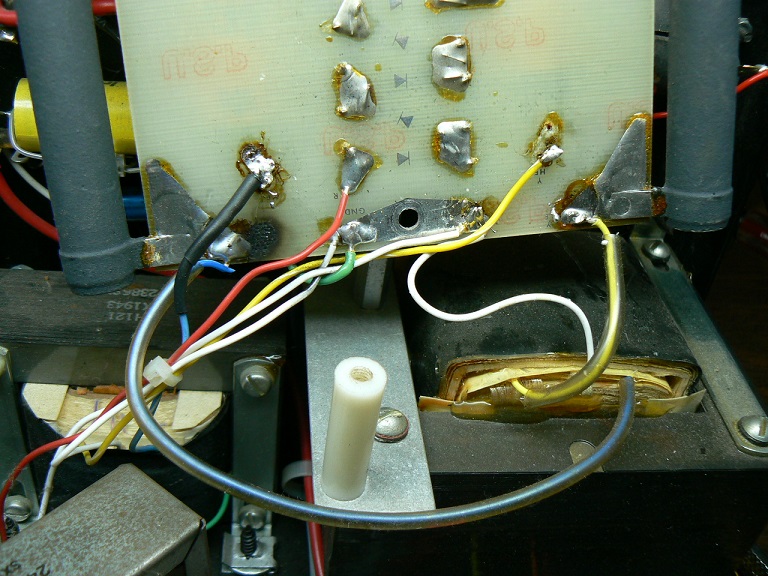

I'd double check all interconnect cables on that channel, reversing and straight, could be a poor ground. I had this happen a couple a times, can drive you nuts, other thing I would check is the ground wire connection in the wall recepticle, plug and interface. make sure you have a solid ground.
If the amp was just turned on, but no music was playing then the voltage difference between blue and yellow wires should be essentially zero; both at safety ground potential, right? or am I missing something.Now we are getting somewhere. The arcing between blue and yellow wires is not an unheard-of problem on the MK121 low frequency transformer. It is usually caused by a failure of the insulation, sometimes aggravated by overdriving the speaker…some flexible PVC tubing from an electronic distributor, with an internal diameter suitable to slip over the blue and yellow wires…Later factory-built interfaces used this method to decrease the chance of arc-over between these wires
The attached pic shows some tubing slipped over the blue and yellow wires…was this the factory build method you were describing?
When you turned on the amp power, were you inputting any audio to it?…Then I turned the amp power on, and the sound came on, and he saw a blue high voltage arc. we located the arc to the yellow and blue wires, coming out of the biggest transformer.
Also, what type of amp is it? Does it use a safety ground?
Yes, that looks like the factory-applied PVC tubing. At some point, but possibly not at the same time, Acoustat began sheathing the wires that ran up into the panels to reduce corona effects. If memory serves correctly, at the very least, all Spectras were build this way, with the front and rear stator wires bundled separately and covered with PVC tubing. I even developed a custom-made tool for grabbing the end of the wires to pull them through the tubing. Not an easy job, especially on the double-stacked models Spectra 44/4400 and 66/6600.
When I turned the amp on, there was no input. The CD player was still of.
I'm looking for the pic tubing on Amazon, is there a specific product or brand I should buy?
If there was no signal applied to the amplifier when you turned it on, and you observed an arc on the largest transformer, there is something very wrong in your system. With no signal applied to the interface, there should be no high voltage to create an arc, no matter how bad or damaged the insulation may be.
Therefore, I am back to suspecting that your amplifier is oscillating into the speaker load, which is, in effect, an input signal creating high voltage, which is then arcing. It is probably a very large signal that is causing a breakdown of the insulation. I suggest you try a different brand of amplifier to determine if you have a compatibility problem. I have no familiarity with your Cinepro brand.
In regards to the PVC tubing, this is a generic item. Try Digikey or Mouser, both are on-line electronics distributors.

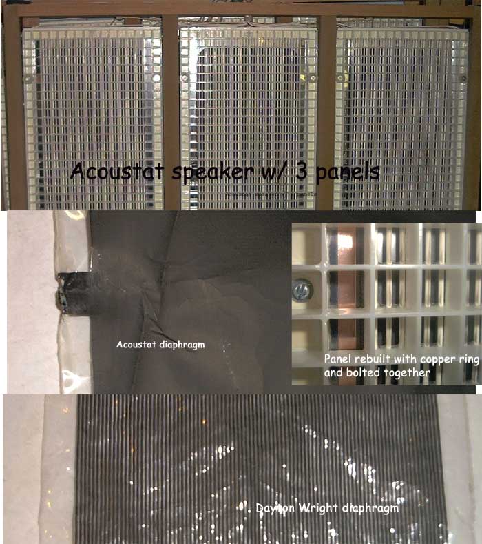

All sorts of foreign matter can get stuck inside the gap between the stators and the diaphragm. Bits of plastic or glue from the panel itself, dead bugs, hair, etc. can all cause buzzing, rattling etc. And, if the foreign object is even slightly conductive (like bugs or hair), it can also cause localized leakage, which usually manifests itself as a sizzling, hissing or ticking sound.
At the factory, panels were routinely blown out with compressed air to remove debris, but the process was obviously not always 100% effective. And of course, over time, bits of plastic or glue can work loose and cause trouble. These problems often show up after the speaker is moved or handled. A thorough vacuuming of both sides of the panel is always a good idea whenever there is a problem or the grille cloth is removed for any reason. This needs to be done with the speakers completely discharged so as to remove any electrostatic holding force that might be exerted on the foreign matter. I make it a habit to vacuum the outside of the grille cloth on my speakers every few months, just to reduce the accumulation of dust that might work its way into the interior of the speaker. And it doesn't hurt the appearance of the speaker, either!
Other than some periodic cleaning of dust and debris, Acoustat panels are incredibly reliable compared to virtually any type of speaker, and particularly compared to other brands of ESL's.
In both of the panels that I had this issue it could be clearly seen that the plastic bits were actual drips of plastic/glue from the manufacturing process. They were both still firmly attached to the panel where the stator wires were glued on and had to be broken off to be removed. Blowing out the panels with compressed air would not have affected these at all, and it was obvious that they had been there right from the beginning when the panels were first assembled.
I completely agree with you about the reliability of Acoustats, they are an amazing design. It really is a shame that they are no longer being produced.

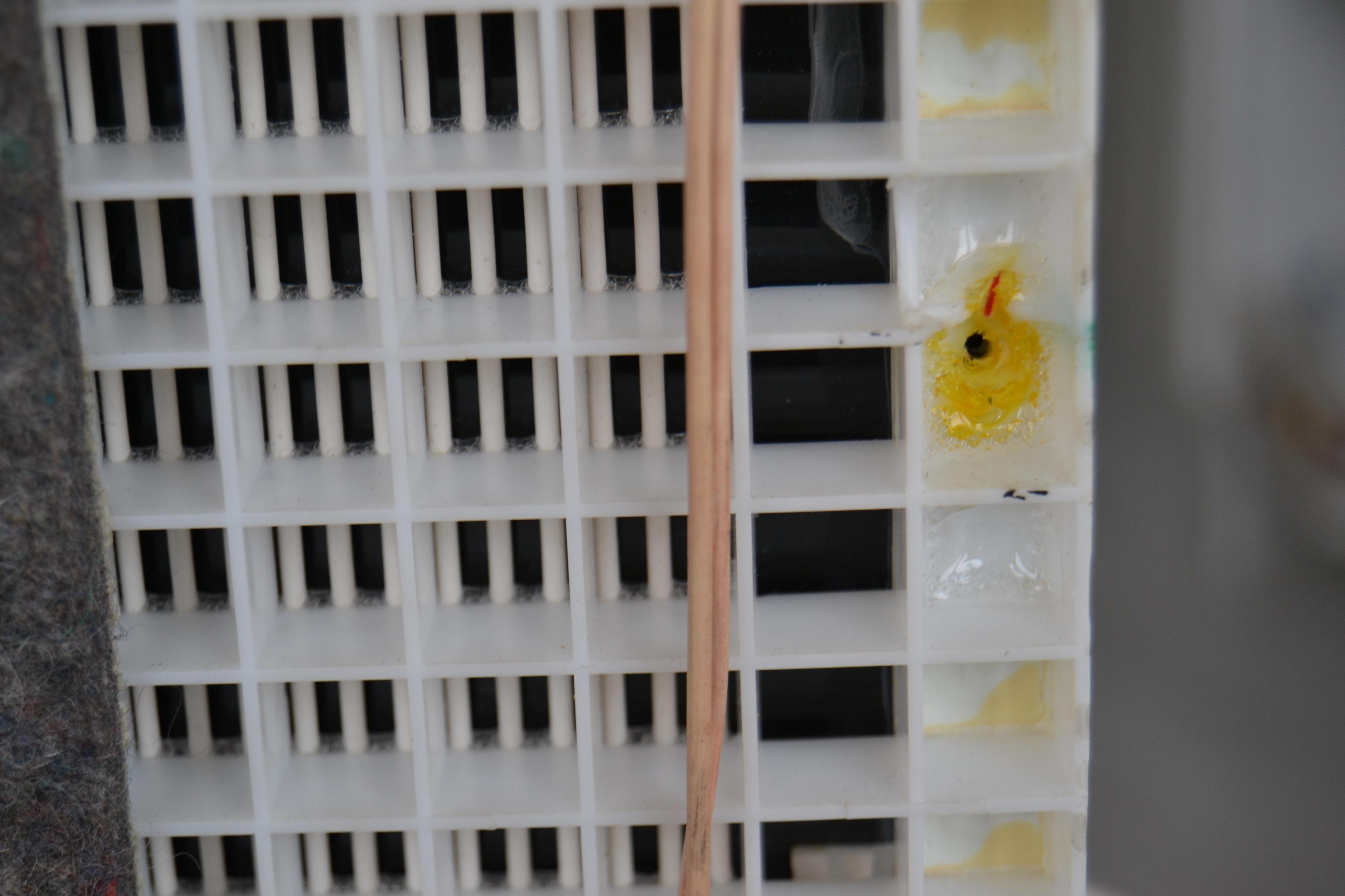

super help needed now I have just found a hole in one of the 2+2 acoustat panels its about the size of a grid square any options at all? finding a replacement panel in NZ is impossible can I just snip the wire and run 3 panels can anyone tell me how to take panels apart and is this difficult?
also after vacuuming warm air blowing staring, glaring ignoring yelling cursing and threatening the rubbish bin one of the other panels isnt working either any suggestions there?
