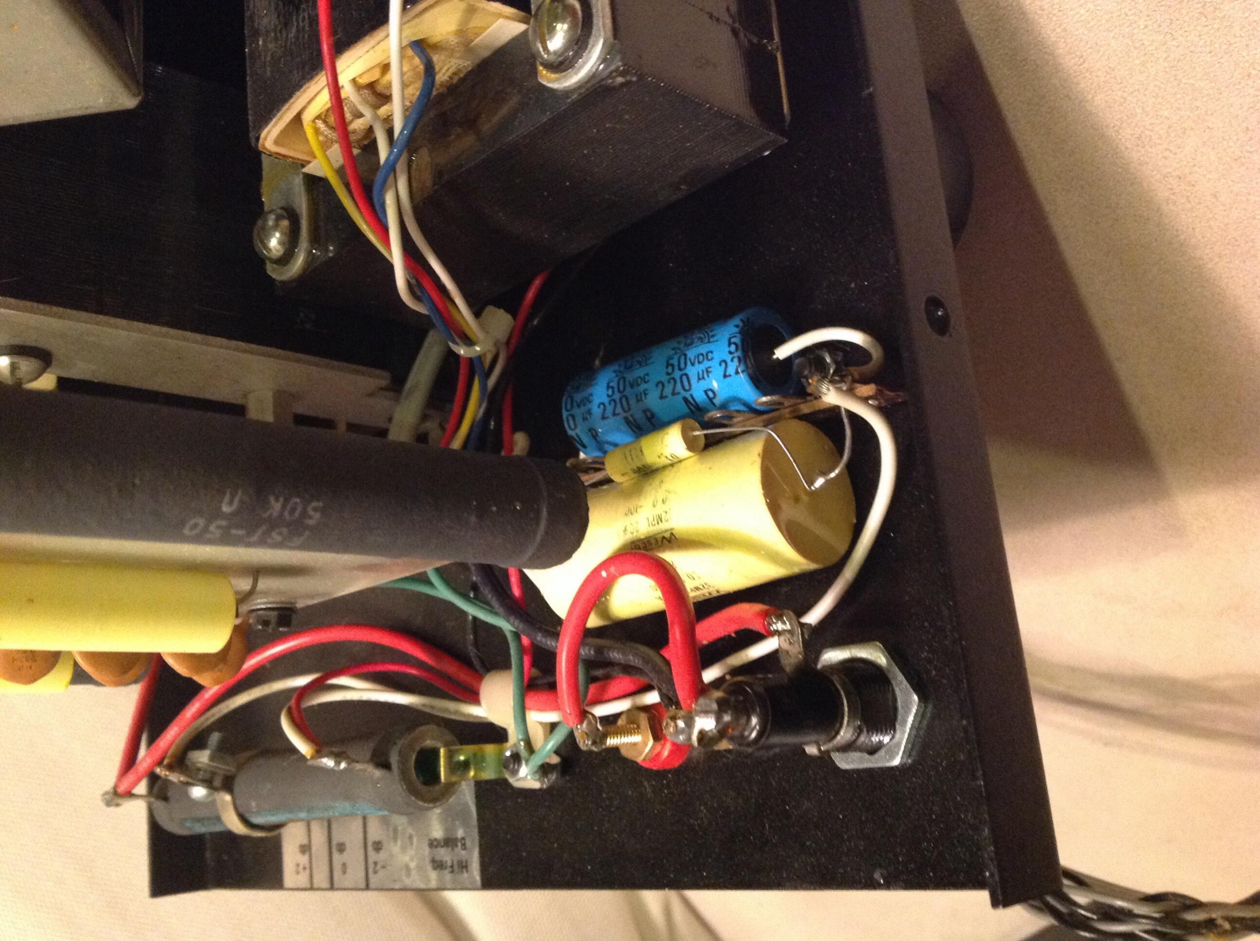

The 1ohm with the Ziptye is a newone on me....I had over 10pr of 121 an never seen that....................but not the prob..with noise ..I would not think
I would take Zips off.. that one ohm can get hot......but that me....
Sounds like your amp is seeing a dead short.......like a dead transfourmer!
less you can see a wire tuching the case.....other can say...
good luck

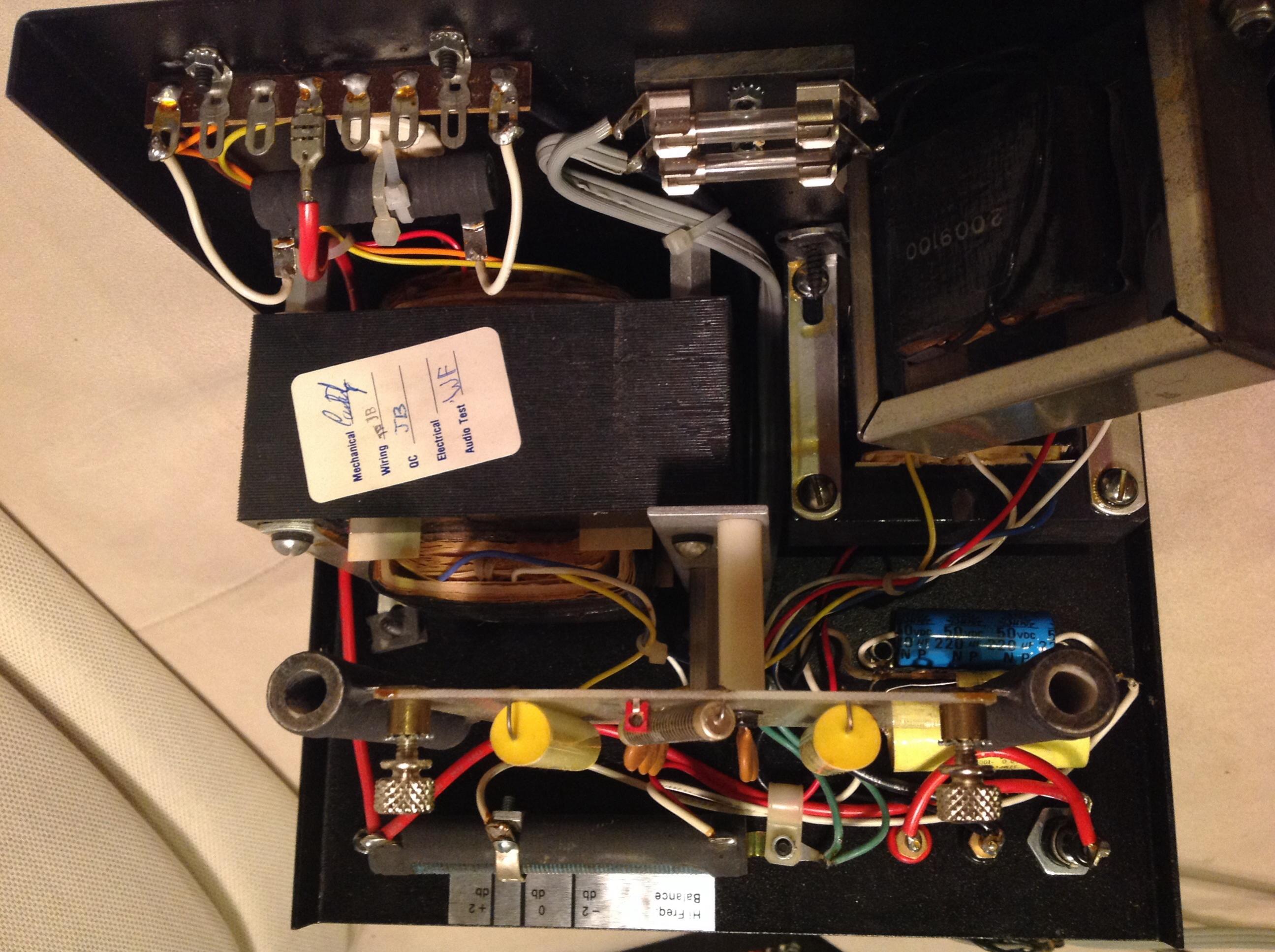

Have you checked all fuses? Start there.
I agree on the zip-tie - never seen it either. Has the unit undergone any goofy mods?
With unit disconnected from speakers measure the bias voltage (DC) with ground probe on chassis ground and red probe on bias pinout - you should read around 70 - 75vdc (should equate to 5kv with probe loading) - be careful, as main voltage exists.
Then unplug, wait a few minutes, and measure the speaker outs resistance - should be low, but not shorted - mine are around or just under 1 ohm, I think.
The panel has three wires - one is red - that is the bias wire - it connects to the PCB in interface (the center red connector).
The speaker outs resistance - is where the speakers connect to interface - measure resistance between red/black connector.

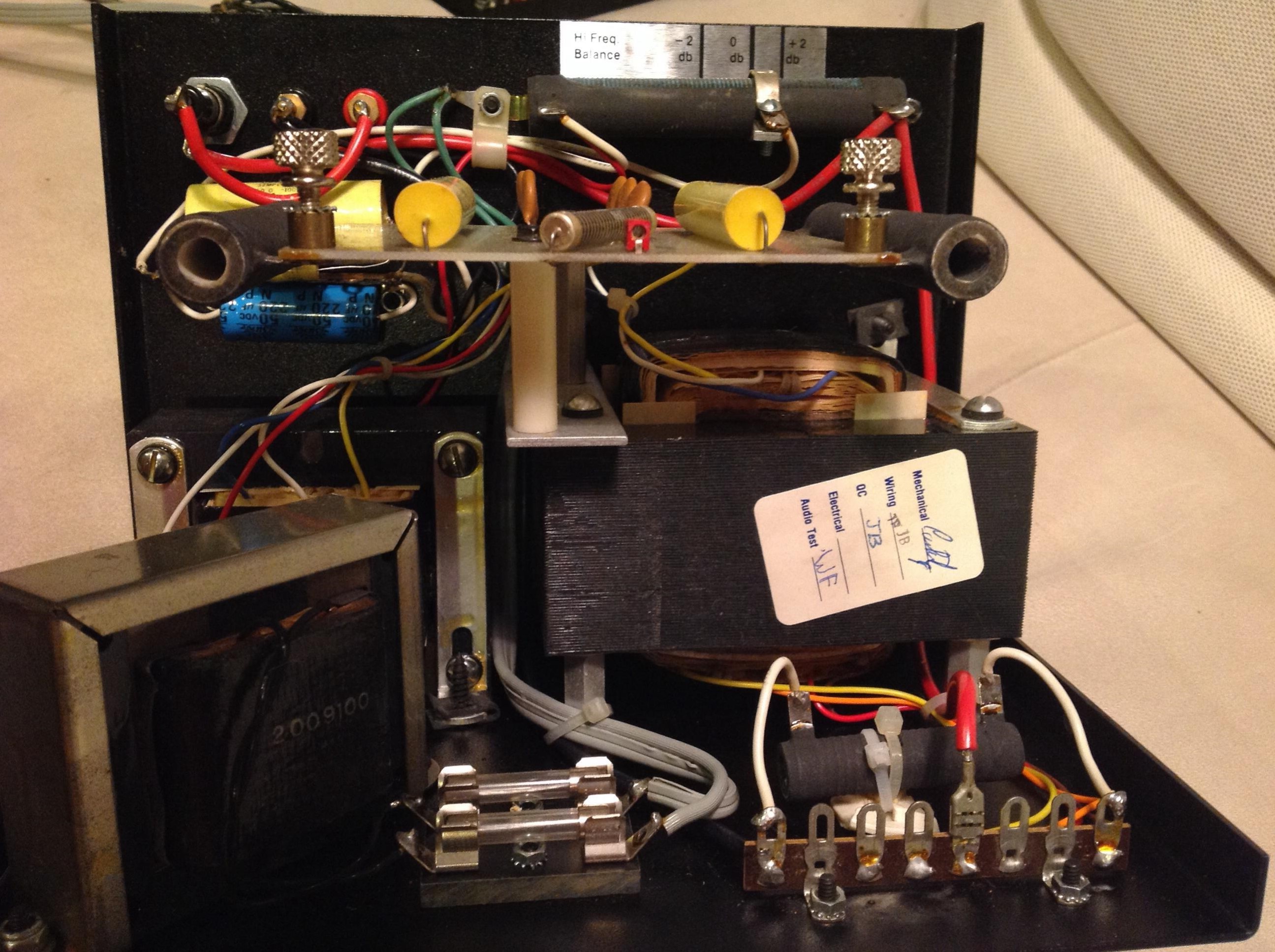

I have examined all of your photos in detail, and cannot discern anything out of place. This is not to say that there isn't...I just can't see anything. I suggest you carefully examine around the two terminal strips to see if a solder-drip may be making contact with the chassis, a sharp point is poking through the wrapper on a capacitor, etc. The defect could be very subtle!
It might be instructive to measure the DC resistance at the input. That is, measure across the red and black input binding posts. This resistance will be quite low, on the order of 1 ohm or less, so you'll need a better-quality meter capable of resolving low resistances.
Regarding the plastic tie wrap and holder on that 1-ohm resistor. That was an ill-advised method used by the factory for a short time. The preferred method is to use short pieces of stiff solid wire to attach the resistor to the terminal strip so that the resistor hangs in mid-air for proper cooling. It can get hot in operation. However, this is not the cause of your problem.
Another item you might want to address is the green corrosion on the high frequency balance control resistor. This can usually be cleaned off with fine emery paper, and be sure to clean under the sliding contact as well. Again, I seriously doubt this is causing your problem: just something to address once you have the problem solved.

Sorry Any, didn't mean to be vague about the sound. it was hard to describe. perhaps a lower freq version of a loud trumpet. but I do have an update...the gentleman, Verne, that sold me the speakers dropped by and tried to help troubleshoot. he didn't see anything with the interface. I hooked it up to the amp, plugged it into the power strip, nothing. Then I turned the amp power on, and the sound came on, and he saw a blue high voltage arc. we located the arc to the yellow and blue wires, coming out of the biggest transformer. There appeared bare, exposed wire where the arc was coming from the two wires, the conductive coating seemed to have been burnt. Verne thought there may be something else wrong that caused the two wires to arc. Does anyone know if there was a reason why this arc came about? or was it just simply a fault in the conductive coating. i was thinking of wrapping 10 layers of electrical tape around the bare spots.
Now we are getting somewhere. The arcing between blue and yellow wires is not an unheard-of problem on the MK121 low frequency transformer. It is usually caused by a failure of the insulation, sometimes aggravated by overdriving the speaker. I reexamined the photos supplied, and could not see any evidence of the burnt insulation, so perhaps the photos were of the 'good' interface?
In any case, electrical tape is not a great solution. I recommend a two-prong approach. First, get some flexible PVC tubing from an electronic distributor, with an internal diameter suitable to slip over the blue and yellow wires. Disconnect the wires from the printed circuit board and slip the tubing over the wires, covering as much of the wire length as possible. Reconnect the wires to the board. Later factory-built interfaces used this method to decrease the chance of arc-over between these wires, so it's probably a good idea to apply this change to both interfaces.
Second, use epoxy to coat the area where the wires exit the transformer. It is okay if some of the epoxy drips down inside the transformer (it may even help the situation). Several applications may be necessary to build up a sufficient thickness.
Finally, there is no guarantee that you can fix the problem. If the arcing is occurring down inside the transformer, you may not be able to sufficiently insulate the area, especially if a carbon path has been established. At that point, replacing the low frequency transformer will be necessary.
