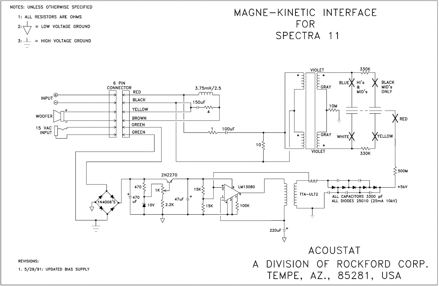

I am still trying to get my Acoustat Spectra 1100's to work. I did the bias adjustment. I did the 2nd method for testing the voltage. It came out to 8.1 volts at the red ESL terminal. Andy's documentations says I should be getting 75 volts at this point. This means I am getting approx 600 volts. (It should be at 5000 volts). This makes sense because the volume of the speakers seems to be 1/10 of what it should be. I did get a little more volume when I did the bias adjustment. How can I get more? (speak to me like the amatuer I am). Thank you to everyone on this forum 🙂
Are you certain that you have the proper 12-15 volt AC (not DC) wall transformer properly connected to the speaker and to a always-live outlet?
There is a possibility you have an earlier version of the ultrasonic bias power supply that exhibits reliability problems. This is very easy to fix. To determine if you have the earlier supply, look at the black-wrapped air-core transformer mounted on the printed circuit board, and note the red wire exiting the top of the transformer. Is there another wire wrapped around the red wire that connects to the printed circuit board? If not, then you need the upgrade and I can send you instructions. FYI, that extra wire is only wrapped around the red wire, not electrically connected to it: it acts as an antenna in the feedback portion of the oscillator circuit.
Report back, and if your bias supply is upgraded, then we can explore more troubleshooting. FYI, I have seen very few instances of a bad IC in the bias circuit, which is a good thing as the part is no longer made.
I had two pairs of Spectra 11. One had the bad IC (swapped with good one to find out it was bad) and purchased two - I still have one - I would have to search for it tho..., and the other was repaired by reflowing all the solder connections.
I updated both with the Bias Mod, both pairs ran perfectly afterwards, and allowed me to push up the bias a bit - better to my ears - and sold them after I found my 2+2.

Andy, You sent me the upgrade instructions. I followed them(replaced 3 resistors, 1 capacitor, 1 diode, and made the antennae) and there is more sound but still it is only at 1/10 what it should be.
My wall transformers, i bought on ebay, Acoustat 12VAC 130mA made in Taiwan. It is connected to the wall here in California.
Since both speakers are acting the same, I would recommend that you review the mod instructions and make sure you did everything according to plan.
Note the differing values for one of the resistors based on whether you have the 12V or 15V wall transformer.
The zener diode should NOT be changed unless the measured voltage is too high. If you changed this part to a 10-volt zener AND you are using a 12V transformer, then low bias voltage would be the expected result.

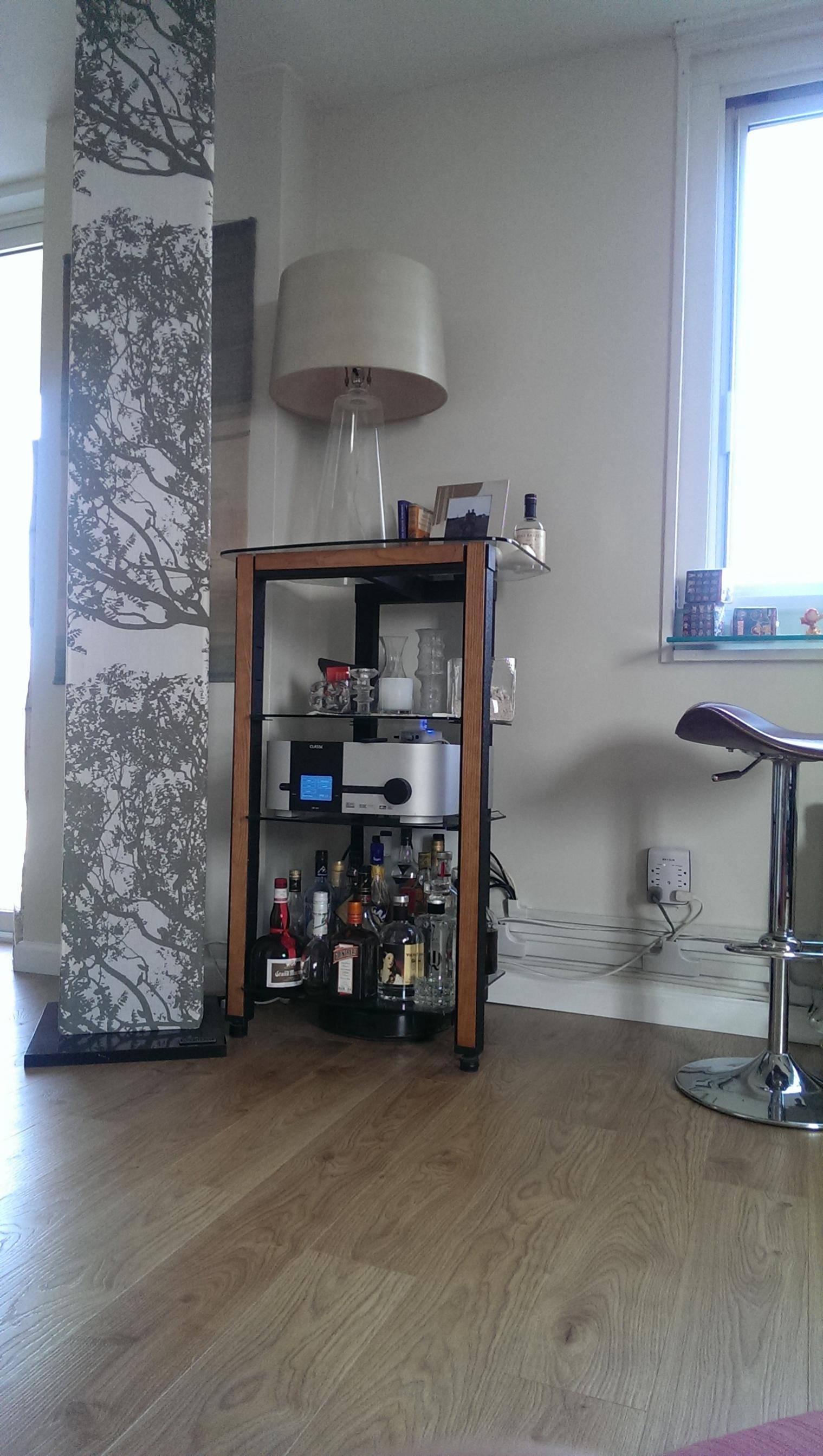

Hey, that's some snazzy grille cloth! What sort of fabric is it?

Acoustat 1+1s Grille fabric
The fabric is from a Finnish Design house called "Marimekko". It is a very thin fire-proof fabric (sonically invisible).
My wife is Finnish, hence the increased WAF (Wife Approval Factor). Brilliant thinking on my part, I thought.
Thanks for all the info. This forum is great.
Absolutely! Is there a U.S. source for the fabric?Brilliant thinking on my part, I thought.

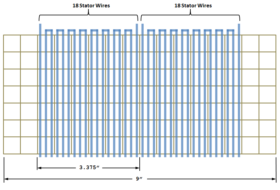

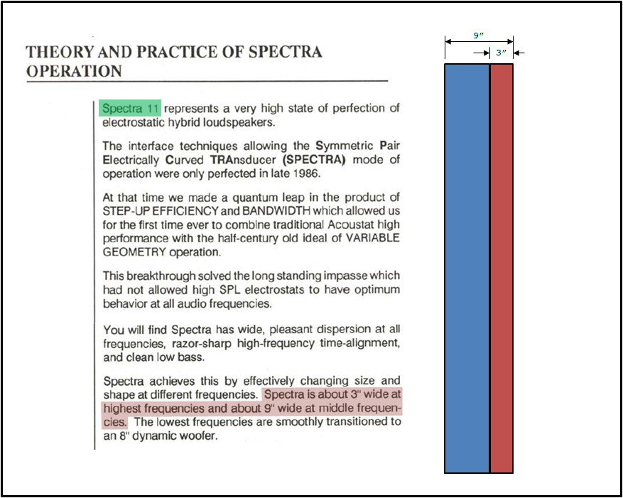

I have always wondered why in the Spectra series of speakers that the first segment to receive the signal is, as an example, on right speaker, the right hand side of first (Innermost) panel?
So on my Spectra 33 right hand side, the standard configuration is:
Panel 1 , Segment 1 2 , segment 2 first
Panel 2 , Segment 3 4
Panel 3 , Segment 5 6
Did you ever try another configuration say the left most segment on the right side?
Panel 1 , Segment 1 2 , segment 1 first?
Or
Panel 2 , Segment 3 4 , segment 3 first?

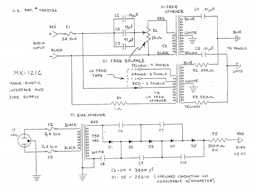

I well give my input on my Spectra 11s an 3s......an some pic for others ...these pic are the stock Spectra panel setups....
I have tried every way that you have posted..an more...an now I run Spectra panels with all parts of the panel setup on fullrang taps only for the best sound.........well for me...
The Spectra transfourmers sound better than the older 121 non-Spectra. type....it my be that the Spectra trans can be ran fullrang an....don't need a C-type crossover .....
456963d1420256495-acoustat-answer-man-here-spectra_sectors[1].jpg69.9 KB · Views: 430
456961d1420256495-acoustat-answer-man-here-spectra_11_sector_sizes[1].png312.6 KB · Views: 412
456962d1420256495-acoustat-answer-man-here-spectra_22_sector_sizes[1].png222.9 KB · Views: 409
457563d1420493129-acoustat-answer-man-here-spectra_stator_wires[1].png54 KB · Views: 396
I was working with a guy that has Spectra 11-1100.....Looking At the old 100mf cap. crossover...An trying to help him understand why using 5-6 poly caps to make up the 100mf.... would give better sound.....when he said that in most ways he like the sound of the 11 better than his Spectra 33....that only have a one ohm res in the input....when there ran fullrange
So as we sat looking at the schematic......I saw agine see pic 1 ...that these Spectra 11-1100 were the only Acoustats panel interfaces..... that ran any part of the panel off the tranfourmer winding it self......with out a res. or cap before the panels.....
With the older Acoustat 121 interfaces....my setup is 3ea 9" panels flat per side
So I took the outside one panel an Moved its panel feeds..right off the Secondary..in front of the caps on the mixer board....see pic 2...
The C-mod crossover is there feeding the high freakquence transfourmer primary.....so the one outside panel well only play what ever the C-mod is......like maybe above 1khz...
Wow.......with the other 2 panels in the stock setup.....vary nice ..more output..Better topend....gives just a little of the Spectra type dispersion......It been about two weeks...an I like it a lot.....vary good sounding Mod...NO down side I see.... less is more.....the best sounding cap...is NO cap!
