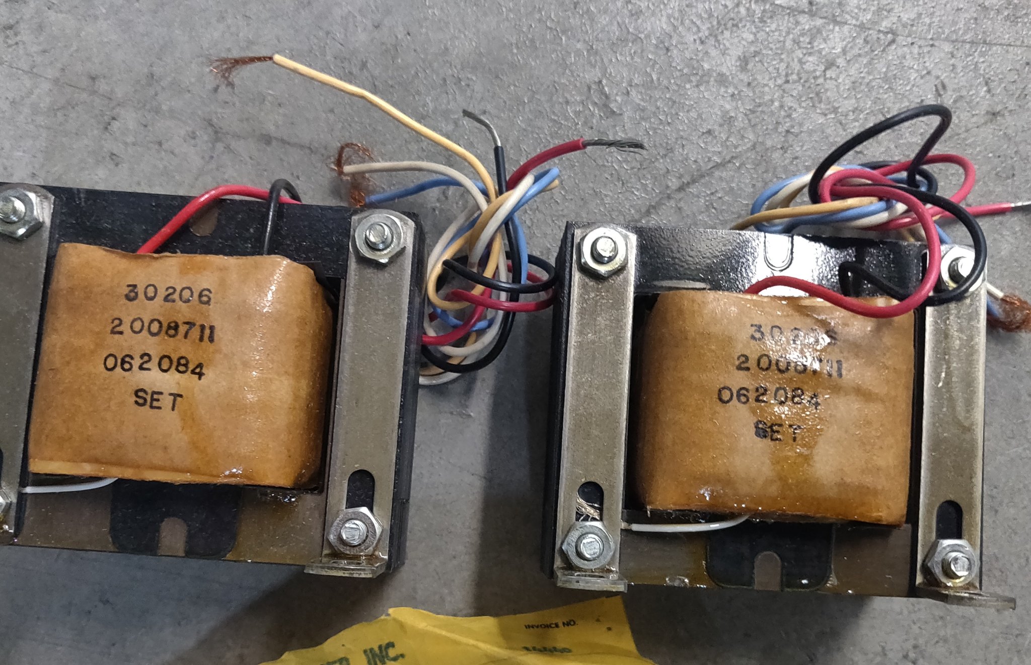

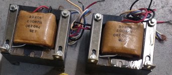

Trying to identify these two transformers purchased in 1984 and left in a box marked "Acoustat." Not sure how accurate that is or how proprietary they are. I'm attempting to liquidate a warehouse full of new/spare parts from the last 40 or so years so there's a lot of stuff mixed in. This one at least at the packing slip handwritten with the date. They look very similar to the ACOUSTAT TTA-117V x-formers but I can't be certain of this. A google search for the associated numbers doesn't produce many if any results. Any ideas? Pricing in 1984 for these was a whopping $190/ea. They fit the palm of the hand on sizing.
These are NOT TTA-117V, which is the bias transformer. It is the high-frequency audio step-up transformer from the MK-121 series of speaker interfaces, which spanned many years and models of Acoustat production. Unfortunately, they are not the much-improved Medallion version, but none-the-less of value to someone who needs one. Dollar value? Probably a couple hundred bucks to someone who needs one for repair, maybe less for the curious and/or experimental purposes. Interesting find.

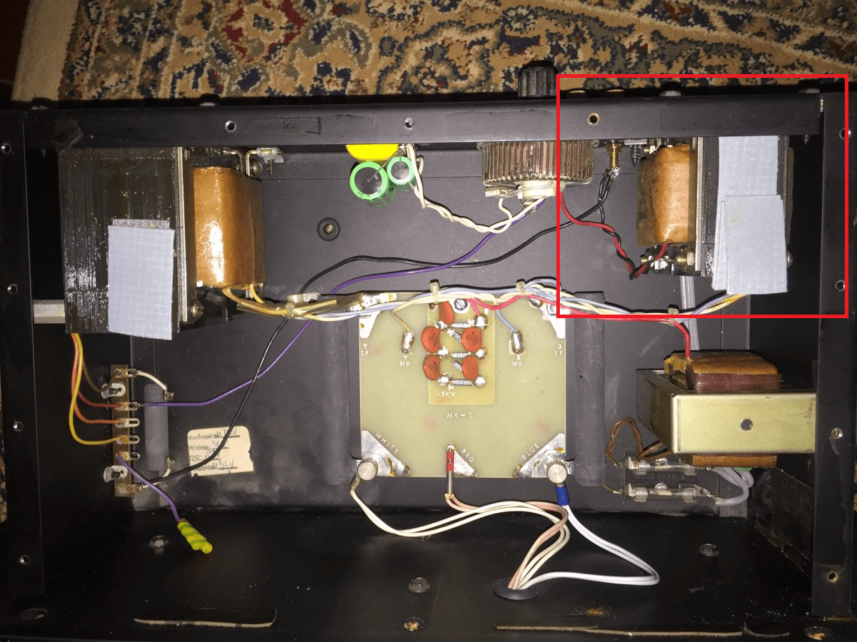

So being that I don't have a MK-121 in front of me, is it safe to assume that this image I lifted off google depicts the transformer(s) in question outlined in the red box?

Yes, that is the high-frequency transformer circled in the photo. Note this is a very early version of the MK121, and that other versions existed in later years that were physically quite different but essentially the same electrically-speaking.Hey thanks for the quick reply! I appreciate the help. I think this is the second time you've been able to identify some Acoustat items with ease.
