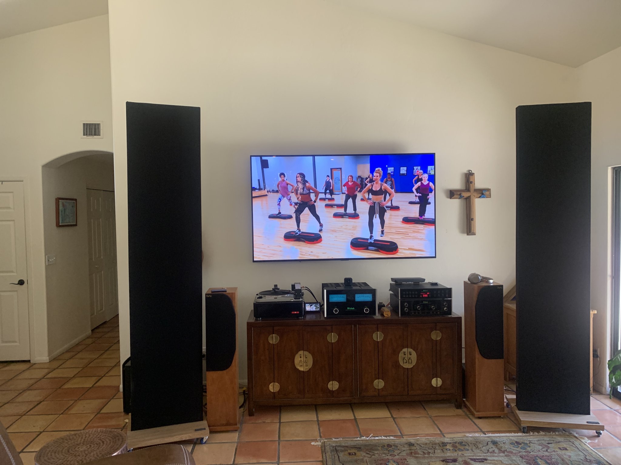

Hi, I own a pair of 2+2 speakers in Tucson AZ. I recently vacuumed the panels and had the mk 121 blue medallion interfaces rebuilt because the left speaker had low output. They are now arcing quite a bit. At idle you can hear a static pop every once in awhile from either speaker and during passages with deeper bass, there is a static sound. The man who rebuilt my interfaces said he added one stage to each of them to get to 3.2kv. Do you think that the extra stage is making them arc?
Your speaker may have issues with low diaphragm tension, or dirt caught in the gap. BUT, increasing the bias voltage will certainly aggravate these issues, and I do NOT recommend this practice of increasing bias voltage above original design specifications. Doing so is asking for trouble. I suggest you have the extra stage removed and the circuit returned to its original configuration. Then see if you still have a problem.
Thank you so much for your advice!! I removed the extra stage and now experience zero arcing at idle or during loud passages! Attached is a picture of my stereo. I’m now removing the ProAc speakers as they sound silly compared to the 2+2.
