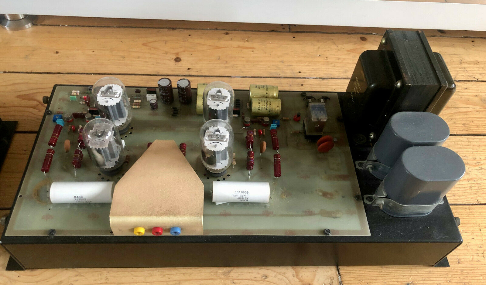

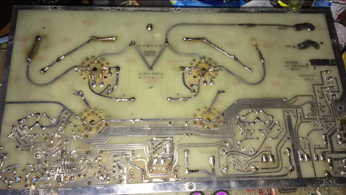

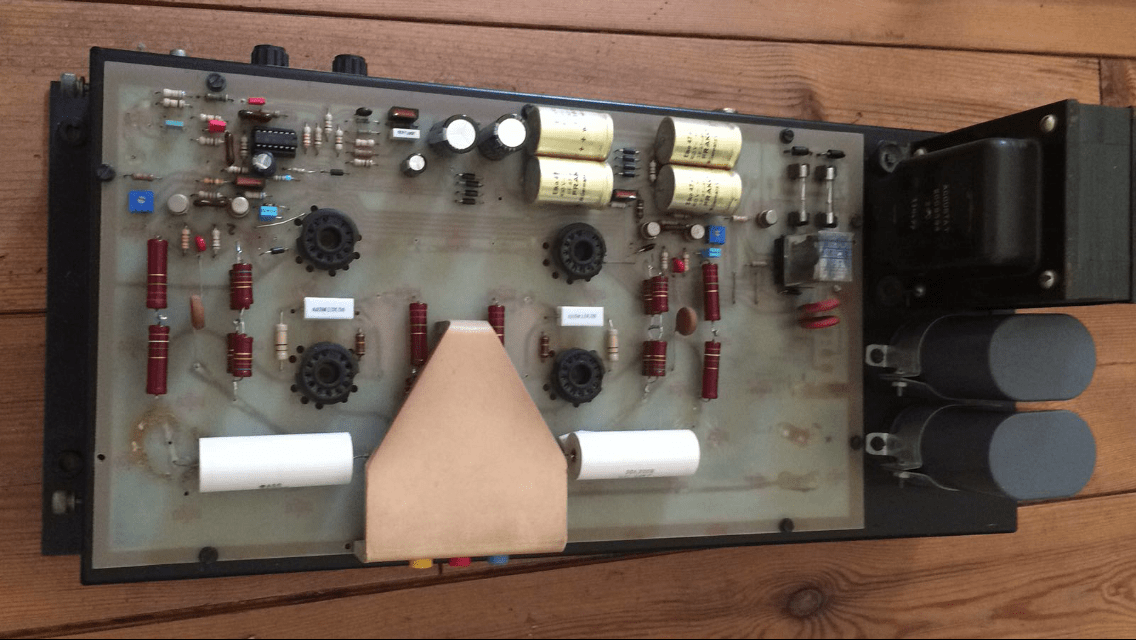

Hello all, a brand new poster here but not brand new to Acoustats. I have been happily owned by 1+1’s, 2+2’s and now model X’s. I’m hoping to get some advice on an issue with one of the amps. I have been slowly replacing parts and have gotten some fair results but still not up to the performance of the other amp.
Symptoms as of now after some fixed: hiss/noise at idle, muted high frequencies, valve 1 plate glowing red (new 10k resistors should fix) but muted high frequencies and noise, slightly less volume are the issues I can’t find yet.
Replaced so far: bias diodes (fixed loud hum), all plug in transistors replaced with new Motorola’s, bias caps tested good, valves tested good. Thanks for any advice!
The original high voltage resistors need to be checked as these loose contact from arcing over time. Red cheek on all tubes or some (upper or lower). Please do not use more powerfull resistors for the 10k values as these can act as fuses in case things go bad. Also make sure that these are off the board not to grill the board in case these get hot. The resistors can be replaced not so the board.
Make sure you switch speakers during testing to rule out panel issues.Hello all, a brand new poster here but not brand new to Acoustats. I have been happily owned by 1+1’s, 2+2’s and now model X’s. I’m hoping to get some advice on an issue with one of the amps. I have been slowly replacing parts and have gotten some fair results but still not up to the performance of the other amp.

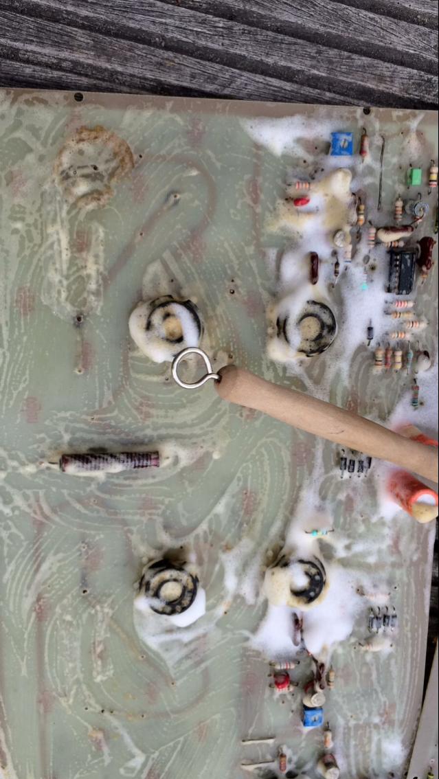

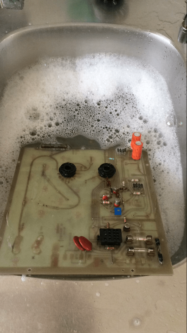

In some cases the board itself can become conductive, in that case it needs to be stripped and cleaned.

Ok, I seemed to have solved the issue of V1 plate glowing excessively and the hiss at idle. I replaced R38 (10k 15 watt) and R39 (470 k) not sure which one did it. I still have reduced volume, high frequency attenuation, distortion at higher volumes and an overall vailed sound compared to the “good side”. The good side is completely amazing with tremendous volume and clarity with a ridiculously quiet noise floor.
I have rolled tubes and swapped panels and sources/cables with the existing problems always following the amp.
Thanks for anymore input!
Bummer. They probably both need complete overhaul. Especially so they both perform identically.
