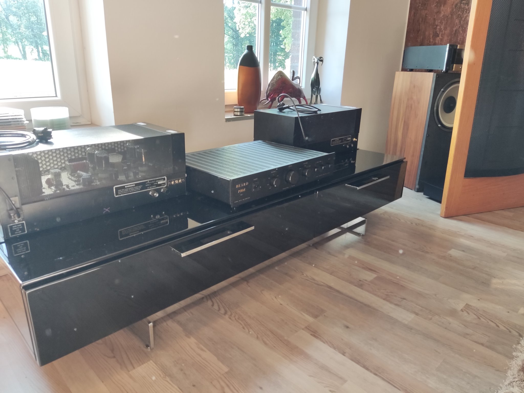

When my dad passed a few years ago he left two working Acoustat servo amps. After sitting in the shelf for 5 years i gave them a good clean and checked for any obvious problems. Didn't find any, so i hooked them up to my Martin Logan CLS MK1. They do play fine at low volumes or Jazz, but when i give them a little more juice i get bass distortion. And it's a bit weird. It's like bass goes aways for some miliseconds and comes back double as loud. Like you would expect from a microphonic tube. Somewhere in the 70Hz and lower region. Hummm...so checked again, swapped tubes, reseated transistors, opamps etc. The problem remains. Then i found notes my father had written down. Mostly what parts went faulty over the years and stuff.
But one note leaves me clueless: "Adjusted stator voltage to lowest possible value: 2,9kV"
Ummm... My father was a DIY guy, building his own ESL panels and he used the Servos to drive them. He was no noob, doing things like that his whole life... But what the heck? As far as i know only "clipping" can be adjusted via the pots on the PCB. From what i believe that is DC-offset, right? Membrane bias is fixed, anode voltage is fixed. All parts have the correct values like stated in the schematics.
Anyone knows what my dad has adjusted there? Is it possible to lower stator output voltage with the pots on the PCB? If so, could it be the reason for the CLS having distorted bass (given they devices are compatible)? From what i understand the dynamic stator amplitude controls possible volume, similar to the diaphragm voltage.
Thanks for your help!

From what I remember, the Acoustat Bias was around 5kv, while the CLS were under 5kv. more like 3kv...the original CLS was a higher 5kv, but was reduced later versions..
I think your bass distortions ware due to something other than the Bias, unless you are leaking bias, and never fully charging up...
This is correct. I have the original CLS, which run on 4.5kV bias on the earliest versions and 3.8kV on the later serial numbers. AFAIK ML changed bias for giving the panels a longer lifespan.

To the best of my recollection, the bias voltage in the servocharge ampilier is derived from the output tube plate supply and is therefore not adjustable on the amp. You might be able to rig up some sort of high-impedance voltage divider using the existing 500 Mohm outfeed resistor.
As far as i understand the schematics that is correct. Maybe a separate (adjustable) bias supply is my best option.
Do maybe you have an idea why my father noted that he adjusted stator voltage (what actually is nothing else than B+, right?) to lowest possible value? I mean, i just guess he didn't understand the meaning of the PCB pots. But he was most often smarter than i thought... in retrospect🙂

Sorry to bother again. I made some measurements with my UMIK1 on the CLS Martin Logan interface vs the servo charged Acoustat amps.
It's just a theory, but i think that ML's tone shaper in the electronic box is working around an resonance issue the CLS bass panels have. CLS owners know about the lean bass... However, it seems that Acoustat did the exact opposite with their EQ section in the servo amps.
With the help of a DSP i could mimik the frequency response of the ML interface while running the servo amps. And now it gets a bit ridiculous. I needed a first order filter from 90Hz downwards to roll off the bass plus an additional notch filter with quite high Q at 50Hz. Then the servo amp sounds like the original ML interface.
So i assume that Acoustat added a bit of bass fun on purpose here. Something the ML Kindergarten panel just can't cope with.
I will investigate further tomorrow and have a look at that EQ input circuit. I may be wrong with my assumption. But maybe i can bridge it and everything's will be as it should be.

I believe the Servo amps have the "wall effect" circuit engaged by default. You have to override it with a resistor. This may have thrown a monkey wrench into the mix?
Yup, correct. I've done that already. Although i assume it should have the direct opposite effect (more bass when defeated). I didn't notice any difference to be honest.
