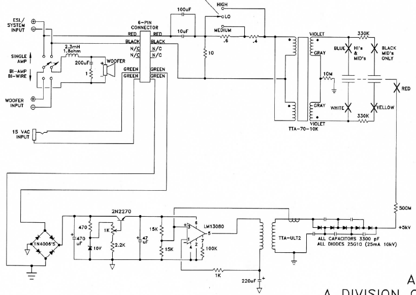

Spectra 1100 10M resistor & parts replacement
Just got my hands on a mint and near stock pair of Spectra 1100 (final version); happy to join the team of Acoustat lovers
After much reading up in this great thread and elsewhere, I'm ready for some interface modding - which leaves me with some questions:
Audio section:
- On the HV side of the tranformer's center tap, the 10M resistor was swapped by a previous owner to 14M. Any reason to change it back to the original value?
- would a non-inductive type be an upgrade for the 330k resistors? If so, any take on power and voltage rating?
Bias section:
- I plan to replace the 47uf & 470uf electrolytics with higher values & solder cap between IC pins 6&2 bobwire and the Acoustat Spectra 11 - bobwire - Planar Speaker Asylum
Any sense in changing the 220uF to higher value, while I'm at it, or vice versa retain all original values?
TIA!
Simon

The 10-Mohm resistor is not a critical value, so 14-Mohm would work just as well. That might have even been a factory substitution.
The 330-kohm sector resistors are special high-voltage types, and I see little value in changing them to non-inductive types in this audio-frequency application.
You can increase the value of the 470-uF and 47-uF in the power supply if it would make you happy. That this is a sonic upgrade is questionable.
I don't much care for the idea of soldering a capacitor directly on the pins of the IC. This may damage the chip, which is no longer made and very difficult to find. Again, that this is a sonic upgrade is questionable.
DO NOT change the 220-uF. It's value is critical to the operation of the bias oscillator.

I agree that any modification that could compromise an unobtainable component is questionable - this one doubly so since the cap isn't really in the signal path. That said, it looks like there are plenty of references to an LM13080N IC, with currently available stock in a few places. If I understand, the "N" refers to the 8-pin DIP package (as opposed to the "P" version 11-pin SIL.)

None of the caps you mention are in the audio path: both 47-uF and 470-uF are in the power supply for the bias oscillator. Hence my questioning as to their sonic impact. Regardless of the availability of the chip, soldering to the IC pins is just dumb. This mod is just adding more capacitance to the power supply, which, especially if you've already increased the 470-uF, is just gilding the lily. Just because you read it from someone on the internet, who may or may not have the required technical background or understanding of the particular circuit, does not mean it's a good idea even though they claim to hear an improvement. (We call this Expectation Bias: expecting to hear a change because you made a change.)
My recommendation is to not fix what ain't broken, and to take all advice (even mine!) with caution unless YOU fully understand the implications of your proposed modifications. But having worked at Acoustat, and specifically having worked on the Spectra series and the Ultrasonic Bias Power Supply, I would hope my advice carries a little more weight than the average well-intentioned audiophile with a soldering iron. There's an awful lot of bad information out there regarding Acoustats, and I've spent hundreds of hours battling it.
If I had any piece of gear already on the bench, I wouldn't hesitate to replace all electrolytic caps over 10 years old as a matter of course. I agree that modifications to the power supply for the bias circuit are highly dubious such as different power cords, but I see "audiophile" power cords recommended for that application which I can't possibly see any benefit in.
I agree...replacing electrolytic caps that are old is not a bad idea, as long as the original values are retained. This isn't "upgrading" the speaker, it's merely a prudent extension of its life.
