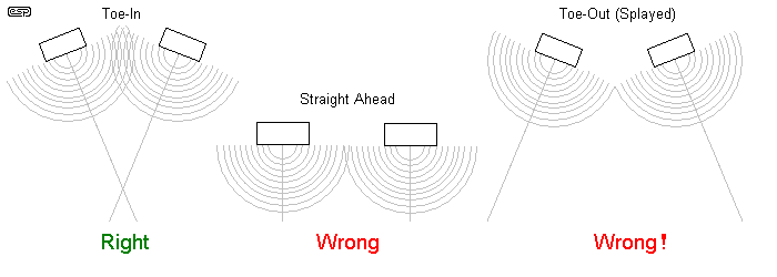

You should be sitting ahead of the toe in intersection. This puts you inside the sound stage instead of at the edge of it.So, you guys have me confused 😕

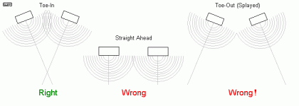

Here is a picture of toeing of a speaker.
Either NONE, TOE IN, or TOE OUT.
So "you" are still toeing them in, just to a lesser degree? Okay, I get it now. You were never toeing them out, you were toeing them in, but not as far as some.
I have found that if you aim the center of the speaker at the arm rest of the listening chair, you get them to converge somewhere behind...

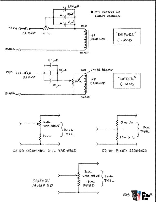

To my ears the old 1+1 with out the c-mod in the interfaces...the first Acoustat with crossover less interfaces..
Could you please elaborate on what you mean by crossover-less interface? I would consider a series capacitor a crossover.
The non C-mod one...gives about 2-3 db more output.
The series 6ohm Res, caps setup works more like a tone shaping setup than the C-mod crossover...
It's a strange circuit which adjusts from shorting the capacitors to partially bypassing them with a resistor. I'd like to see a plot of various settings vs. frequency response.
