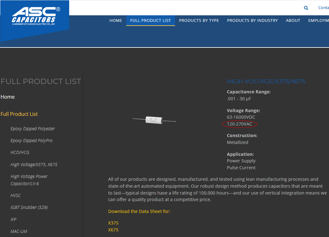

I came across these on eBay which look like suitable 0.01uF/6kV replacements: 0.01uF 6000V ASC High Voltage Poly Capacitor 6KV .01uF lot of 4 | eBay
My only concern is that they're listed as "used."
Perhaps a bigger concern is poly-what? The eBay auction doesn't say, and the ASC website doesn't yield anything on "ANA14". ASC is American Shuzuki Corp, who did make caps for Acoustat, but these don't look familiar.
If you are desperate to find replacements for capacitors that have failed, these should work. If you are looking to upgrade or replace caps that are okay but "old", I would steer clear of these because you have no idea what you're getting.

Note that the 6kV rating is for DC not AC. The application in the Acoustat mixer circuit requires an AC voltage rating of about 3kVrms. Unless these capacitors are specifically made for that(either oil impregnated or internally sectioned) they will eventually fail due to internal corona slowly eating away at the metal film. Note that the ASC website identifies their HV capacitors as having an AC voltage rating < 300Vrms. Attached is an article by ASC describing the corona limit.I came across these on eBay which look like suitable 0.01uF/6kV replacements:
An alternative to a special built capacitor is to use a series combination of capacitors to reach the required limit.
In case you missed it, I had posted an example using WIMA caps. in Post #1579
Thanks bolserst, it certainly seems ASC's current production doesn't permit AC voltages above about 300V, but ANA14 looks like a discontinued product. Definitely not worth the risk with better options available. However, they could be used for the Izzy-Wizzy smoothing cap mod for the bias multiplier.

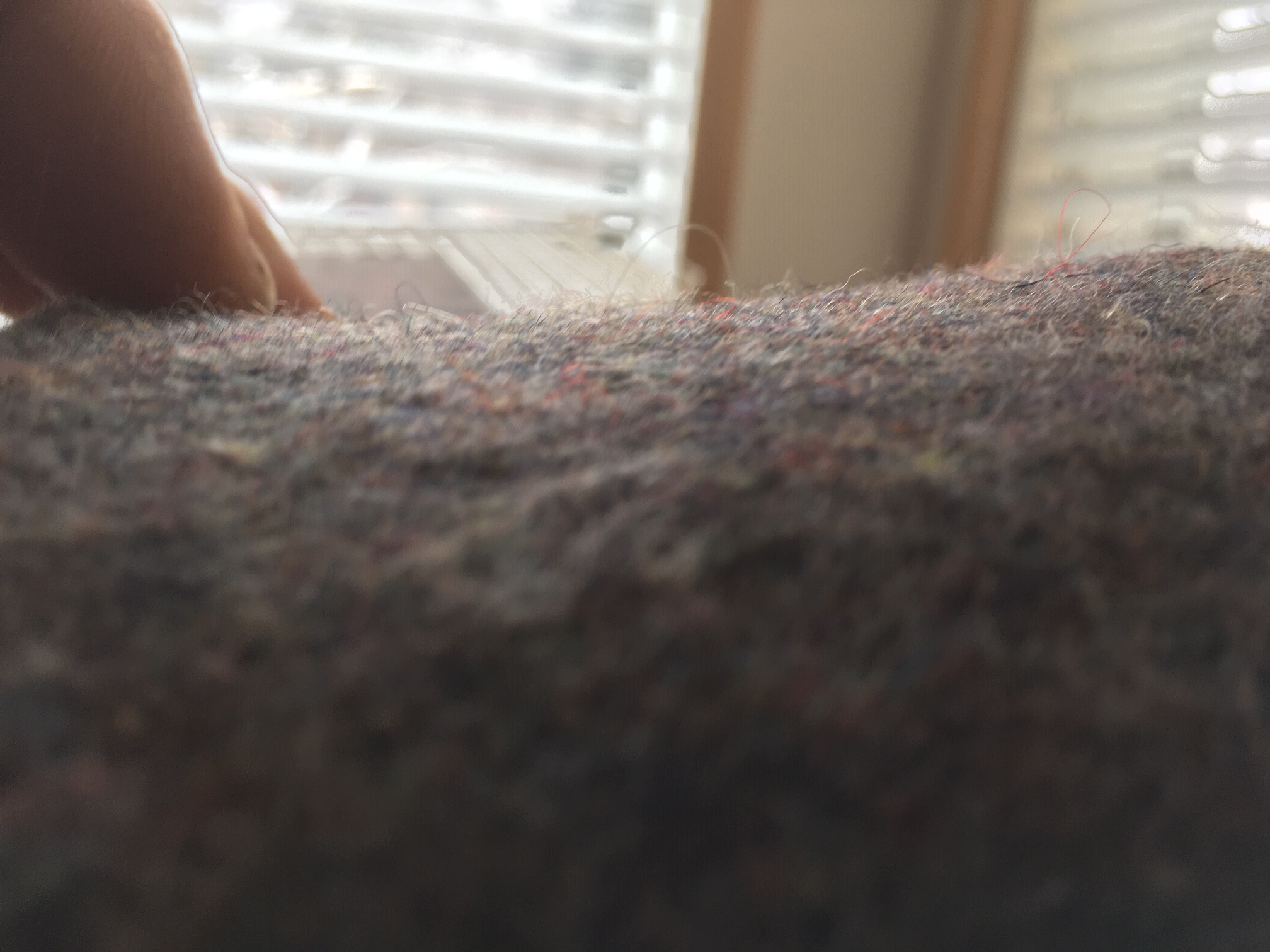

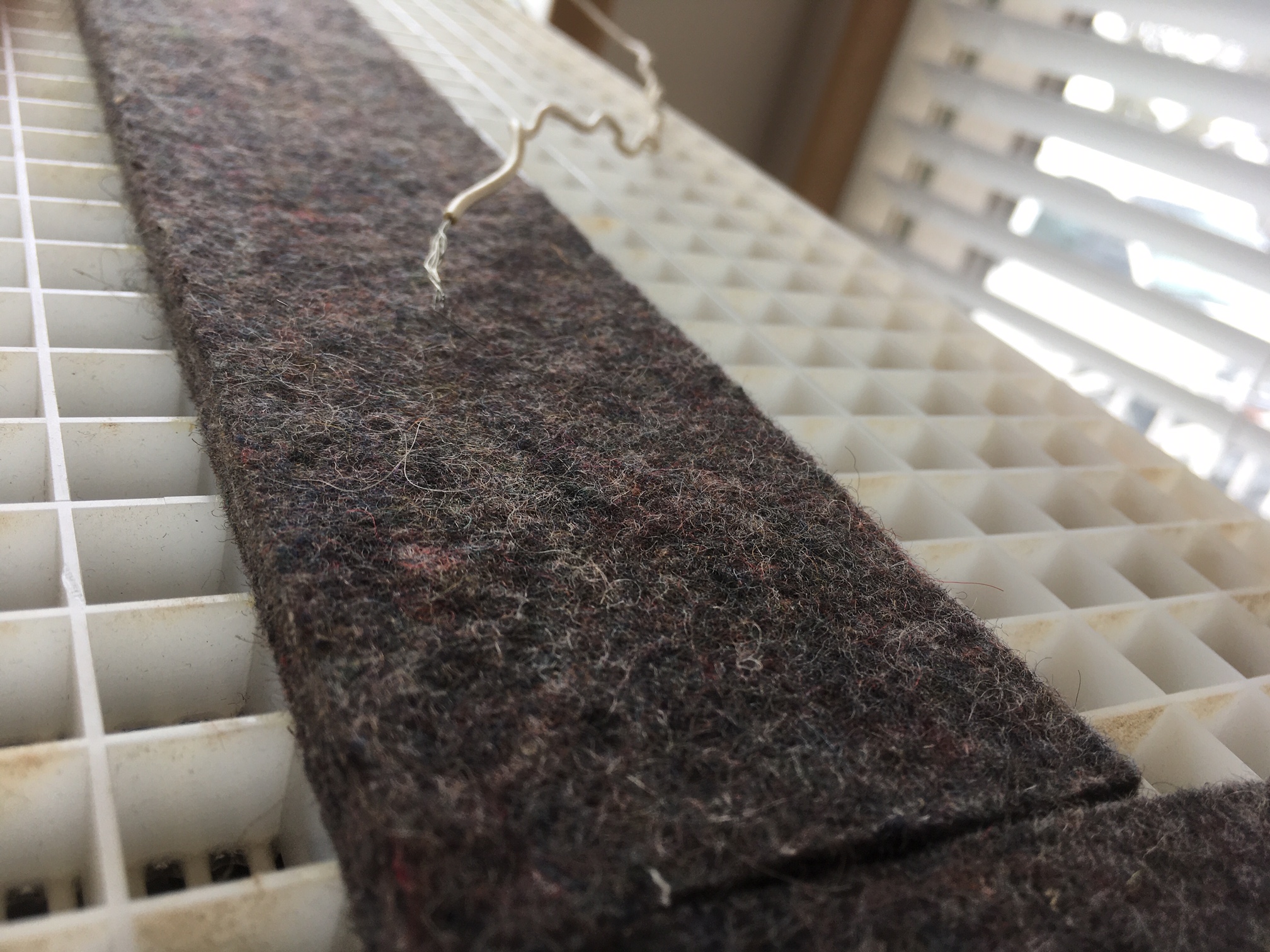

Okay, this is a panel I chose at random to pull back the felt(I have quite a few), original untouched. I've looked at others and they are identical. You can see there is no layer of glue on it. In the other pic if you look carefully, you will see the glue on the louver extending a little past the width of the felt. It's rough and unglossy there from the glue. I have a complete set of panels for the X, a complete set for Model 3, and a complete set for Monitor 3, total of 18 panels. They are all the same.Glue was applied directly to the felt over it's entire surface with a spray gun. Being a contact adhesive, the glue was allowed to get tacky and then applied to the louver. Only a very thin layer was applied, so it may not be visible between the grids.

Yeah, no way of knowing what its AC voltage rating might be without documentation or cracking one open. They look to short to be of the multi-section type, but could possibly be oil filled.... ANA14 looks like a discontinued product...
Just because you can't see the glue on the felt doesn't mean it isn't there. And if you see some glue on the louver beyond the edge of the felt, it's likely a bit of "slop" when the felt was pushed into position and it slid around a little bit. It wasn't an exact process, relying mostly on the operator's eye to gauge the final position. Glue was 3M #4693 contact adhesive, which was also used to glue together the two panel halves.
I'm suggesting there may have been a change in procedure, not that you are wrong. The glued side of the felt has no detectable residue even under high magnification. It also feels just like the other side. When I pulled it back it was quite securely stuck in place.Just because you can't see the glue on the felt doesn't mean it isn't there. And if you see some glue on the louver beyond the edge of the felt, it's likely a bit of "slop" when the felt was pushed into position and it slid around a little bit. It wasn't an exact process, relying mostly on the operator's eye to gauge the final position. Glue was 3M #4693 contact adhesive, which was also used to glue together the two panel halves.
