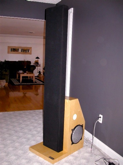

Acoustat…...Just got my 4th pr of 1+1s....$300.pr with the Medallion interface transformers.....like new......still the best sounding of all..well to my old ears...
I post the money only to show....Big Speakers are Dead to most...an then these 8" tall boys can find a room to day....the Spectra 11-1100 sale $200-250 can give them away....
So now About the Spectra11....the 1100 lowerd the panels down 3-4"
An you see in the pic others lowered them even more.with Z1100
I had about 5 pr of the 11.....never even seen a pr of 1100...funny
The Spectra 11 stock transfourm well not take the full rang...it cook!
Spectra panels can take full rang....
Andy can add his input

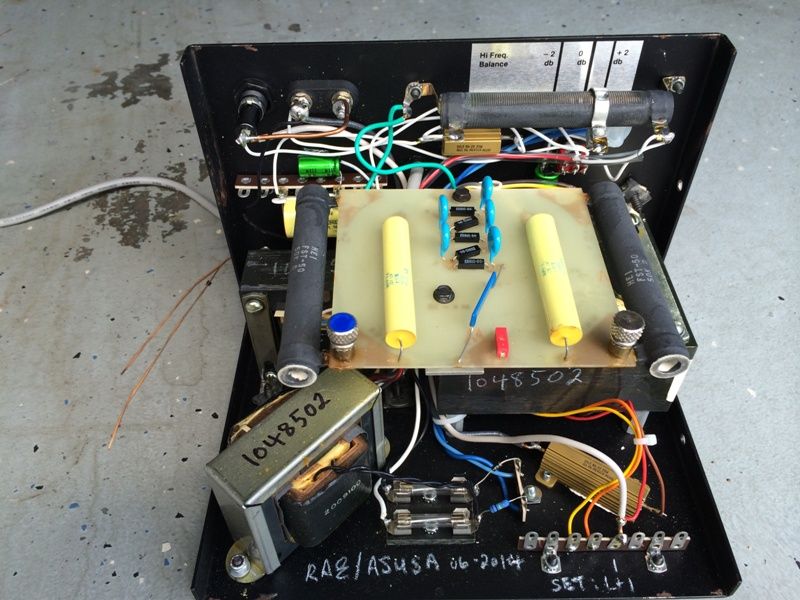

Now that I think about it, maybe 75 VDC was closer to the typical voltage measurement using the DVM method. I don't have my notes at hand.
The diodes are not measurable by any normal means. To get the high voltage rating, the diodes consist of several stacked diode junctions within each case. Typical ohmmeters don't have enough voltage to properly forward-bias the multiple junctions, and therefore they tend to measure "open" or "non-conducting" in both directions.
OK, I replaced all the components in the bias supply (except the transformer) and directly wired around the damaged area on the PC board. Checked the DC resistance of both transformers (input and output windings) and compared to the good speaker (all fine) and plugged it in. I got 85 VDC at the bias supply.
Installed the interfaces in the speakers and got sound from both. No hum on the repaired speaker. Set them close together and played a mono source and all the sound focused dead center - meaning the speakers (original and repaired) match in output.
Installed back the system and all is well and sounding great.
I suppose I should rebuild the bias supply in the still original speaker but it looked so nice and is working and I did not want to tear into it. I did get enough parts to rebuild this speaker (plus a couple extras) and so I can rebuild whenever needed.
I think I got a little cavalier with these speakers when using my new McIntosh MC 452 (500 Wpc amp) thinking they're old speakers and not worth much and so no big deal. But these are great speakers and it would be difficult to replace them with something new without spending lots of money.
So I will use them a little more carefully.
Anyway, I'm glad I found this forum and thread as it was very helpful for getting the speakers working.
Thanks again!

Ck the other interface bias,,,,,,if it 80-90 good to go...but if in the lower 70s
this well run the bass transfourmer an res. parts Hoter….an can kill parts...
Just a ward to the wise....good job.....most all the older Acoustat Bias need to re-worket…..
An a new 500mg res well add goodness an better bass, blue wafer type res..seen in the interface pic....Roy E handy worke...small price to pay for a like new ESL speaker.....Long live Acoustats
