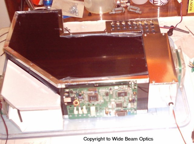

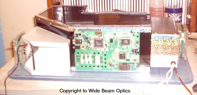

ok guys a small update, ive been making and designing the psu and ignightor box, it has 2 12v 1200mah power suplies in it and the ignightor with the main power relay that gets triggerd on and off via the modd i did to the controller card, so all can be turned on and off via the remote, ive also been doing some wiring harneses for various items, 1 being the light box another the ballast that is now mounted in its box and ive also done the wiring for the ir remote sensor, the psu box should be done in a couple of days, it was a real headache to design but i got there in the end, it will more then likley be filled with holes like the ballast box mainly for looks not so much cooling, a fan is on the outside of it that will push air in the psu box and exit into the rest of the projector case, ive also modded the controller card as mentioned in a previous post, unfortunatley the underside of the pcb pics didnt turn out too well but ill post the better ones for u to see how far i went with it, also in the controller pics u will see 3 pluggs that ive added, they are for relay pulse for the main power realay, the standby and power leds to be at the front and another for the infrared remote receiver, also u will see the small micro relay ive added to make the standby and power leds possible, also ive wired it in such a way that the controller pcb doesnt take any load for the modds wich means this way i wont be taking power from a place that will be needing it and therfore the controller will run in a much better fashion, anyway hers the pics, ill post the psu box on the projector base first from a few different angles then the controller card modds.
Pic 1
P.S sorry this first pic realy is crap so u will just have to imagine the psu box there lol

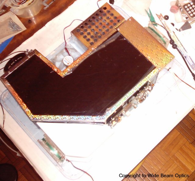

ok pic 2
if your wondering what that black thing in the psu box is standing up well thats a drill bit holding the top up, i have yet to make the other panel that covers the front and sides
