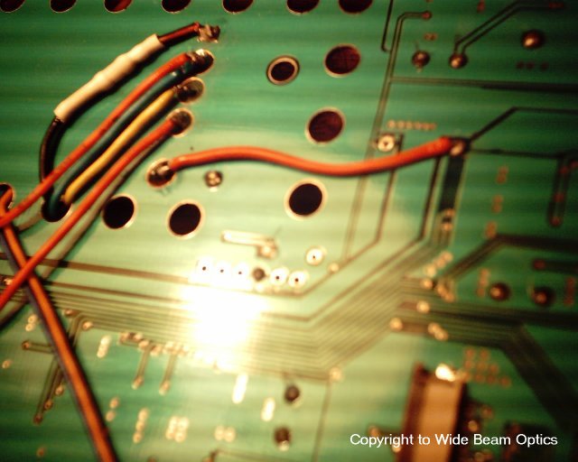

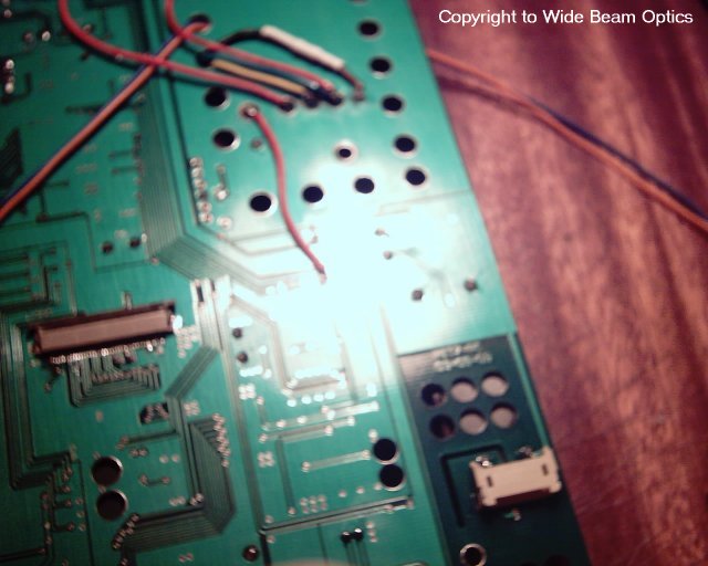

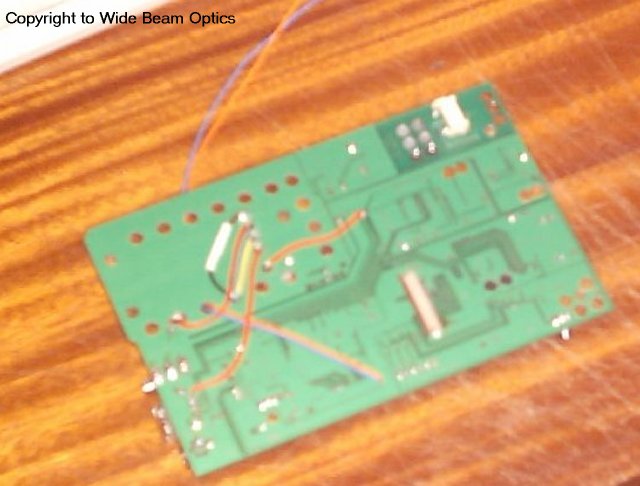

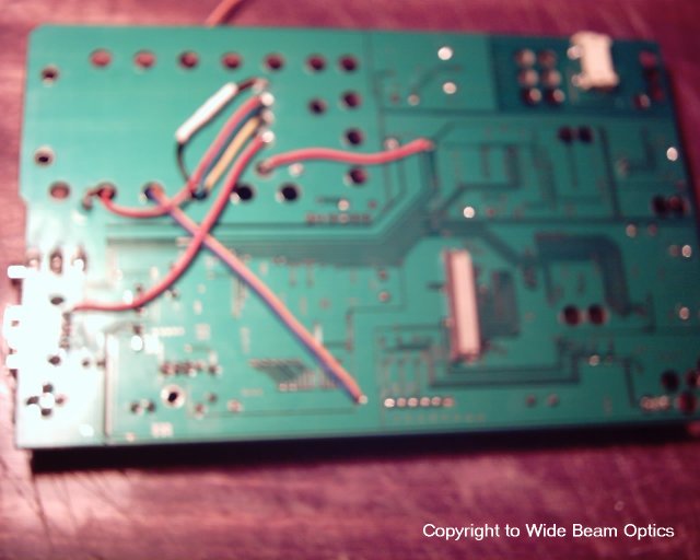

ok and here is a few shots of the controller card here is a shot of the uderside of it and the wires going to the small relay, all of the wires on this pcb are my modds, the controller doesnt have any on it normally, its all been tested and works fine with no interferences in the signal. Also i have drilled some holes for the cables to come through, this isnt a updated pic of when i finnished it , the updated that i havnt taken yet has another resistor and wire under the pcb, also another plugg at the front when u will see the plugg and relay pic, the white on the wire is heat shrink over a resistor that solderd on the wire.

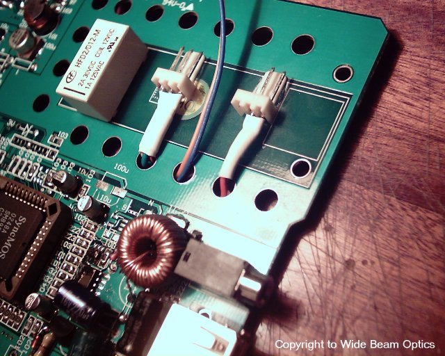

ok and here is a close up of the wires that go to the micro relay, the holes that the wires go to is where i drilled them and where the pins of the relay come out, the relay is super guled onto the pcb and is also solderd to a ground plane on the pcb for an earth. The soldering looks alittle rough but i can asure u thats A grade soldering once again my cam has let me down lol ( i think ill buy a dogg soon and give the cam to the dogg for a toy! )

ok and here is a shot of the relay side of things, there is a plugg missing in this shot as its outdated as mentioned before but the plugg thats been fitted in there now is inbetween the 2 in this pic, they have also been super glued on. Once again the white stuff over the wires is heat shrink to protect the wires from any acidental shorts and neatness although it could have been abit neater with the nice size up heat shrink lol

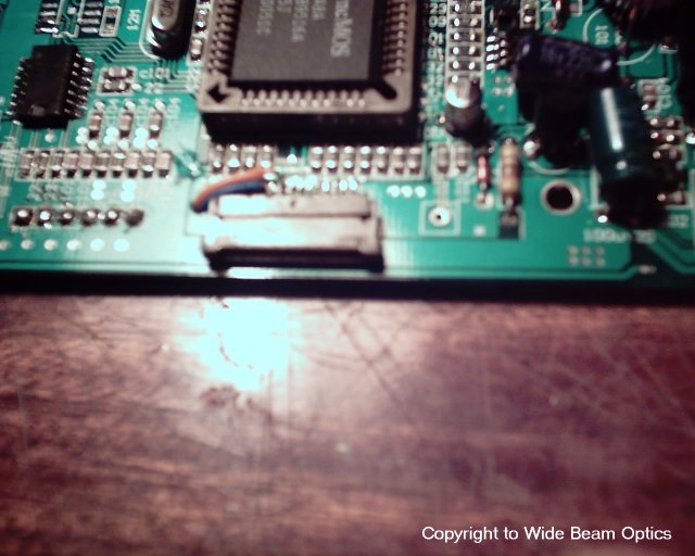

ok and this is some super fine soldering, once again the cam makes it look like its crap but in real life that soldering is spot on and very tiny and neat, the 2 wires u see here are the remote sensor wires, once i found them i didnt need the button pcb any more so i have that thrown in a cubourd for a rainy day (or spare parts the small leds that are on it are smd leds, they are perfect for modding a mobile phone with a blue lcd backlight and to have blue buttons), as u can well, cant quite see the solder contacts on the conector i solderd to are about 1/4 of the size of a smd resistor so make sure u have a very sharp soldering iron tip to do that mod, well thats about it guys ill have more pics soon, im still waiting on my mylar and frensel but it should be in any day so i can then start the pyramid of the light engine.

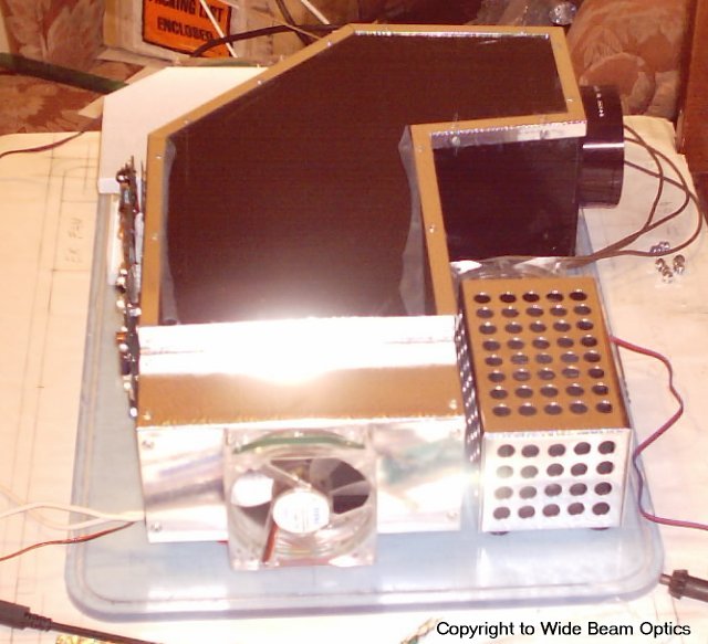

heya buddy, no i dont have any keystone problem, if one side of the image is out to the other, say the left side of the image is higer then the right side that would be because the mirror isnt at 45deg or lined up properly to the lcd, i use front surface mirror, if u use the regular mirror then u will get ghosting and also image shift, also u may find the left side biger then the right as the normal mirror wont fully reflect the image perfectly at 45deg, as for a keystone corection well i could impliment one in this but just lol, there isnt much room infront of the lcd because the focal on this projection lens is quite short but it is doable, most probally u would get a maxium keystone correction of 20 deg, the next model i may impliment the keystone ajustment for a vertical plane.

nope, im using the mirror to correct the image the right way round and to also make this form factor of the projector possible, mirrors dont use much light if its a front surface mirror, (if anything noticable), but however a normal mirror will, the focal is short enough to make the projector without any modds to the triplet, i dont fool much with triplets as they are fairly much in their optimum state out of the factory, so if u wanted a shorter focal id recomend u to buy a triplet that has a shorter focal, on this lcd i wouldnt go any shorter then 180mm focal without a mirror and no shorter then 240mm with a mirror.
