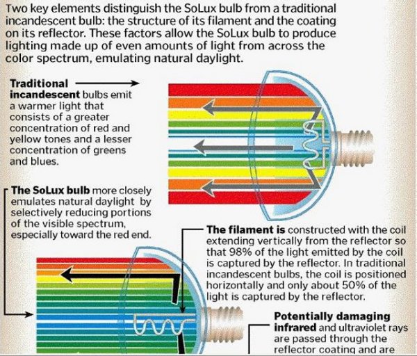

When using parabolics or ellipsidals, make sure you run your bulb with the arc running through the reflector and not have it sideways as its more eficient, (i did see a document on this somewhere ill have to dig it out). It makes the world of difference.
And here is that document, (read the fillament part in the chart).
Trev
Trev![]()
yeah buddy, that makes it evidently clear to me.
but to reach that aim you have to built in the double sided lamps, haven't you? Coz the -T style or double ended lamps won't be so efficient due to their kind of construction.
I've seen this style on lamps fabricated for medical fiber-optics appz. I think we have to go a way between both styles. that's how you can make it "diy-usable".
I'll keep an eye on this monster -thread. It's always an inspiration. And.....I don't wanna miss the final product.
ief
Actually i think its possible to run both in the ellipsidal, there are 2 types you can get.
This is the type i have, (see pic).
I get what your saying though and i agree, but its got alot to do with the power of the frensels too that ive found. Having a frensel with too much power will show the end of the lamp, while having a frensel with less power and you dont see the lamp. I think with using condensers this is realy only good for side mounted bulbs but its doable on both.
Regarding the CDM-T, mines untouched. I just poked it through the hole at the right focal and it works. I think a better bulb would be a CDM-T style with a clear arc tube, we can get these, but hard to find.
Trev🙂
