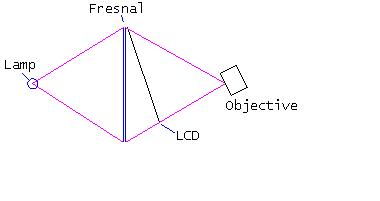

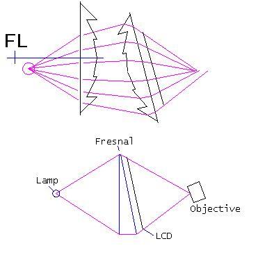

The following info might help in understanding what I'm trying to achieve.
Here is a pic of a standard split fresnel set up. Take note of the light running parallel to the fresnel grooves. This is the most efficient way to run it.
There are two problems when the fresnel is tilted to correct for keystone. The first is that the grooves are no longer running parallel with the light, it is blocking it, causing a shadow. The second is that Spherical aberration is introduced into the objective. You can clearly see this in that the rays are no longer focused to a tight point. Because the fresnel is in front of the LCD, it is now part of the objective and any distortions it introduces will be visible. This is the reason why we can only get 10 degrees of keystone correction, any more tilt and the edges of the LCD distort and/or blur.
We can gain an extra 5 degrees of correction by tilting the fresnel 15 degrees and tilting the objective in the opposite direction. This is called Scheirmpflug rule or lens shift.
The next method of keystone correction is where I hold my hope. I haven’t fully tested it yet as I’m waiting on a FFC but I have tested it with clear OHP sheets and it all works correctly. I have actually achieved more than 15 degrees of correction. The only thing that will let this method down would be if the LCD’s contrast weren’t consistent over the screen. The Samsung I will be using is relatively new with a large viewing angle, so fingers crossed. Here is a pic, the objective can nearly be level with the top of the screen at about 2400mm.
Because I’m using a 17’ LCD the Fresnel’s have to be large so here is an alternative. It’s a compromise but I think with some fine-tuning I should be able to get it to work. If you look at the ray trace I deliberately raised and placed the lamp closer to the rear fresnel to spread the light slightly to compensate for the ring shadow in the second fresnel. As an added bonus this config actually improves Spherical aberration.

heya dazzla, hmmm i dont know where you got some of those drawings from but they dont look too right, tilting the lcd ones do but the frensesl ones arnt too correct.
The light that goes along a axis wont change its axis from a lens, only a prisim or a mirror can change the axis, and thats what give us lens shift, maybe you mixed that up with keystone, who knows but however with a top frensel tilted it wont alter the lights axial path, what it does alter is the magnifacation and thats what gives us the keystone.
The reason for the rings as ive stated in an earlier post is from the light traveling in a single given direction, if you could change the light rays to match the angle on the rings of the top frensel then you wouldnt get the ring shadow, although not impossible, in our diy world it is on the cheap, and honestly i wouldnt be too fussed about it.
A rule of thumb to follow is to always have the lcd panel perpendicular to the lcd, thats a must, i saw a drawing in there that wont work as it was out of paralelle.
I drew them, what do ya mean not, to, correct😡 😡😡
Just joking and you’re correct they are not 100%. The software I used is meant for drawing house plans so it's a real pain to use for ray traces. The rear fresnel is right out of wack, I rushed it hoping you wouldn't notice, Bugga.
If you mean the LCD and lens, then I have to disagree. Tilting the lens with regards to the lcd will compensate for spherical aberration intoduced by the tilted second fresnel.
