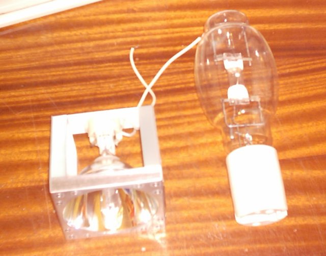

hey ace how do you get that bulb in a ellipsical reflector???
i have a 175w medium base metal halide bulb that i want to put in that type of reflector

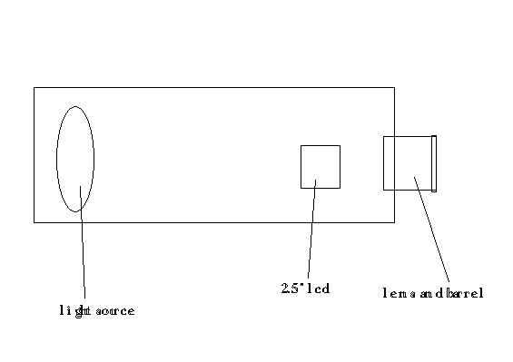

hi guys love the work you people have done.
im starting a project myself and need a bit of help. im going for the cheap route but dont mind putting in alot of work. im going for a screen size of 50" - 55" but dont mind a bit smaller if the quality will be better. do i need a frensel if the lens covers the whole lcd, or is it best to still use one.
has anyone got a basic diagram of the setup for a 2.5" lcd projector.
would it be possible to use this light as a light source. and a fresnel lens witha 300mm focal length to drict the light into my lcd or is that not nessercary.

the pic is wat i want the basic layout to be will that work or is it possible or out of the question.
also what sort of lens would i need for this.

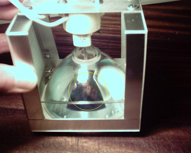

Through a 22mm hole buddy, you just poke it through.

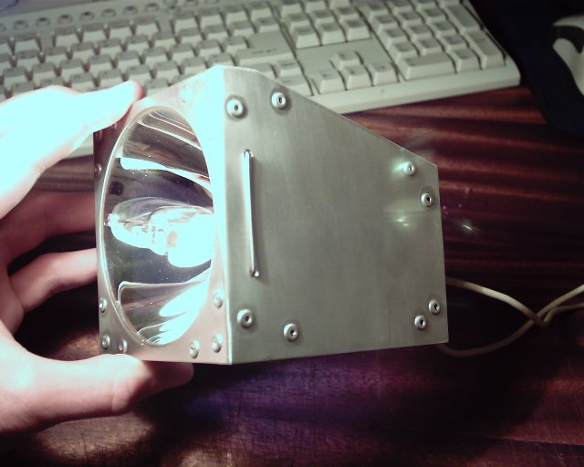

You cant do this on the larger bulbs. I have taken a shot of my new light unit against the exact 175w mh bulb you have.
That 175w light is brand new btw, if anyone wants it let me know by email. Its been sitting here for over a year doing nothing, never fired up and comes with ballast socket, ignightor and cap, all brand new.
Trev🙂

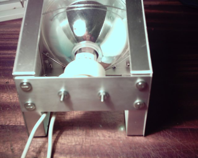

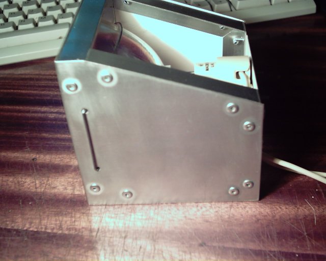

The reflector is held in by a spring i made out of piano wire as you can see in the next 2 shots.
The unit isnt finnished as there are 2 panels that go on the top and bottom that mount flush to the lip on the sides. Overal this thing in real life looks very pro, but on the cam nothing like it. Ill finnish the other 2 panels off asoon as ive finnished the design for this in the projector, so i can sort out the cooling.
Before any of you guys chuck a fit and say the lamp isnt central lol it is, its just from the veiw from the cam from which i took the shot.
And here is a side shot showing the side of the spring.
Mind the odd bolt on the lamp being too long as stated the unit is not done.
The performance of this new elipsidal isnt bad, its the same brightness (if not brighter) as a 250w HQI-TSD with the arc being condensed, so that means its going to be alot brighter then a standard 250w setup.
For those of you who have played with a parabolic reflector and thought the Parabolics wer touchy, these reflectors are 10x worse. Everything has to be spot on or it wont work right.
Ill be back with more updates at a later date.
