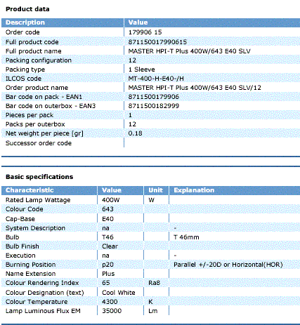

Hell, I'm doomed....got everything but lamp, and now I found out I can't use under 250W...:cannotbe:
Well here it is 220 volt :xeye: .
I got another source here locally ACE, but it's different from any of your lamp, wonder if this is okay to use http://www.eur.lighting.philips.com/int_en/oem/ca/general/products/catalogue/Chapter_04/5243s.pdf
I intend to use HPI-T PLUS 400W. The problem is I can't get the ARC size info, and the CRI is only 65. But I guess that might not be a problem coz brainchild also uses EYE lamp which has CRI of 65 also. Right ?? Right ?? Please help:bawling: :xeye:
Yeah it will also run on 220v lol, it should be fine, we have a 3 - 10% varience in voltage threshold on ballasts so it will be ok.
About brainchilds bulb, if you dont want to use a condenser then its fine, forget about cri for now, all it is, is just a ratio on how real colours look to normal daylight, its like a light rendering parameter, ofcourse a high cri means much more vivid colours then a low one, but its not overly important and its not a must. All of my bulbs are 90cri and up so i cant realy coment on the difference between the low and high cri bulbs, but its not overly important.
The main thing to worry about is the lumen output, sure brainchilds bulb packs a punch, but we have a problem, because of its size it will be difficult to catch and dirrect the light to the lcd panel in an eficient manner, therfore we go for a smaller diameter bulb so we can direct the light much more eficently through the lcd, with a 400w bulb, personally i wouldnt be too fussed about a condenser, only some of us want the best performance from our bulb and not to waste light, besure that a 400w bulb will yeald you a bright image.
I cant get into the link you supplied about your bulb so maybe a screen shot might do it as most of those catalogs run through their own server and dont alow the links to work.
Btw, the arc size on a 400w lamp is typical of 25mm.

Sure ACE here's the PIC :
So whaddaya think ?
Yeah that bulbs fine buddy, its not bad actually i wouldnt mine one myself for testing lol, its also a good low profile bulb so we could use a condenser and a reflector with that, i say go for it bud.🙂

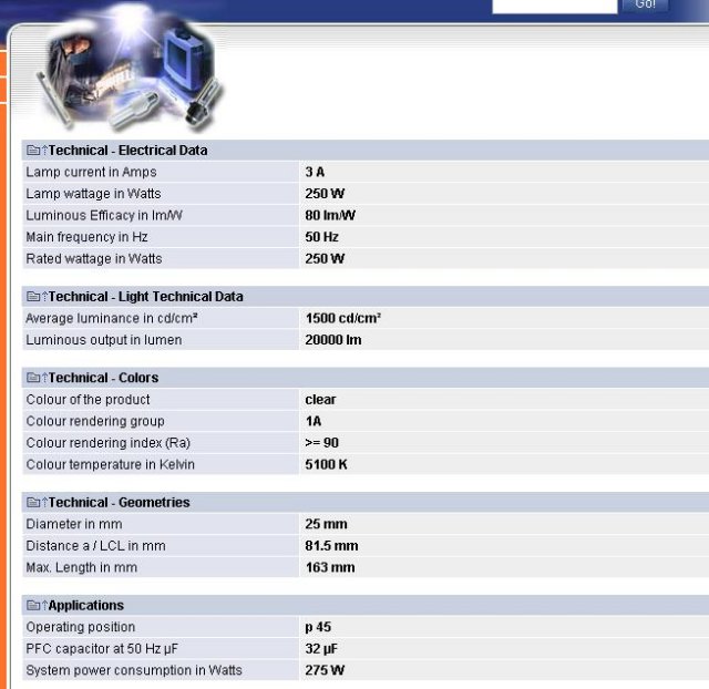

Just for interest, here is the spec sheet on the new 250w bulb i just got.
Trev

Last question regarding this bulb ace. The center size that emits the light is only 40mm on this bulb, so can I use my 60mm condenser for this thing ?
Its abit small lol, u can, but better to use somthing thats about 100mm - 150mm with a focal the same as your frensel, that wont be hard to find, and will yeal great results.
