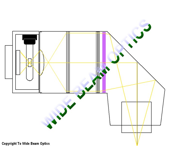

Ok in the setup of the light engine, i have a condenser, a pre condensing frensel for the main frensel behind the lcd, and the main frensel, the lcd is a 7inch wide screen lilliput. The condensers im selling will work in ohps too with a 15inch lcd, they are specially coated also to absorb more light and to filter out glare, ive had many condensers in over the past but ive never got one as good as this type, the light that comes out of this one is very bright, colour corected and very even, also it yealds a very wide angle of the light. The new reflectors ill be getting in will be spherical and they have a focal of about 30mm, ill be getting in a couple next week to test and will be for sale the monday after, ive orderd 20 from china so the numbers are limitited lol but i will be getting more in at a latter date if there is a call for them, they will work on the 15inch lcd also or the smaller lcd models.

Heya hezz hows it? ok here is a rough pic, the tech is new so im not going to get into it, this is idea 1 i have a new idea thats even brighter and gives a superb image but i havnt made any drawing of it, as it is your lucky to see this one as there was going to be one similar to this in the plans lol, but i wont hold the tech back from the forum aslong as nobody is going to go out and copy my light engine design on this particular lcd. Also this pic is slightly out of whack near the lens barrel as i drew it in a hurry.
