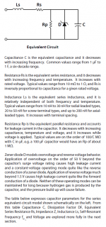

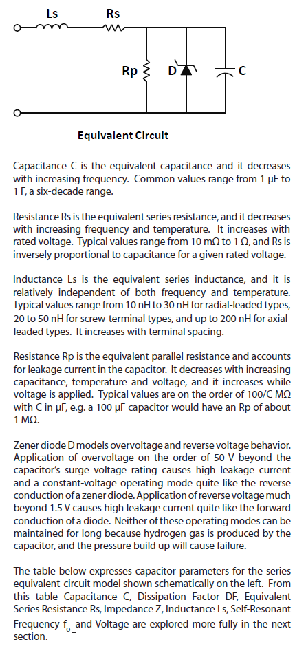

I've copied part of a Cornell Dubilier application guide below. Notice that "equivalent series resistance decreases with increasing frequency".
Dissipation Factor (tanδ) suggests the same thing: ESR = tanδ / (2πfC).

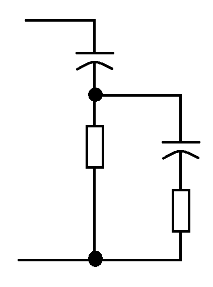

Thus ESR is not constant, and cannot be accurately modeled at all frequencies by a single resistor. Perhaps we can increase accuracy by including more than one resistor in our model of a real capacitor? Perhaps a two-resistor model as shown in the attachment, will give better results. The first resistor models ESR at 120Hz, and the (first resistor in parallel with the second resistor) models ESR at 100 kHz.
This idea may be straightforwardly extended, to prepare capacitor models employing three or more resistors. These can better fit the measured ESR vs frequency data of real capacitors.

Thanks for the answer! This is what I had also read to estimate a value for Ls. 🙂
So yes, it follows from the equation that ESR decreases with frequency. Notably, I have been thinking about all these after a comment of yours, reminding that capacitors are not ideal etc. So I wanted to safely estimate the HF suppresion of an R-C filter based on models that add ESR etc.
Therefore, it goes without saying that modelling everything with an ESR of some milliohms vs half an ohm or what, is extremely different. Maybe I will just use the maximum ESR for low frequencies, and estimate a value to include for HF - not zero. All this easies my efforts - good to know I can get rid of big ESR when in need of serious HF attenuation. 😛
I mentioned 100kHz or so, because I have sometimes seen curves indicating the capacitor impedance vs frequency, and I remember (of course I can be mistaken) graphs showing a minimum value around such frequencies. My guess is that indeed, there is a characteristic frequency for each capacitor that Ls cancels out with C - the capacitor then could have purely ohmic properties.
So I thought why not take the ESR measured while reaching that frequency, and use it in our model for all greater frequencies? I believe this would bring our HF suppresion simulations on the safe side. Apart from the fact of cource that should ESR really become zero for high frequencies, then this approach could include some damping that does not exist in real life for other frequencies that could be resonant ones - a dangerous thing. Still, it could hardly matter, provided one ensures that damping factors (series resistors, winding resistance etc) are present in reality.
