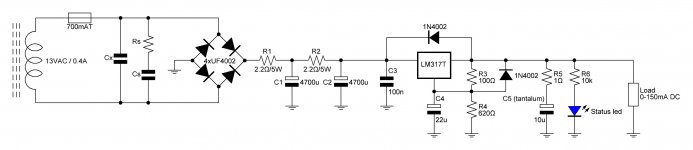

9VDC LM317 power supply schematic
As promised, I attach the schematic I have come up with so far.
Nothing very special - secondary, slow blow fuse, snubber, bridge, two R-C filters for smoothing and then the LM317 circuit. Which uses the 100n film cap at the input for transients, and an R-C combination at the output for stability. I have chosen a 10uF tantalum cap in series with an 1 ohm resistor. Plus protection diodes.
All resistors unless specified are 0.25W metal film. Maybe I will put 0.6W metal films if I can get them easily.
Any opinions are welcome! 🙂

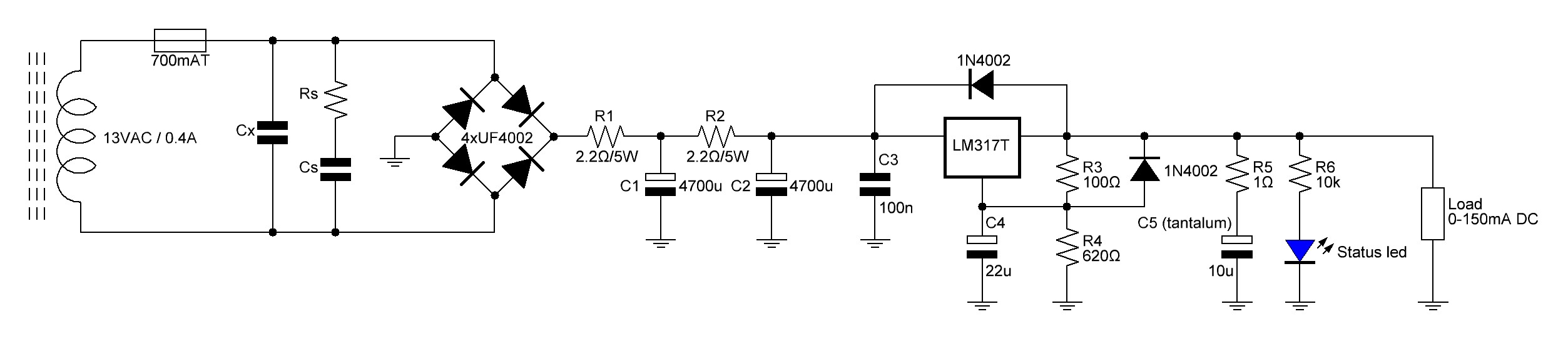

I'd put a 1.8k bleeder resistor across C2.
I'd also consider putting ferrite beads around the legs of R1 and, perhaps, also R2. (Here is a datasheet) and (here is a sales page) of some ferrite beads.
Me, I'd use ferrite material "73" (0 - 40 MHz). But a Really Conservative Person might use one "43" bead and one "73" bead on R1, followed by another "43" and another "73" on R2. Hey they're only 9 cents in quantity 100; it's cheap to be paranoid.
