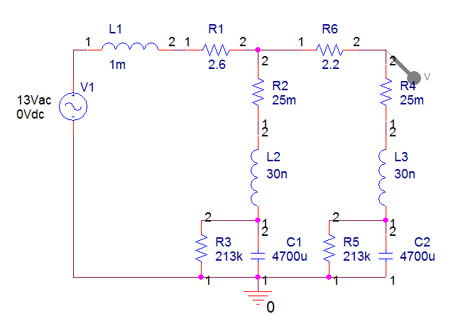

Thanks a lot transistormarkj! 🙂 Saying 1L, 1R you mean to give equal values to each component of the model, am I right?
As for the ESR, do you think I ought to use the value derived from the worst dissipation factor, or the typical impedance at 100kHz?
For DCR (leakage resistance) I use 21,3k - since Imax=0.01CV, where Imax is leakage current, for the caps I want to use.
Well, after a bit of simulations, assumptions and evaluations, I have come to a conclusion I hope.
I decided to replace the first 2.2Ω resistor with a 1mH, 2.6Ω, 280mA inductor. I have found this one, but tomorrow I will check local availability for anything else.
This option is cheap: I would pay around 0.2 euro for each 5W resistor, now I will pay around 0.3 for each inductor. Which means negligible total extra cost. Also, such radial inductors will save me place in the final layout.

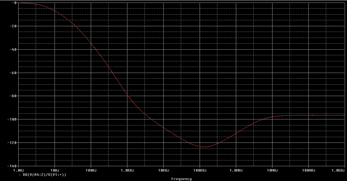

As for the frequency response, I simulated things a bit in Pspice. Assuming 25mΩ of ESR (quoted for 13mΩ, but why not add some more to include contact and trace resistances), 30nF of ESL (I think this is reasonable, and big if I refer to some articles I have read) and 213kΩ of leakage resistance - assuming 10% of maximum leakage current.
So, I attach the results. Given that the transformer winding will also introduce some leakage and resistance, the performance could be also "better". But, my main goal is achieved: adding around 80dB of attenuation for high frequencies (above 10kHz or whatever) to compensate for LM317's poorer rejection. To be more specific, to make sure I don't rely on it to reject high frequency garbage. 🙂
The performance is quite good, actually adding 80dB of attenuation above 1kHz - so even if in reality the performance becomes worse, I think it will be really good above 30kHz or so.
Next step, as Goatguy correctly suggests? Go buy stuff and try it in reality! 🙂

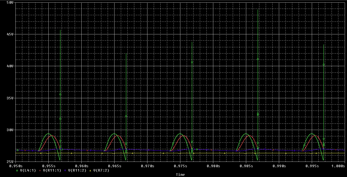

Performing some simulations, I came up with something that seems a bit bad, concerning the direct use of an inductor after the bridge.
When I arranged the filter as L-C-R-C, I noticed some large spikes coming behind the inductor (behind = adjacent to the bridge). I assume that the large dI/dt ripple current that the first reservoir draws through that inductor, causes it to give a voltage spike.
So, the voltage waveforms in Pspice looked like the following:
The green waveform is the leg of the inductor that ties to the bridge - the spike is clear. After the inductance part follows the resistive part of the inductor (R11). The total voltage across it mimics the ripple current needed to charge the reservoir (red curve), while the voltage at the reservoir (purple curve) is the expected rectified voltage with a reasonable amount of ripple. The yellow curve is the input to LM317, that is the voltage waveform after smoothing caused by the cascaded R-C section.

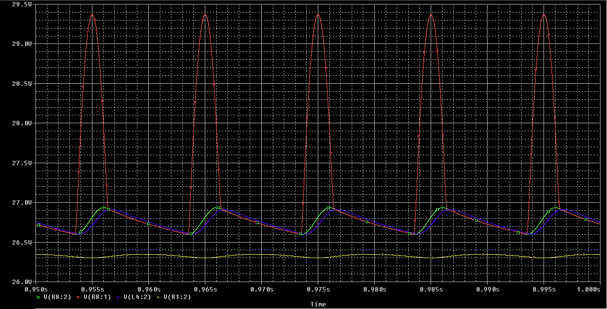

So I thought a bit about what to do, and I decided to rearrange the filter making it R-C-L-C. The resulting waveforms:
So, everything looks smooth now. I believe that the solution lies in the fact that there is a much smaller ripple current through the inductor, so the spike phenomenon is eliminated. Seems to be the best solution, meaning nothing has to change except for the layout.
I would like to have a look at all these with the aid of an oscilloscope. I hope I will get the chance to monitor it in reality to see whether it really occurs. 🙂
The only "drawback"? The ac response of the total filter remains unchanged, except for the fact that above 10MHz, the attenuation goes from around -95dB to around -90dB. Hardly a concern, though. 🙂

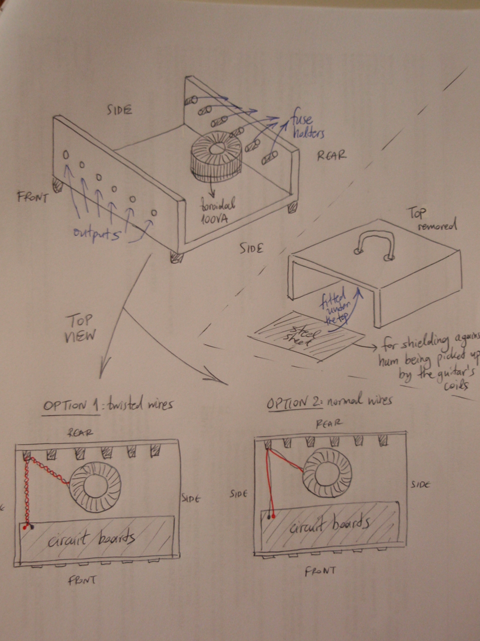

A question for the final layout: does the arrangement of the secondary wires play an important role in hum issues, as far as the power supply alone is concerned?
I was initially thinking of twisting the wires until they reach the fuses, and then I would go again with twisted wire pairs to the rectifiers. But I suppose all this does not matter since all that filtering takes place afterwards, and we have no sensitive circuits nearby - eventually, all these currents will reach the rectifiers.
So, I have concluded that twisting wires could only help the guitar not to pick up any interference, and would add no significant noise to the whole power supply sytem. The box will be aluminum, so I am just a bit anxious about magnetic fields escaping it and reaching my pickups. 🙂
Do you agree with my opinions? I think I could also attach a thin sheet of steel below the top aluminum sheet, to shield things a bit from my guitar. Do you think this would help?
If you don't quite imagine the physical layout I am suggesting, please note it so I will elaborate a bit. 😉
So I decided to attach a quick sketch of the layout I am currently thinking, to clarify things a bit:
Of course, to simplify the sketch I just drew the wires for one supply only - same concept for each of them.
So I need your opinion on Option 1 vs Option 2:
(1) Do you think they have any difference as noise in the power supplies alone is concerned? (not the guitar coils)
(2) Will Option 2 prevent unwanted interference from reaching my guitar's coils?
(3) Do you think that just inserting a steel sheet (or something like that) as illustrated, would be better than using Option 2 in terms of shielding, thus making Option 2 useless?
Why asking all these? Just because I want to evaluate the lead lengths of each secondary to modify my order accordingly. 🙂
