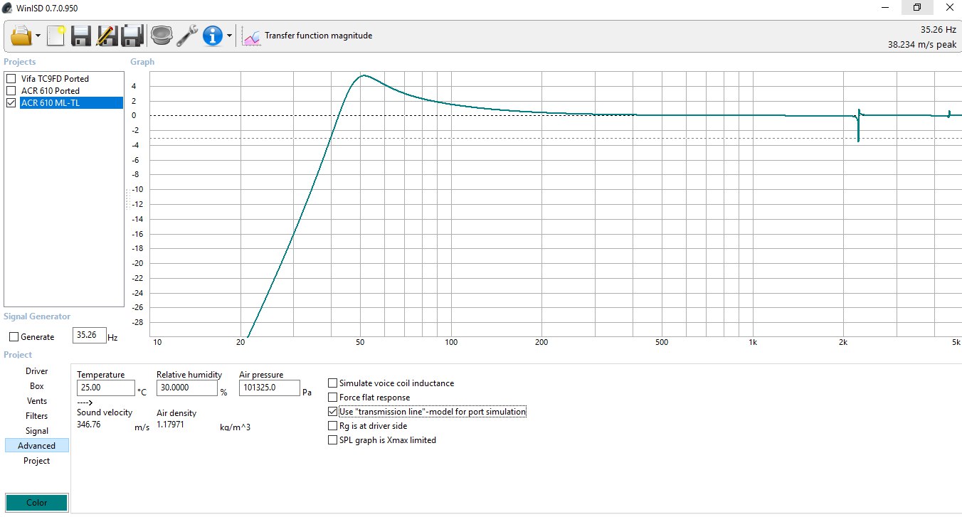

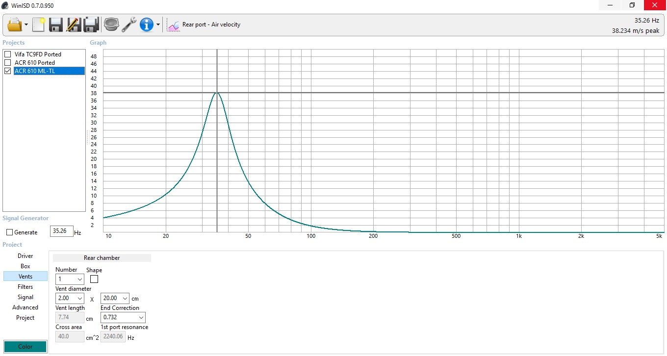

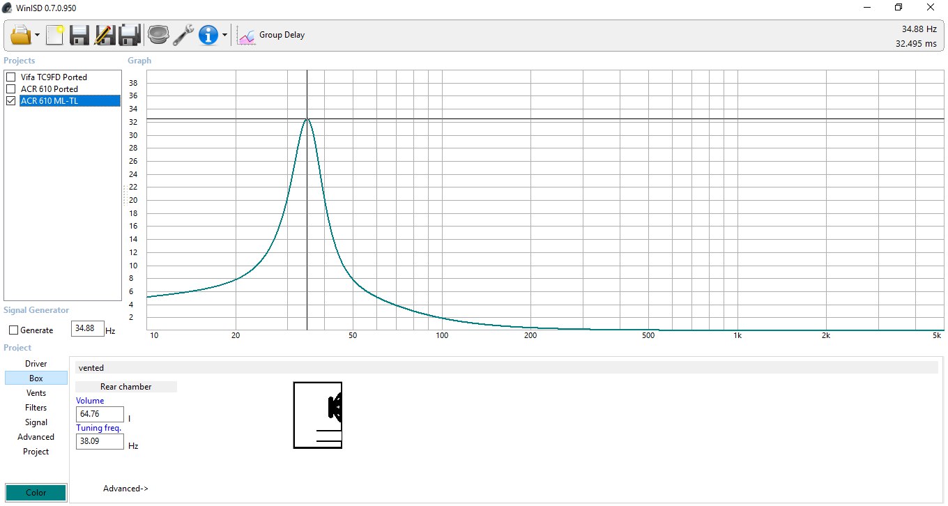

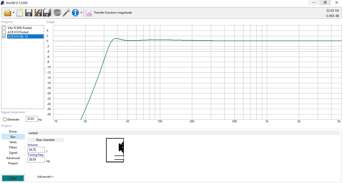

Guess what: I managed to get WinISD on a borrowed laptop. Long story short, you wanna help me see if this driver can be good in an MLTL?
Using the default result, Vb is 64.76L. I don't mind having it as tall as 115cm, as wide as the driver, let's use 20cm, and 28cm deep. That is 45.2x7.8x11 inches.
Please let me know your initial thoughts on this, and if there's any information you need from me. Thank you so much.

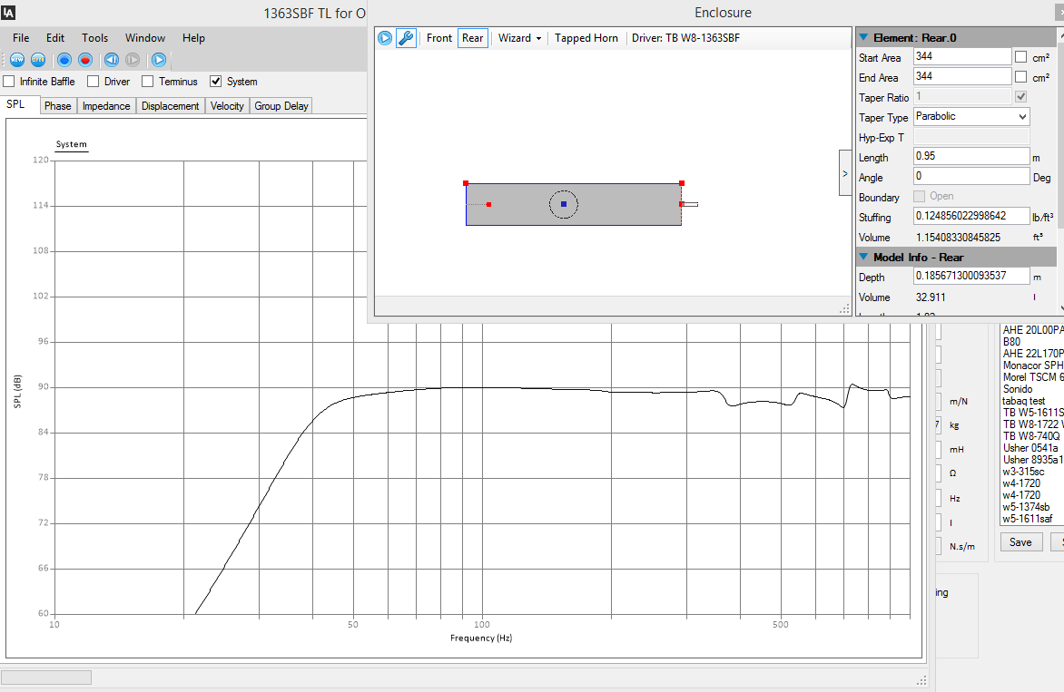

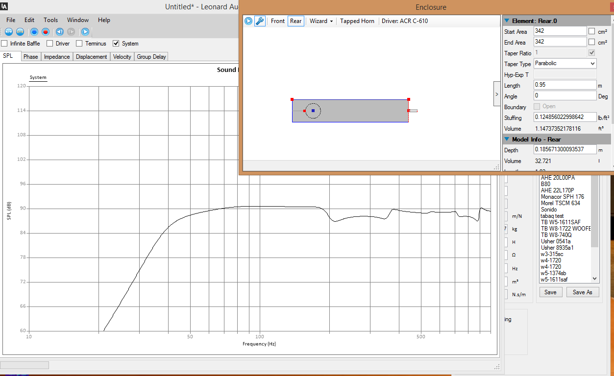

Alright, your woofer seems ok in a 344 cm2 enclosure that is 0.95 cm tall.
Vent is 33 cm2 and 0.7 cm long.
The output is there, although there are drivers out there that will get better bass extension, push it lower than that, but they usually end up in a much bigger than this enclosure. This is a very reasonable size.

And the vent is 18x1.83cm opening, but vent length is only 0.7cm? Just checking to see if I got it correctly.

This is what happens when you go bigger and taller.
Yes, it goes down lower, but if the room picks up that 31Hz bump, it will resonate throughout.
I must admit, this driver behaves quite well, even when it's on a bigger enclosures.
I've seen a lot of drivers create huge bass spikes that would have made listening uncomfortable.
In this case, it's not so bad. I still don't like the bump, but if by any chance the room picks up a 45Hz, then, it would be quite impressive for this 6.5".
