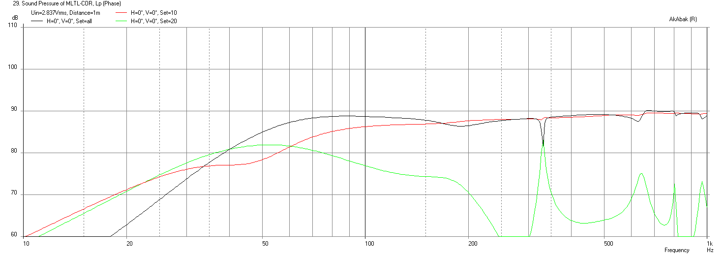

If you want, I can turn on back wall and floor reflections (tell me distance away from back wall and how high your driver is above the floor) and I can show you what it looks like. Ain't going to be pretty - lots of reflection dips, back wall bass gain is good as I did not turn on baffle step losses (about -5dB) so that will come out maybe even with wall and floor.
Basically it amounts to hard against the back wall - maybe a 4" gap. As you say, the baffle step will be pretty much not there, which is why I think the SPL will probably be ok and match-in with the Alpair on top with minimal level adjustment.If you want, I can turn on back wall and floor reflections (tell me distance away from back wall and how high your driver is above the floor) and I can show you what it looks like. Ain't going to be pretty - lots of reflection dips, back wall bass gain is good as I did not turn on baffle step losses (about -5dB) so that will come out maybe even with wall and floor.
Driver centre will be 60cm above the floor, as my speakers sit on a low plinth.

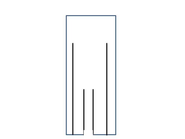

Can anyone here advise me to see if this design works in accidental mltl.
I have a 60cm length 8 inch diameter pipe with another 50 cm length 6 inch diameter pipe inside. The speaker port is about 25cm long and 2 inch in diameter . The speaker driver is SB acoustics midwoofer PFC 6.5" and will be placed on top.
The pipe inside a pipe hopefully hopefully should resemble folded MLTL. I am using this for a subwoofer. I know I should use sub drivers, but sometimes they are just too slow sounding so I am using a midwoofer instead.
Any advice on this design?
Thanks in advance.
